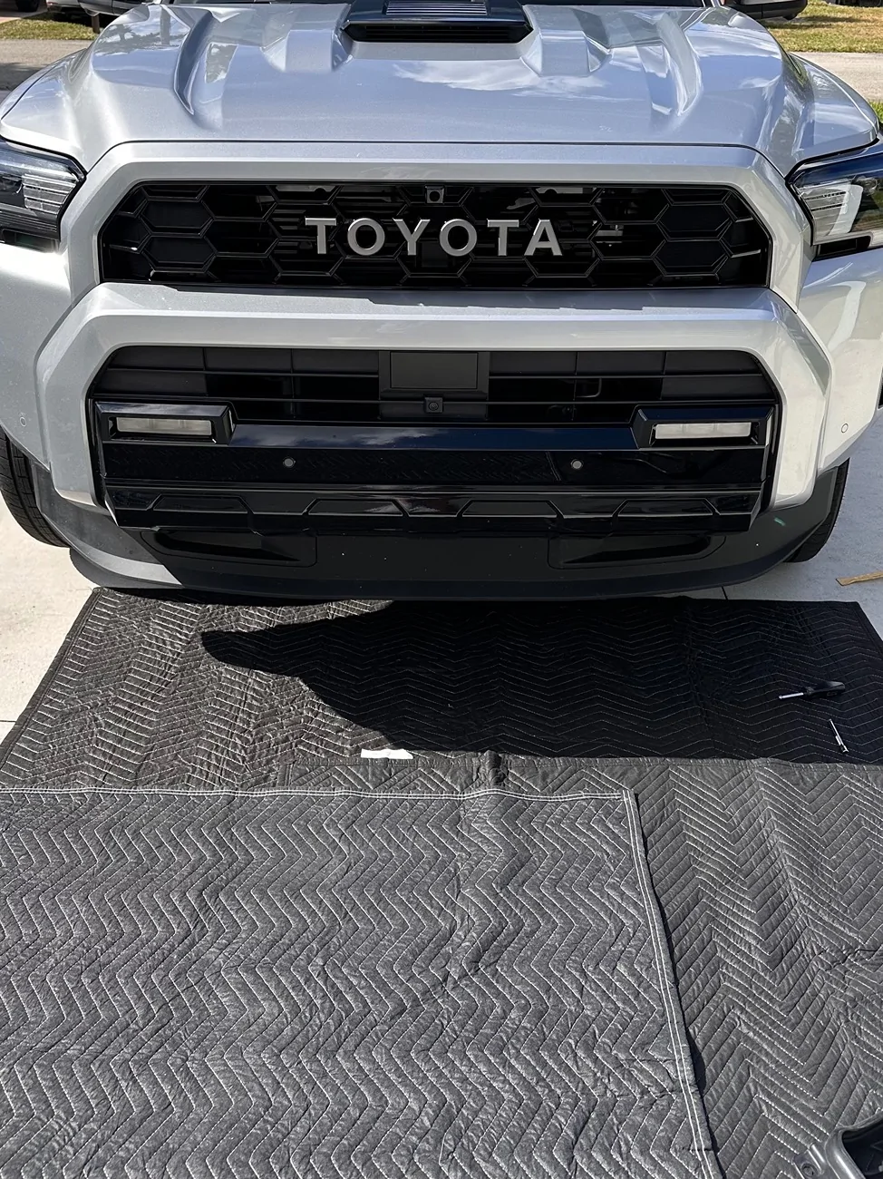

I watched the video on youtube from Yoti Expedition to install and was taking off panels above the radiator then feeding thru the grill. It looks like I can’t do that bc there is a louver system there and feeding wire thru would block it from closing. How did you do it ?

Thanks for installation instructions. There were none in the box. Still not seeing where to feed the wire thru to the front grill. I’d don’t see any openings above the louvers.
Hopefully you have since found the small gap where to feed the harness through. But, if you haven't, I'll try to describe the location. It's definitely a tight (small) gap that I had to finesse the harness and connector through. If you reference Toyota's instructions from the link that @Ahmad310 provided, it is Step 17 on page 6. The gap is located underneath the black tab (left of the hood latch if you're facing the front of the car) at the top of louver system.

Thanks ! Going to work on it this weekend! That info will help alot.

How hard was it ? Do you have to take off the grill? I already have the illumination. Mine is the chrome. I just want to switch out to the black one.

Installation wasn't difficult. But your case will be a little different. Your wiring for the illuminated emblem is already in-place. All you have to do is remove your existing illuminated chrome emblem. I had originally had a regular emblem installed when I purchased my vehicle, so it was easy to remove because the original, non-illuminated emblem had voids which allowed me to stick my finger through and behind the emblem to unclip the tabs holding it in-place. In your case, your existing emblem is an illuminated emblem which is a solid emblem without any voids. There's not much online information or videos about how to remove the illuminated emblem because I think it's so new. I haven't tried looking yet, but you might be able to unclip the tabs on the illuminated emblem from the back side of the emblem without removing the grille.

Thanks for checking back. After got the paper print out and ya'll input, it was easy.
I pull up on that grill tab on top alittle and fit plug through it.
