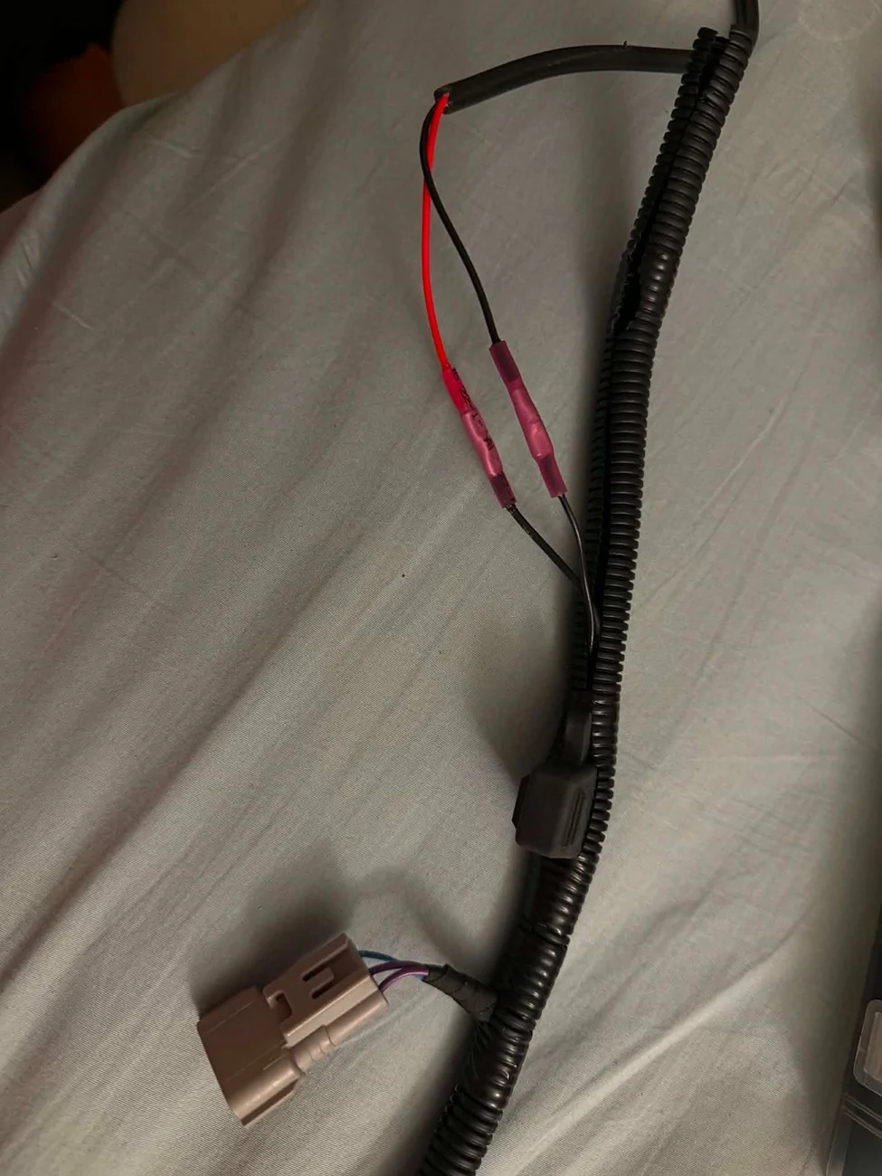

So I just got the harness and wired my raptor lights to the other headlight. I think you could tap into the wire harness of the illuminated emblem due to the fact it uses the same fuse and is fine.

I just have the picture of the harness. I just removed the pre-existing wire and attached the Raptor light light harness to that point. Theoretically you could just attach the tap in to this harness for your raptor lights and it should work fine. If anything did happen the fuse would blow first.

I dont know if it works for the Full LED headlights in the upper trim models. But for Off road Premium and bellow it should. few options.
Illuminated Emblem + Raptor Lights = Tap Raptor lights into Emblem Harness.
Raptor Lights = Buy Harness PT413-89250-AC and connect harness to raptor light plug into headlight (or tap into fuse box) Harness comes with inline fuse.
Also noticed my Illuminated emblem and raptor lights dont turn on during the day time only at night or when i turning the lights all the way on.
If you want your raptor lights on all the time you would have to tap into another source like fuse box or something with constant power when car is running.
