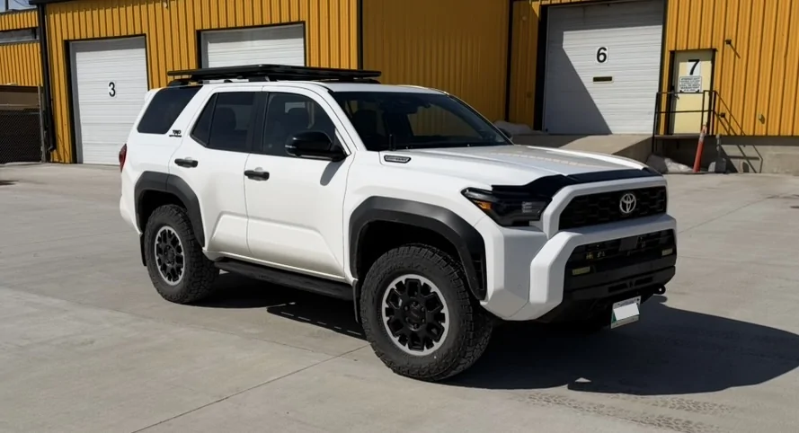

Having my rig now for about a month, and after doing all the mods to it i felt it was time to now express my true thoughts in hopes anyone else here planning similar can get a good idea from my experience.
Before i get too deep here i feel its important to give back story on my experience and reasoning to my build, as its a true “no nonsense” set up IMO.
I am an avid survivalist and outdoorsman that provides off road guiding / hunting / survival training and exploration service's. I also build and design prepper survival systems that regularly require me to find ways into usually unaccessible areas while also carrying my gear. I live in Northern Canada where long highway rides are a regular and -35C is considered a warm winter day. So between work and play I live on highways as well as off grid. Frankly, nobody is coming to save you or any emergency help is a 48 hour helicopter arrive time.
My first rig nearly 25 years ago prior to Toyota was Ford and as most of you likely suspect it was not a good experience. My second and third off road rigs ranged between Nissan and GMC till i finally had the money to buy a brand new 2019 4Runner, fully modded to my standards with over 200,000 km of off road service milage by the time i sold her. This Gen 6 is my 5th off road rig that for the first time i feel is “perfect”.
Coming from my Gen 5 4Runner that was heavily modded to handle most of everything i felt i wanted the Gen 6 to still be capable without loosing comfort. I am also getting a bit older now and feel its time to keep things looking somewhat reasonable. Every mod, part, interior item and storage system placement in my Gen 6 is there for a reason, my entire build is designed from my past experiences of what worked and what didn’t, and so i begin the explanation of my build and why its no nonsense to me.

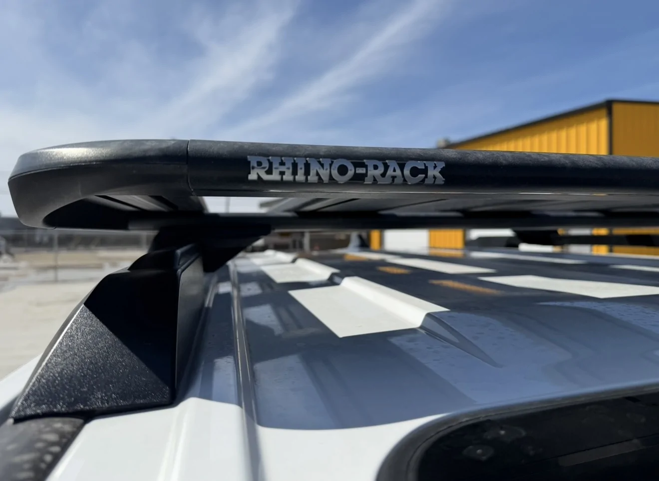

Roof Rack
I hate the idea of drilling into the roof of my rig, I ran a Rhino Rack Pioneer system on my Gen 5 for 7 years with not 1 single failure. Iv mounted everythign from 12 sheets of 5/8 G1S Plywood to 40 2x4's to RotoPax etc... The roof rack has never had wind noise issues, never flexed or vibrated and never made road noise that drove me nuts. I ended up going with the exact same Pioneer system as previously only this model on the Gen 6 is Rhino Racks newer design (apparently 40% lighter with even less wind noise). The roof rack system i went with is great, it mounts on factory roof rails and requires no drilling. The mounting systems on the tracks are very easy to work with and the amount of accessories available ranging from MaxTrax mounts to Awning brackets are endless. I usually tun a 4 Max Trax holder with shovel along driver side, and a ARB Awning on the passenger side.

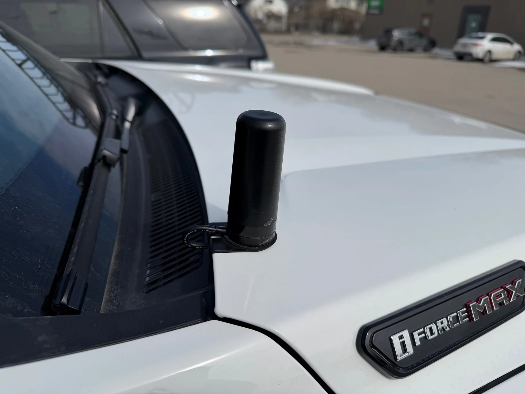

Radio
I have ran CB for a long time and over those years the one thing i can clearly say with CB is its dying.
As trail rides and group events became more common or hitting true remote areas it seemed only 1 other guy was running a CB and the conversations were limited. By the time i got my 2019 4Runner i can count only 2-4 times in 7 years i was able to talk to somone on the road. GMRS was definitely the go to with almost every rig having a handheld leaving me with a bulky CB on my dash and a small hand held GMRS in my cup holder.
For the Gen 6 i decided to go with a full Midland MXT575 with a Tram 1246-b NMO hood mount. I keep a stubby 3db antenna on at all times but also a 6db in trunk storage if needed.
The chatter i can pick up between job sites and hobbyists is fun, i enjoy scanning channels and listening but on group rides with the MXT575 the range is unprecedented, with highway driving getting 30+ km’s of talking distance (CB was lucky if we could get 2 km). In dense urban my friend and i were able to talk almost 8km apart where previous CB would be lucky if we could make 1/2 - 1 mile.
GMRS is the way to go, chatter seems more frequent in city but group rides on highway is an impressively serious system that you just need to experience to truly understand.

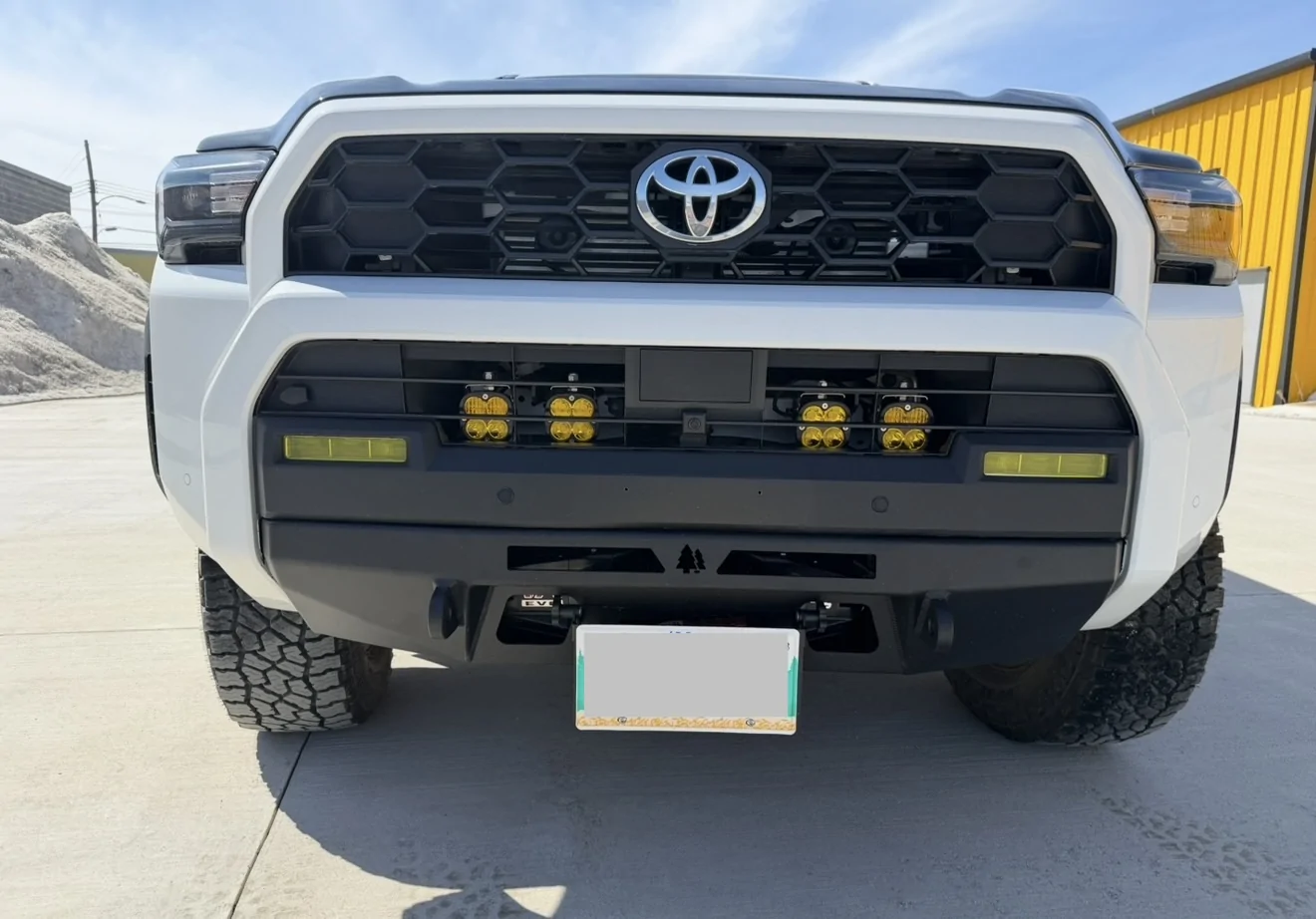

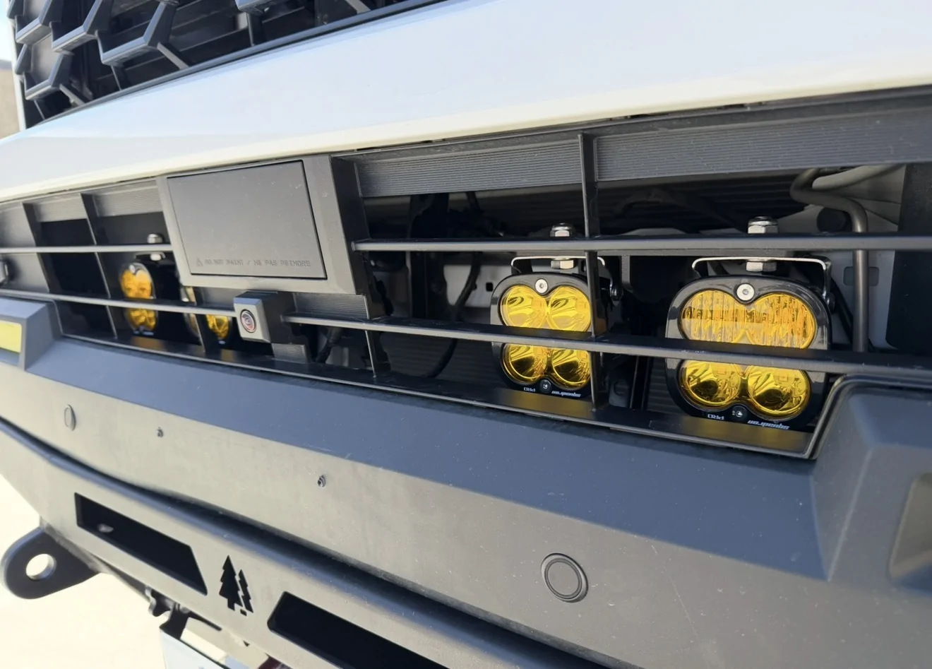

BAJA Squadron Grill Lights
I haven't had a chance to really test these lights yet in any serious situations, but i have had the chance to blast them a bit in some fields and on empty highways. These things throw light better then any fog i have ran before. They are almost "to bright" where any use of them to other riders in front of you will just be painful for them. When i turn them on while driving open highway, they over power my head lights high bean and low beam and spread a light pattern unlike anything I have veer seen before. The install was very simple and the mount brackets worked flawlessly with no jutter or shake on the lights while driving. I will update this thread down the road after i have more opportunity to test these lights.

Greenlane Stump Bumper with Warn EVO 10-S 10,000 lb Winch
Anyone with a winch knows what im talking about when i say its the most comforting insurance policy. My 2019 4Runner i ran a bumper hidden Warn Zeon 10,000 lb system that never failed me. I even recall pulling a farmers stuck tractor out of a field with it once after being bet $20 “theres no way your truck can do it”. As long as you keep a few tree huggers and snatch blocks on hand, you should be able to get yourself out of ANY situation (as long as you can be creative with your spare tire and a shovel).
I decided to go with a CBI super stock hidden bumper just before tariffs got serious between USA and Canada. CBI is an incredibly good brand and i have nothing negative to say about them but once tariffs got substantial i made the decision to switch my purchase to a Canadian brand, Greenlane.
The Greenlane stump bumper was a beautiful alternative and frankly the aluminum design over steel was a plus to me as nose dive from the extra weight on the CBI steel was reported to be bad.
I did the full install of the Greelane bumper myself and it was a total nightmare (Link on Review Here) but the end result i am very happy with.
I did have some concerns in serious winch scenario’s where I was not totally confident on this bumpers reliability in off angle winch scenarios, however after reaching out to the manufacturer and raising these concerns they made it clear no movement would happen and their testing proved their design was solid.

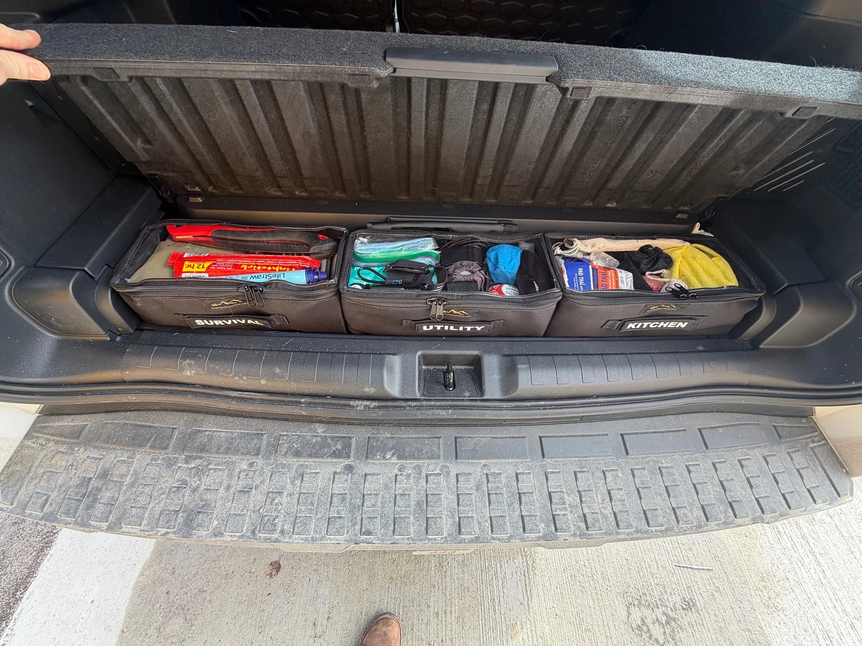

Storage - Survival / Utility / Kitchen
The contents of my storage system is purely based on real world experience of what i used in an emergency, what i wish i had during an emergency, and what comforts i appreciated to always have when i just wanted to enjoy myself.
In the rear cargo storage i went with the Overland Gear Guy storage packs with custom name tags. I got the bag ideas from another post here (Link on Bags Review Here). The bags are very expensive but upon arrival they were clearly worth it. These bags have clear tops as well so you can see your goodies before having to open them to make sure they are there. The bags are worth the expense if you can afford it, organization is critical in fast response times.

QQs:
Are those the factory cross bars?
Also, how did you mount the rack to the bars? Direct via a T channel bolt?
Cranberry
Cranberry
Dan
Nov 26, 2025
167
134
Manitoba Canada
Look epic!
QQs:
They are rhino rack cross bars. They friction mount with grips to the fa tory roof rails.

Suspension
My 2019 4Runner I had the opportunity to run 3 different suspension systems ranging from Old Man Emu to a full $10,000 Kings Racing. The Kings system was hands down the best thing for my needs but after getting 60,000 km on them the idea of dropping another $10,000 to redo them hurt. I have also had bad experience with failures on my old rig where my truck was stuck on a lift for a week or 2 while we had to wait for aftermarket suspension parts to arrive for repairs.
After my experience’s it was clear the Gen 6 suspension had to be capable and had to be easily available for purchase in any catastrophic failure.
I intended on putting the TRD Pro FOX suspension on my rig as they seem on paper to actually be a serious contender. On day of pick up and having my first drive experience however with the factory suspension i was impressed. Its a substantially stiffer ride from Gen 5 and handles incredibly well on highway. Based on this unexpected experience and frankly shock due to the several negative reviews i had seen on the stock suspension, i decided to keep it and instead add a rough country spacer lift of 2.5” in the front while putting Firestone airbags in the rear.
I truly find the suspension is great, its clearly not a $10,000 kit that lets me ride 7” washboard at 90 km/h but its good, and it gets the job done perfect for me. The spacer lift gained me that extra clearance and removed the rake, so far the truck rides like a dream. Unless i start hitting rock gardens or MOAB crawls, i dont see a need to upgrade from here, but time will tell if the factory set up is truly as capable as i feel it will be.
Roof Rack

Radio
In the back seat Gun Rack
