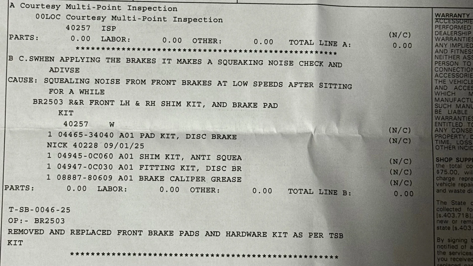

This is what they did yesterday
2025 2026 4runner 6th gen Front Brake Squeal Noise Fix - official TSB brakes fix! (TSB-0046-25) IMG_3301

yea that’s the TSB. They did that on mine twice now. Still squealing.

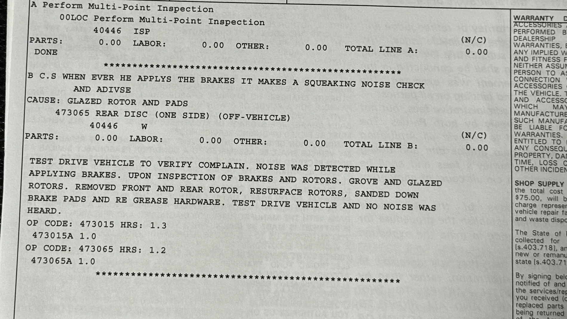

This is me backing out of my parking spot for work. This is after TSB repairs were completed. Today is September 2, 2025. I didn't have anyone to stand outside and record me backing up, but the noise is categorically worse than before the TSB.
Showed this to my local dealer, they were completely at a loss other than "Yeah we figured it'd be back."
It's comical at this point, really.
