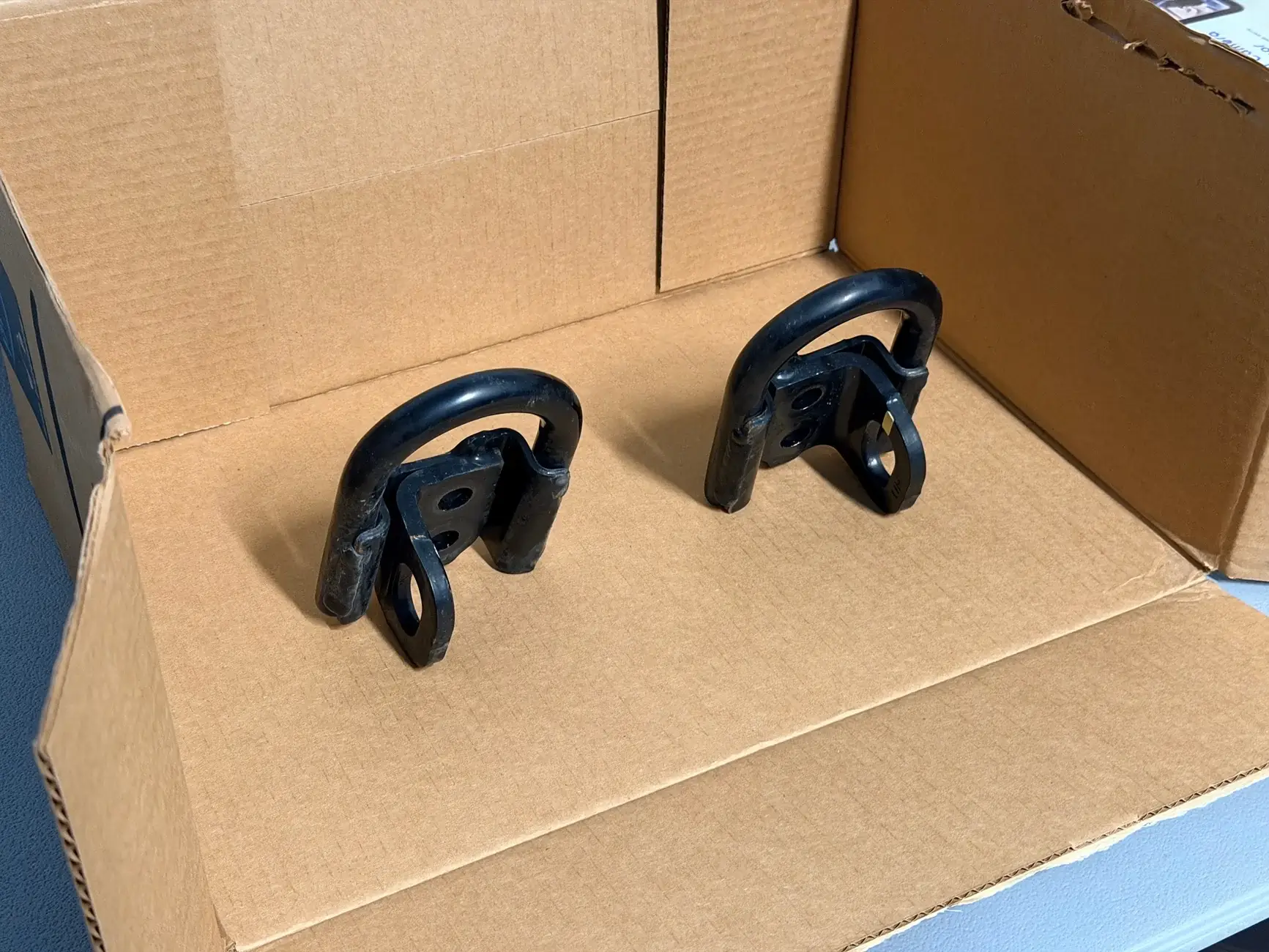

I've looked closely at the factory "tie down brackets"/"tow hooks" and they are very beefy, smooth curved edges for soft shackle and two BIG bolts directly into the frame. Only issue is the back there is only one (wish there were two). And I am virtually certain that the toyota red tow hook, and all the aftermarket versions replace the stock ones so mounting point is the same. Unfortunately in the only photo I could find of mine, its hard to see the frame attachment above the hook but it is attached to the frame. So I believe that, yes, those can be used for recovery (and I have been winched off a rock where I was high pointed on center frame member using the rear one.)
2025 2026 4runner 6th gen Factory Tow Hooks - Purpose/Capacity 20251206_172742-EDIT
This thread shows what they look like off the vehicle (black and painted:>). factory tow hook photos in hereCompare heft to all the "tow hook" choices.
2025 2026 4runner 6th gen Factory Tow Hooks - Purpose/Capacity 1777477976896-k3
2025 2026 4runner 6th gen Factory Tow Hooks - Purpose/Capacity 1777477924653-lc

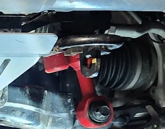

Credit where due - I just stole those photos from this thread from JGR because I remembered seeing this view of the stock "tow hooks" off the vehicle:
This weekend, added Hood Struts and decided to paint the factory front tow hooks red.
For now, the factory hooks in red add the subtle pop I was looking for.
