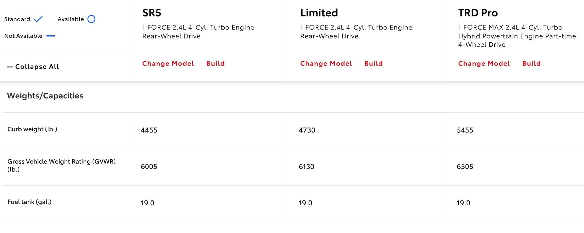

The specs did show the payload (GVWR - curb weight):
SR5 = 1550 lbs
Limited = 1400
TRD Pro Hybrid = 1050

Payload capacity is vehicle specific because it depends on what options and accessories are installed. A base SR5 will have the most and a fully loaded Trailhunter will have the least, and everywhere in between.
