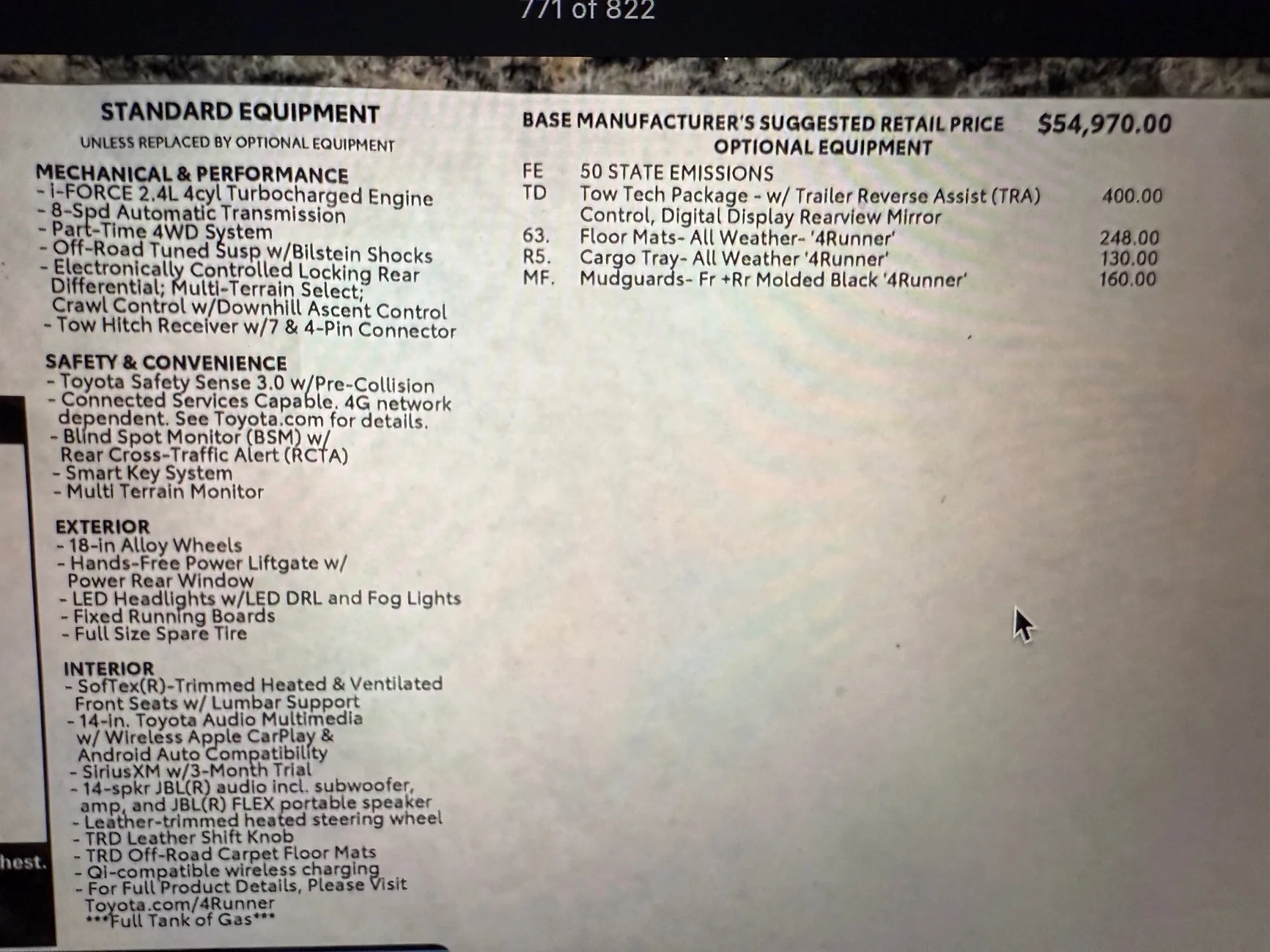

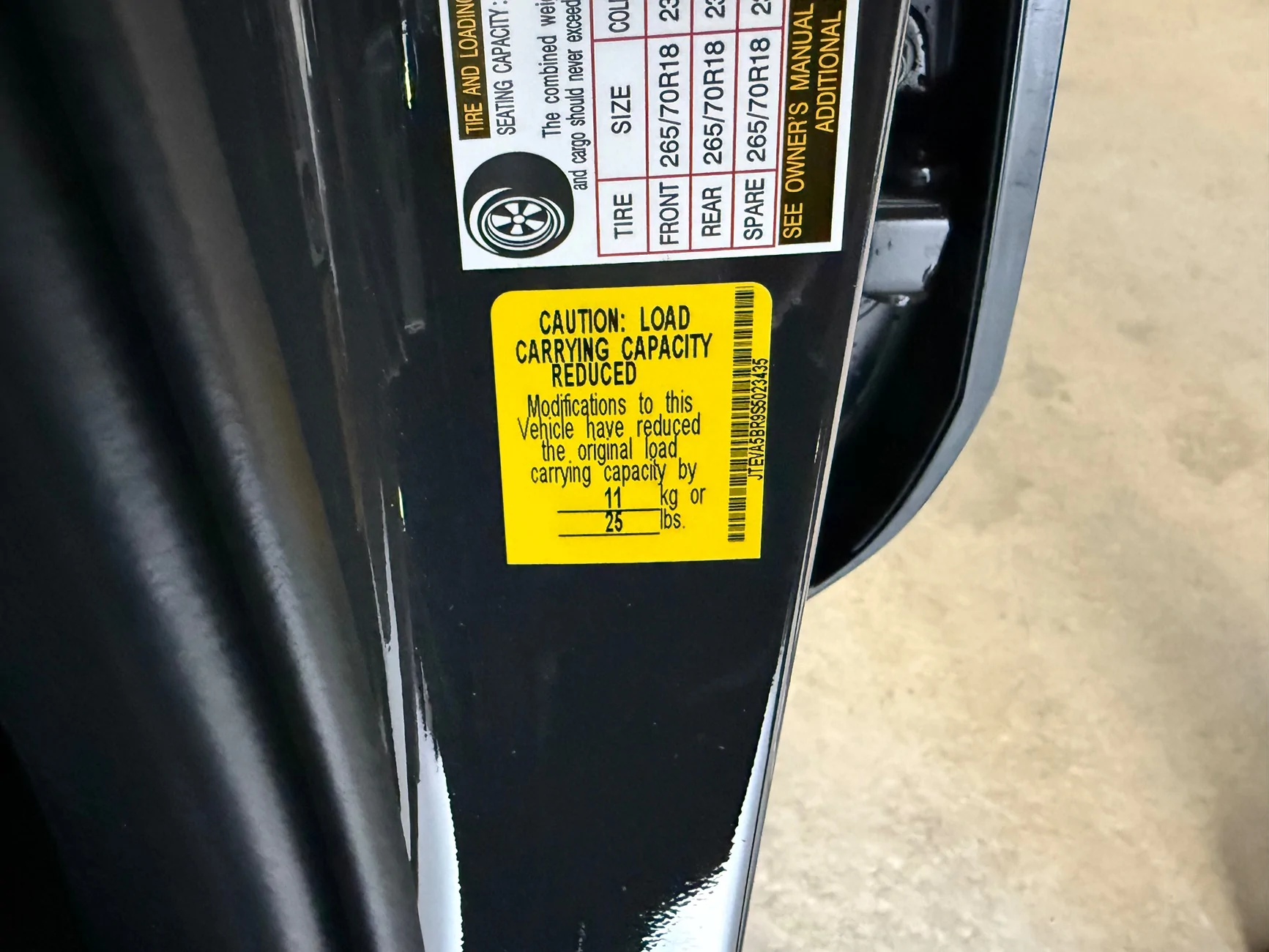

What was put on my 6th Gen. to reduced the load capacity? I have a ORP, nothing fancy was put on it at the port.

tow tech pkg + mudguards (prob 1 lbs) + floor liners (1-2 lbs prob)
