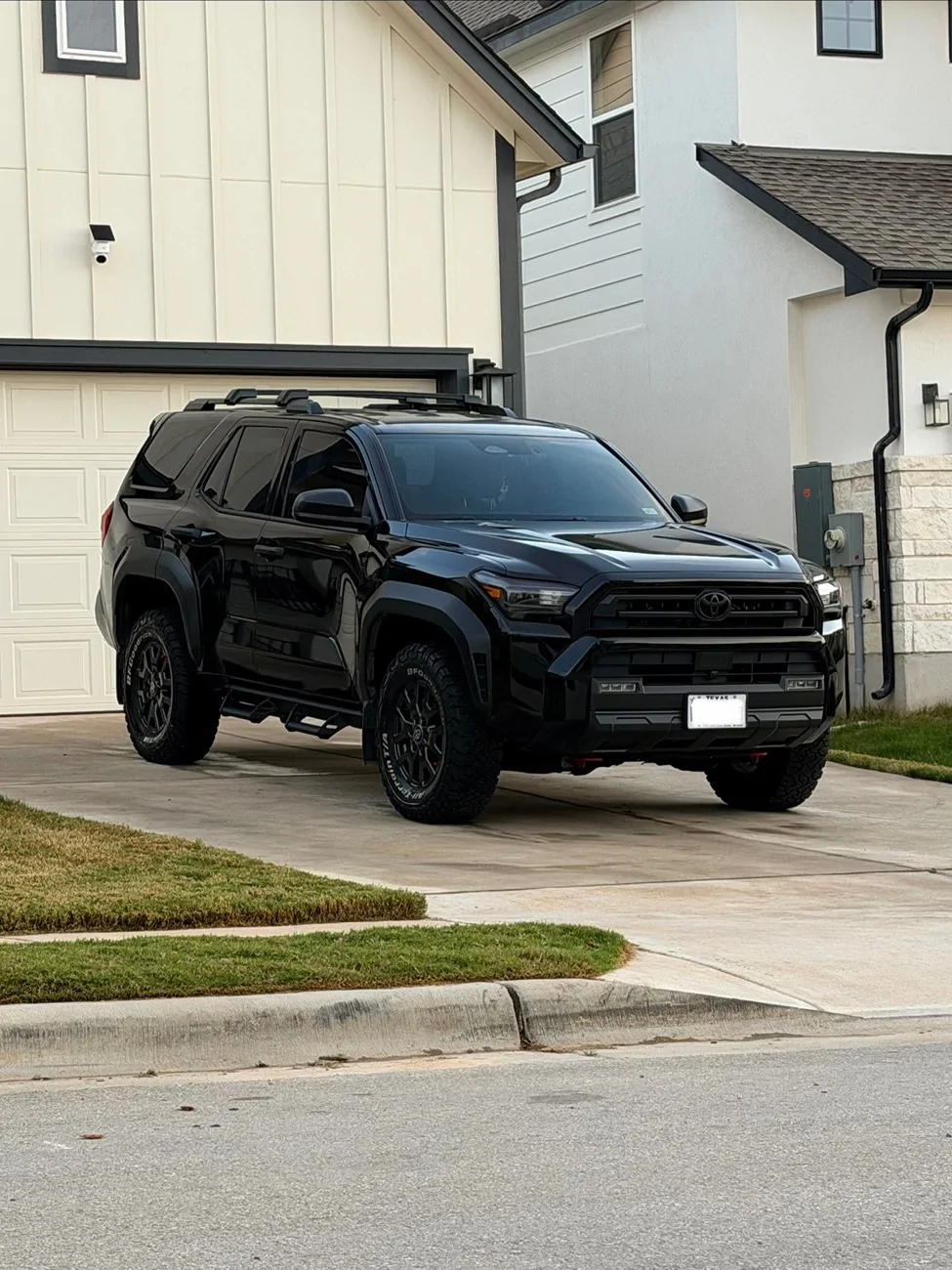

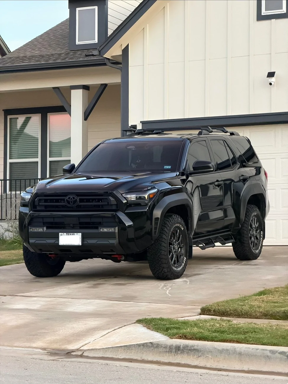

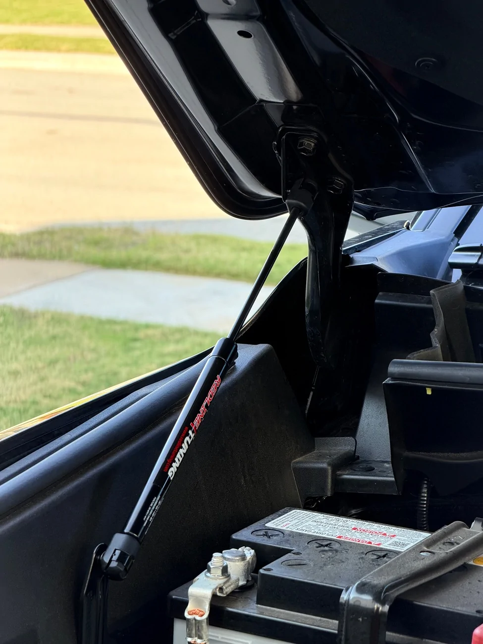

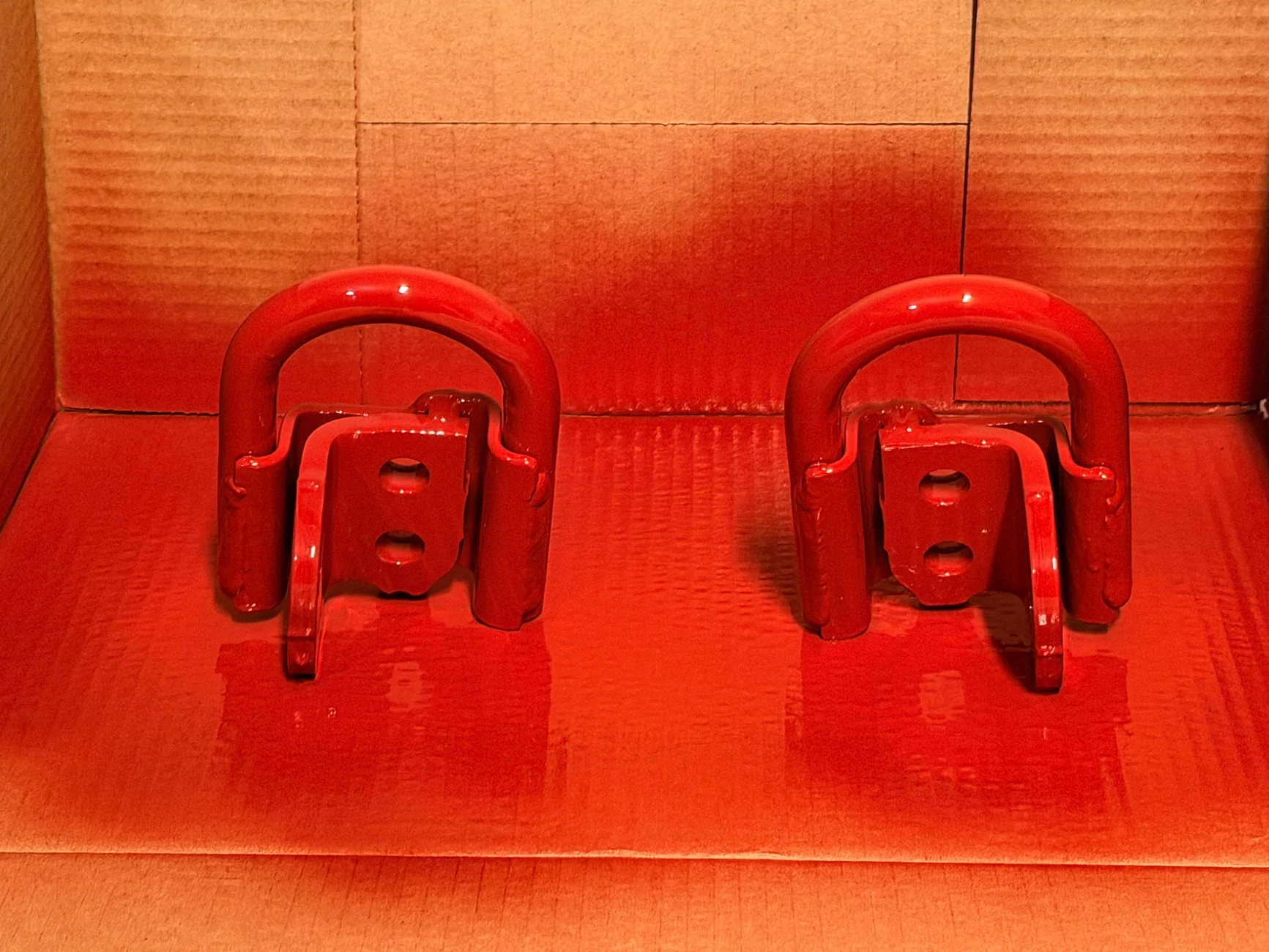

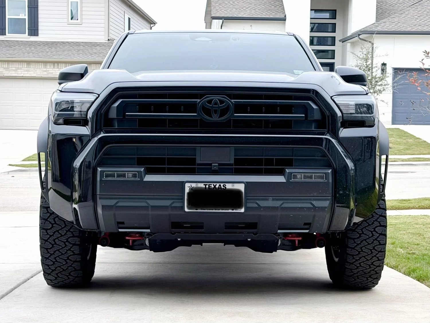

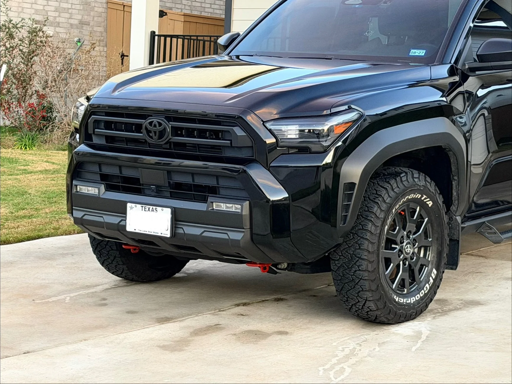

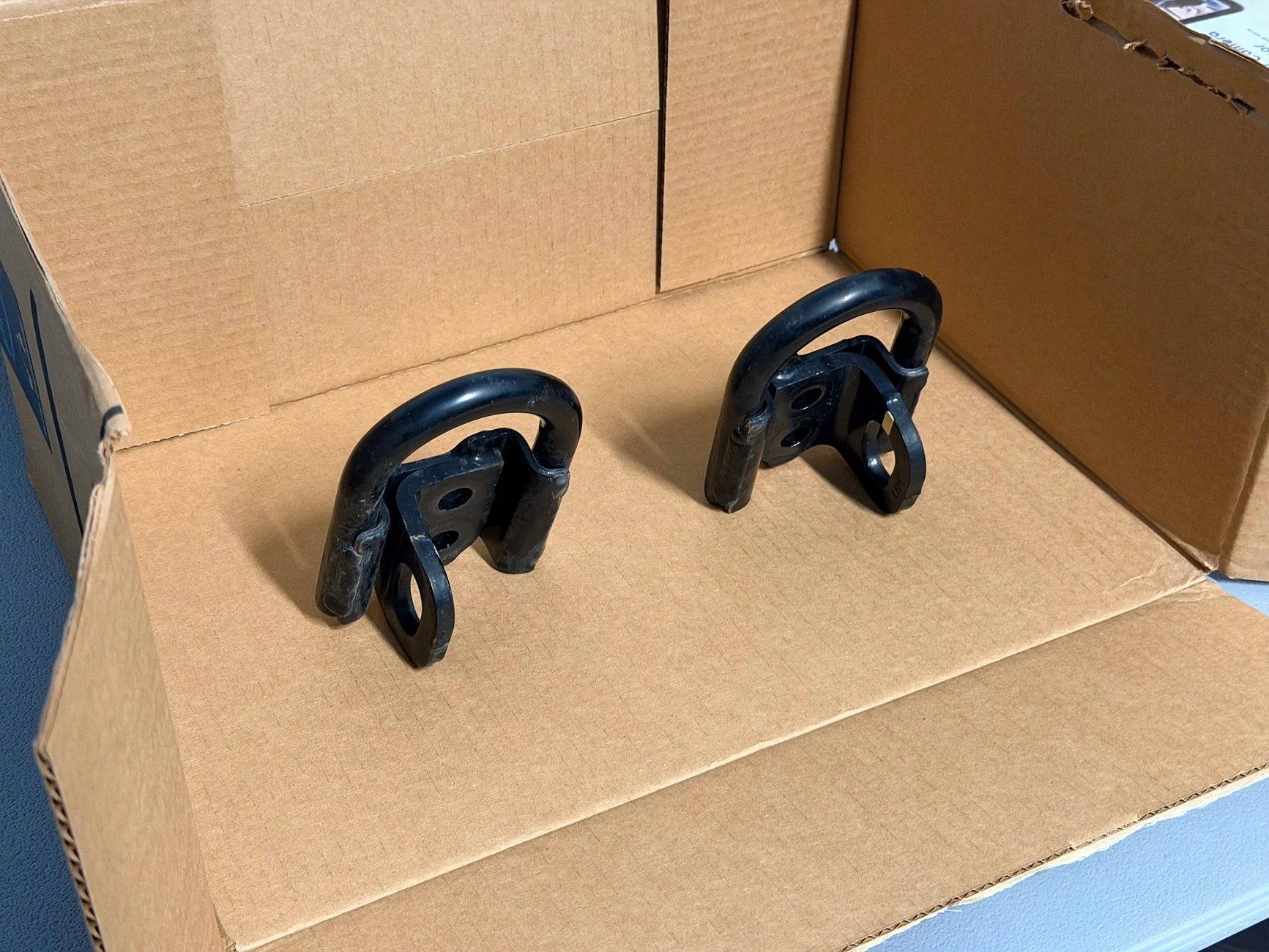

This weekend, added Hood Struts and decided to paint the factory front tow hooks red.
2025 4runner 6th gen 😎 SR5 OEM+ Build on BFG KO3 265/70/17 tires + white lettering (on stock wheels) + TRD OR Off-Road suspension IMG_1761
2025 4runner 6th gen 😎 SR5 OEM+ Build on BFG KO3 265/70/17 tires + white lettering (on stock wheels) + TRD OR Off-Road suspension IMG_1764
2025 4runner 6th gen 😎 SR5 OEM+ Build on BFG KO3 265/70/17 tires + white lettering (on stock wheels) + TRD OR Off-Road suspension IMG_1768
2025 4runner 6th gen 😎 SR5 OEM+ Build on BFG KO3 265/70/17 tires + white lettering (on stock wheels) + TRD OR Off-Road suspension IMG_1770
2025 4runner 6th gen 😎 SR5 OEM+ Build on BFG KO3 265/70/17 tires + white lettering (on stock wheels) + TRD OR Off-Road suspension IMG_1774
For now, the factory hooks in red add the subtle pop I was looking for.

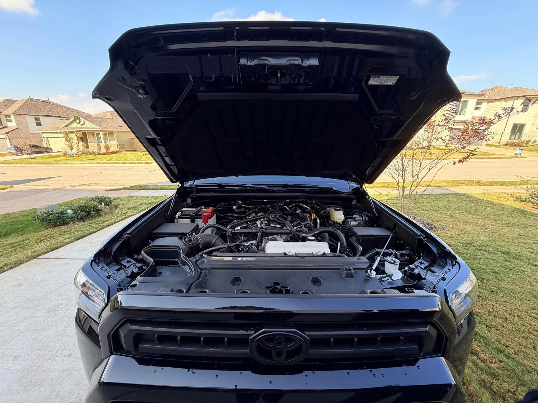

Also added a Zekzoop Insulation to the hood. Aside from thermal benefits, I noticed it improved the hood floppiness at highway speeds. Feels more stable with it on, less visual wobble.
After installing the insulation pad:
and finally got the air dam off! :)
Does the aftermarket hood insulation works?
Definitely helps with the hood not flopping in highway speeds.
It reduces the engine noise, and from my observation makes the hood appear more sturdy.
I heard it helps protect the paint and the thermal aspect makes sense too.

How are you liking the tires? Are they white letters on one side, black on the other? I'm looking at these but I'm not crazy about the white letters showing.

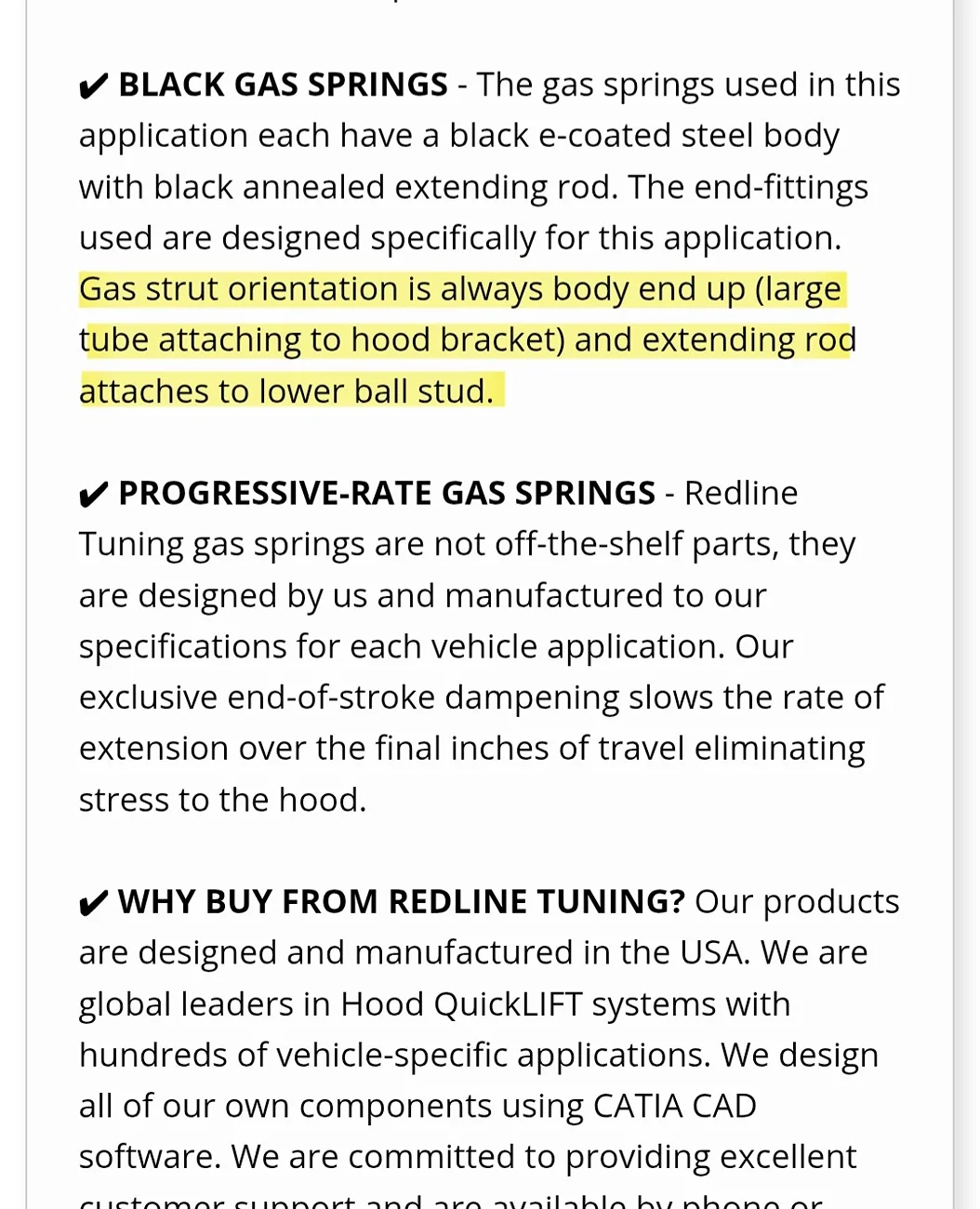

It looks like you installed the struts in the wrong orientation.
2025 4runner 6th gen 😎 SR5 OEM+ Build on BFG KO3 265/70/17 tires + white lettering (on stock wheels) + TRD OR Off-Road suspension Screenshot_20251221_073046_Chrom

What brand did you use?
Zekzoop from Amazon

BFG KO3’s, they have white letter and black on the other side. All down to your preference.
I’m enjoying them, i recommend the C-rated if you’re not making the rig heavy and want better handling.
They def take a hit on MPG’s, but it makes the truck so different from stock.
Good catch, i must have gotten too excited. Literally stopped reading the instructions after the brackets. Better design would be to not let that install happen backwards! Thanks for letting me know, gonna correct that!

What type of paint did you use?
