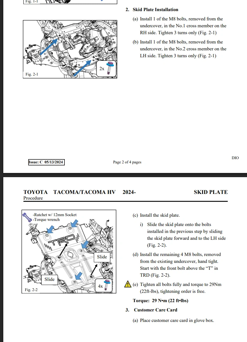

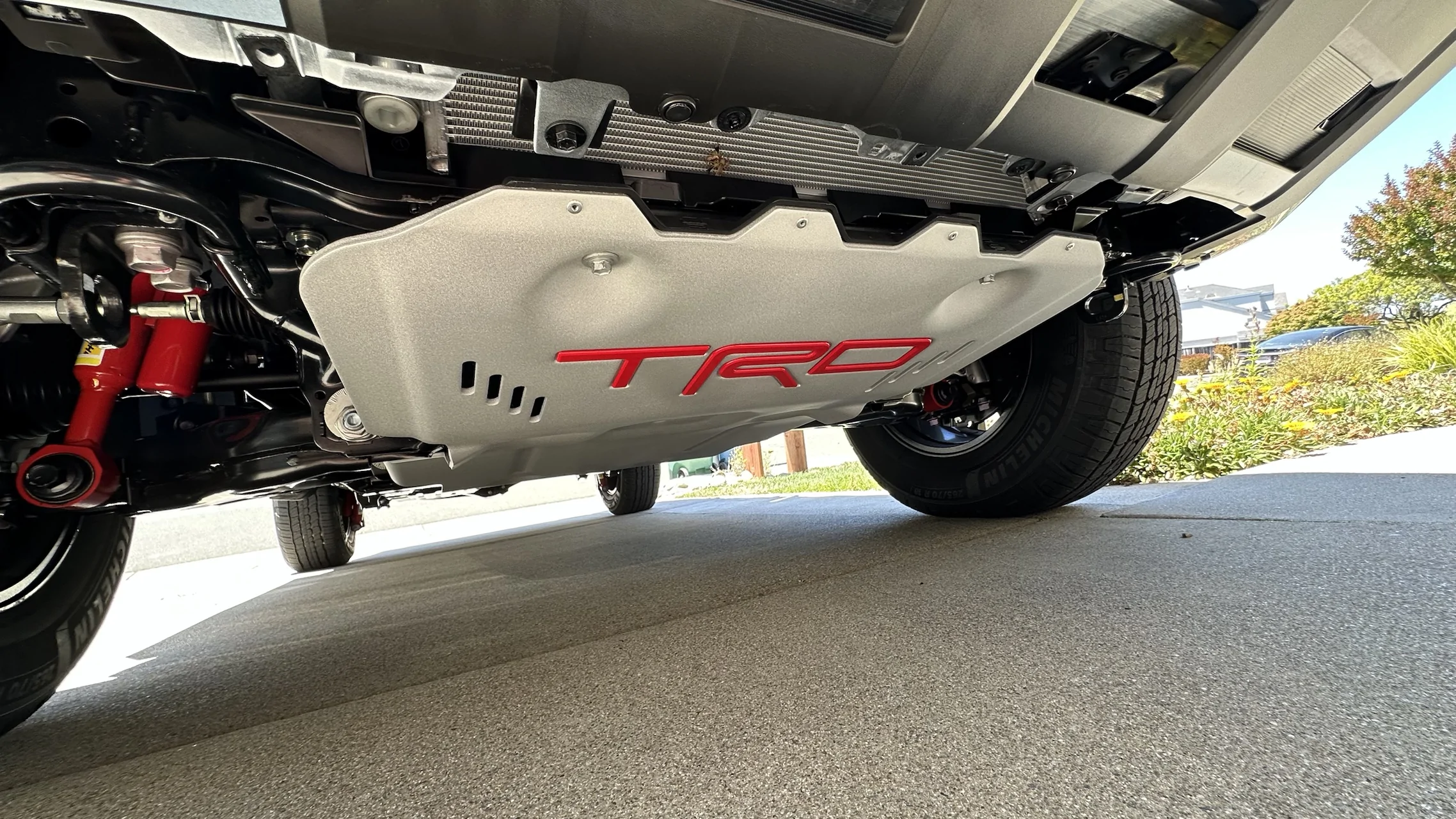

After my bad experience and my dealership in which they quoted me $254 and 0-8W Oil (I had it rectified). I will be doing my own oil changes from now on. I am assuming I will need to remove the skid plate to get to the Oil Filter and Drain Plug.
Any pics or recommendations from folks that do their own oil changes?

I have a TH and i think this applies to TRD pro skid plate : Only 2 bolts need to be fully removed and
the other 2 just loose, because the skid plate design is made to slide/ rotated the be removed once you deal with the bolts as said. 2 holes are keyhole shaped.

Actually i think the TH has 6 bolts and 2 that holt the plate in place for removal. Not sure if TRD plate goes that far back too.

TRD also has 6. Two can simply be loosened but the other 4 need to come out to slide the plate off. It is pretty simple, but helps to jack it up and use stands. The extra room makes it easier.

As other said there are 2 bolts you can loosen and keep the plate in place, remove the other 4 and slide it over/off.
I personally found it faster to remove all 6 and drop the plate and reinstall, that’s just me though.
