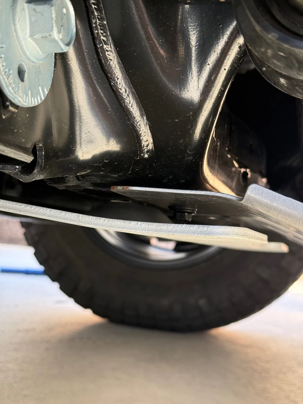

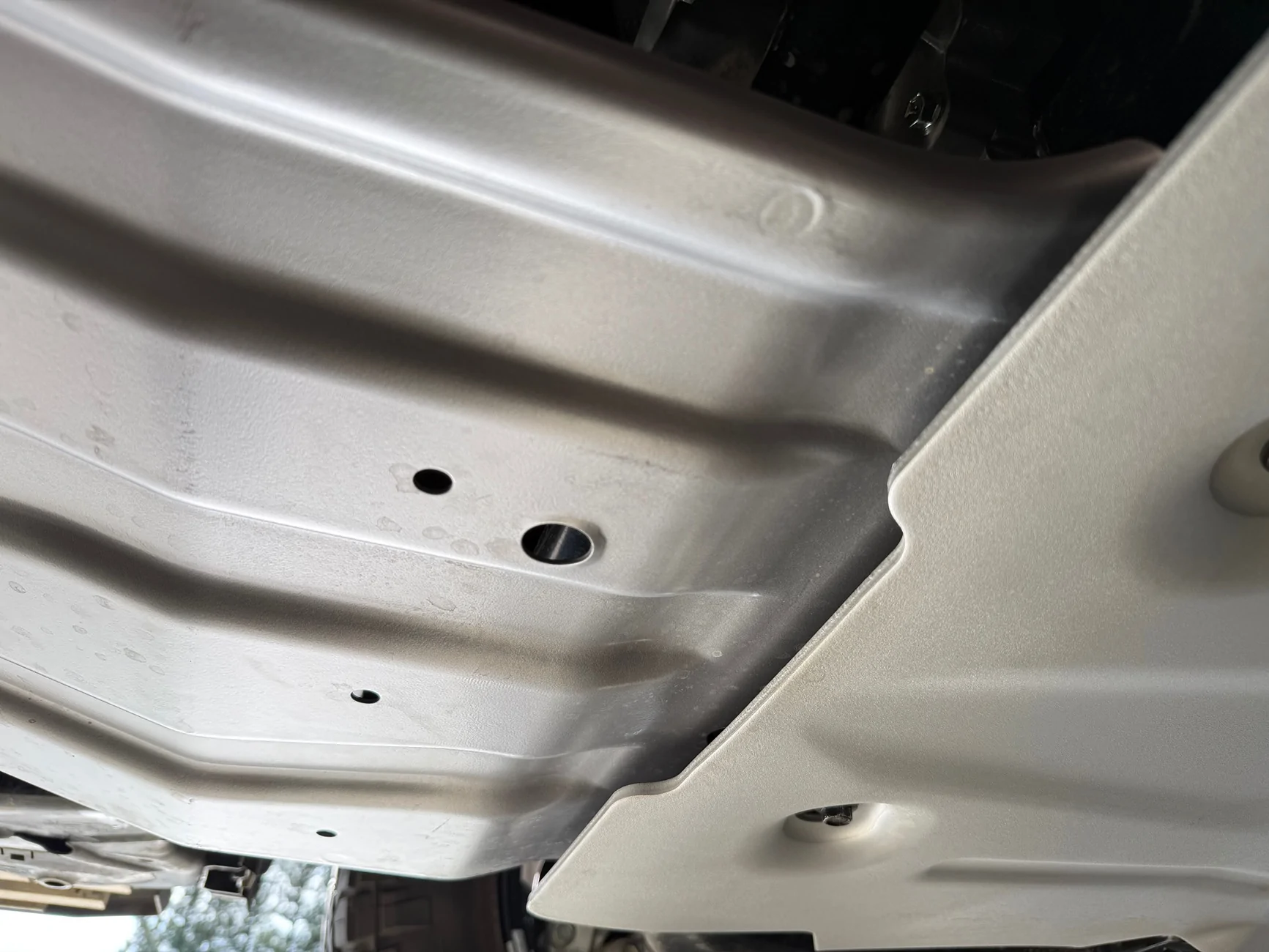

I had a TRD skid plate installed on my 4Runner and wanted to add the trail hunter transfer case skid plate with it. I saw other forums about it but was not sure if this was the correct way to install it. There were 4 screws for the transfer case one which was installed first, and then 6 for the aluminum TRD one which was installed after the transfer case due to it blocking the front mounted screws on it. These were the best pictures I could get.

Do you mean transmission skid plate instead of transfer case? If I am looking at your pictures correctly, the engine skid in on the left and the transmission on the right.
I think some dealers say transfer case skid plate while others say transmission skid plate for some reason
