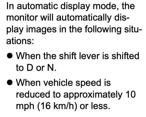

There is a setting that you can enabled that turns the camera on when you go under 10mph or so. Check that “Auto” is not enabled.

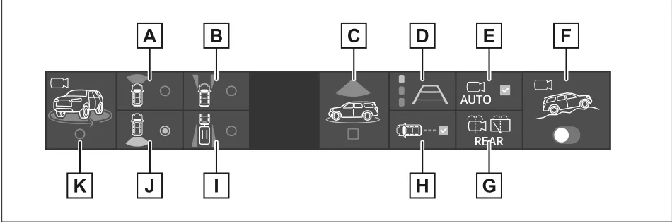

There is a setting for this on the camera display on the screen. It's called Auto Mode. Mine did it until I turned it off. See attached pics from Owners Manual
2025 2026 4runner 6th gen Cameras turning on at stoplight Screenshot 2026-09-07 at 9.20.13 AM
2025 2026 4runner 6th gen Cameras turning on at stoplight Screenshot 2026-09-07 at 9.21.45 AM

Yep, Auto is probably going to be your selection. Our camera systems are fairly diverse and you really notice the benefits of all of those features when you're in crawl mode and multi Terrain, You can even set it so when you stop at an intersection you can view the cars behind you.
