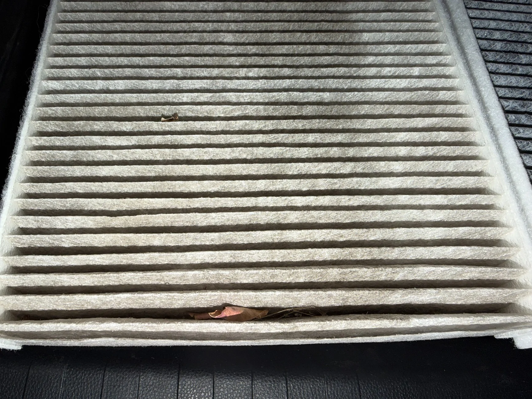

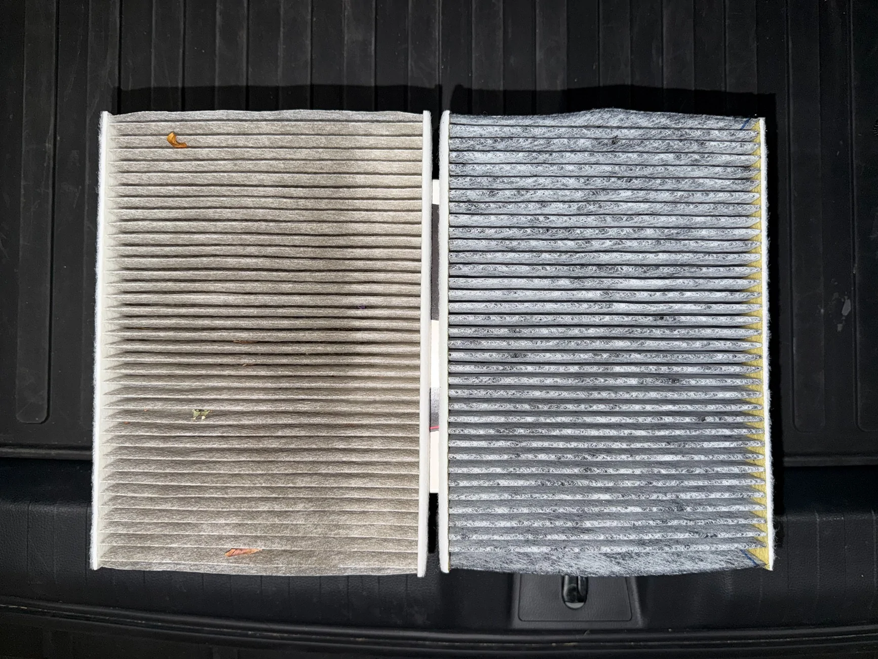

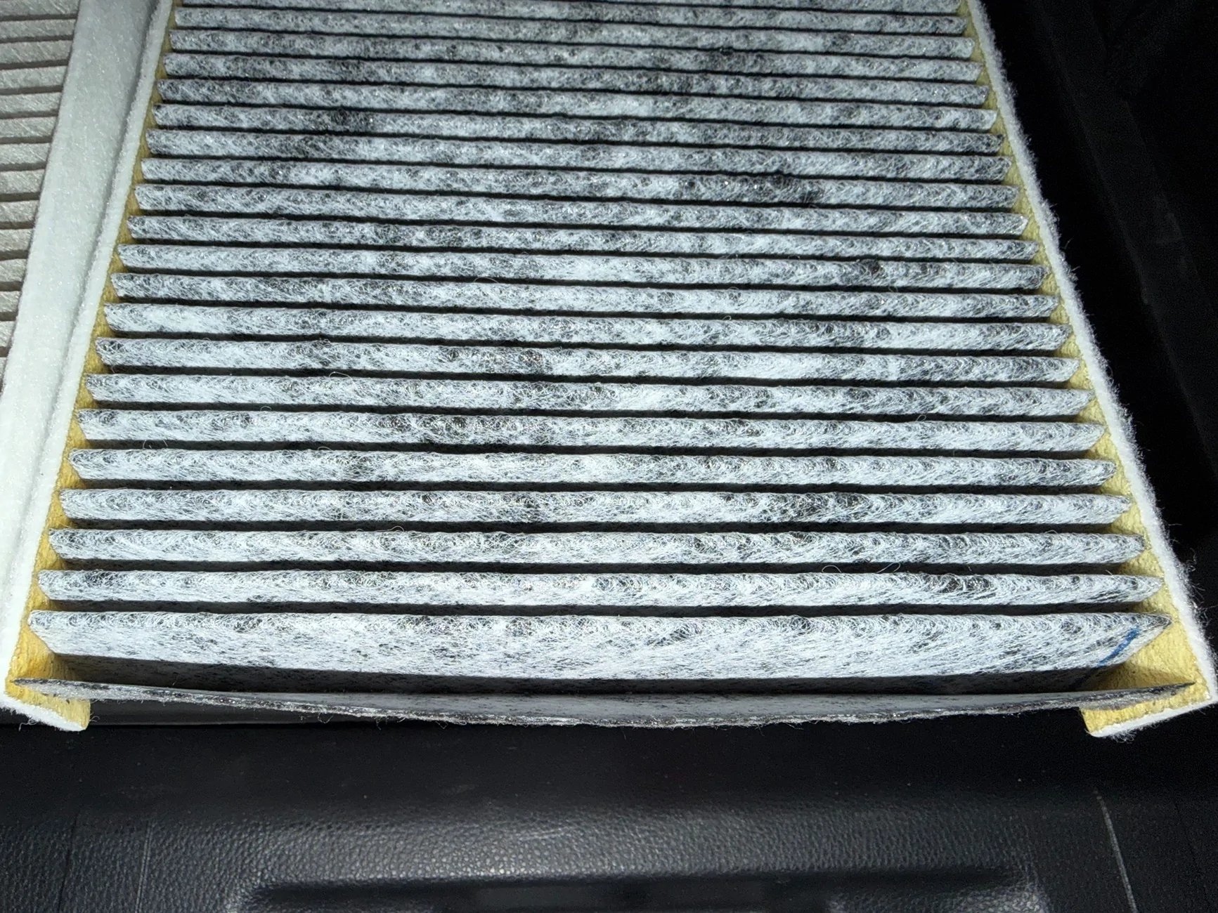

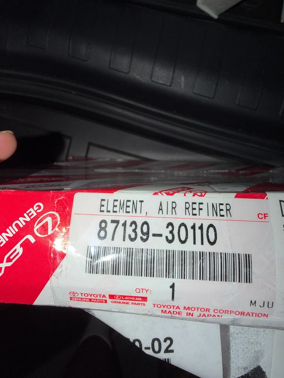

I just replaced my factory paper filter with the carbon one at 1 year/15k miles. Carbon one feels much heavier and solid - so far it's been helping a LOT with the pollen we've been getting in NC. No perceived difference in airflow so I'd say this is a win.
PN is confirmed 87139-30110
Comparison pics:

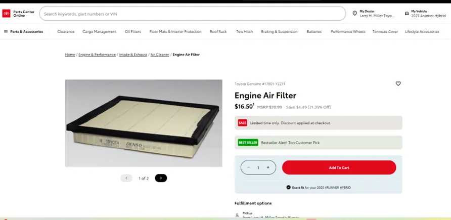

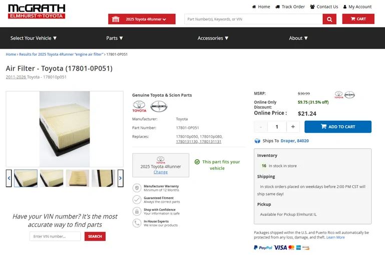

This is what I found:
  • The original filter is still available from various dealers, see screen shots below.
  • For what it is worth, ā€˜AI’ said the following:
Toyota part 17801-0P051 and 17801-YZZ11 are interchangeable OEM engine air filters, but with a few key distinctions regarding manufacturing and design.
  • Official Status: 17801-YZZ11 is the current, active part number. Toyota officially supersedes and replaces 17801-0P051 with the 17801-YZZ11 filter.
  • Manufacturer: 17801-0P051 is typically a Japanese-made (often OEM) filter, while the 17801-YZZ11 is part of Toyota's North American parts program.
  • Design Differences: Some owners and mechanics have noted that the 17801-0P051 has slightly deeper filter media (pleats), making it appear marginally thicker than the 17801-YZZ11.
2025 2026 4runner 6th gen Cabin Air Filter Replacement - Part Number & DIY Instructions [Updated with correct parts confirmed by dealer] 1779803533446-9s
"New' filter:
2025 2026 4runner 6th gen Cabin Air Filter Replacement - Part Number & DIY Instructions [Updated with correct parts confirmed by dealer] 1779803610527-q7

I also noted that 17801-0P051 is used by Lexus, thus a Lexus dealer may have the 'original' filter in stock.

yes, still thinner filter media though, for those preferring more filtration
