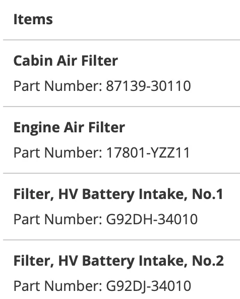

Cabin Air Filter Part Number (OEM Toyota)
87139-60030 is the non-carbon cabin air filter version
87139-30110 is the carbon cabin air filter version
Note: 87139-0C010 (non-carbon) is NOT the correct part number
Cabin Air Filter Replacement Instructions
Toyota recommends checking the cabin air filter every 15,000 miles. To replace it:
- Open the glove box
- Push in the sides to release the stops and lower it completely
- Remove the cabin filter housing cover
- Pull out the filter cartridge and inspect it
- Insert the new filter (make sure the AIR FLOW direction arrows point down)
- Reinstall the cover and glove box
