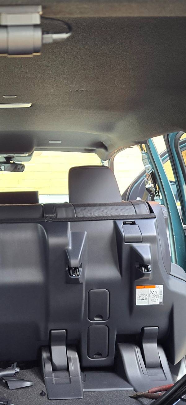

2025 2026 4runner 6th gen Blackvue DR970X LTE Plus Dash Cam + Blackvue Battery install. Rear cam bracket from amazon for 5th gen. - DIY instructions & photos 1000019474
What is did was remove the passenger sun visor and mount, a pillar trim, passenger front grab handle, passenger b pillar trim, passenger c pillar trim, and both d pillar trims. There's push clips in the middle of the headliner and in the rear. After that you should be able to lower the headliner just enough to run the wire to rear along the factory harness. Be careful not to pull down to hard to cause any headliner creases. But if you remove the roof console you should be able to lower the headliner more. Sorry that's the only Pic where it kind of shows what I removed. Note there's a trim piece that goes along side the rear passenger window. Take care to remove so it doesn't scratch the tint if you have tint.
