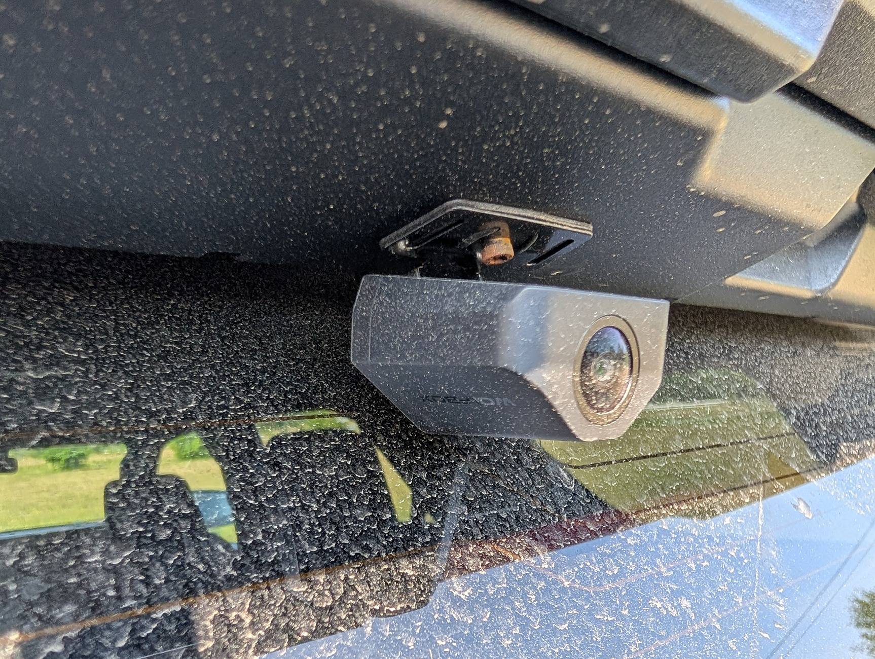

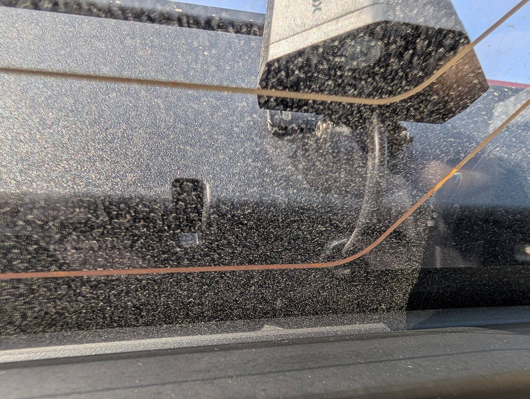

Excuse the dirt. But I drilled the camera into the plastic part under the spoiler and then on the same part drilled another small hole behind (where it tucks up 2nd photo in from the underside) then just ran it through the channel with the other wires from the hatch into the vehicle.

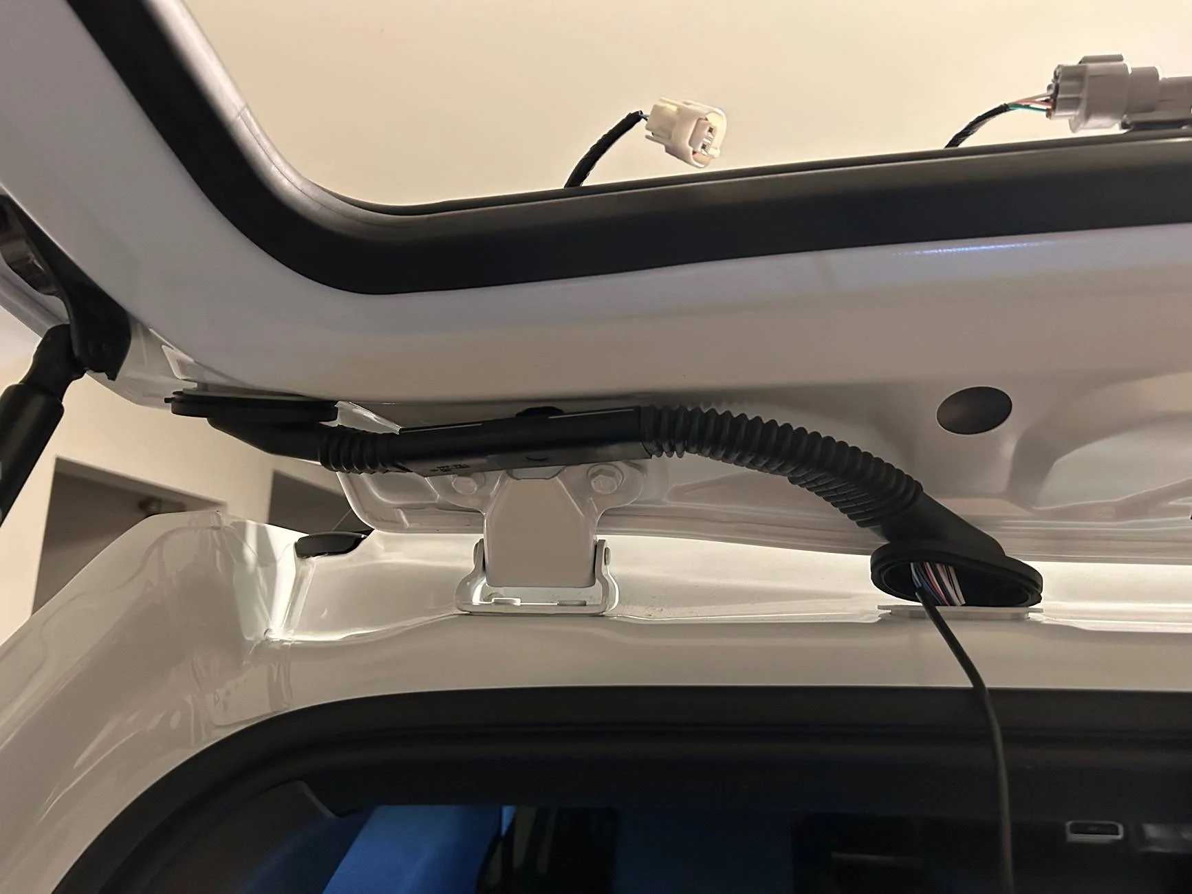

I ran the wire from the mirror along the headliner on the driver's side, and the wire from the camera through the rubber harness located inside the top of the rear liftgate. Similar to what was shown in the youtube video I posted in the comments. There's no need to drill to run the wire.

@jaymay82 @Geofflolz how did you guys route the this firewall and hose? Ive been struggling on this
I attached the wire to a long ziptie and pulled it through.
I saw others that sliced a tiny hole in the middle portion of the rubber cover to run the wire through, and then sealed it with electrical tape.

Same, I just used a wire feeder instead of a zip tie but same concept. Just folded the rubber channel about half way and snaked the metal line through / pulled the connector out and ran it along with the stock wires.
