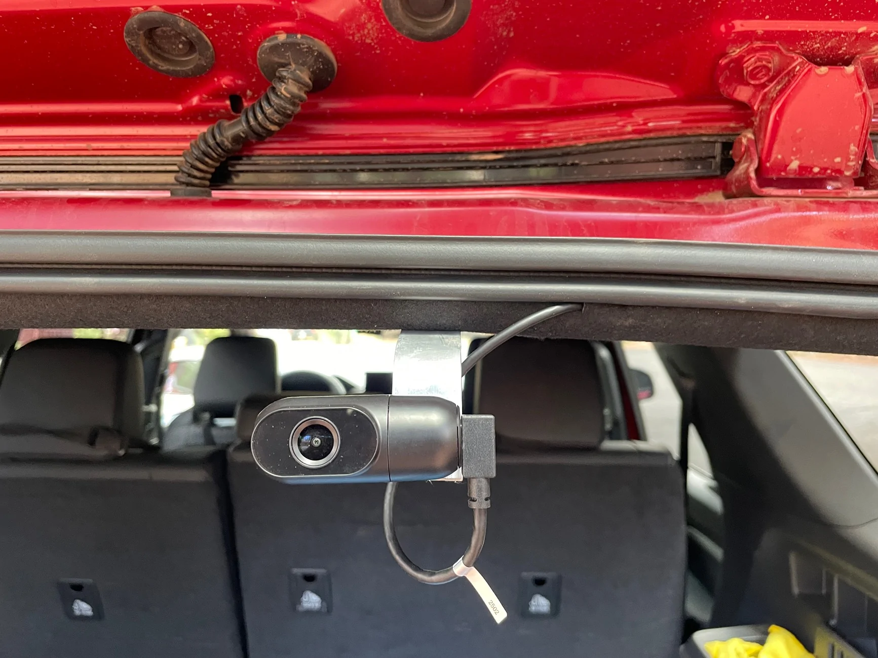

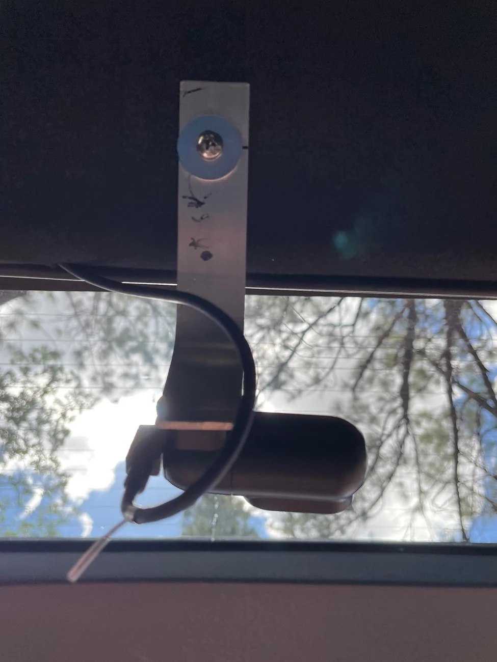

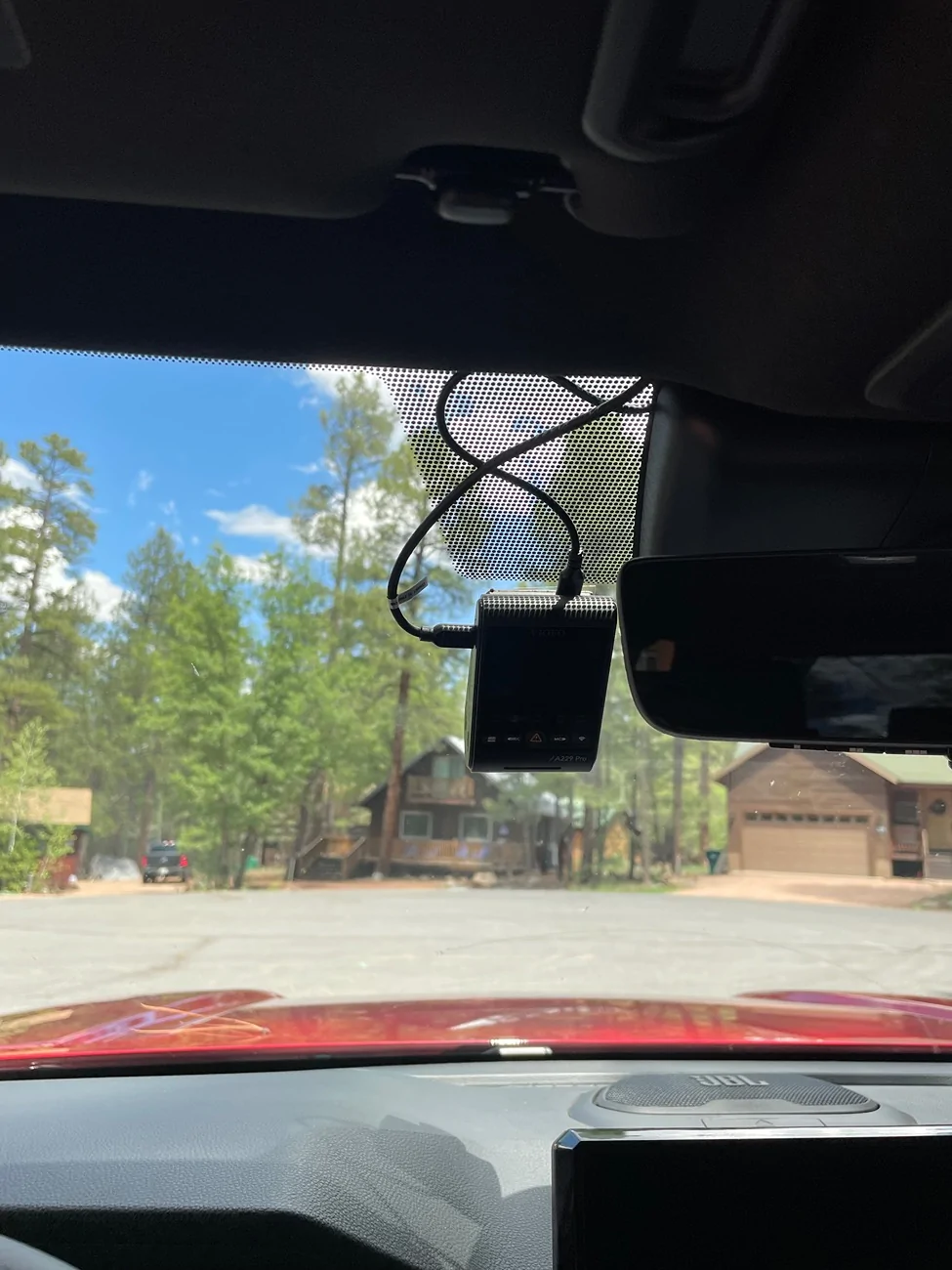

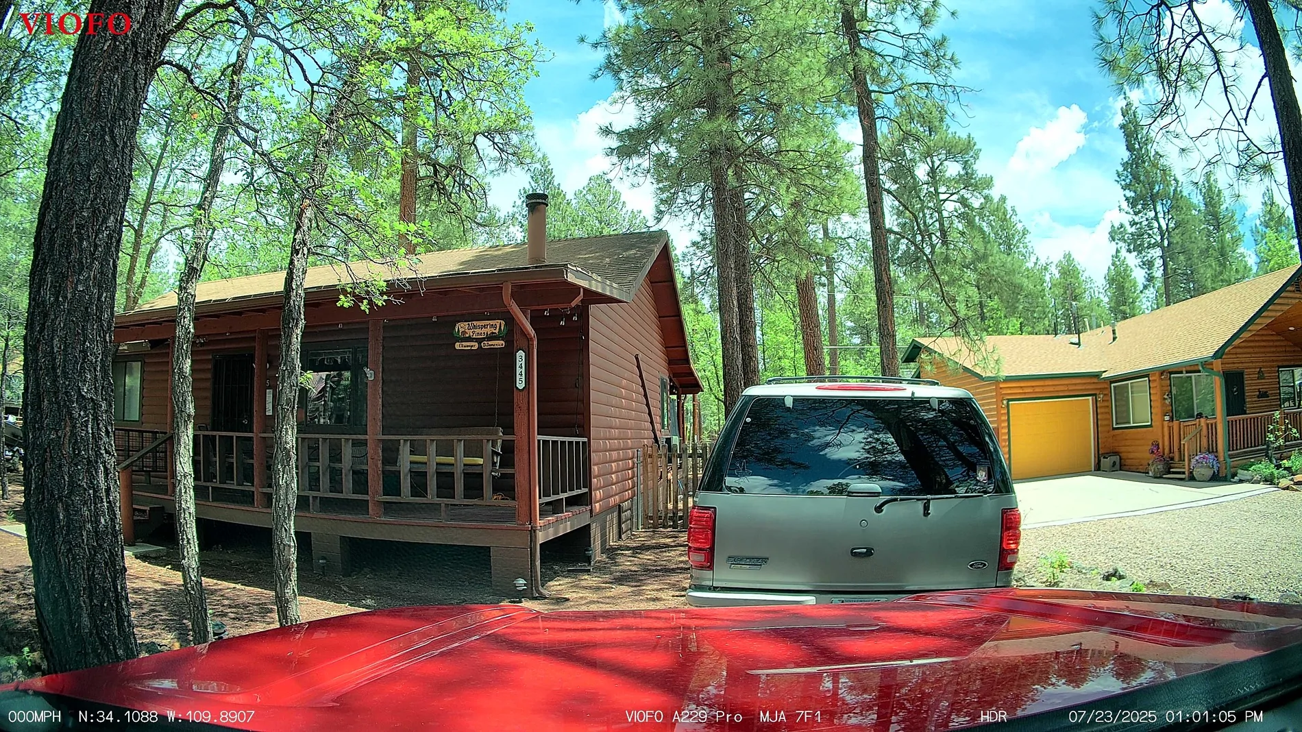

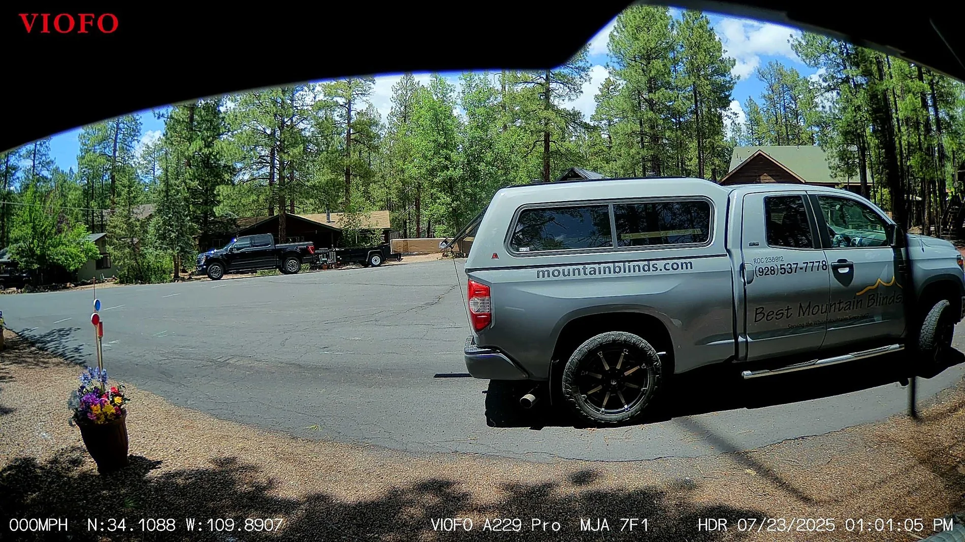

Here’s front and rear mount. Only couple wires high on windshield. Rear made bracket and attached into rear bracket under head liner. Use aluminum bar stock and bent. Had to put toward passenger side so rear wiper would clean camera area. Also couple of pics from dash cam.

How/where did you mount your rear? It’s a shame we have to educate dealers.
I haven’t done the rear yet. I’ll probably just use some sort of adhesive to stick it to the headliner. I want to avoid something permanent if possible
