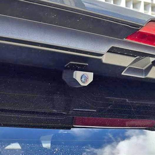

I did the @Wolfbox G900 pro with the rear camera mounted on the exterior just under the liftgate spoiler.
This is the video I watched on how to do the rear camera install on the exterior. Not my video.
Mounted slightly off to the driver-side to be away from the rear wiper, and also slightly towards the rear glass so that there's some coverage from direct sunlight and rain hitting the lens. Unlike the video, I simply used the included double-sided tape for mounting. Eventually I will utilize the screw and locking nut method used in the video.
Removing the spoiler is easy, just open the rear gate and there's 4 round rubber covers with i believe 10mm bolts inside. Remove the 4 bolts and the spoiler lifts up enough (don't have to remove it like the 5th gen video) to run the cable and follow the video instructions on running it through the existing cable bundles and into the cabin.

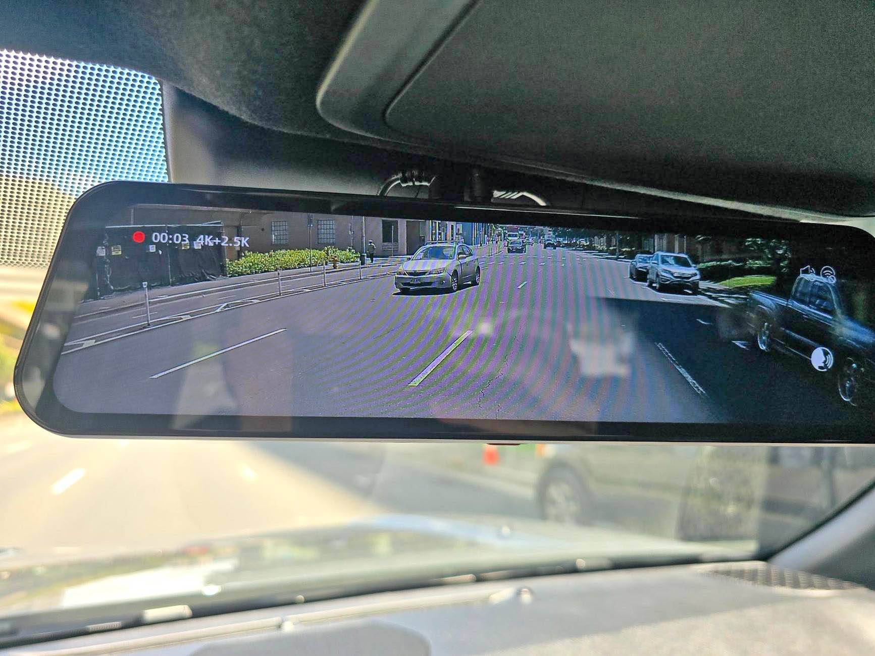

I did the @Wolfbox G900 pro with the rear camera mounted on the exterior just under the liftgate spoiler. There's a 5th gen video on youtube and the 6th gen pretty much followed the same steps. I will say the spoiler on the 6th gen was easier to remove than the 5th gen for running the camera wire.

Very cool. I was thinking about how to do that myself. Would you mind posting a few pics of the setup under the spoiler? Thanks in advance.
2025 2026 4runner 6th gen Rear Camera Dashcam Mount w/ Rear View Mirror Install - DIY Instructions & Pics rear camera dash cam installed 2025 4runner 6th gen 1
2025 2026 4runner 6th gen Rear Camera Dashcam Mount w/ Rear View Mirror Install - DIY Instructions & Pics rear camera dash cam installed 2025 4runner 6th gen 1 copy
2025 2026 4runner 6th gen Rear Camera Dashcam Mount w/ Rear View Mirror Install - DIY Instructions & Pics rear camera dash cam installed 2025 4runner 6th gen 2
I am having a crazy time trying to get the spoiler / back plastic off. Does the black plastic on the outside just pop off with clips? Or do I need to remove the spoiler? Ive gotten a few things to loosen up on the plastic itself but going into the corners feels like its gonna snap.
Also I am assuming you mean the 4 bolts on the spoiler under the rubber covers and then the other bolts? Tried just doing the 4 under the covers and that thing is still on there lol.
Thanks in advance! Trying this install as we speak.
The black plastic piece just under the rear wiper pops right off. Start by pulling down (gently) with the lift gate closed, the right side of the piece just under the wiper motor.
For the spoiler, after you remove the 4 bolts located under the black rubber grommets, it give it enough opening to run the cable through. You don't have to remove it in order to run the cabling.
