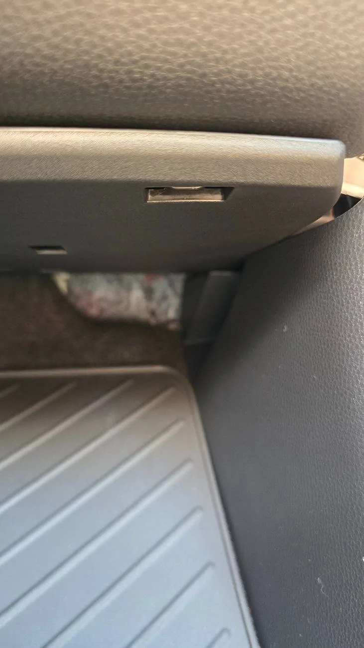

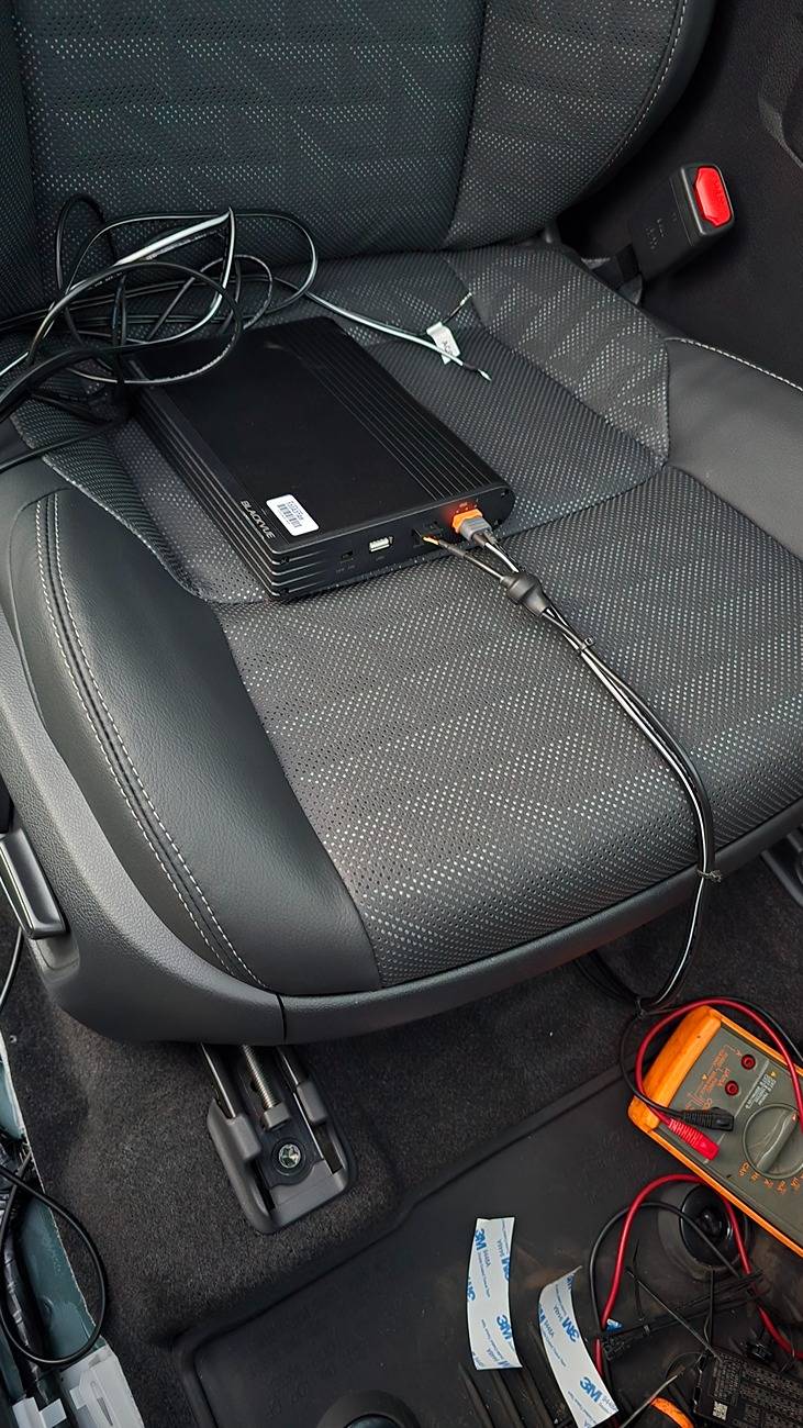

Blackvue Ultra Battery B-130A installed under passenger front seat. Velcro which came with unit was used but only hook side was attached to grab to carpet.
2025 4runner 6th gen Blackvue DR970X LTE Plus Dash Cam + Blackvue Battery install. Rear cam bracket from amazon for 5th gen. - DIY instructions & photos 1000017305
2025 4runner 6th gen Blackvue DR970X LTE Plus Dash Cam + Blackvue Battery install. Rear cam bracket from amazon for 5th gen. - DIY instructions & photos 1000017306

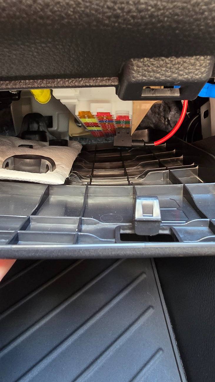

Battery was hardwired to passenger side fuse box with fuse tap to P/Outlet fuse. Fuse box cover can not go back on due to tap but the trim panel under dash can go back.

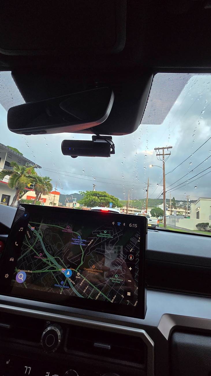

Front camera was mounted and power wire run down passenger A pillar to Battery pack.

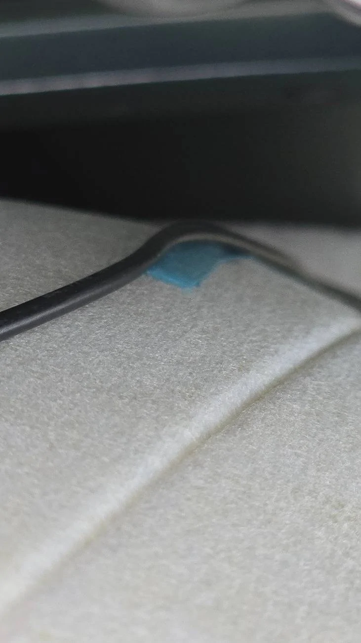

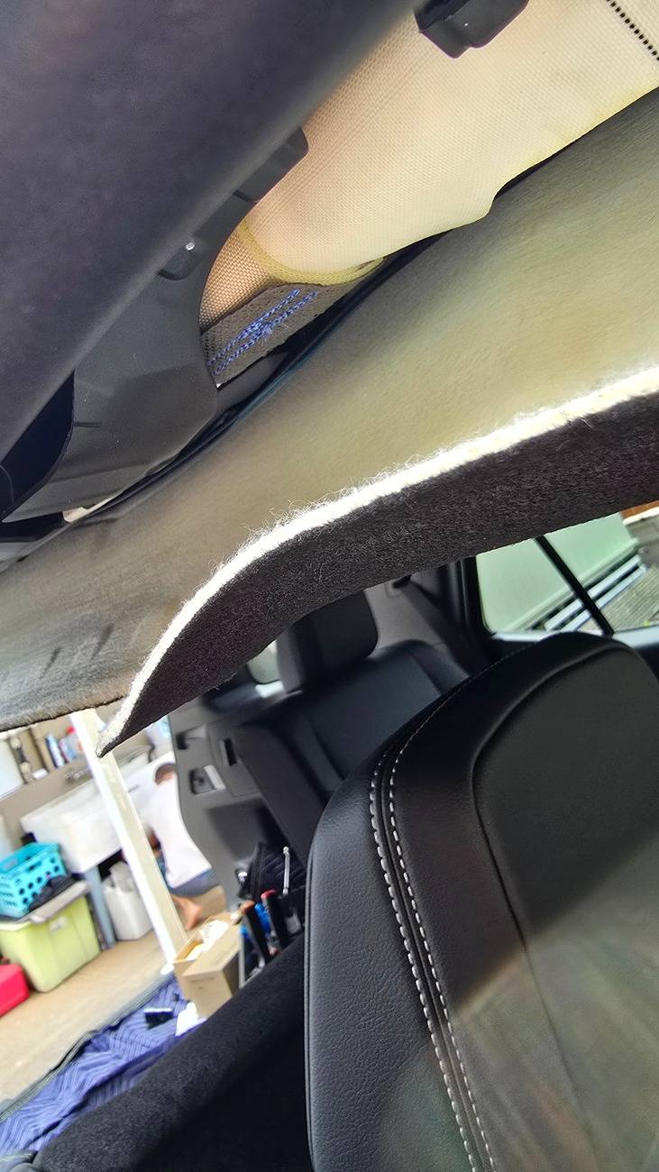

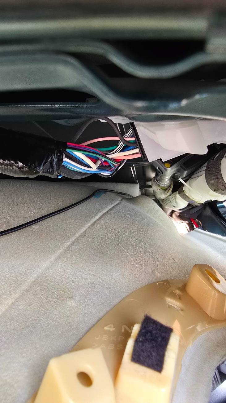

Headliner was lowered on passenger side from front to rear and wire was run on headliner with an existing harness. You CAN NOT just stuff wire between headliner after pulling out rubber door seals as there are side curtain airbags. There is what appears to be a double sided tape run on headliner which factory harness is secured to. It is light blue in color and the dashcam rear wire can be stuck onto it also with the factory harness. I have pics trying to show what I'm talking about. If you install as I did you will know what I'm talking about.

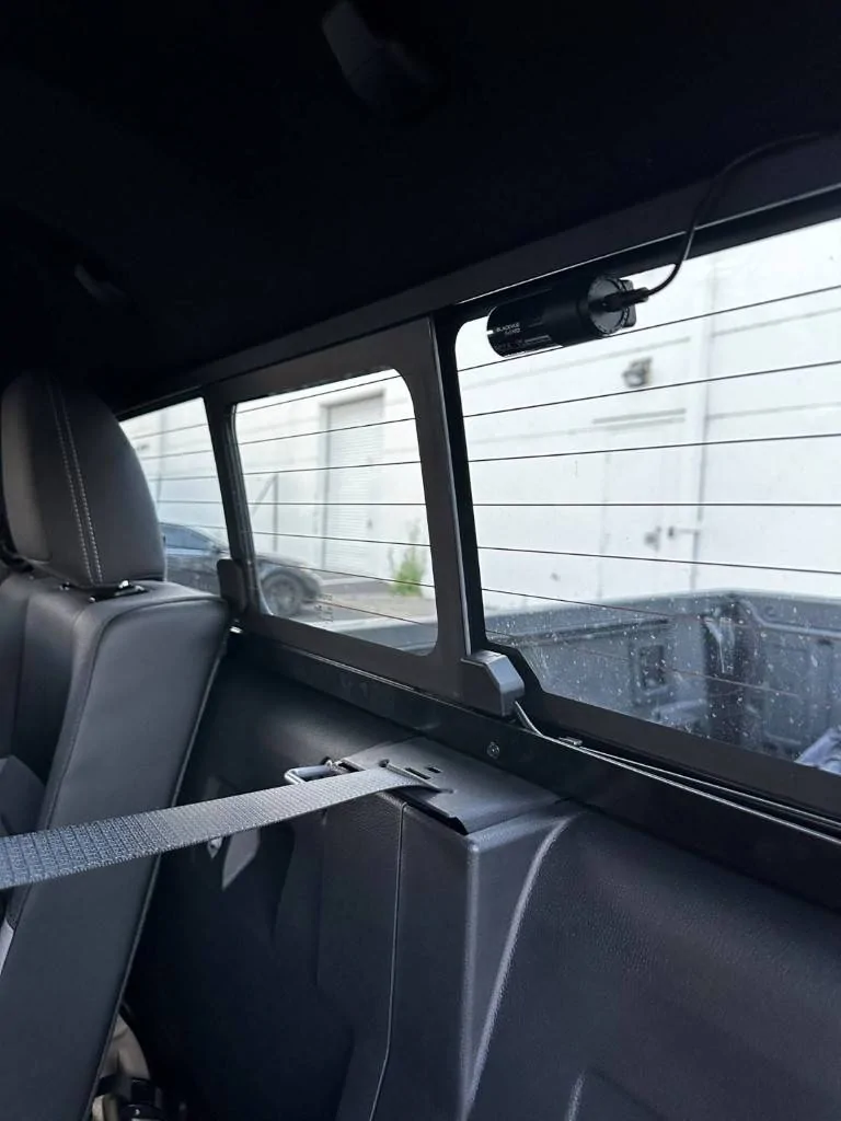

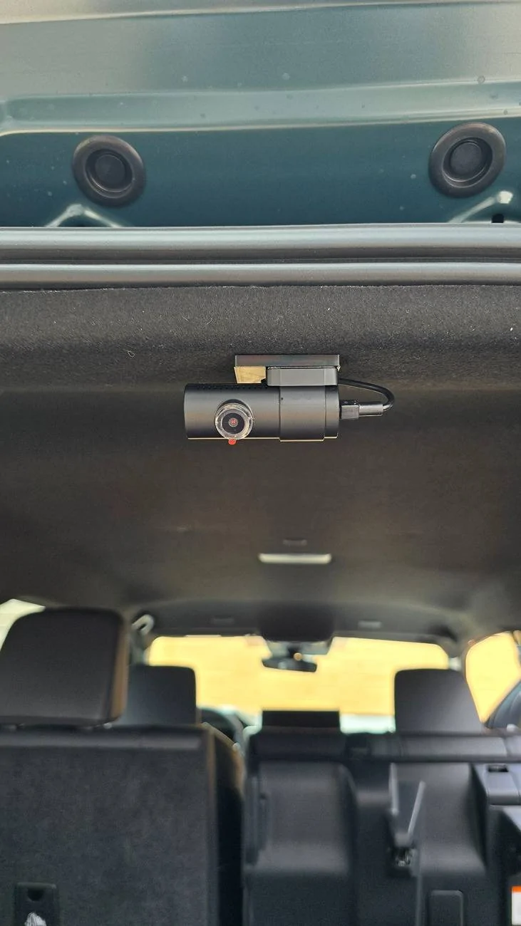

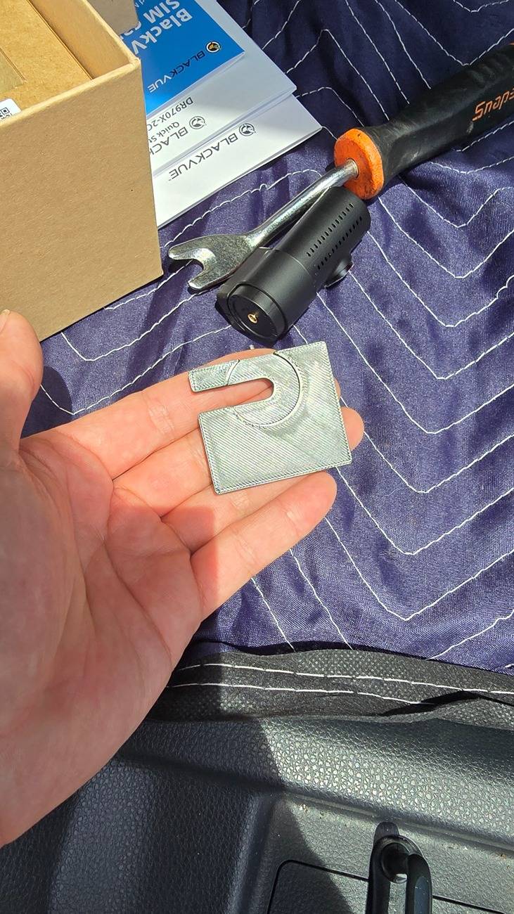

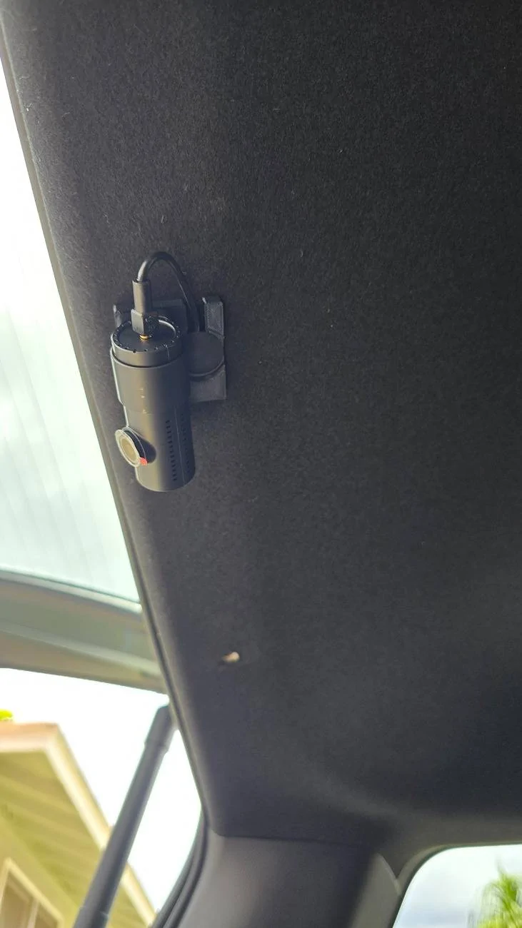

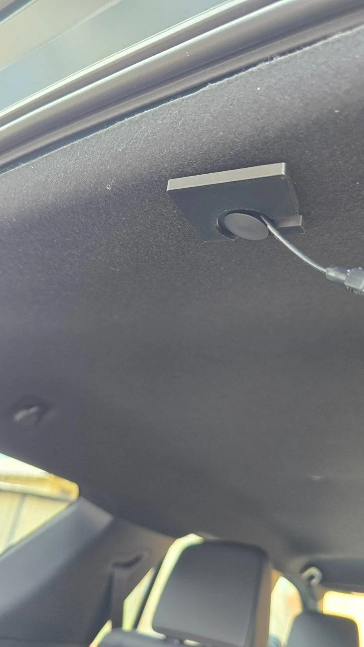

Wire can exit out of hole for pushclip in middle of headliner by hatch area as this is where you will secure the bracket for rear camera and push pushclip in to secure. Everything else is about adjusting angles to your liking. As some have mentioned its best to just get a tmobile data only sim 30g for $10 a month as the blackvue data is ridiculous with 1g for $10 a month.

Great work nice write up, how long can you get with parking mode? Also the fuse tap fits?? I gotta retry mines cause I was sure it doesnt

Looks great! How solid is the rear mount? Any shaking or instability?
Parking mode depends on your settings. I have mines on motion detection and I get around 18 hrs of coverage before the battery is depleted. I'm sure you will get more if you adjust the quality down and the sensitivity down.
The rear mount is solid and there is no shaking. The only problem is that it can turn so if it gets hit it will turn. I just hit it with my head yesterday and it turned when went into the rear.

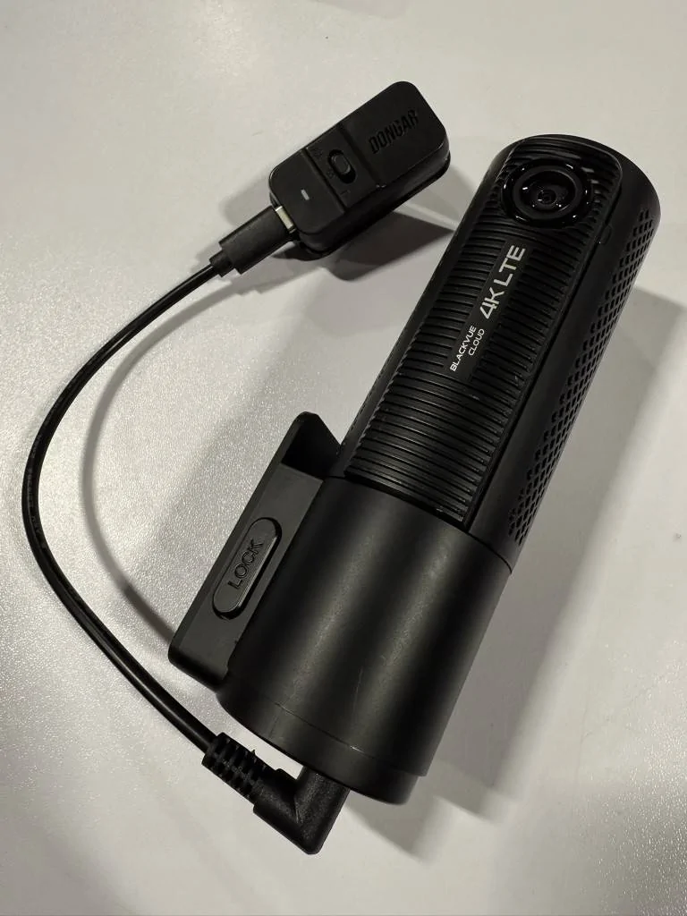

Nicely done. I was running the DR970X on the '24 Tacoma rearview mirror when I first designed our PRO dashcam power adapter. I can't remember exactly but we got maybe 2-3 days of recording powering directly off the truck's battery before low voltage kicks-in, albeit I don't use LTE and I use non-default parking mode settings on the 970.
Prototype stage about a year ago:
2025 4runner 6th gen Blackvue DR970X LTE Plus Dash Cam + Blackvue Battery install. Rear cam bracket from amazon for 5th gen. - DIY instructions & photos 1713418237530 (Medium)
Production PRO adapter with our USB-to-12VDC barrel jack converter cable:
2025 4runner 6th gen Blackvue DR970X LTE Plus Dash Cam + Blackvue Battery install. Rear cam bracket from amazon for 5th gen. - DIY instructions & photos IMG_1972 (Medium)
Rear mount:
2025 4runner 6th gen Blackvue DR970X LTE Plus Dash Cam + Blackvue Battery install. Rear cam bracket from amazon for 5th gen. - DIY instructions & photos 1713418256180 (Medium)
