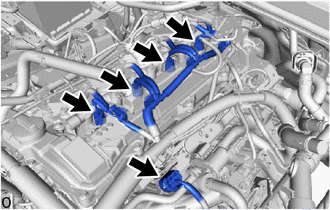

BONUS INFO
If you want to go long in the interval (owner manual), there is a good test any shade tree mechanic can easily do. Compression test. This really tells a lot about how the cylinders and rings are doing.
11. INSPECT COMPRESSION
NOTICE:
Keep the spark plug holes free of foreign matter when measuring the compression pressure.
Pre-procedure
(a) Warm up the engine, then stop it.
(b) Check for DTCs.
Powertrain > Engine > Trouble Codes
(c) Remove the 4 spark plugs.
(d) Disconnect the 4 direct fuel injector assembly connectors and No. 5 engine wire connector.

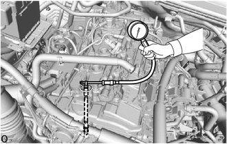

Procedure
(e) Check the cylinder compression pressure.
(1) Insert a compression gauge into the spark plug hole.
(2) While cranking the engine, measure the compression pressure.
Standard Compression Pressure
Item​
Minimum Compression Pressure​
Specified Condition​
Result​
Cylinder 1​
1000 kPa
10.2 kgf/cm 2
145 psi​
1200 kPa
12.2 kgf/cm 2
174 psi​
kPa
kgf/cm2
psi​
Cylinder 2​
1000 kPa
10.2 kgf/cm 2
145 psi​
1200 kPa
12.2 kgf/cm 2
174 psi​
kPa
kgf/cm2
psi​
Cylinder 3​
1000 kPa
10.2 kgf/cm 2
145 psi​
1200 kPa
12.2 kgf/cm 2
174 psi​
kPa
kgf/cm2
psi​
Cylinder 4​
1000 kPa
10.2 kgf/cm 2
145 psi​
1200 kPa
12.2 kgf/cm 2
174 psi​
kPa
kgf/cm2
psi​
Pressure Difference between Each Cylinder​
200 kPa or less
2.0 kgf/cm 2 or less
29 psi or less​
kPa
kgf/cm2
psi​
NOTICE:
  • Always use a fully charged battery to obtain an engine speed of 250 rpm or more.
  • Measure the compression pressure as quickly as possible.
2025 2026 4runner 6th gen Best Synthetic Oil for Turbo Charged Engines A568821
(f) If the cylinder compression pressure is low, pour a small amount of engine oil into the cylinder and measure the compression again.
HINT:
  • If the compression increases, the piston rings and cylinder may be worn or damaged.
  • If no compression changes, there may be a defect of valve or cylinder head.
