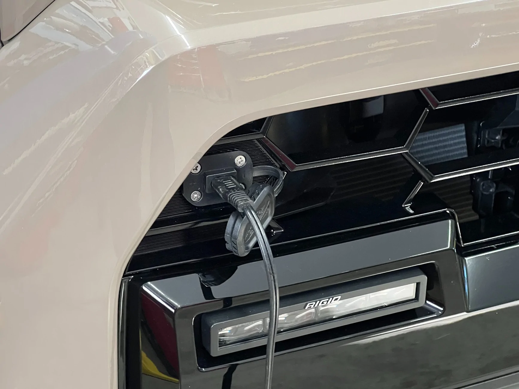

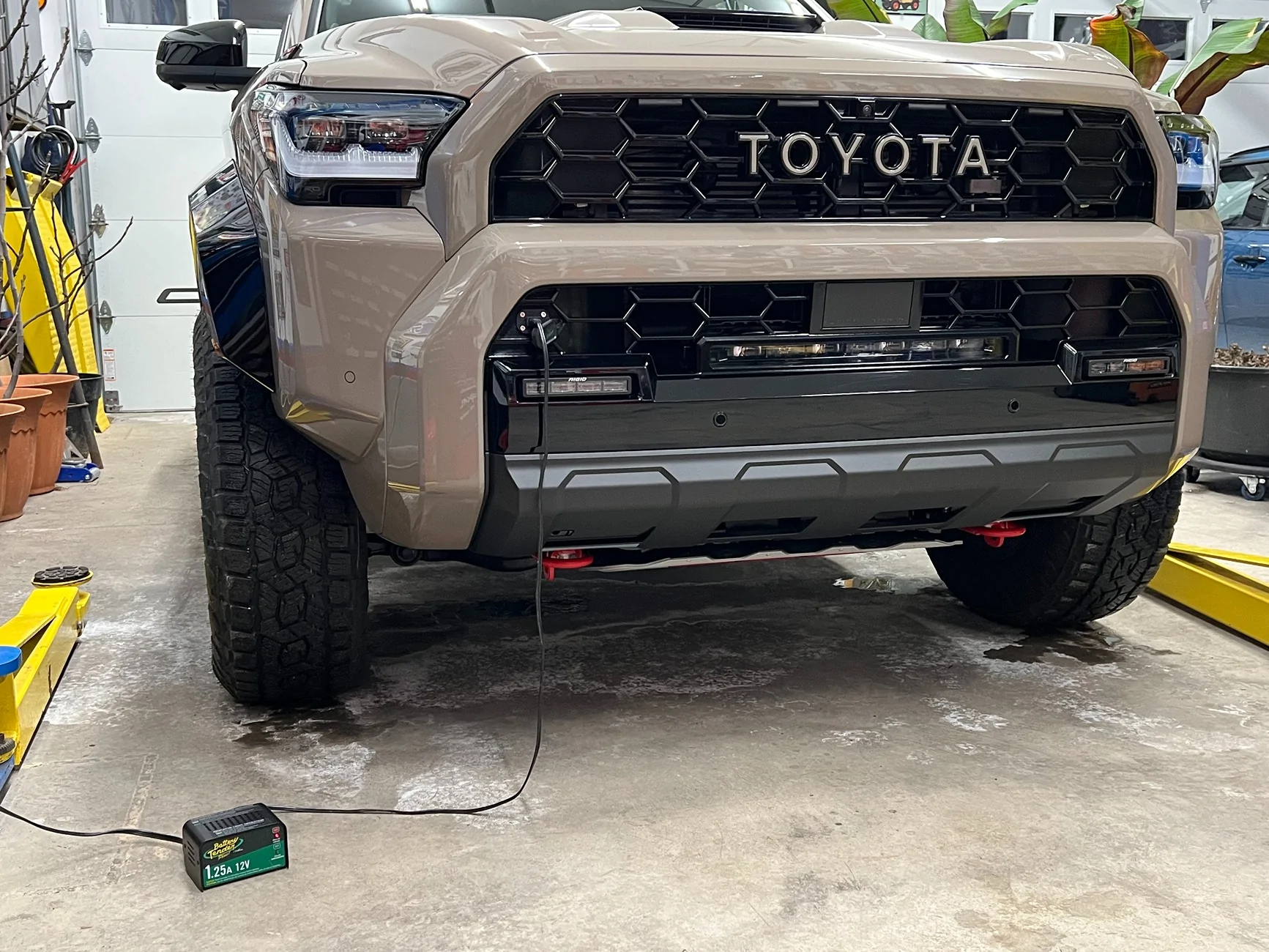

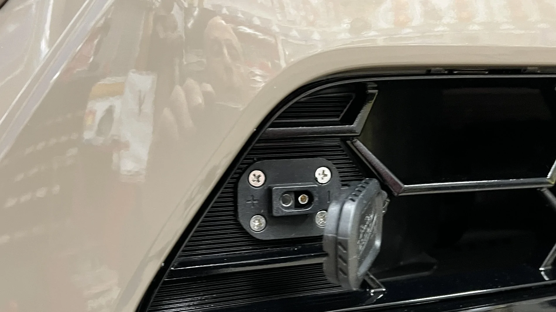

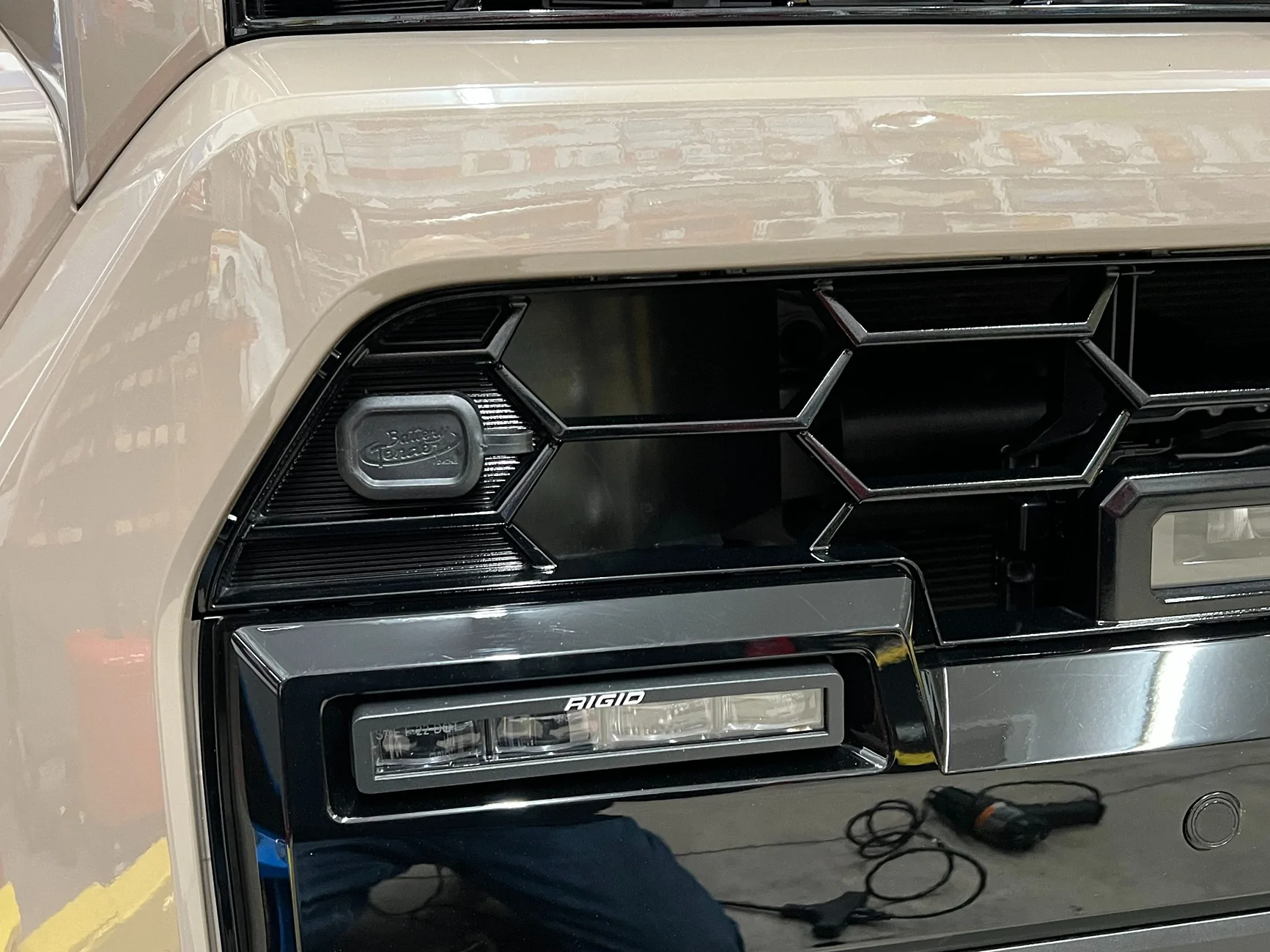

On occasion my TRD PRO will not be driven on a daily basis and could be sitting for a week or two. I like to keep a battery tender on my 12V battery during that time. To avoid having to open the hood and remove the fuse panel cover to install the Battery Tender, I installed an external Battery Tender receptical.

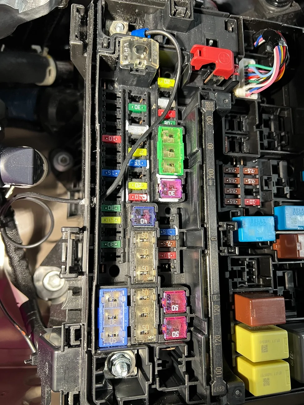

I'll have to get the model number off the Tender tomorrow but The connections I think are all the same on all of the Tenders I have. I connected the 16 guage positive wire to the battery terminal in the underhood passenger side fuse panel. I drilled a small hole in the side of the panel to allow the wire access into the panel. I connected the negative ground wire with a bolt to a threaded hole on the inner fender body panel in the engine compartment.
