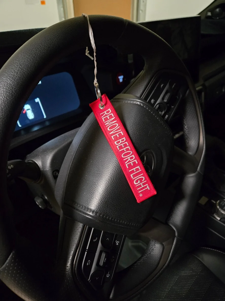

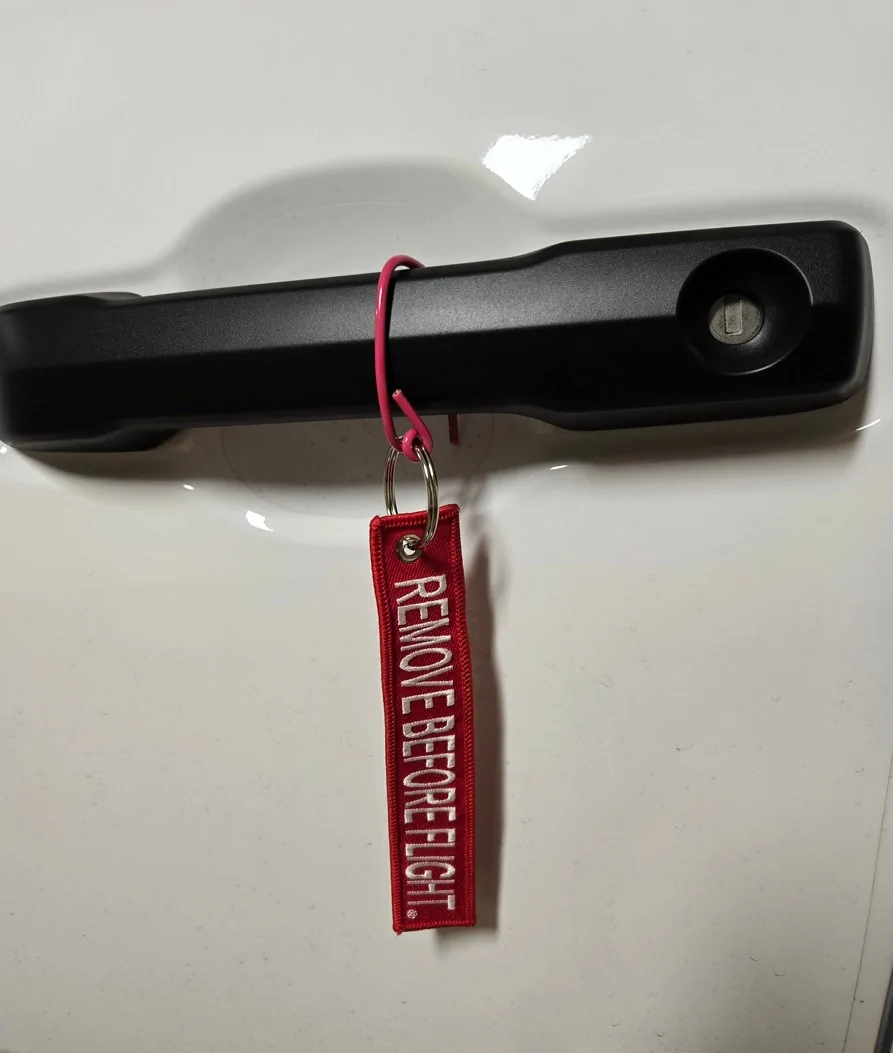

I too have had good battery life in my vehicles using the Tender. What you have is a good setup too. To keep me from driving off with the Tender attached I put a clothes-pin on the front drivers seat when the tender is connected. When I open my door I take the clothes-pin off the seat and disconnect the tender wire and attach the clothes-pin to it. So the next time I plug the tender in, I put the clothes-pin back on the front seat. It works for me!
My reminder flags . . .
2025 2026 4runner 6th gen Battery Tender external receptacle install Reminder 1
2025 2026 4runner 6th gen Battery Tender external receptacle install Reminder 2

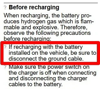

Does everyone disconnect the Negative ground battery cable before connecting a maintainer ?
2025 2026 4runner 6th gen Battery Tender external receptacle install Recharging
