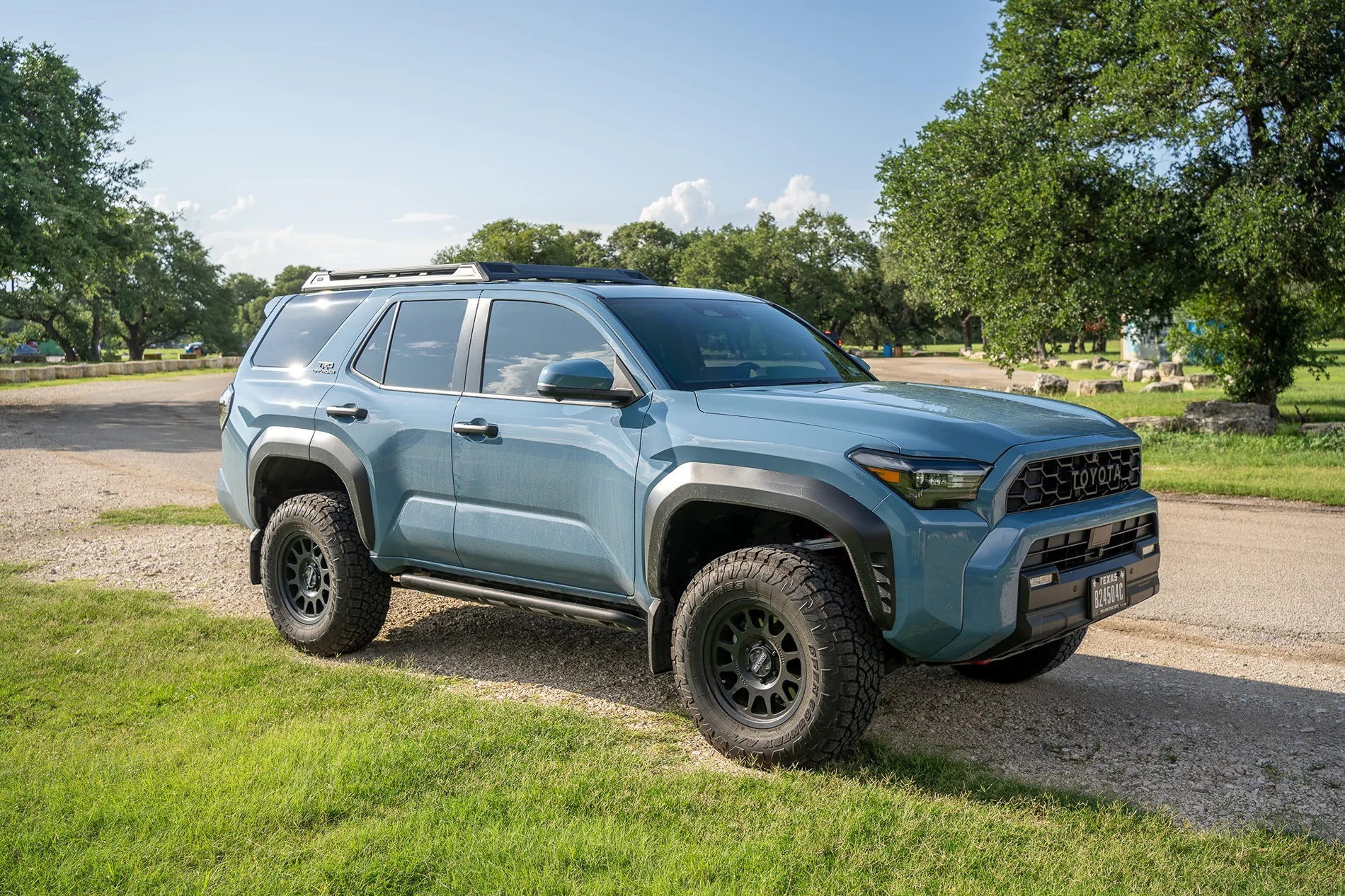

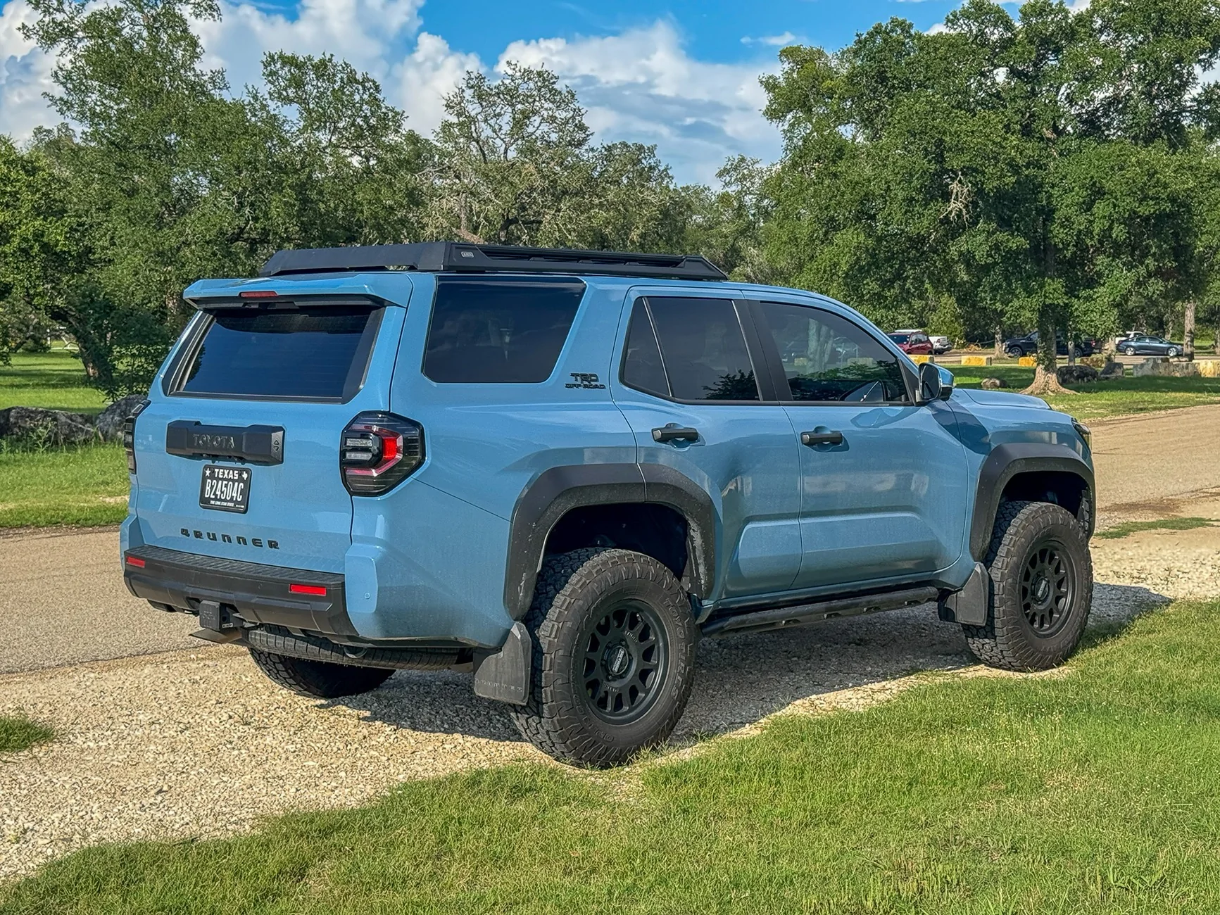

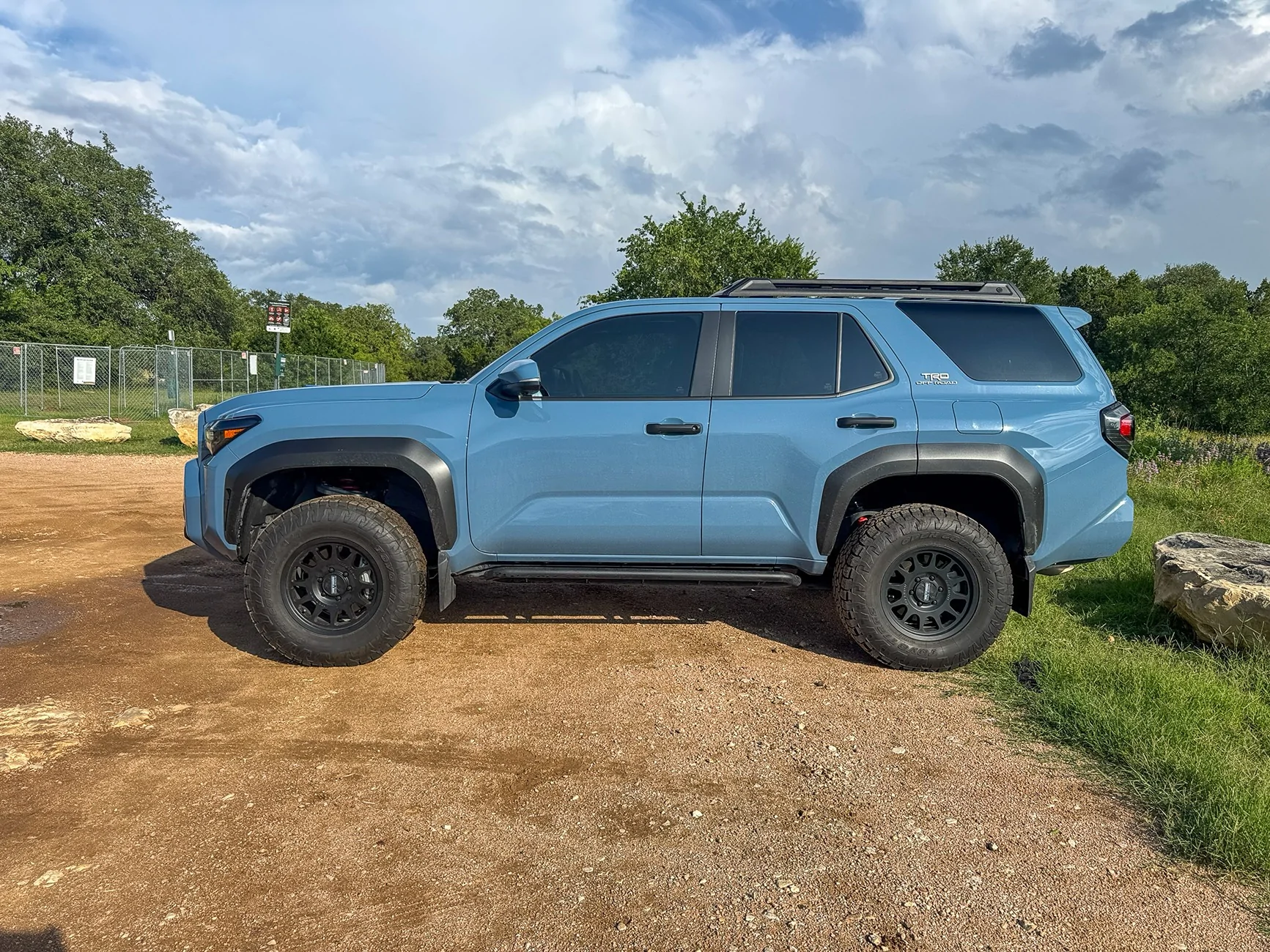

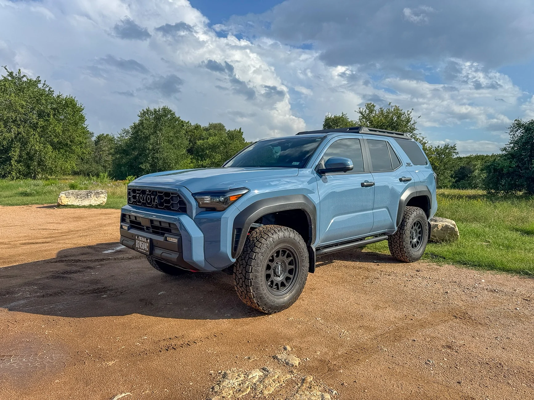

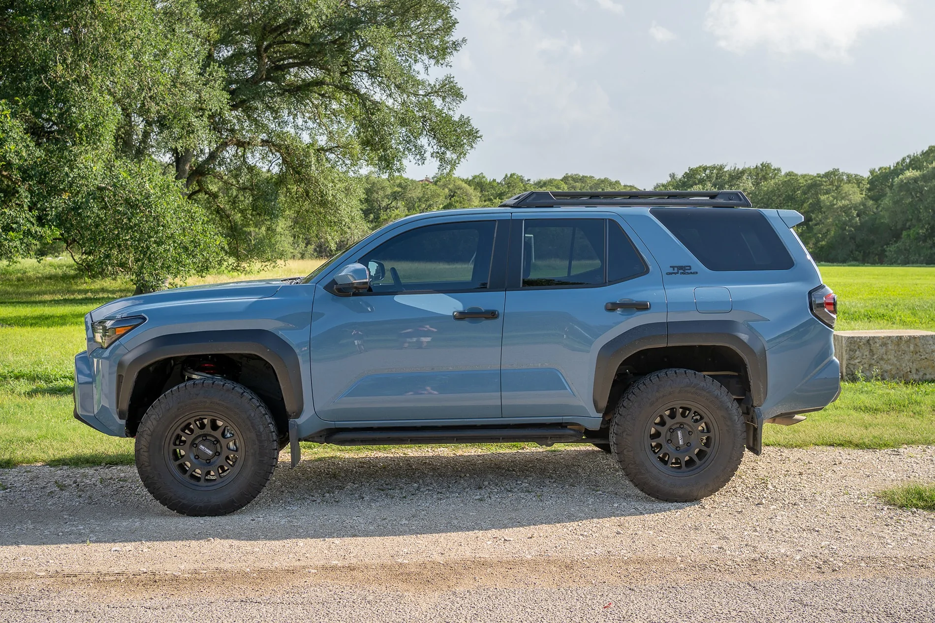

Some more photos. Also noticed today that the brakes feel slightly spongey. Could be because its 1000% humidity in Austin right now, or maybe it's psychological or because of minor nose dive from the lift. Going to keep an eye on it and climb under the truck and see if the brake line got pulled anywhere...
