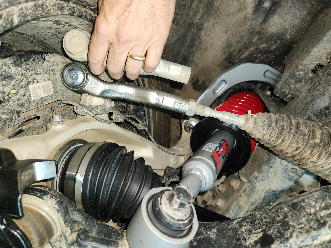

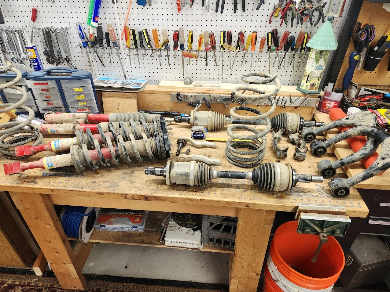

Lift completed! Will provide detailed measurement comparison and resultant ground clearance numbers at some point but for now, here is a cluttered view of the take off parts.
2025 2026 4runner 6th gen Any updates on OEM 2.5" TRD Suspension Lift? 20260621_144745
Tie rod end is a just a bit longer (BTW axel and rear springs are notably longer... will cover in future post.)

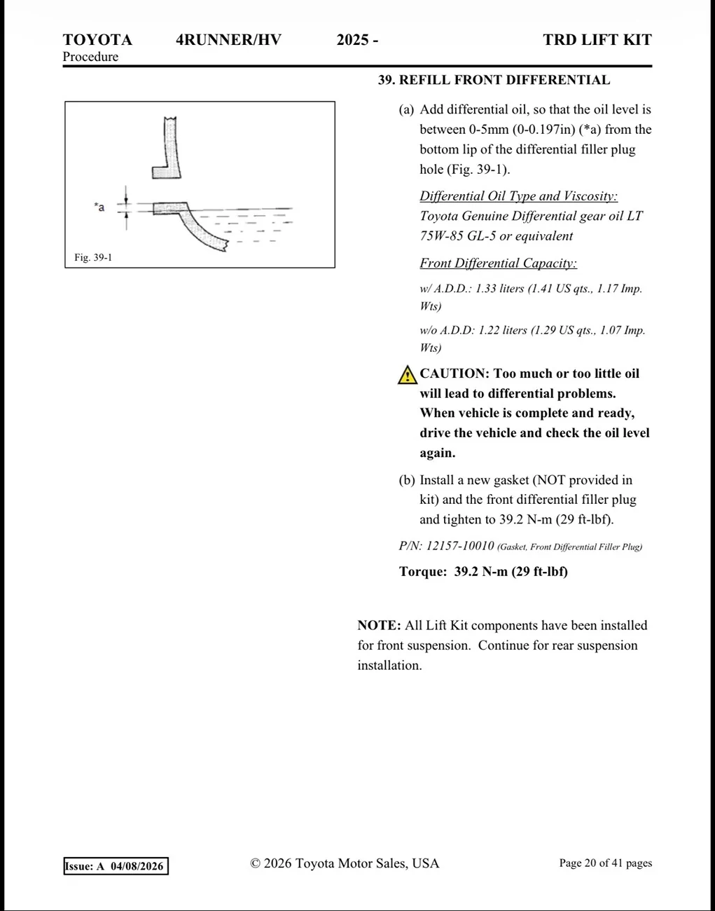

Just put my order in for the lift. Questions for yall. Did you need to refill or top off the diff oil after replacing the axles?
You're talking about the front CV axles? No, the differential fluid is completely unaffected. You will not touch any fluid at all.
Check out the installation instructions that were posted earlier in the thread. The diffs are not touched IIRC

thanks guys for helping! I read the instruction manual and found out you do need to refill the diff fluid. The front axles goes into the front diff. That’s why.
But all good! Got new fluid! And it’s done!
Love it! Feels very nice!!
You had to "refill" the differential? Surprising.

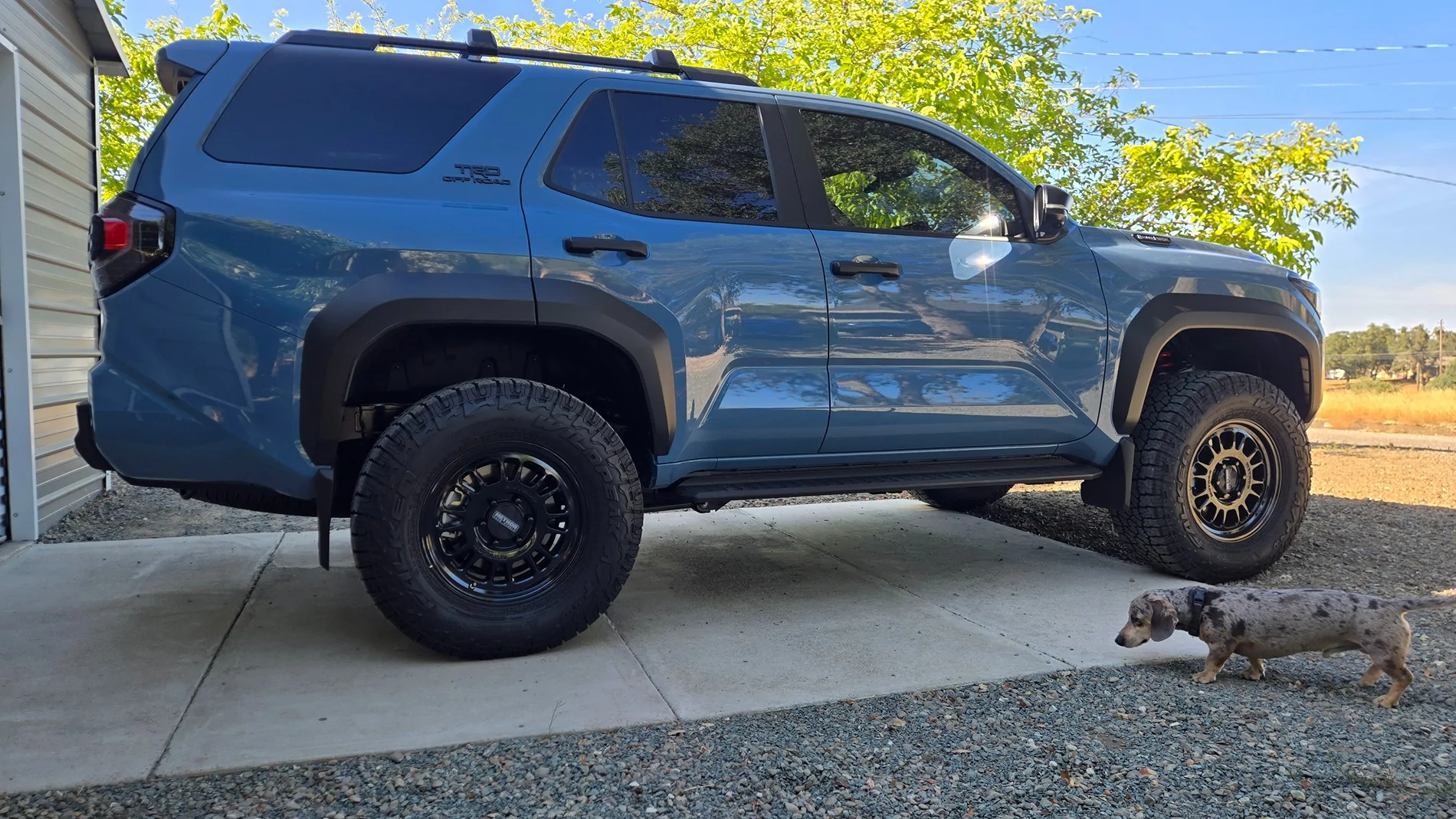

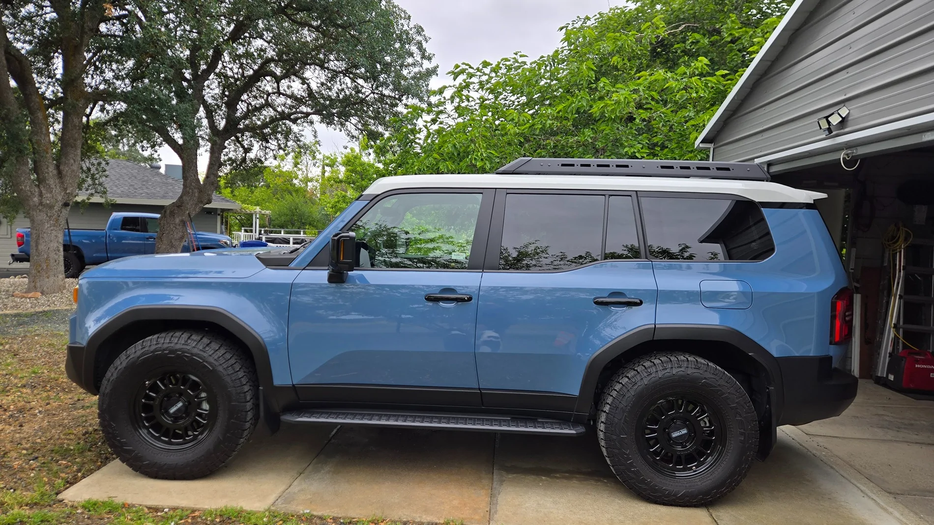

Just got the TRD 2.5 inch lift completed 5k out the door. The labor was 1900 with the kit running the typical 2999. I found the lift on sale from a dealership in another state for 2490 but after the shipping was added at 470 it ended up not being worth the risk of the shipping. Didn't want to worry about damage and the hassle of dealing with any returns. Threw the methods and the 285/70/18 Falken wildpeak At's on that I had on the 25 Land cruiser and I do have some minor rubbing. The LC250 had the wheels and tires on it stock with zero rubbing and that was on full flex off road. So the wheel clearance on the Land cruiser is much better even with a 2.5 inch lift on the 4runner.
The height is 39 1/4" in the rear and 39 3/4" in the front. Was hoping it would settle but after 200 miles it's remaining the same on the tape measure. Not a big fan of the stinkbug look but it rides nice. I figure after a front bumper and winch that number will then come down.
