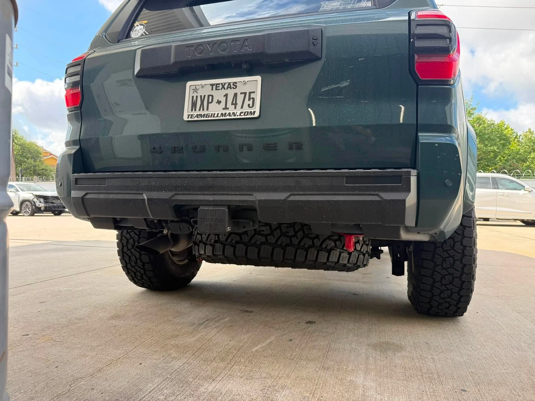

The real question. Spare tire?
It'll fit. I was waiting to test these before buying one. Some dude on facebook posted a pic. It def hangs low but itll fit.

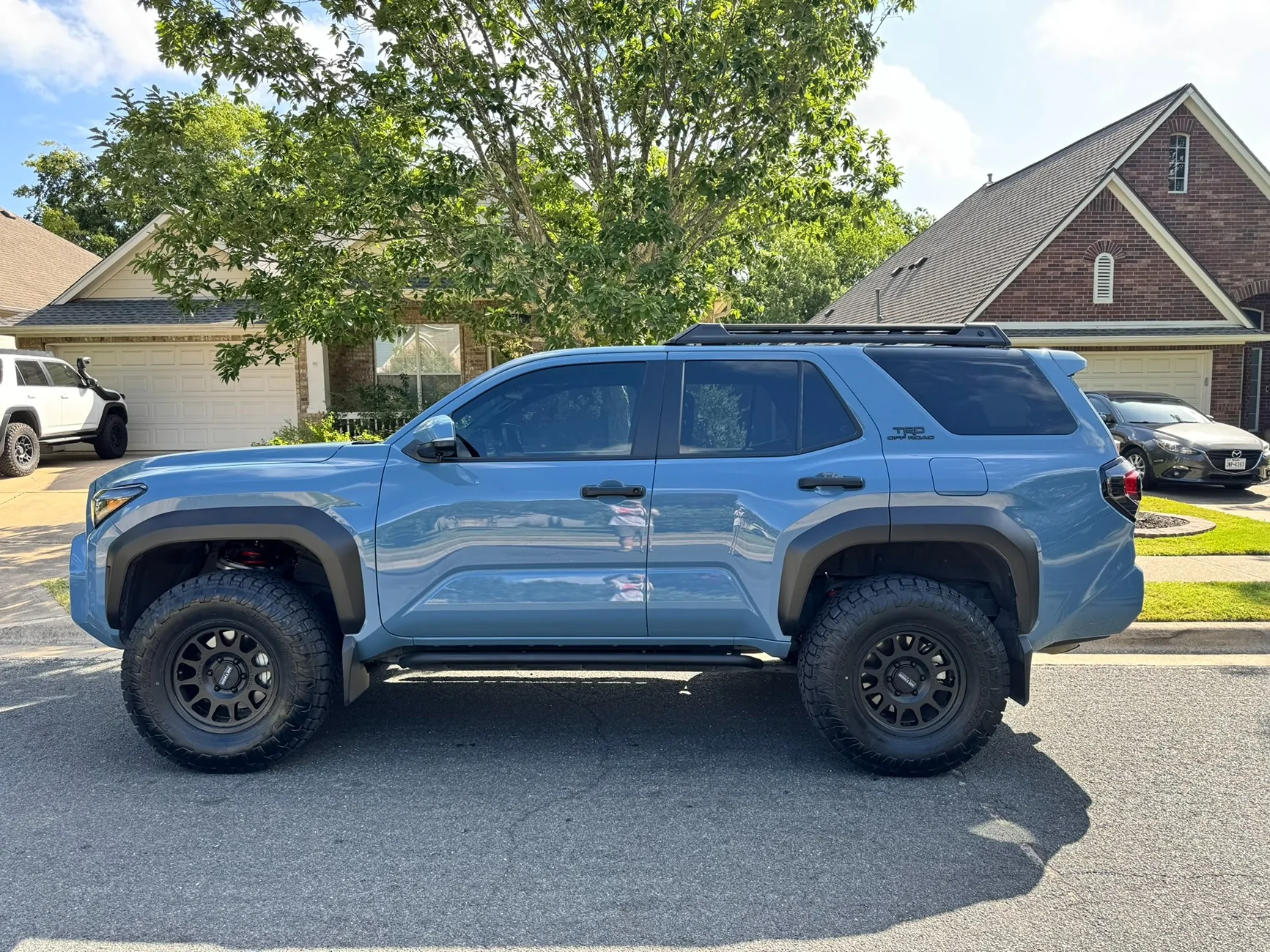

285/75r17 Toyo AT3 installed today. Looks muuuuch better with this suspension setup. I did notice some light rubbing at full lock reversing out of my driveway. Will get some better pics and report back on fitment after I get a chance to drive it some more.
Looks fantastic!
The rubbing must be from the mudflaps because my setup doesn’t rub and I’m not running flaps. Either way, love the way a 285/75R17 fills out the wheel well, truck looks great!

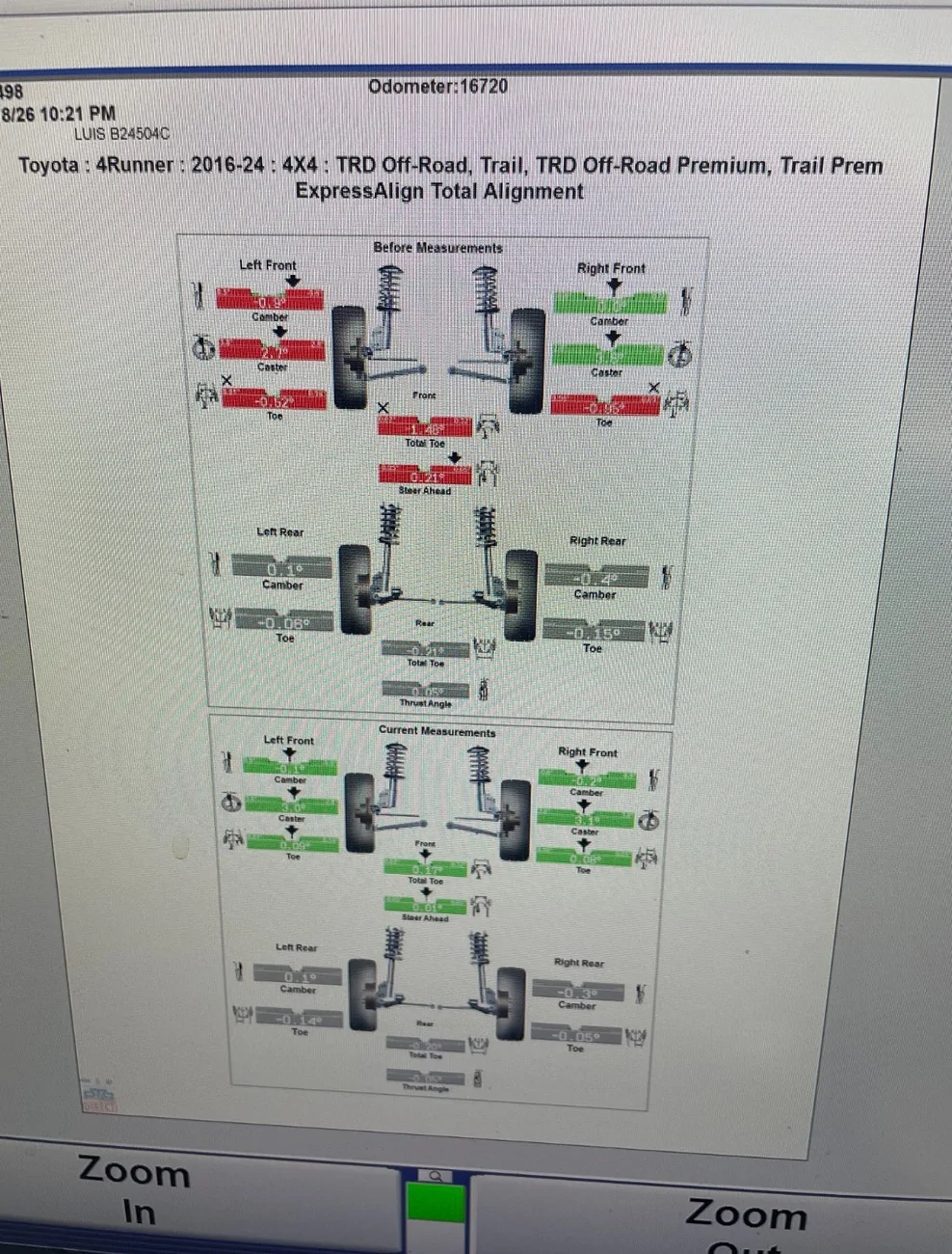

Can anyone share their alignment spec after the lift? This is what I have
Front:
0.0 (L) -0.1 (R) : Camber
2.7 (L) 3.0 (R) : Caster
0.04 (L) 0.04 (R) : Toe
Rear:
-0.4 (L) -0.1 (R) : Camber
0.02 (L) -0.12 (R) : Toe
-0.10 : Total toe
0.07 : Thrust angle
is my rear right toe cooked?
Front:
Rear:
-0.10 : Total toe
0.07 : Thrust angle

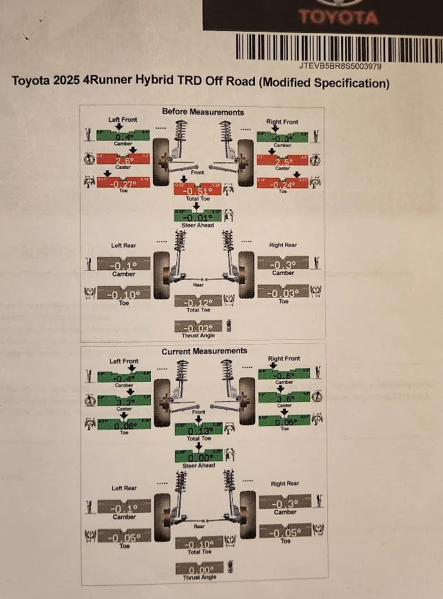

I literally just took this photo of mine yesterday (lift was 4 weeks ago):
2025 2026 4runner 6th gen Any updates on OEM 2.5" TRD Suspension Lift? 20260717_063641-EDIT
I really don't understand the numbers, but I would observe that your right rear toe is not too different than my left rear. OTOH my thrust angle is spot on zero, yours a bit off (but just a small bit and I don't know what is too much).
I am experiencing left front tire rub after the lift (with my 35s) that leads me to believe my caster might have been overdone slightly - anyone know if it can be adjusted back a degree or so without wrecking the overall alignment - and maybe gaining a fraction of an inch of clearance in front of the tire? (And please educate me if this is a dumb question.)

No. Thrust angle is 0.07, which is tiny. Rear toe isn't adjustable anyway.
I can't see your sheet (on my phone) but technically, less positive caster may provide the clearance. Altering that will also affect the rest of the alignment, definitely on that side. The shop should be check my the rear numbers in order to inform the front alignment and ensure the vehicle tracks straight.
