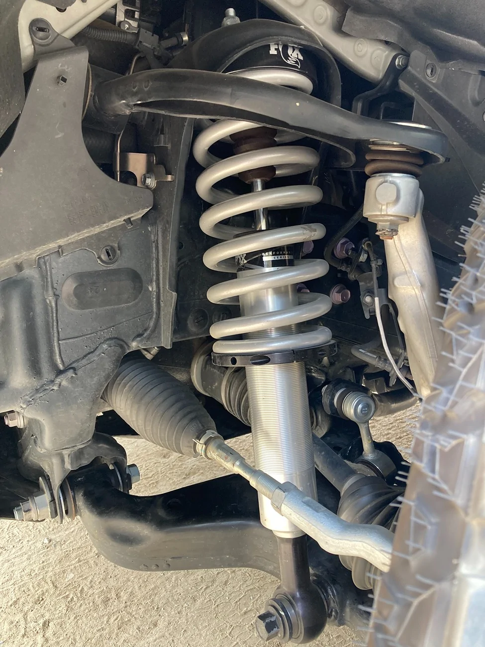

Now, The ride is no better, if not, worse than the factory external reservior Bilstiens, Front & rear. So, just letting you know if you are thinking of going this route.
The front lifted nearly 2-3/4 inches which is great and I also installed toytec 2" lift springs in the rear. The rear springs are noisy and I think its because the coil isnt flat wound on the top like the factory springs.
Regarding the coilovers, I`m thinking the topout bushing Fox installed on the piston shaft is limiting the travel to like 4 inches
Anyway, be cautious if your thinking about the 2.5 Fox Performance series

Vehicle: 2025 ORP , 275 70 18`s GY Wrangler ultra terrains E load @ 34-35 PSI

could it be possible that the front springs have too much preload? The preload collar looks like its set pretty high up for the 2.75in of front lift. Could try moving it down a bit, i think a little bit of rake is good
yes it absolutely could and I do have a fox wrench to adjust the preload collar. Really didn’t want to lose the front height though.
I may try it however.
