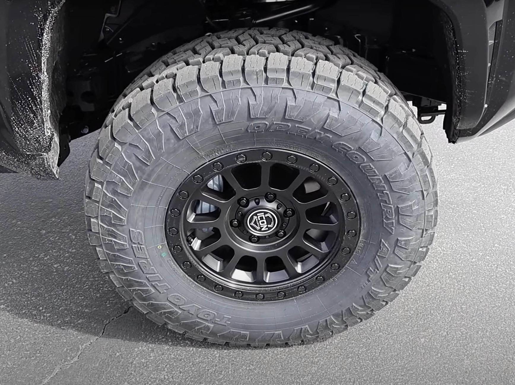

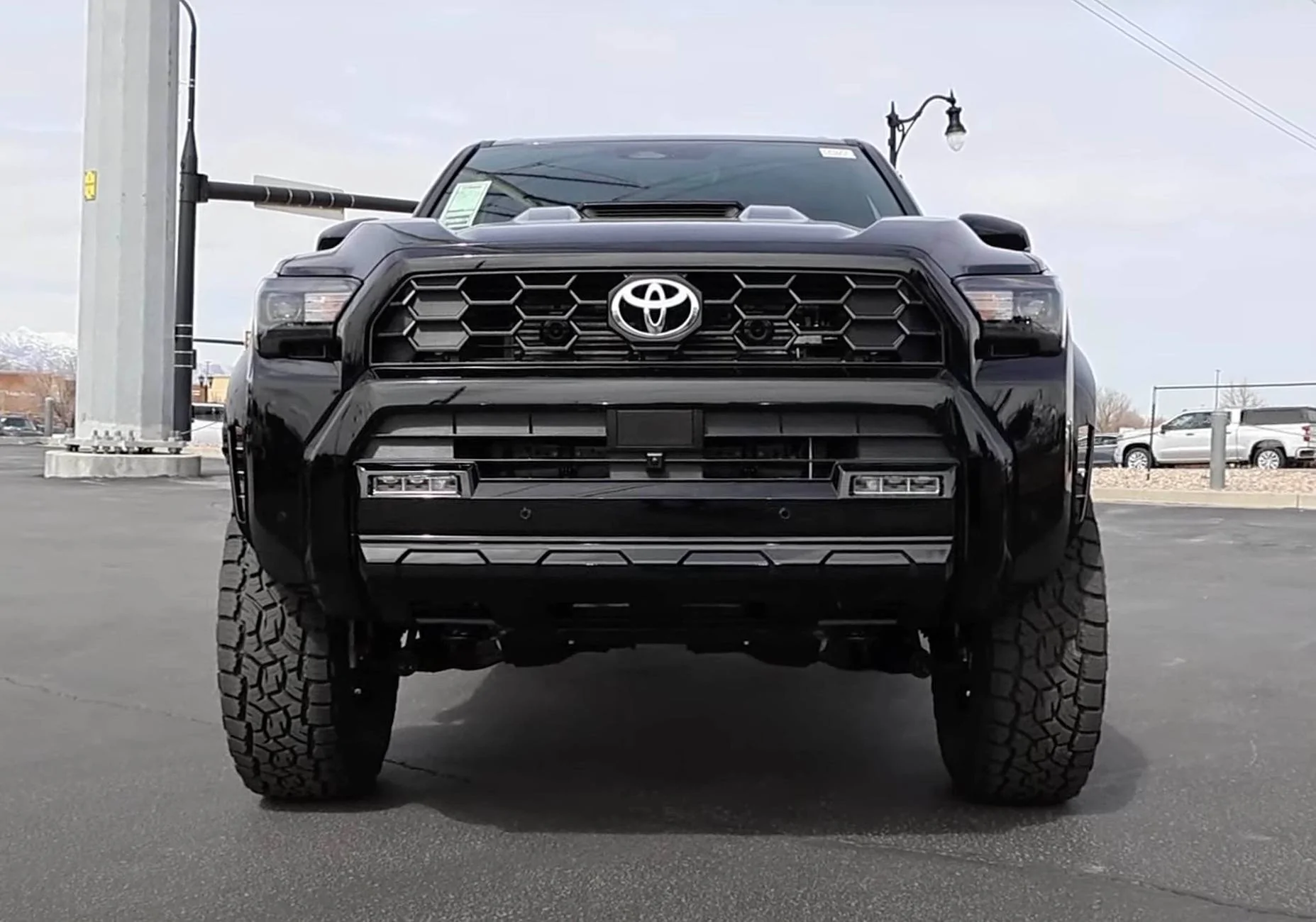

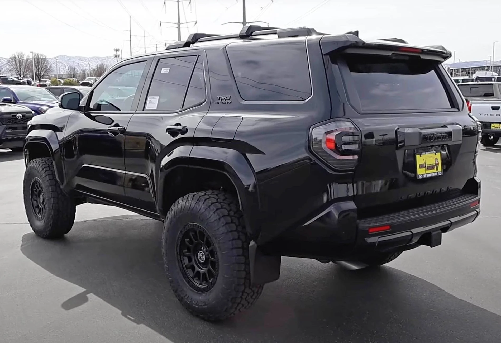

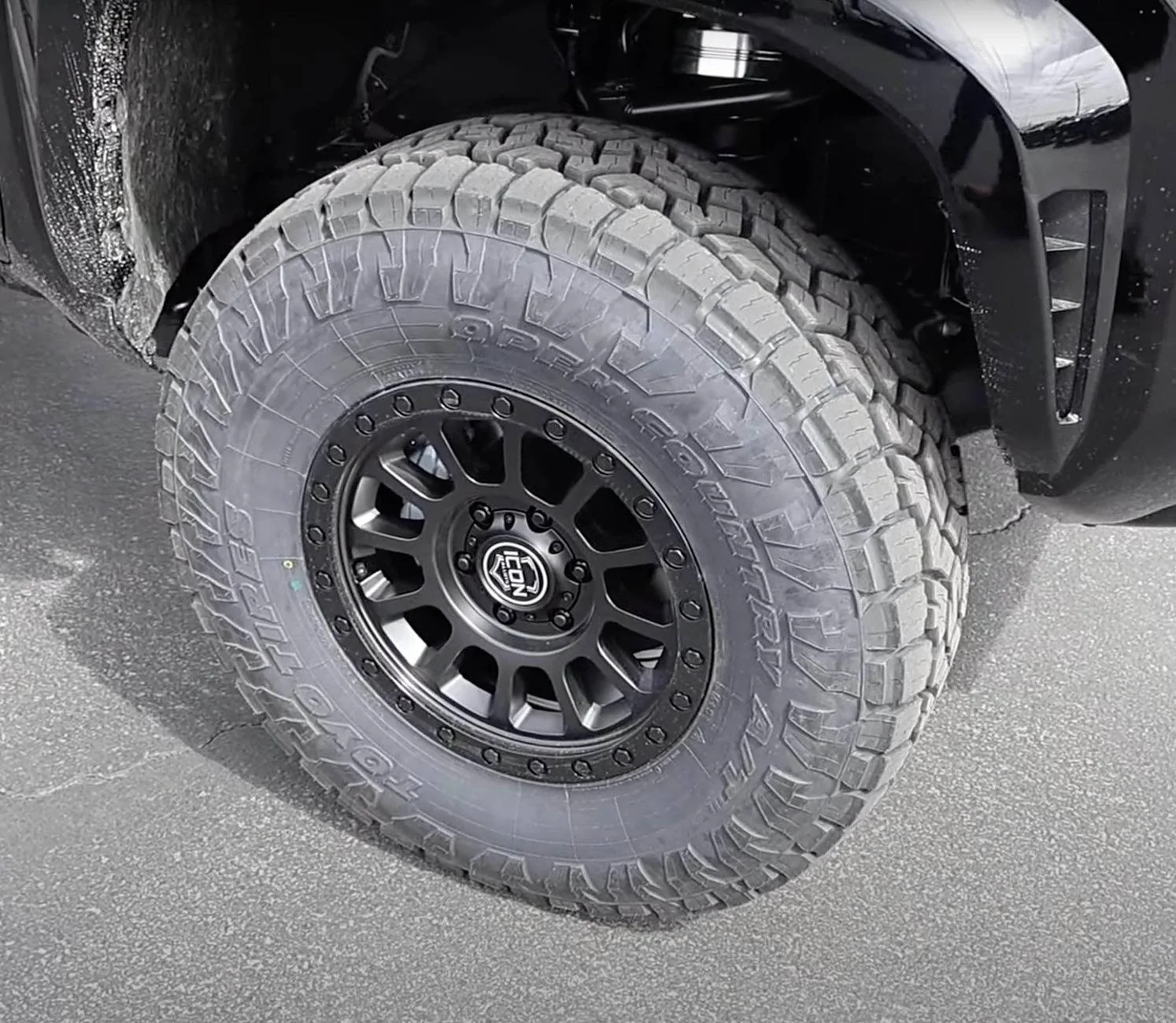

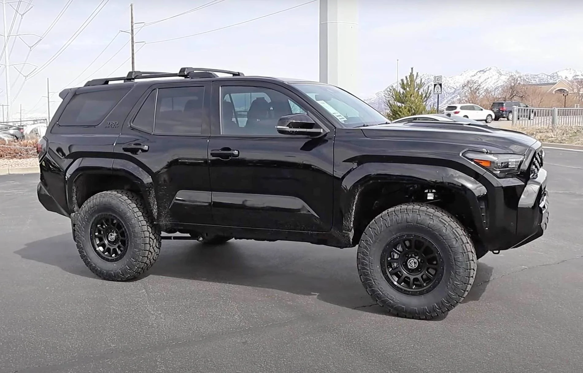

Black TRD Sport 2025 4Runner build with premium tail lights which looks so good on black. Mods list -
3" spacer lift
17" Icon Alloys (Hulse)
35" tires (35x12.50R17) - Toyo Open Country A/T III (AT3)
OEM Premium Tail Lights

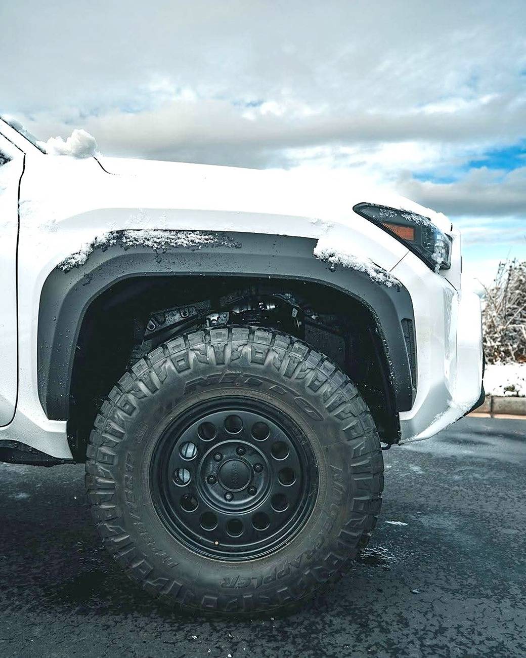

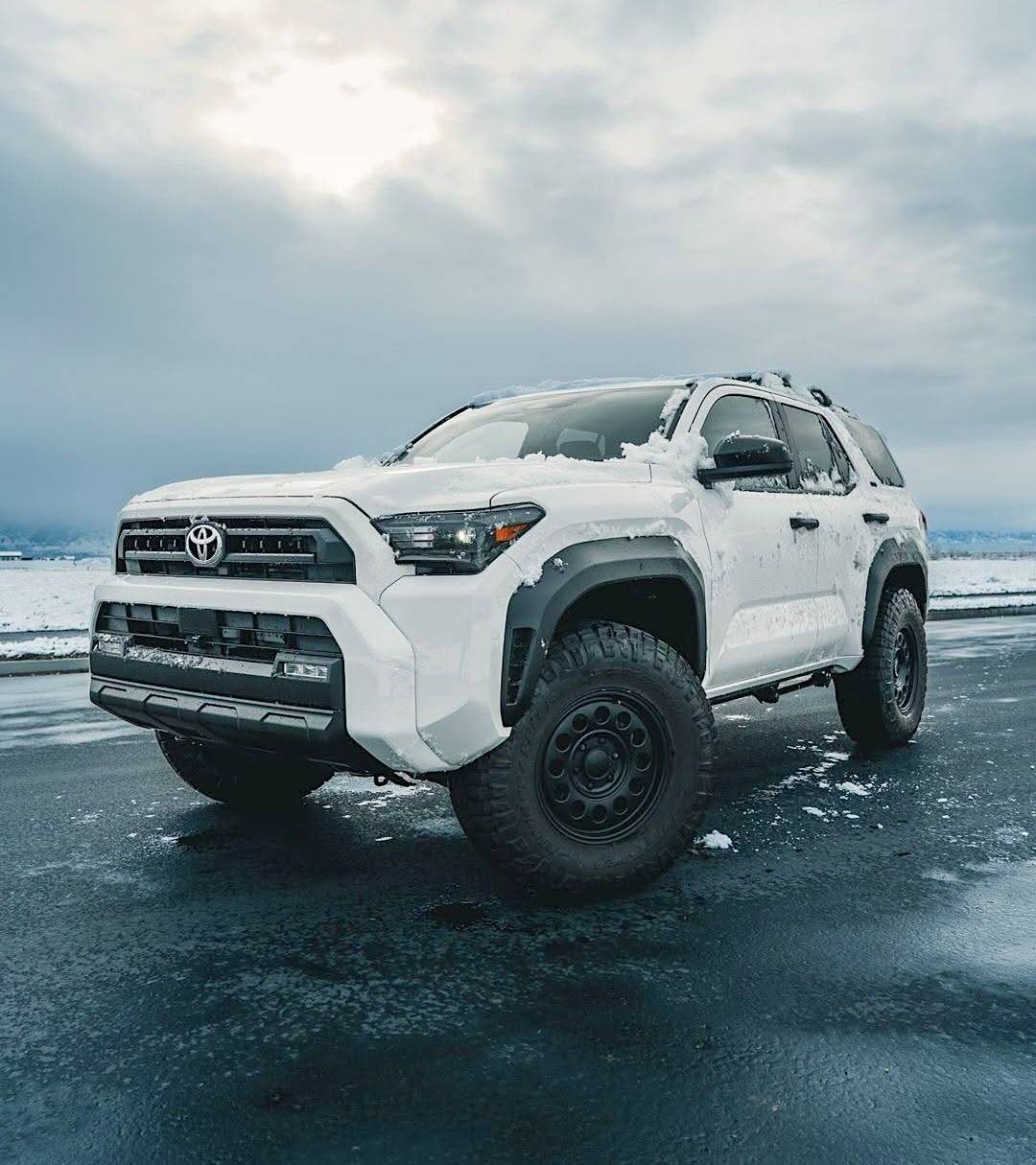

SR5 Ice Cap build on:
285/75R17 Nitto Ridge Grappler Tires - 33's (technically 33.8" diameter)
+25 offset wheels (Nomad 501SB Convoy Satin Black)
3" Lift Kit by Bison Off Road
Fog light vinyl overlays

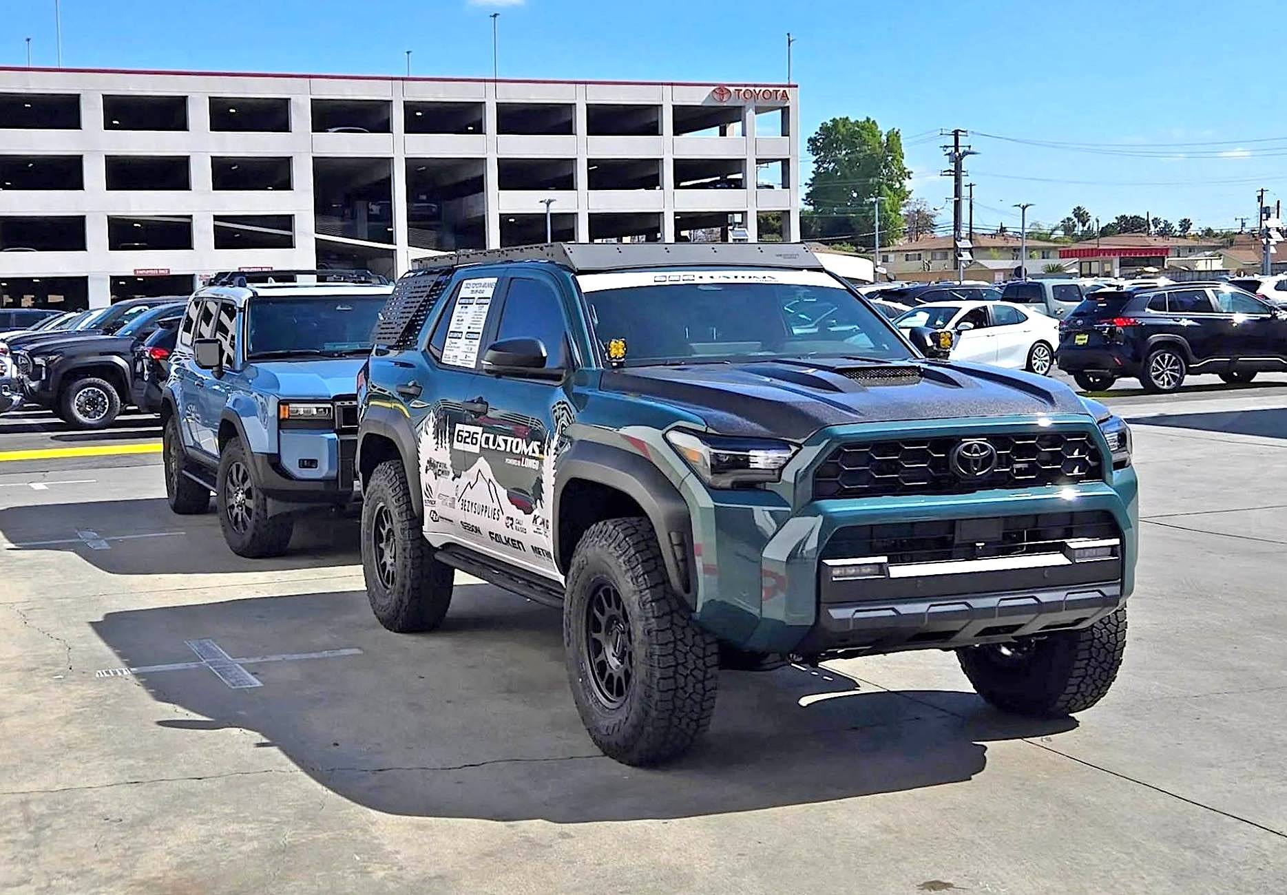

Adding this one too.
Supersonic Red TRD Off-Road build. Aftermarket mods installed by Outlaw Offorad:
  • Bronze 17" Fuel Wheels (FC86 Piston Bronze) +25 offset
  • Nitto Ridge Grappler 35's - 35x12.50R17
  • 3" lift

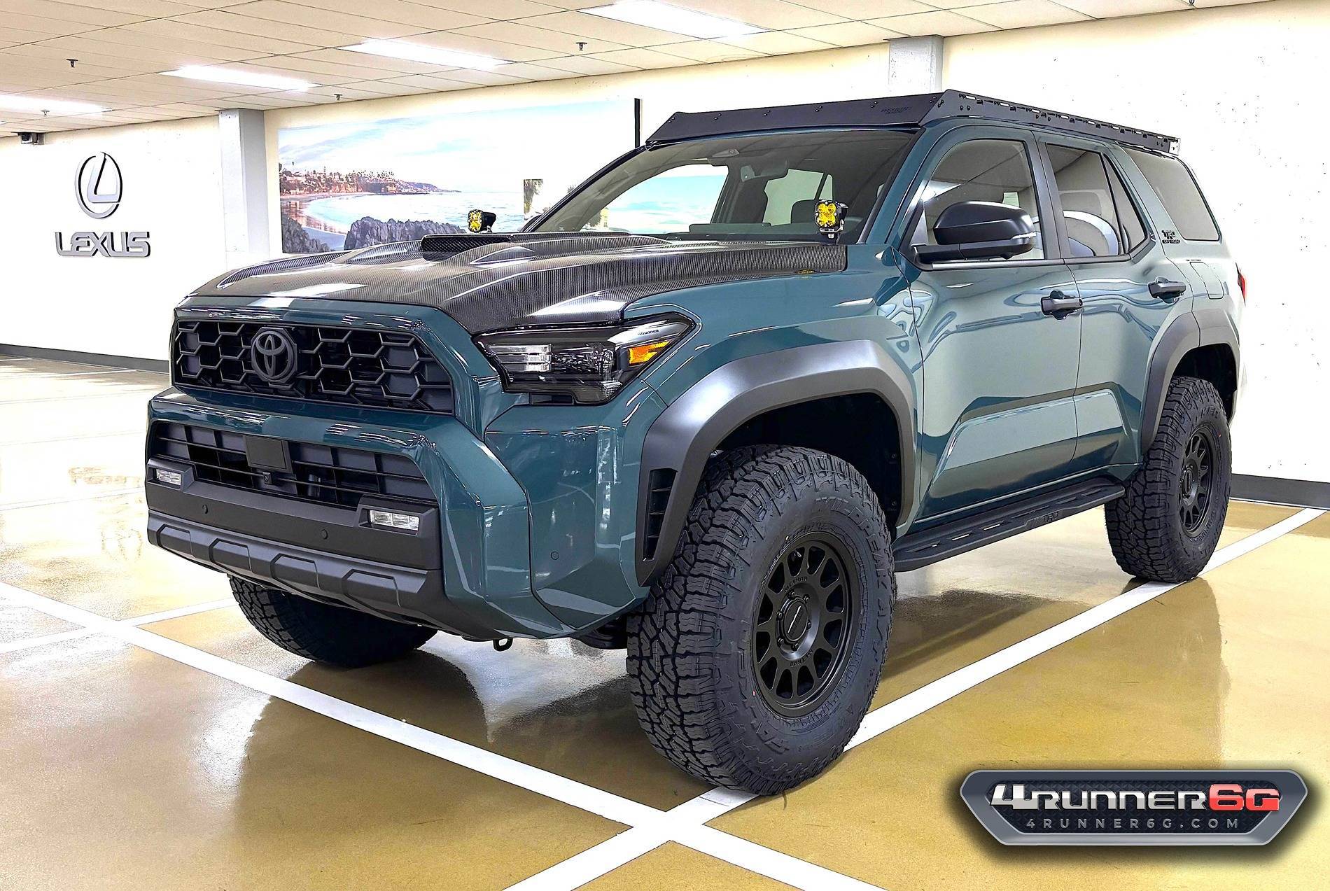

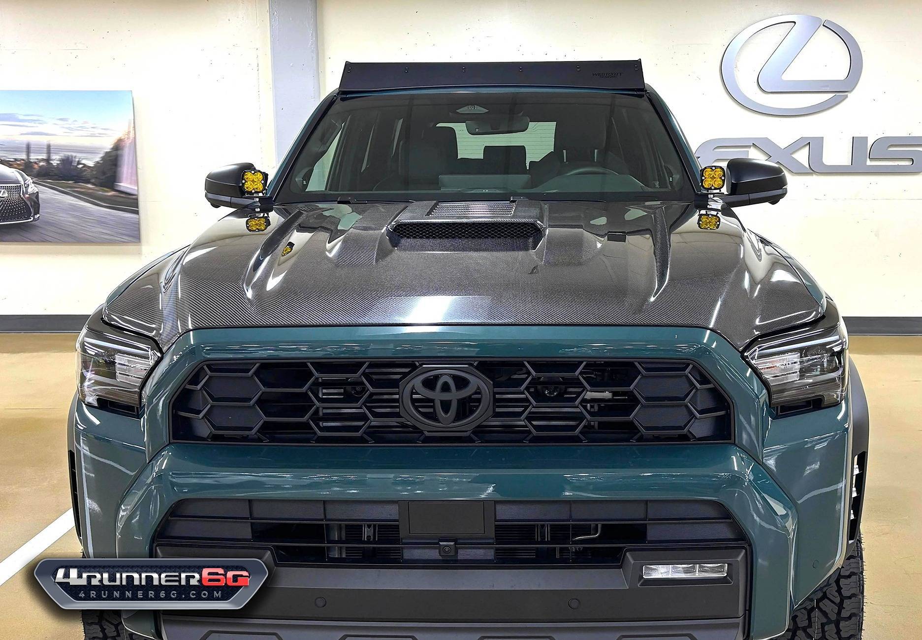

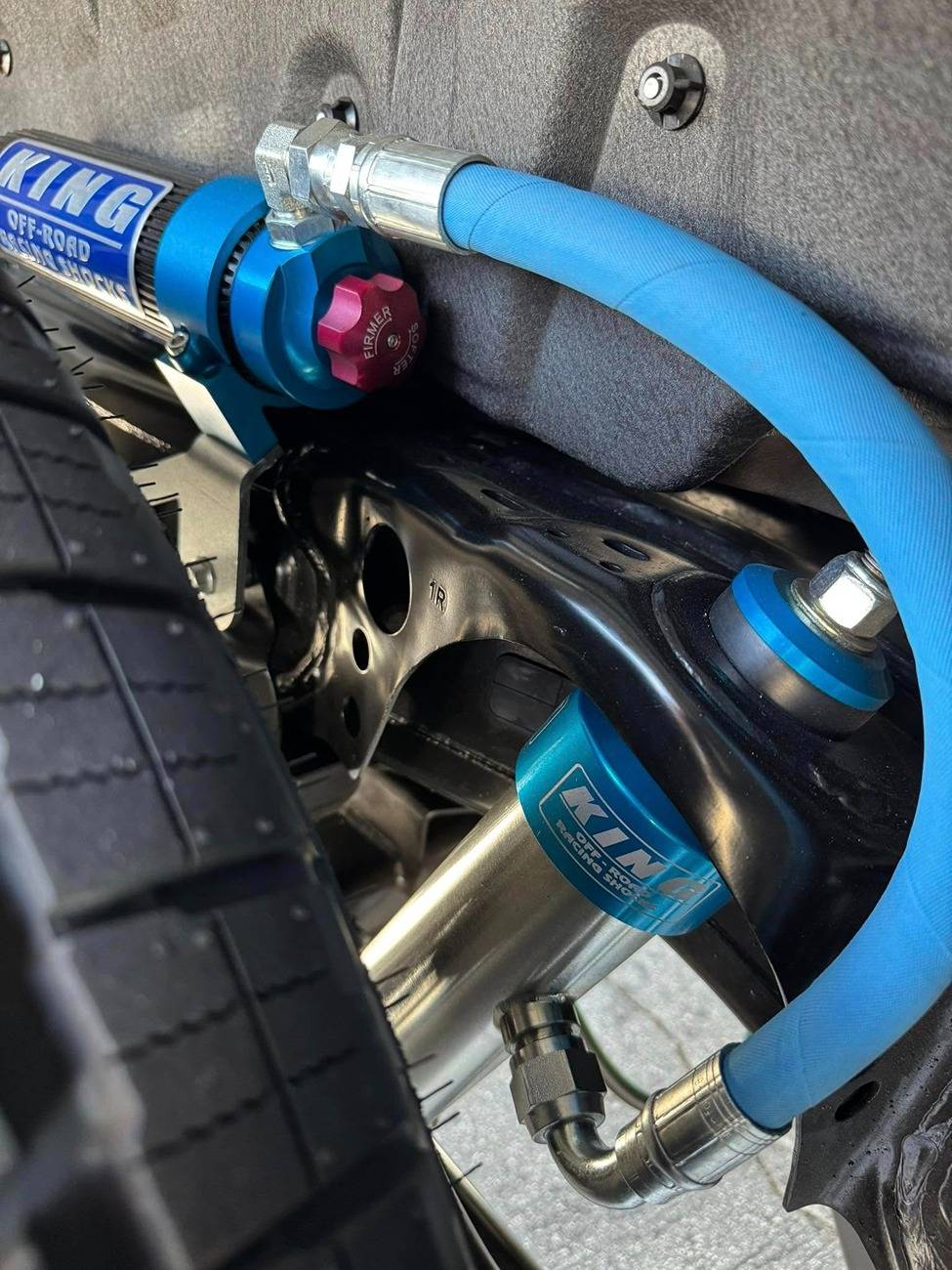

From my original thread:
https://www.4runner6g.com/forum/thr...ldpeak-at4w-roof-rack-carbon-fiber-hood.2929/

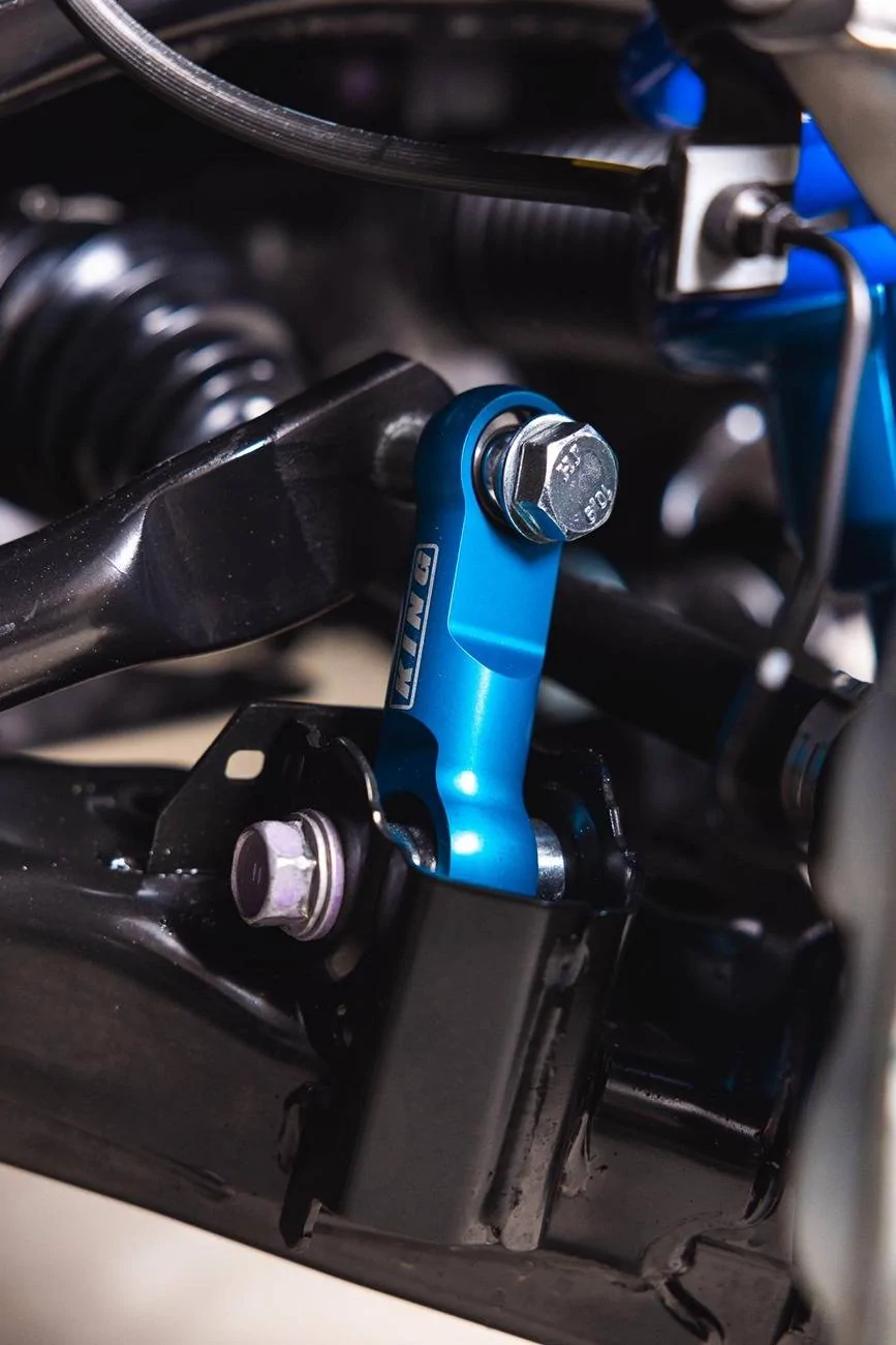

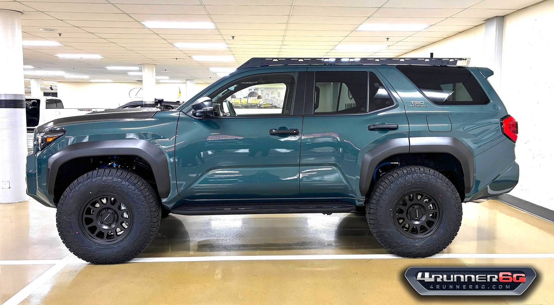

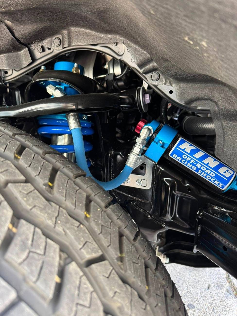

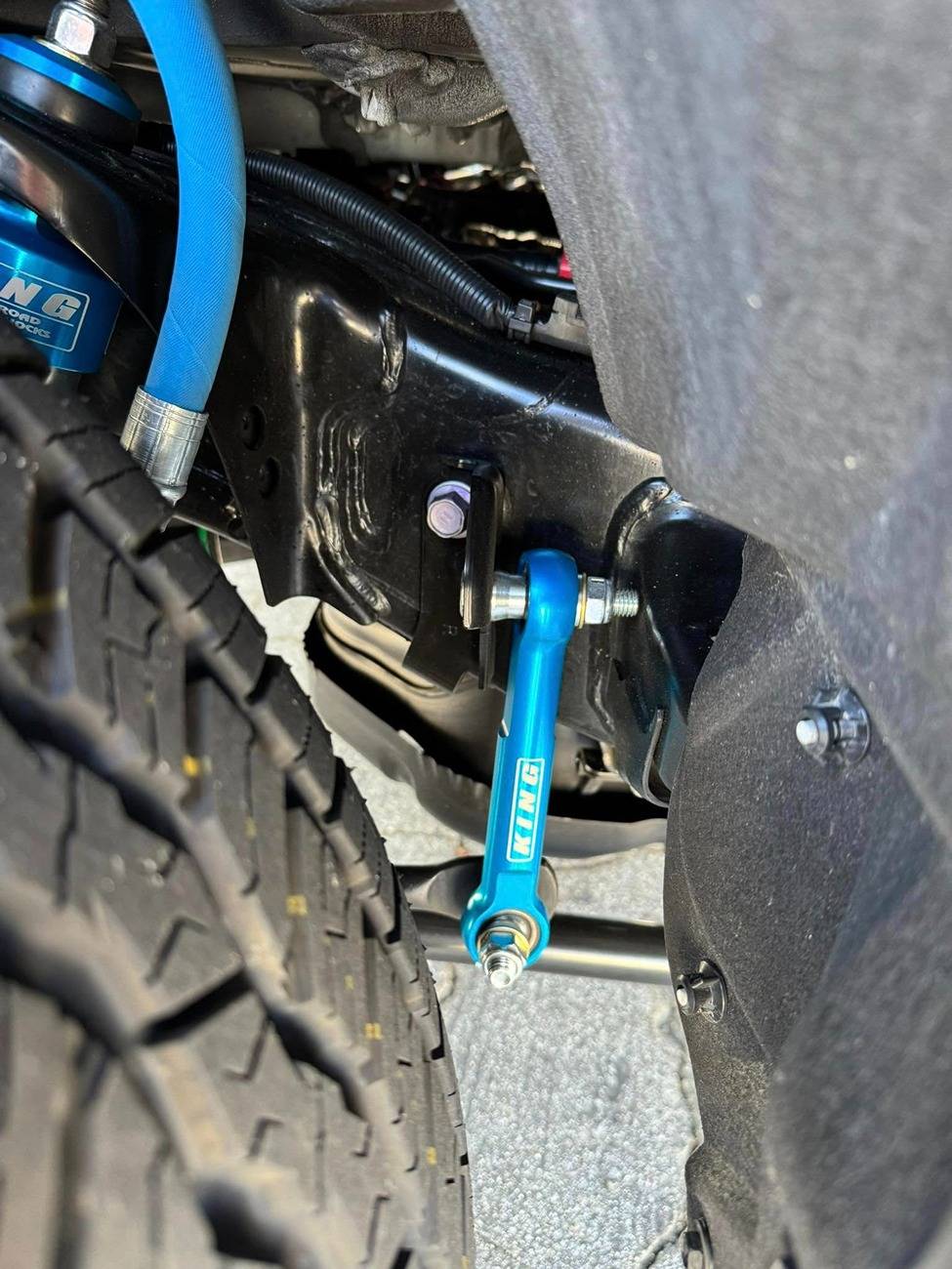

2025 TRD Off-Road 6th gen build on:
17" Method Wheels (703) - 17x8.5 +35 mm offset
WildPeak AT4W Tires (35x11.50R17)
Other mods:
KING 2.5 Coilover Shocks w/ remote reservoir
KING 2.5 Rear Shocks w/ remote reservoir
KING Sway Bar Link Kit
Total Chaos Fabrication's Upper Control Arms UCA
Seibon Carbon Fiber TR-Style Hood for 2025 4Runner
Westcott Designs Lo-Pro Roof Rack
Westcott Designs Molle Panel
Toyota OEM Aluminum Running Boards
Toyota Front Emblem Overlay
Baja Designs Pattern Black Squadron Sport LED Light Pods
Updated above list of aftermarket mods and here's more photos and a video.

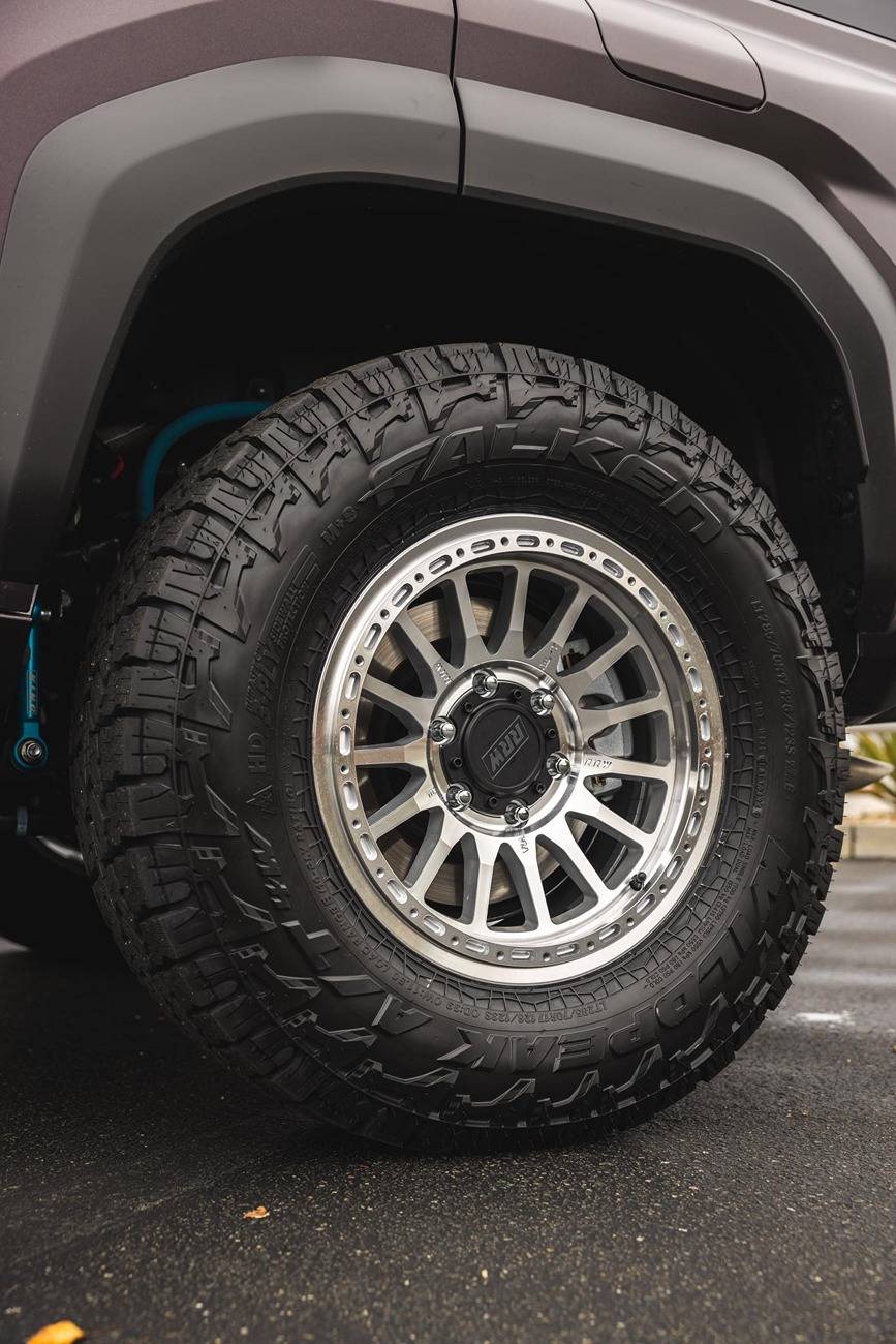

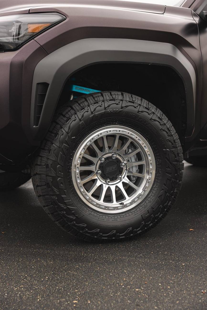

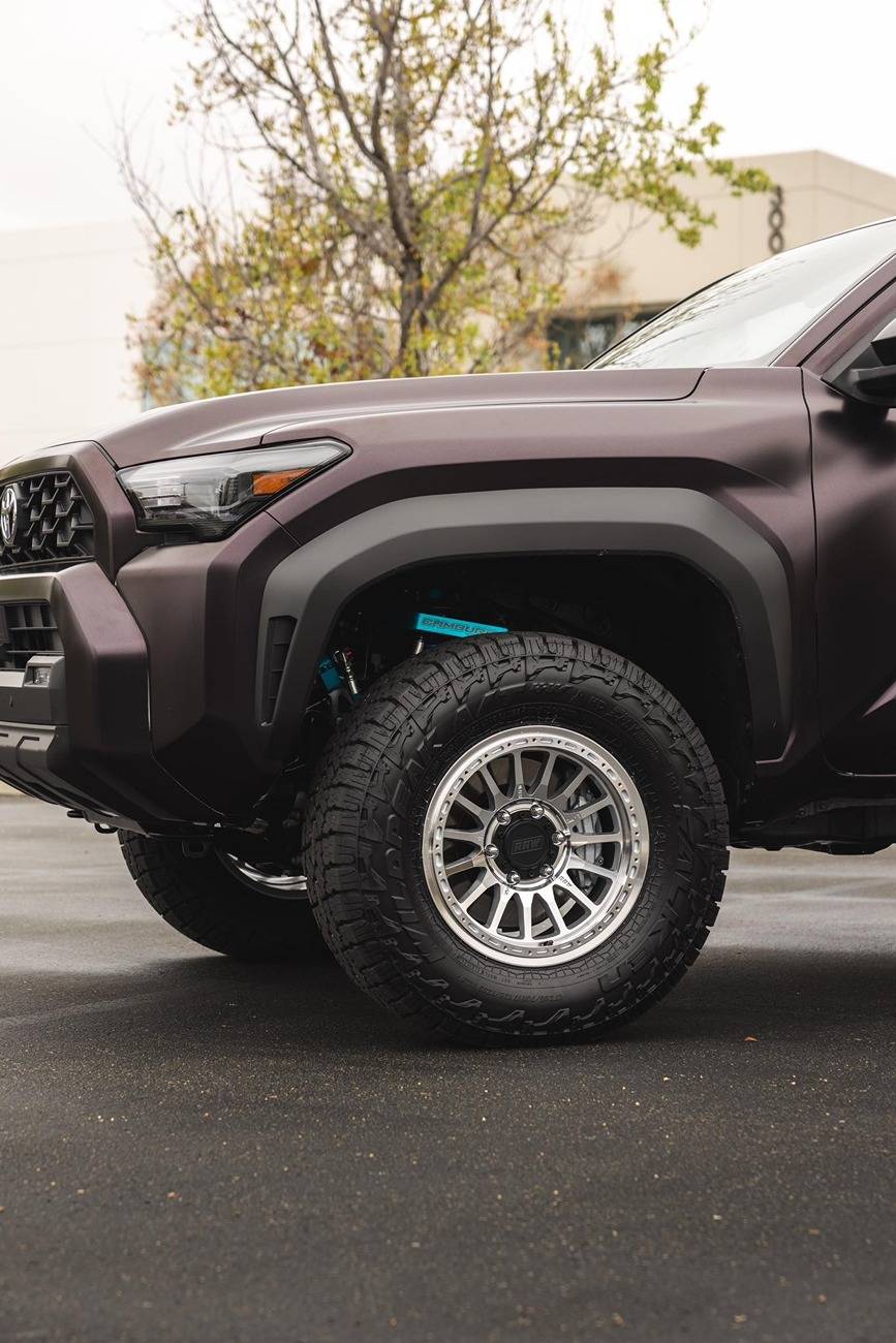

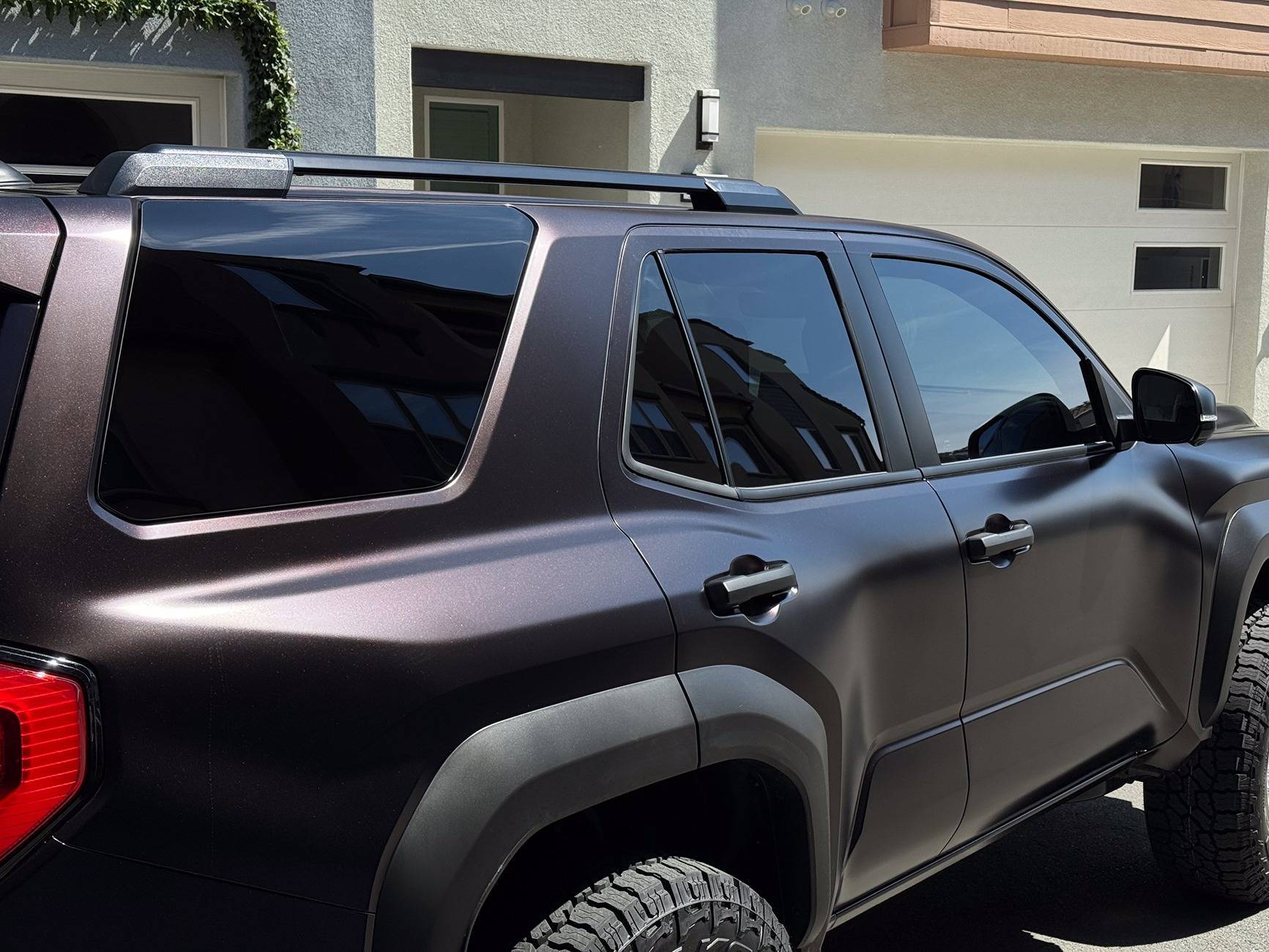

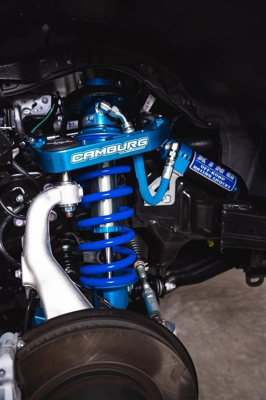

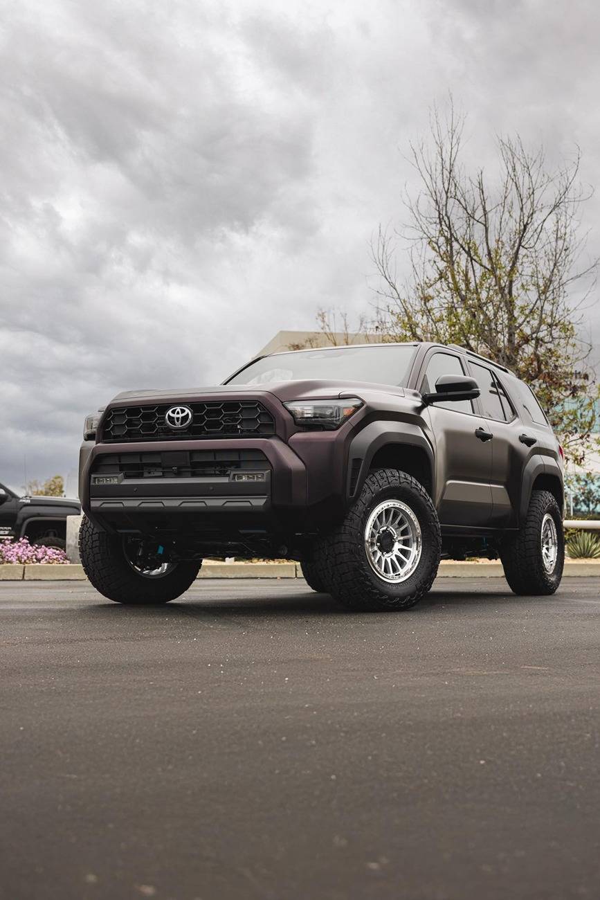

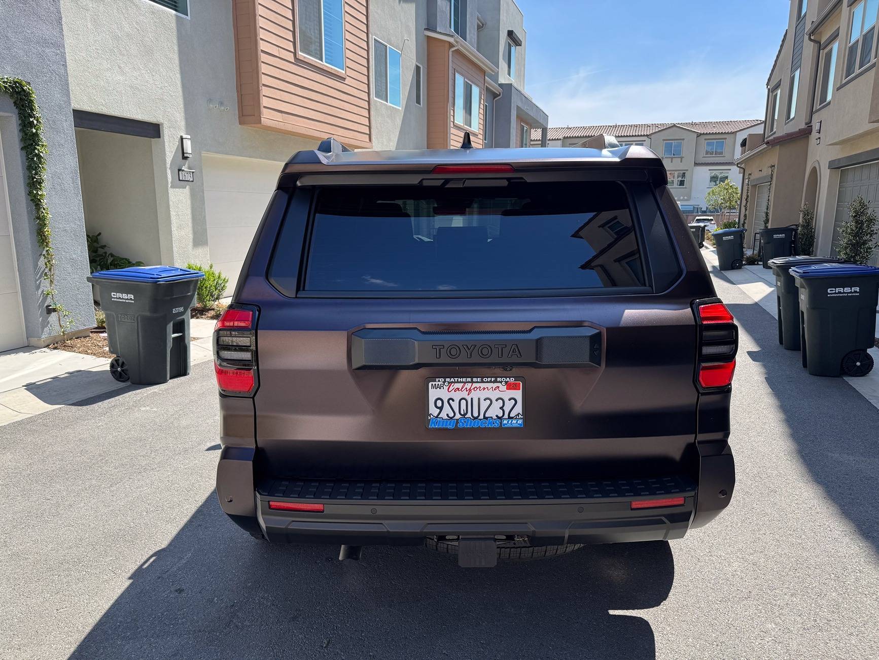

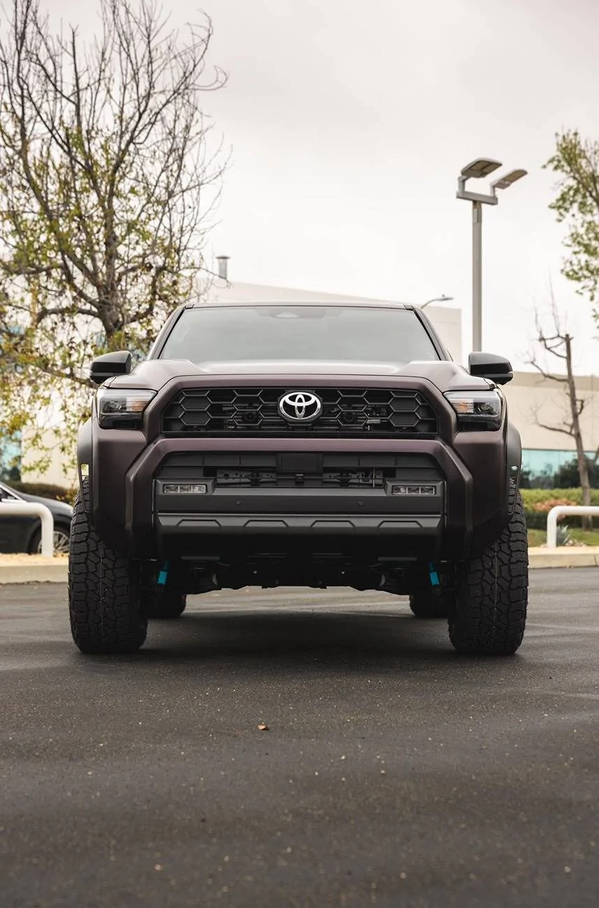

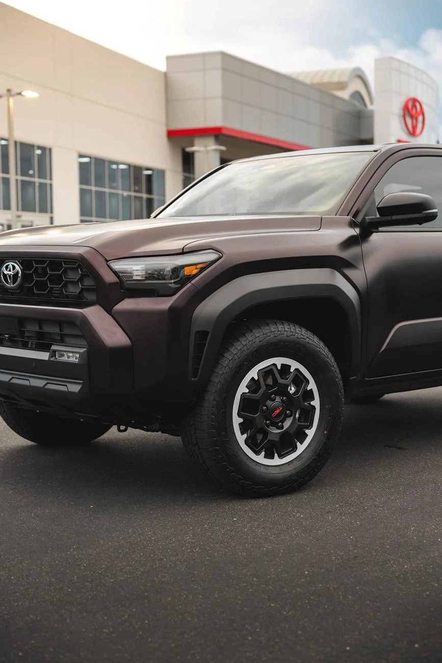

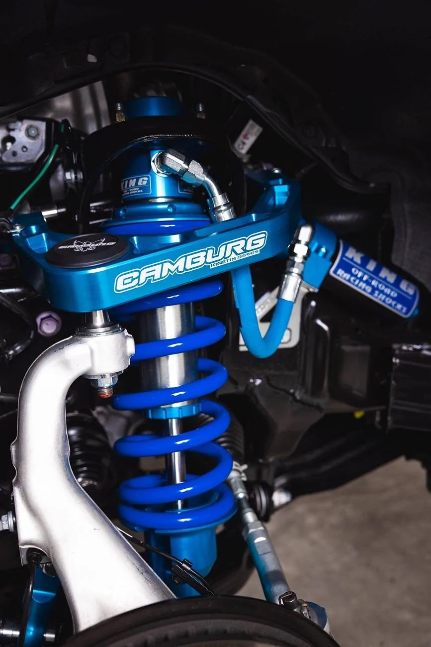

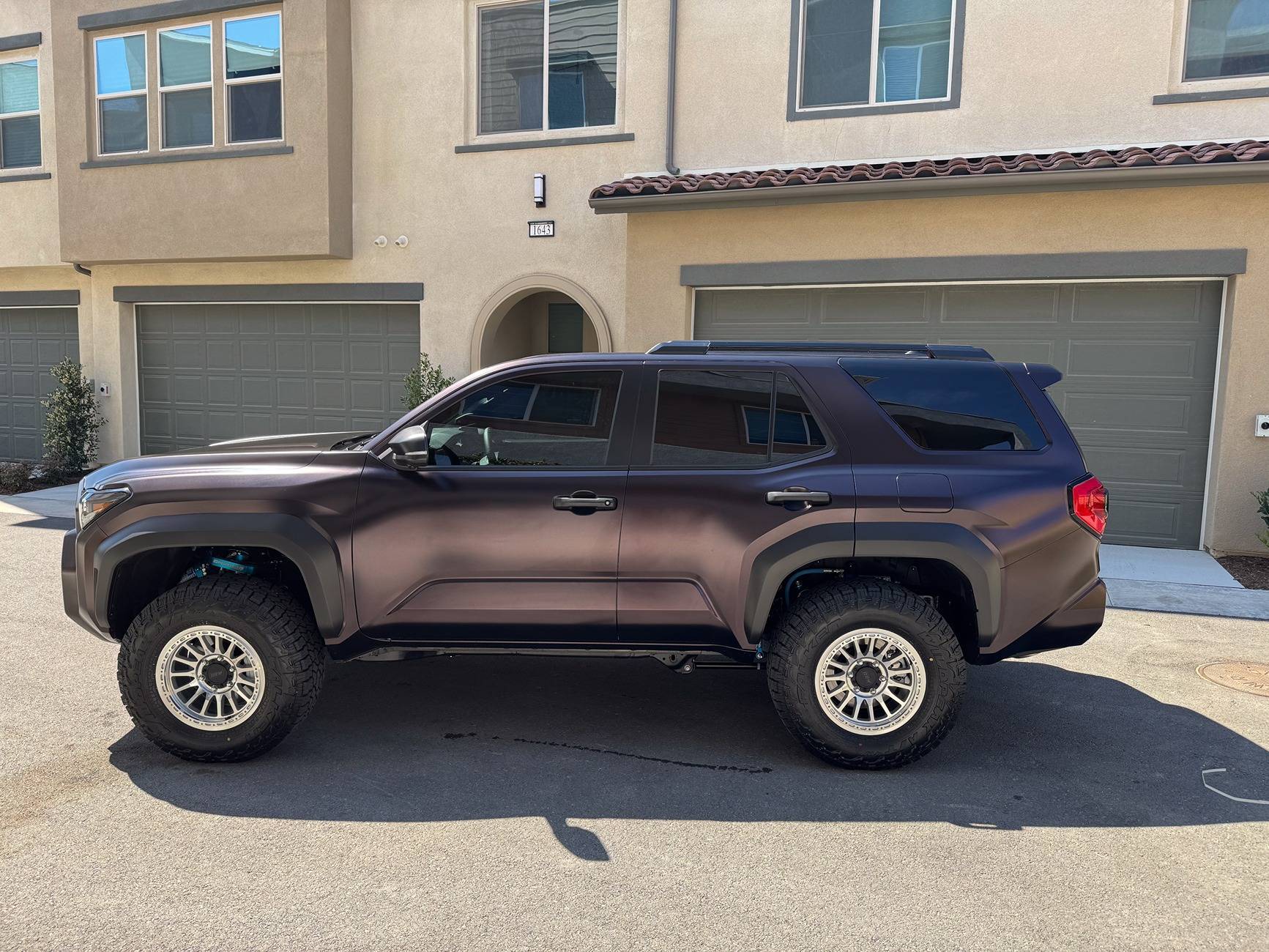

Here's a cool modded 2025 4Runner TRD Off-Road Premium ORP build (originally Ice Cap white)
Aura Vinyl - Satin Vinyl in Metallic Midnight Red color
+25 offset RRW RR7 Wheels (Relations Race Wheels)
285/70R17 Falken Wildpeak AT4W (33's -- 32.70" diameter to be exact)
KING Shocks
2" lift front
Stock rear height
Camburg billet upper control arms
Build owned by @kophoto4x4

Before kophoto4x4 installed the RRW wheels and KING / Camburg suspension parts, with just vinyl wrap:

20% XPEL ceramic tint added was also just installed on this build by its owner. The factory tint was removed. Cost: $575.

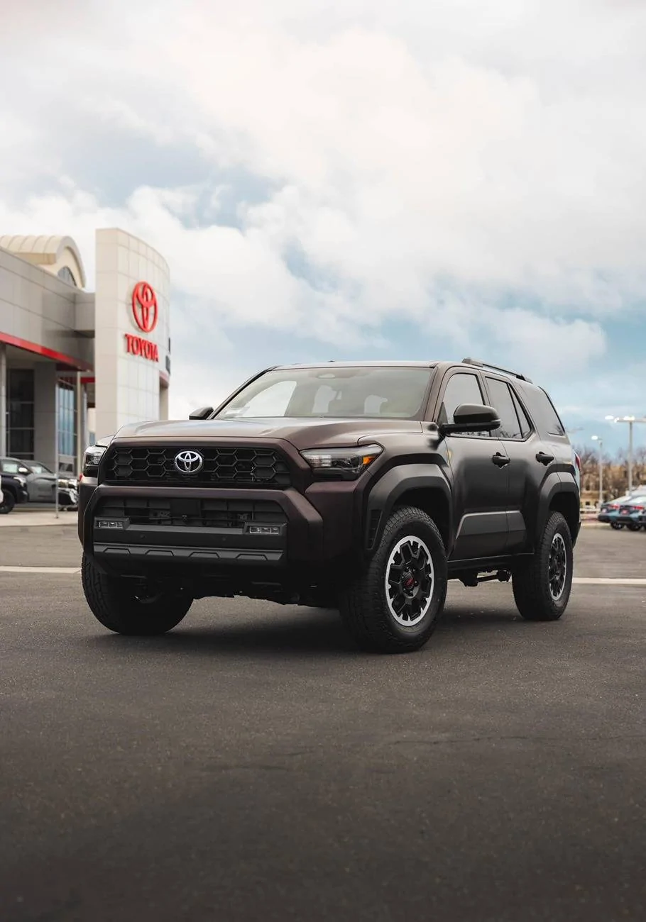

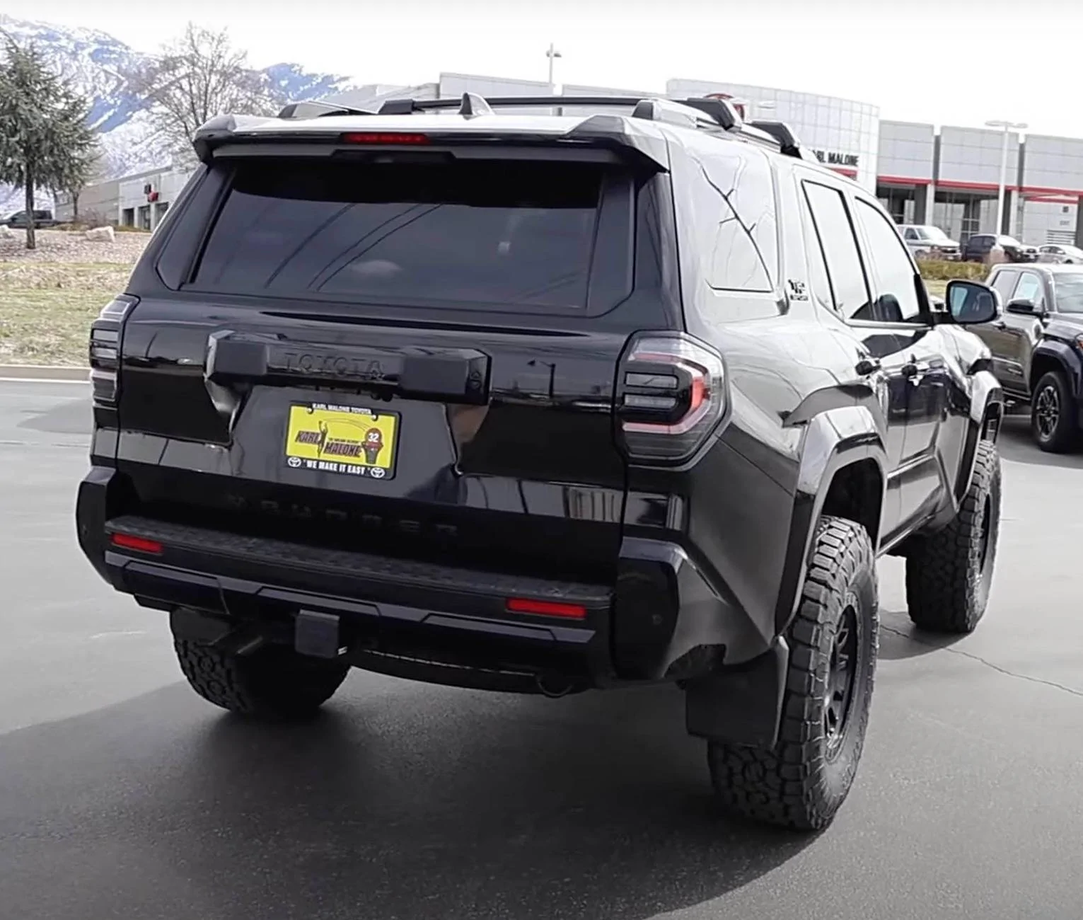

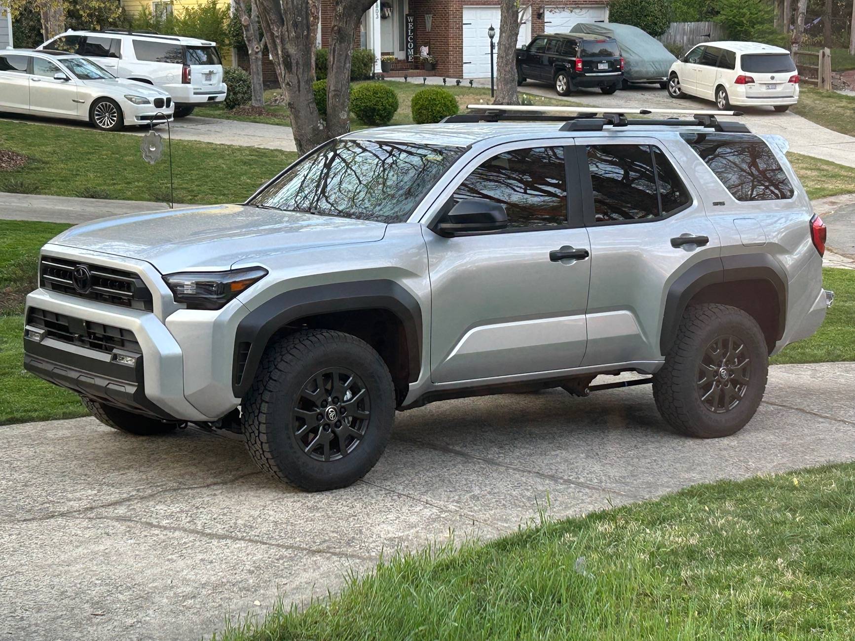

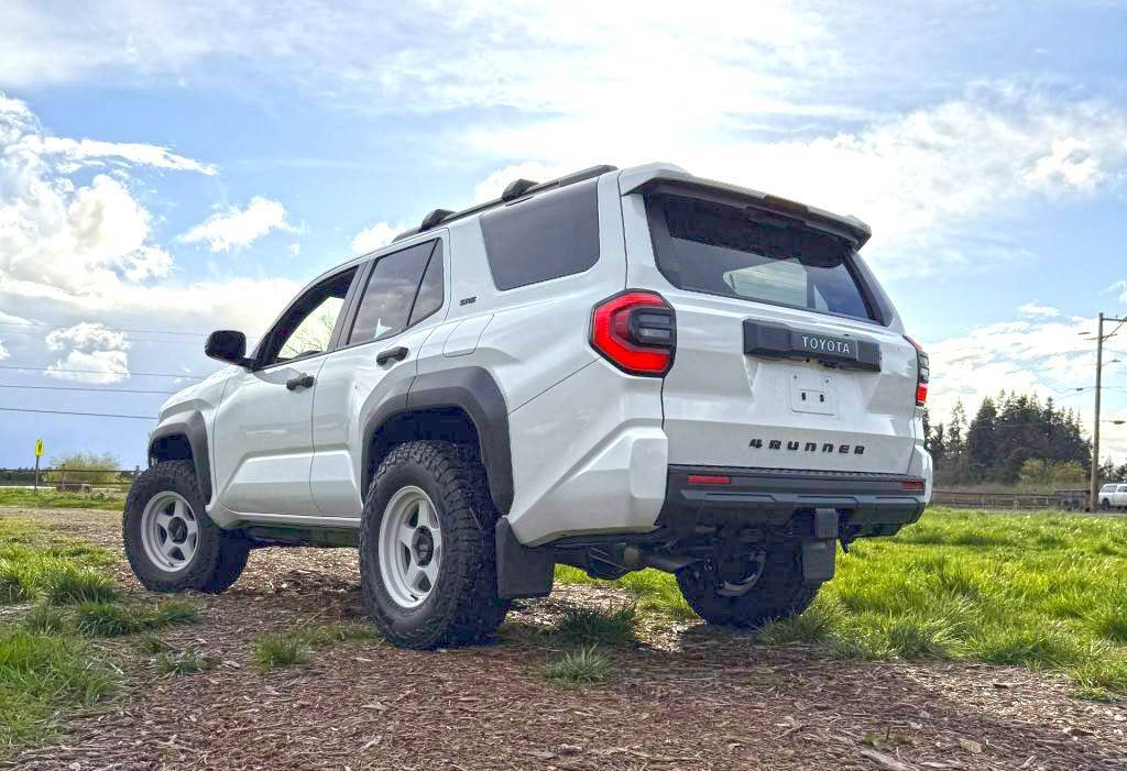

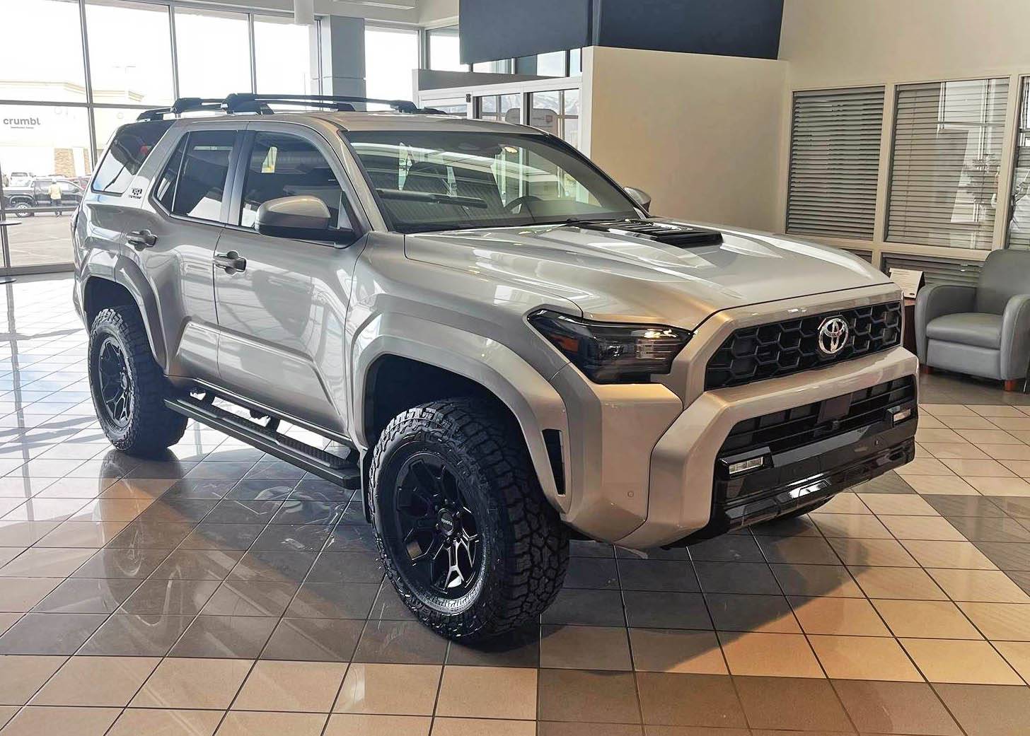

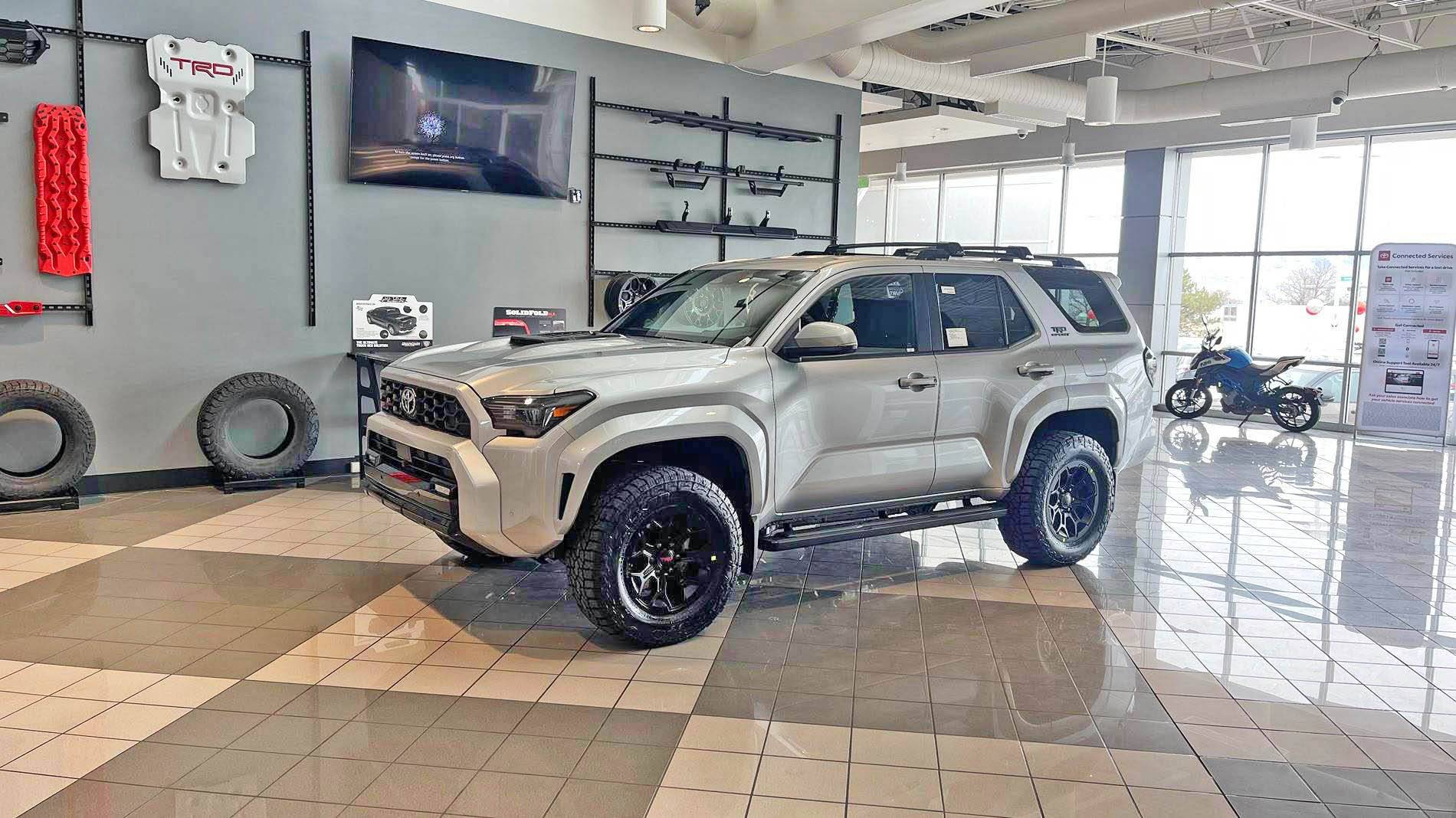

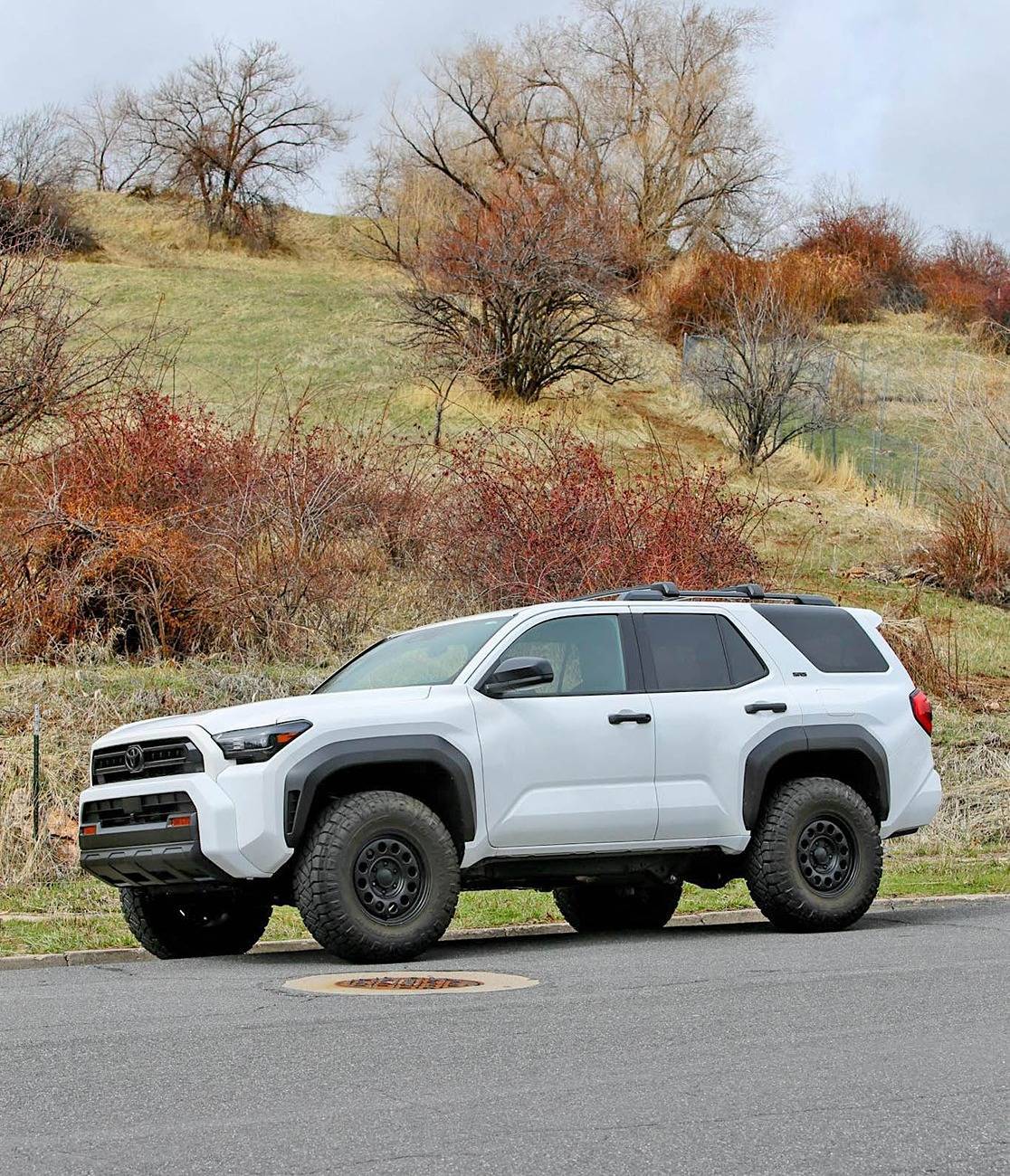

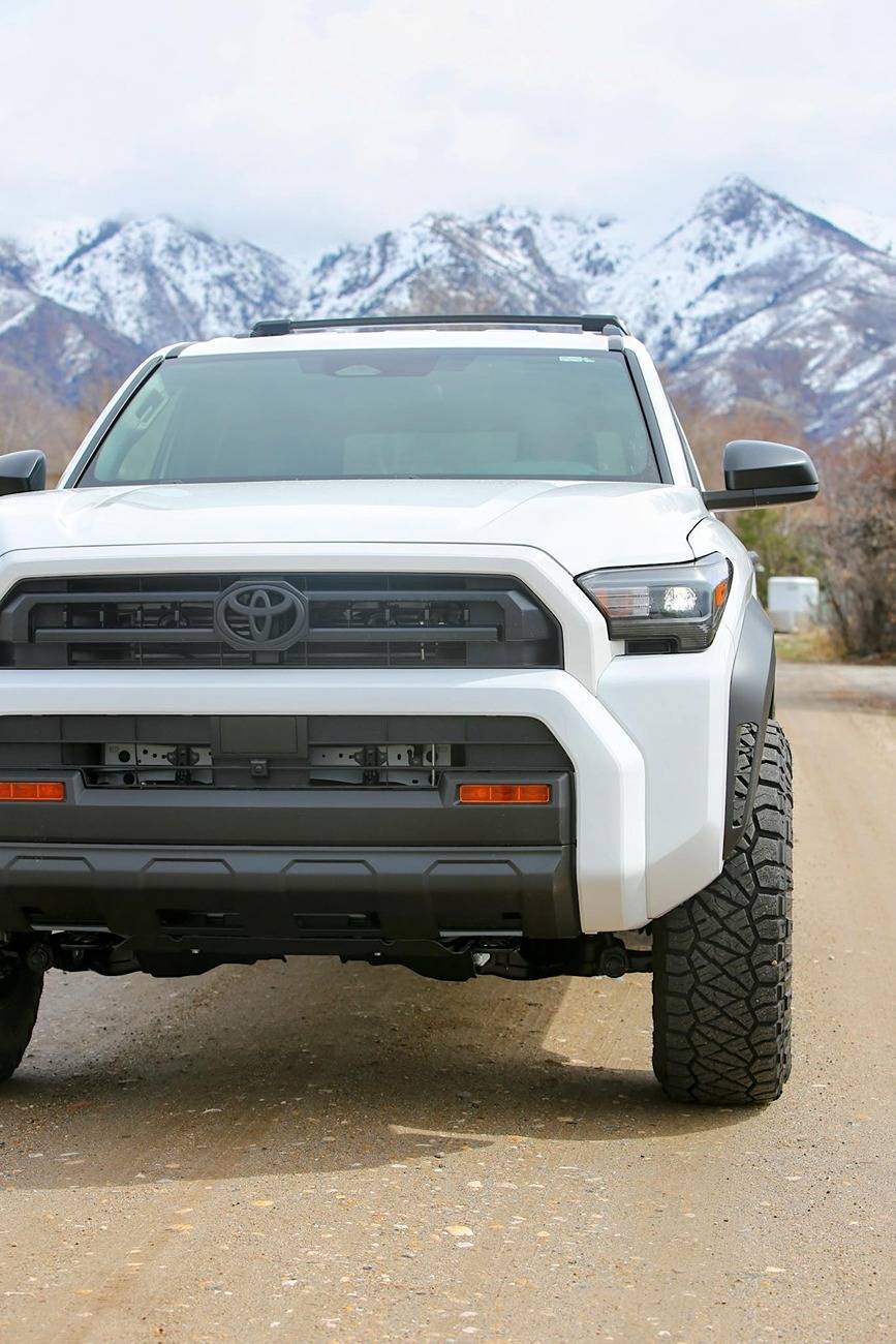

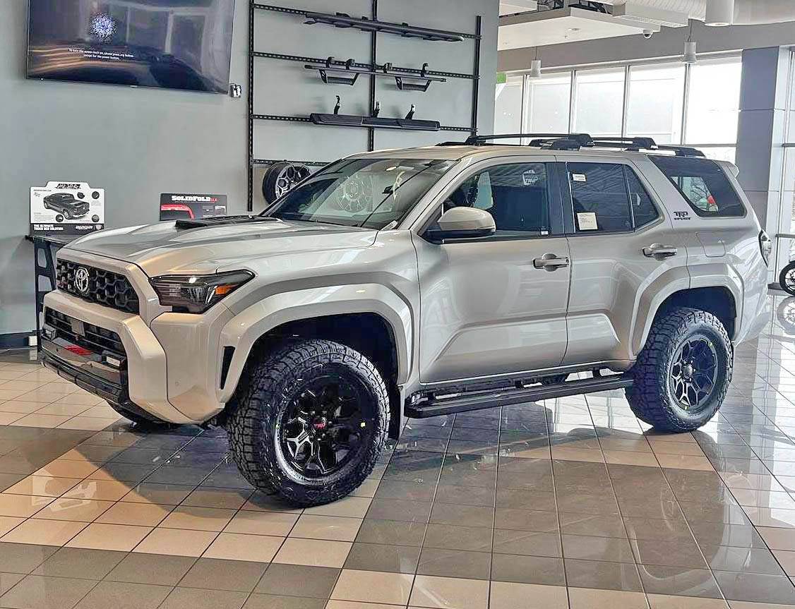

This is a build I just did on a new 4Runner. Thought I would share.
2" Torq front level kit (same spacer lift kit as the Land Cruiser 250)
TRD Pro 18" Wheels
"Toyota" lettering center caps with silver writing to match the paint
285/65R18 Falken Wildpeak AT4W Tires.
It already has the factory basic Toyota running boards. I also added a black front badge overlay (not pictured).

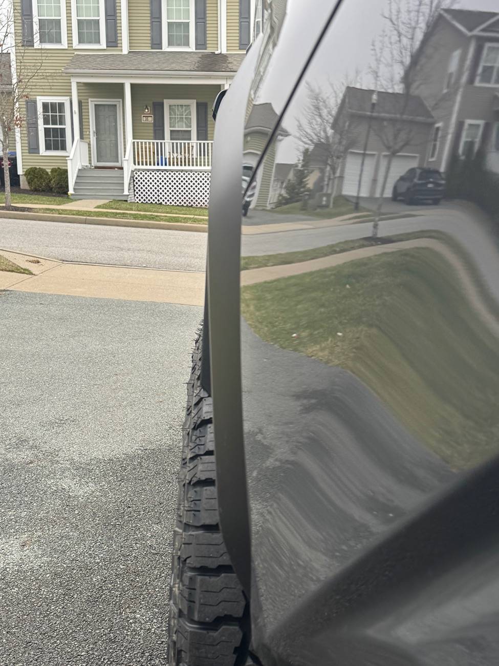

2" Rough Country Level kit + Nitto Terra Grappler 33s 275/70r18 tires installed on 18" TRD Wheels.
Finally got around to throwing the Leveling kit on the 4 runner. Super easy took me about an hour and now she's in the shop for alignment today. This is exactly the look I was going for, now just waiting on the trail hunter grille and the wife will be happy.?

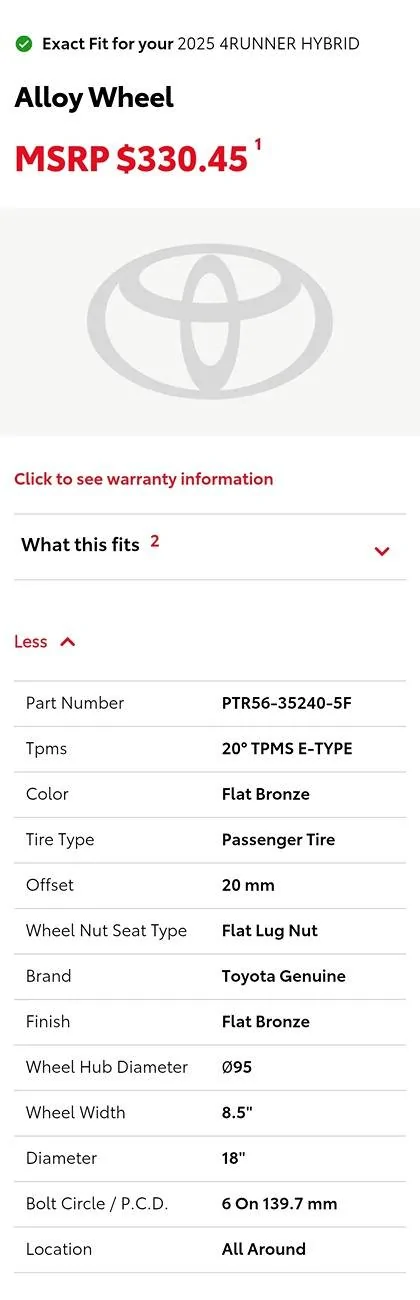

Were your wheels factory option? If not, where did you find them? TIA

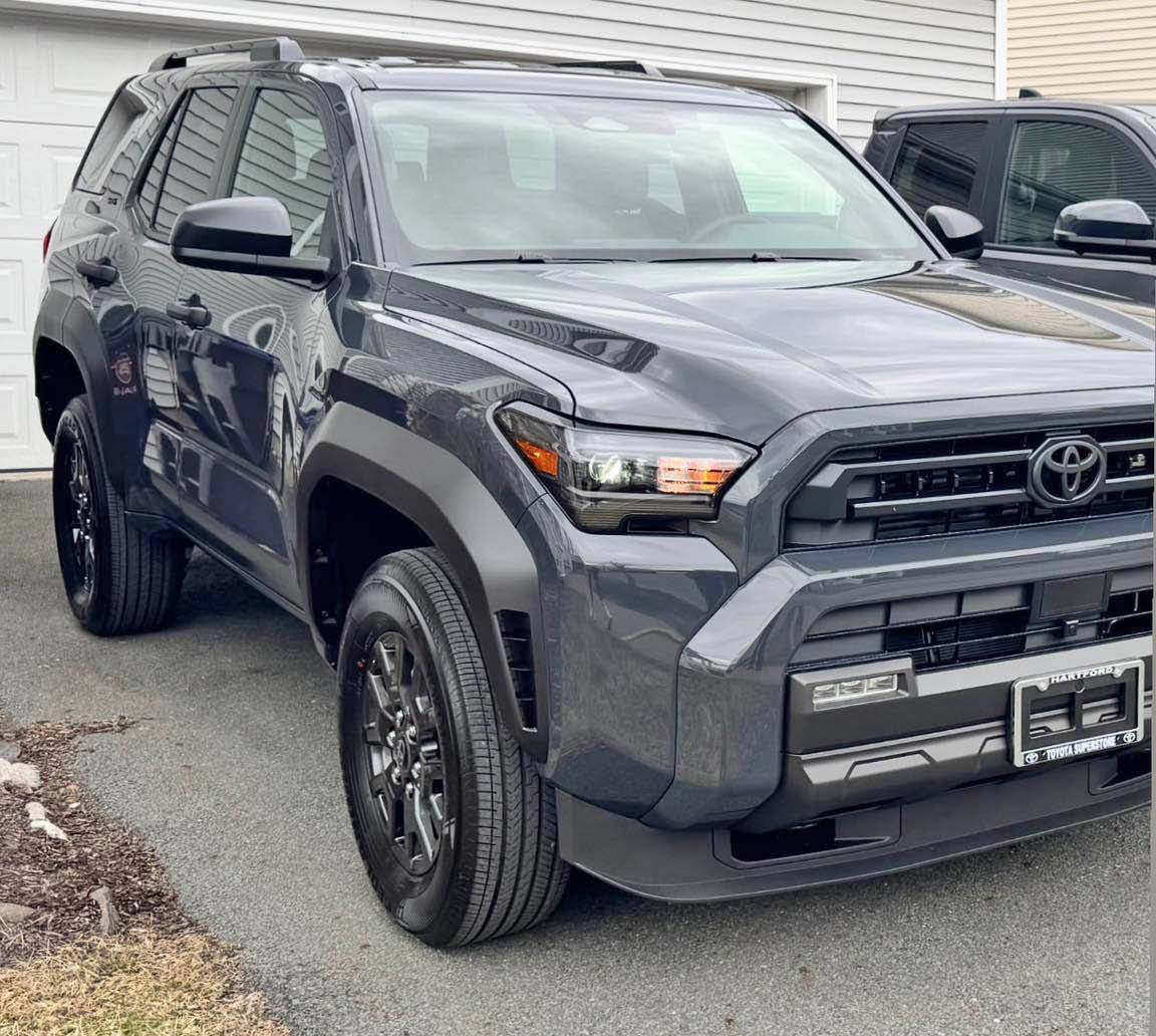

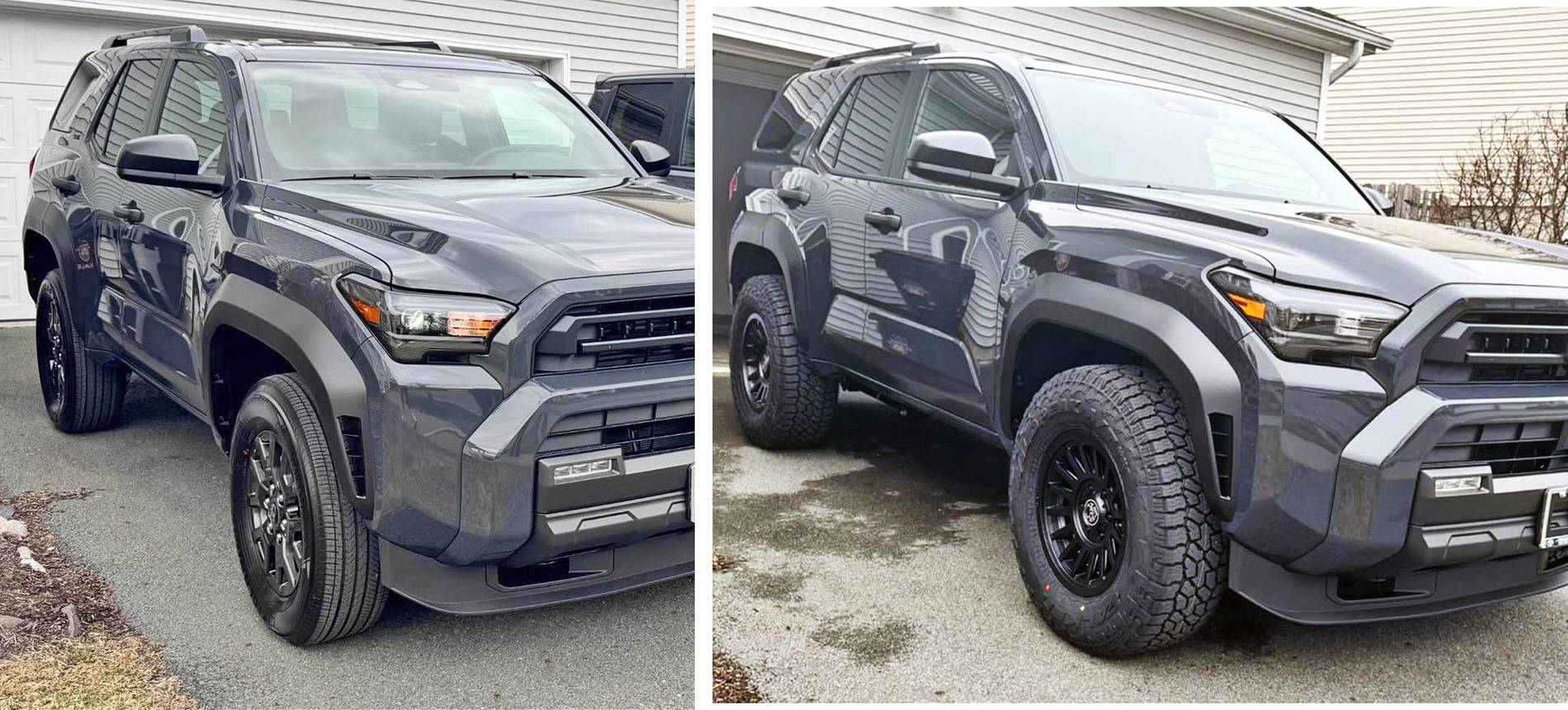

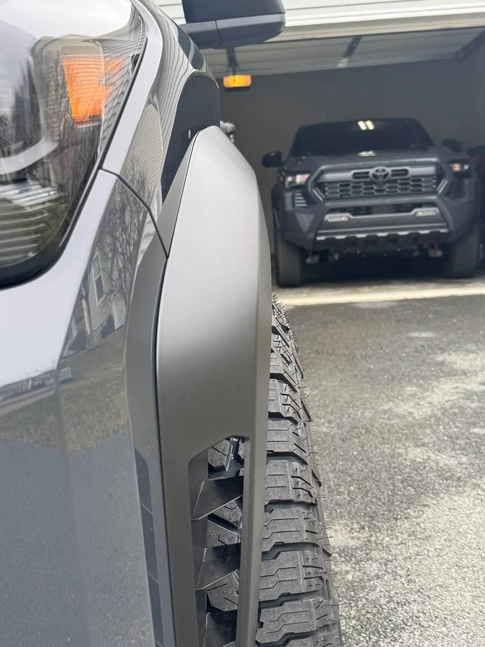

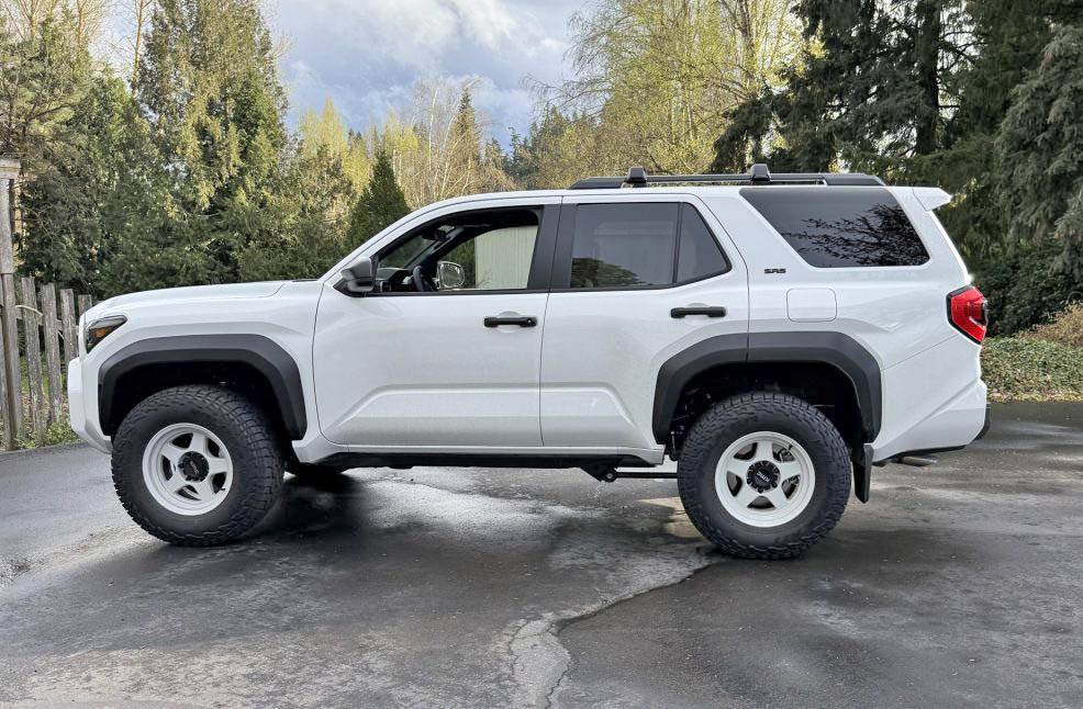

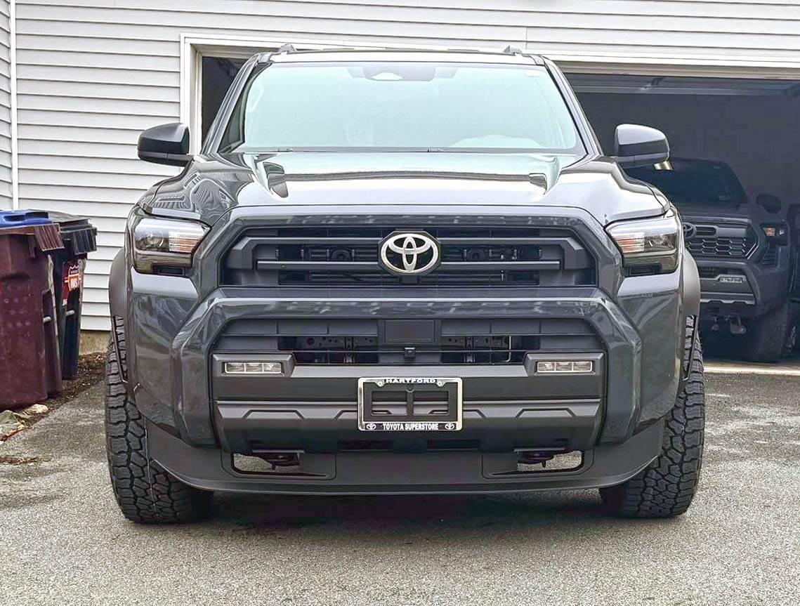

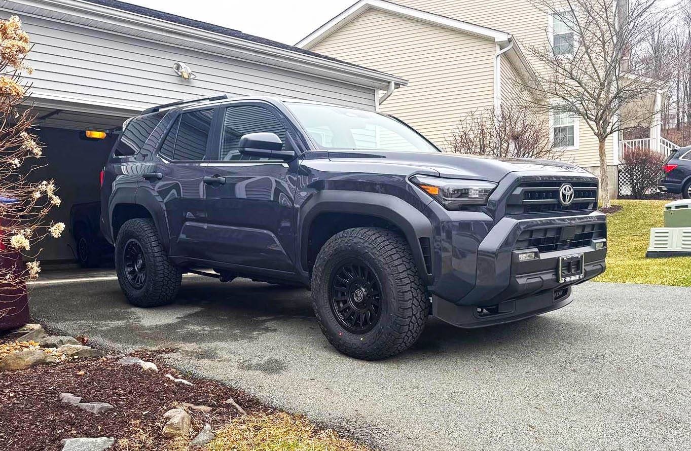

Before & After on SR5:
Tires: Falken Wildpeak 285/70/17 A/T4W SL
Wheels: Icon Alloys Recon SLX Satin Black 17x8.5 +25mm Offset
No lift
No rub
The Wildpeak AT4W tires are great.. they ride smoother than stock with a very slight hum. Not noisy by any means though.
@Ericd6972's wheels are these factory optional 18" TRD Wheels upgrade available for the TRD Off-Road trim
https://www.4runner6g.com/forum/thr...-on-falken-wildpeak-a-t3wa-tires-photos.2401/

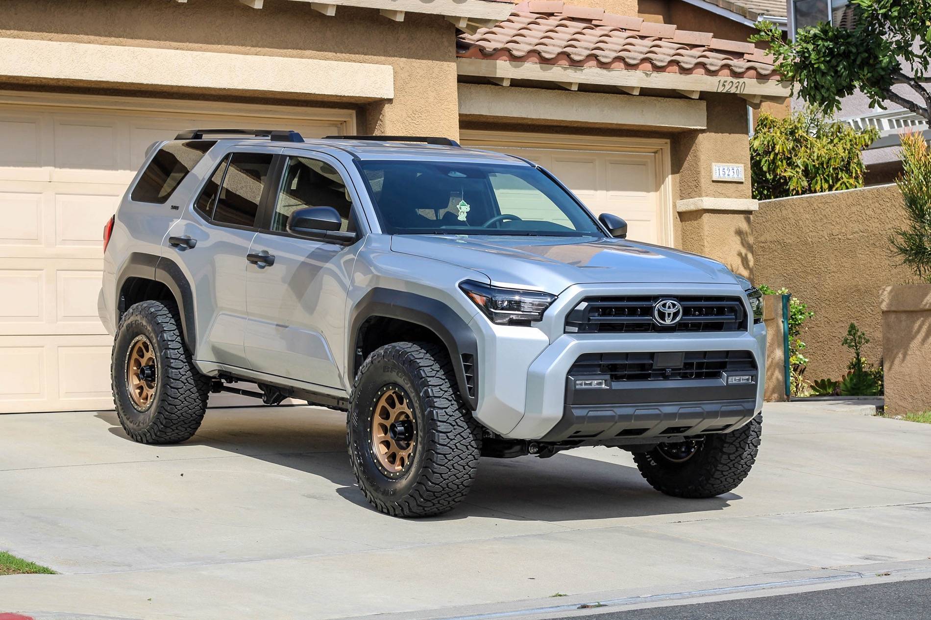

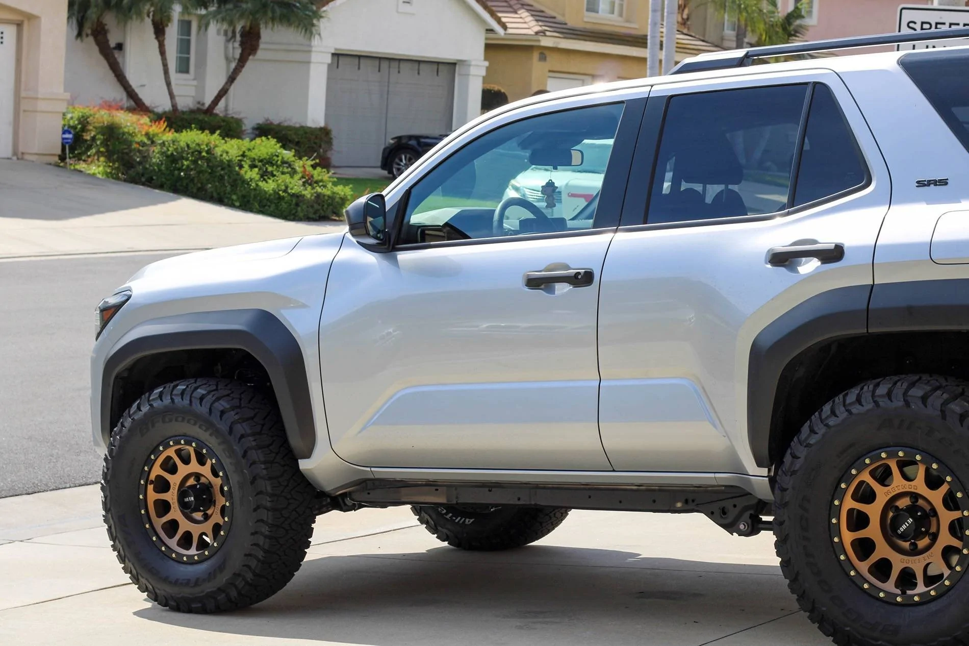

Just installed some 35s this weekend paired with Westcott preload collar level kit.
Cutting Edge SR5
KO3 35's tires 315/70/17
0 offset Method 305 Bronze Wheels (17x8.5)
Westcott level kit: 2.5" inch lift front & 0.75" inch lift rear
Some rubbing even after level kit (required some slight fender liner trimming in the front + a little bit of angle grinding. Also uninstall the bump stops/mud guards (not 100% sure that's what they're called but it is pictured below,). Just three 17mm bolts. Super easy. Rears clear perfectly!

Here's what -10 offset wheels w/ 33" tires look like on the 2025 4Runner 6th gen. Way aggressive for my taste but interesting to see how -10 mm offset looks like on the 6th gen. I do like the white wheels on Ice Cap white look. This isn't my 4Runner btw, it's owned by Kevin K.

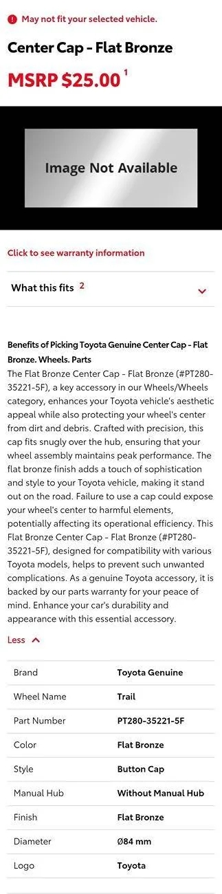

Flat Bronze Wheel Center Caps Details:
Part NumberPT280-35221-5F
ColorFlat Bronze
StyleButton Cap
Manual HubWithout Manual Hub
FinishFlat Bronze
Diameter084 mm
