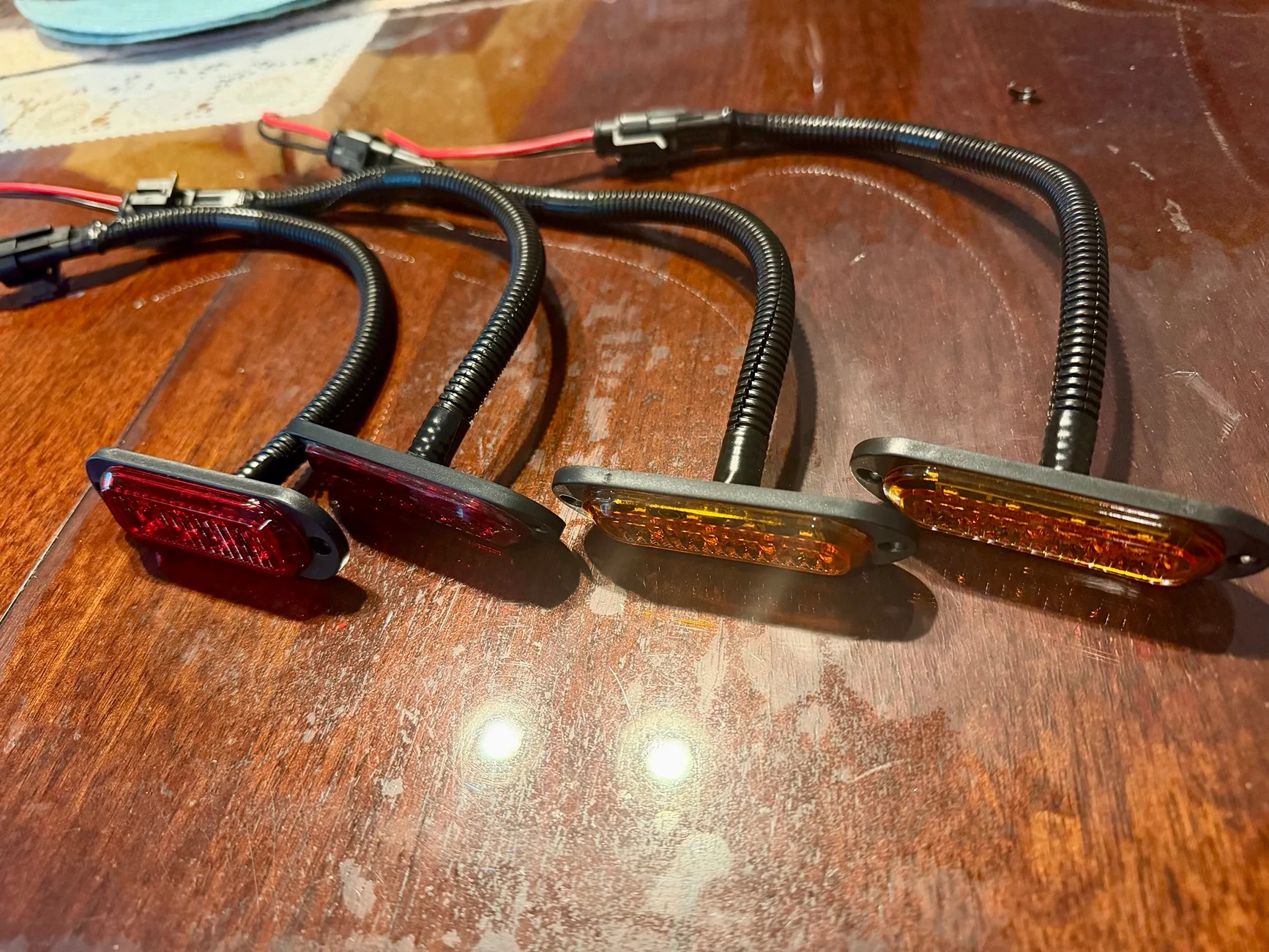

Happy to say that I installed all the parts and accessories with the guides of YouTube University Lol. Installing the whole suspension is very challenging but satisfying in the end. I trimmed a little bit part of the fender flares because I have the rough country wider flares and pushed inward the fender liners in the front to accommodate the 35x12.5 inch tires. 3inches lift is the way to do when installing 35” tire with the 0 offset. The rides are really nice and way better than the Oem Bilstein shocks. At first I was very hesitant to buy the ready lift (Falcon) suspension because there’s not a lot of reviews but I am glad that I did it. Do not ask me about gas mileage because I don’t care about it, lol. I added fender lights marker that I got it on eBay and made my own wirings that connected to park lights.

Great rig @page09. Love all your mods, especially the fender flare marker lights. Any tips on where to get the lights and how you installed / hooked them up?
I get them from eBay and bought some waterproof wire connections and tap them to parking light.
Can you post a picture of the parking light wire or fuse that you tapped into? I am considering doing the same for some
Fogs with backlight. Thanks!
