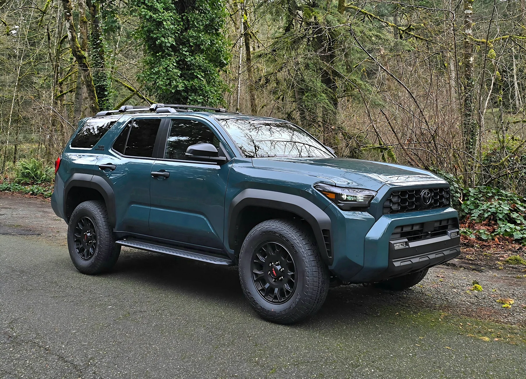

Installed Limited Headlights w/ 4Runner Badge (Etsy šŸ˜…) on the Hood

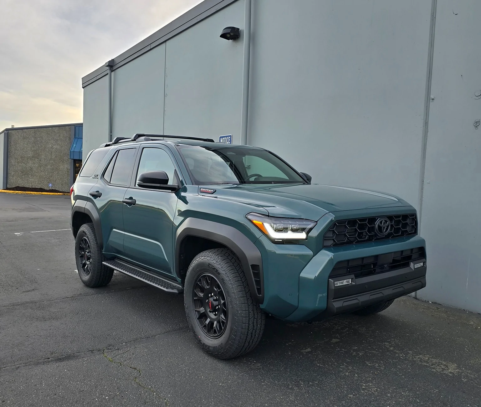

For anyone interested in doing this upgrade, it’s fairly simple. I highly recommend disconnecting the battery anytime you’re working with electrical components such as headlights or fog lights.
Part Number: 81070-35661 - Unit Assembly, Headlamp, B Left Hand
Part Number: 81140-35661 - Unit Assembly, Headlamp, B Right Hand

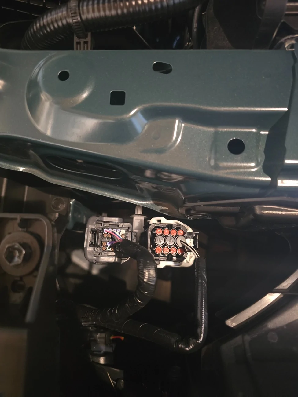

When removing the headlights, make sure to disconnect the two harnesses located on right passenger side of the headlight. (Be sure to connect them properly once you're finish, otherwise you'll unlock a can of worms; check engine lights, codes, etc. etc.)
Please refer to video: How to remove front bumper
The entire process takes roughly 1.5 hours from start to finish.
It is purely Plug and Play, no additional harness required for the installation.

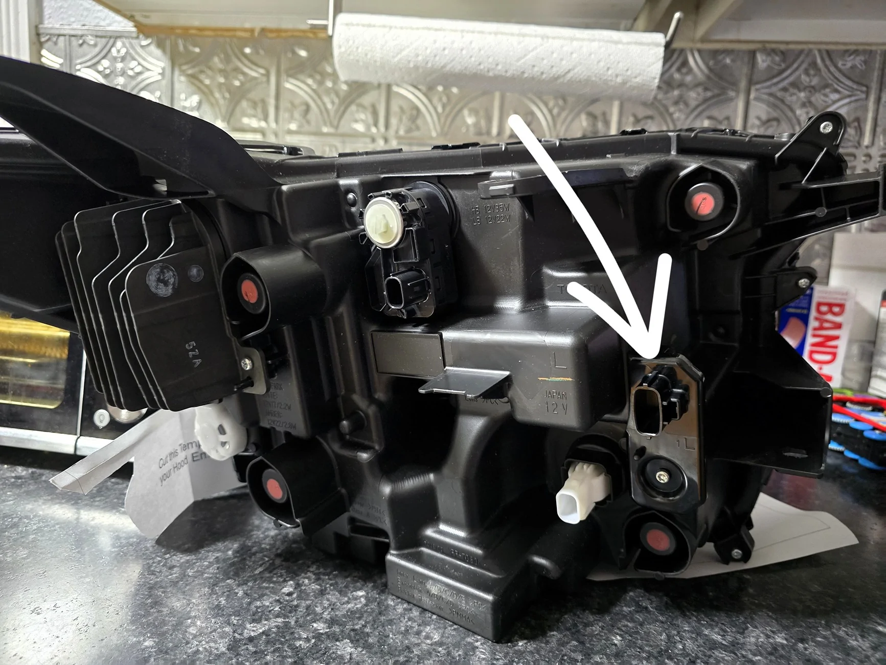

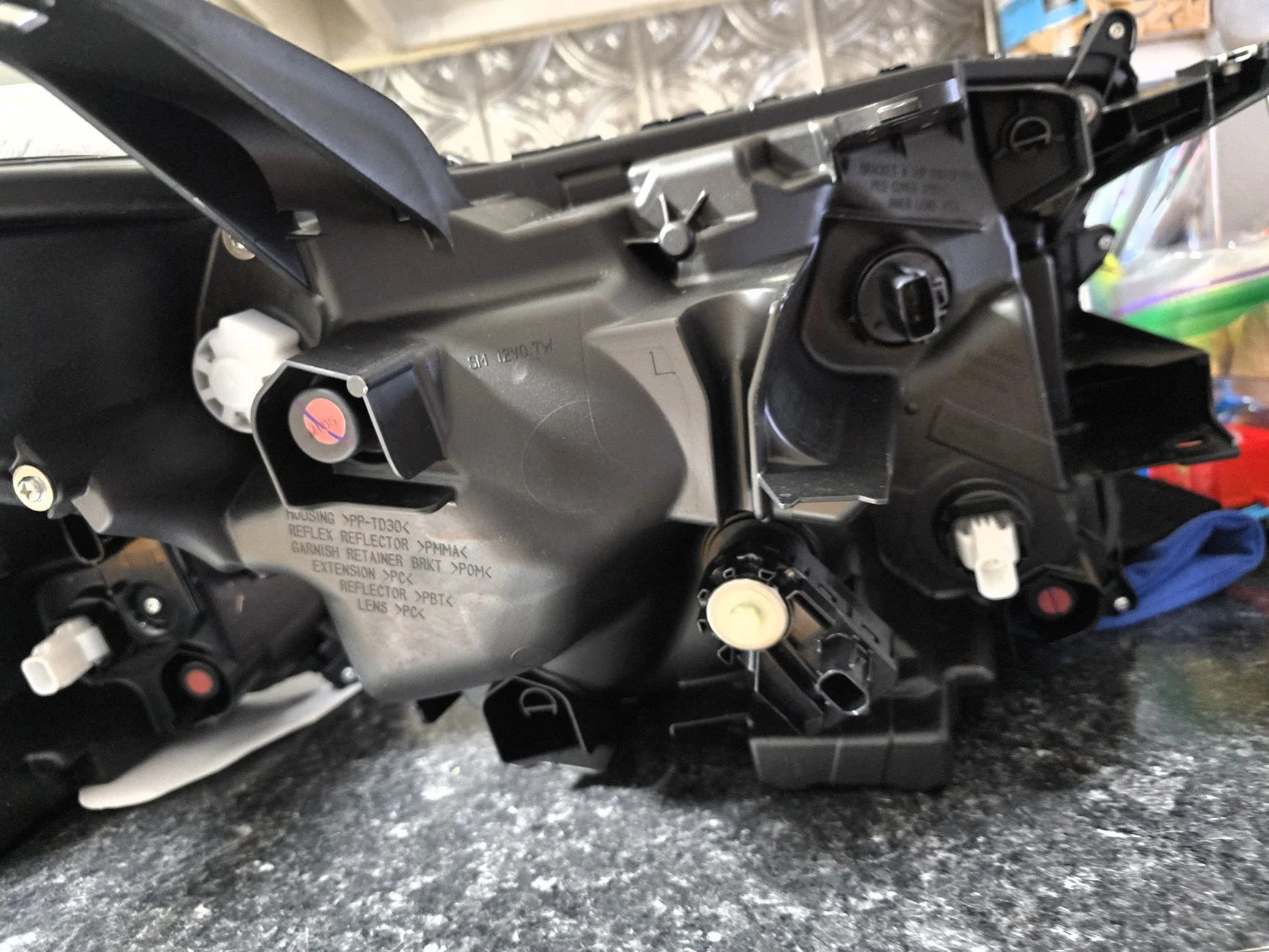

Limited(Premium) headlights have three connectors total:
  • One connector for the DRL/turn signal
  • Two connectors for the low beam and high beam
  • One extra connector that is not used (I pointed this out with an arrow in the photo of the back of the headlight)
The headlights can be adjusted by using the headlight leveling control knob on the driver’s side.
Overall, a straightforward install and a great OEM+ style upgrade.

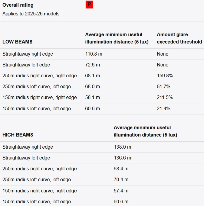

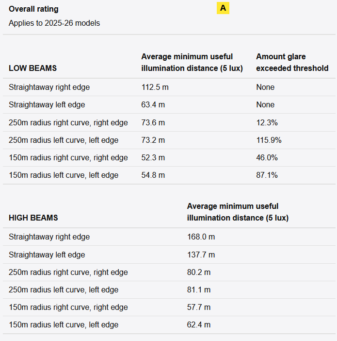

There is a material difference, but no active steering of light. The only instrumented test I'm aware of comparing the two are the IIHS headlight test, on which the lower trims receive a "Poor" rating and the upper trims receive an "Acceptable" rating.

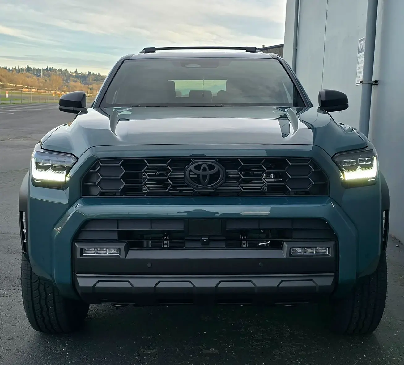

These look amazing, quit holding out on us Form

Oops, they had them on their 4Runner this year, too. Looks like they will have a selectable amber or white DRL, sequential signals, and a startup sequence.

If I am reading the data right the high beam improvement is very significant
CO/ZA
Mar 7, 2025
265
250
Denver
25 4R ORP
Sort of, yeah.
10m-30m here and there so 30-60ft distance/spread.
Some difference is noted, given the Acceptable rating vs Poor.
Is that worth the $2,000 investment though....
