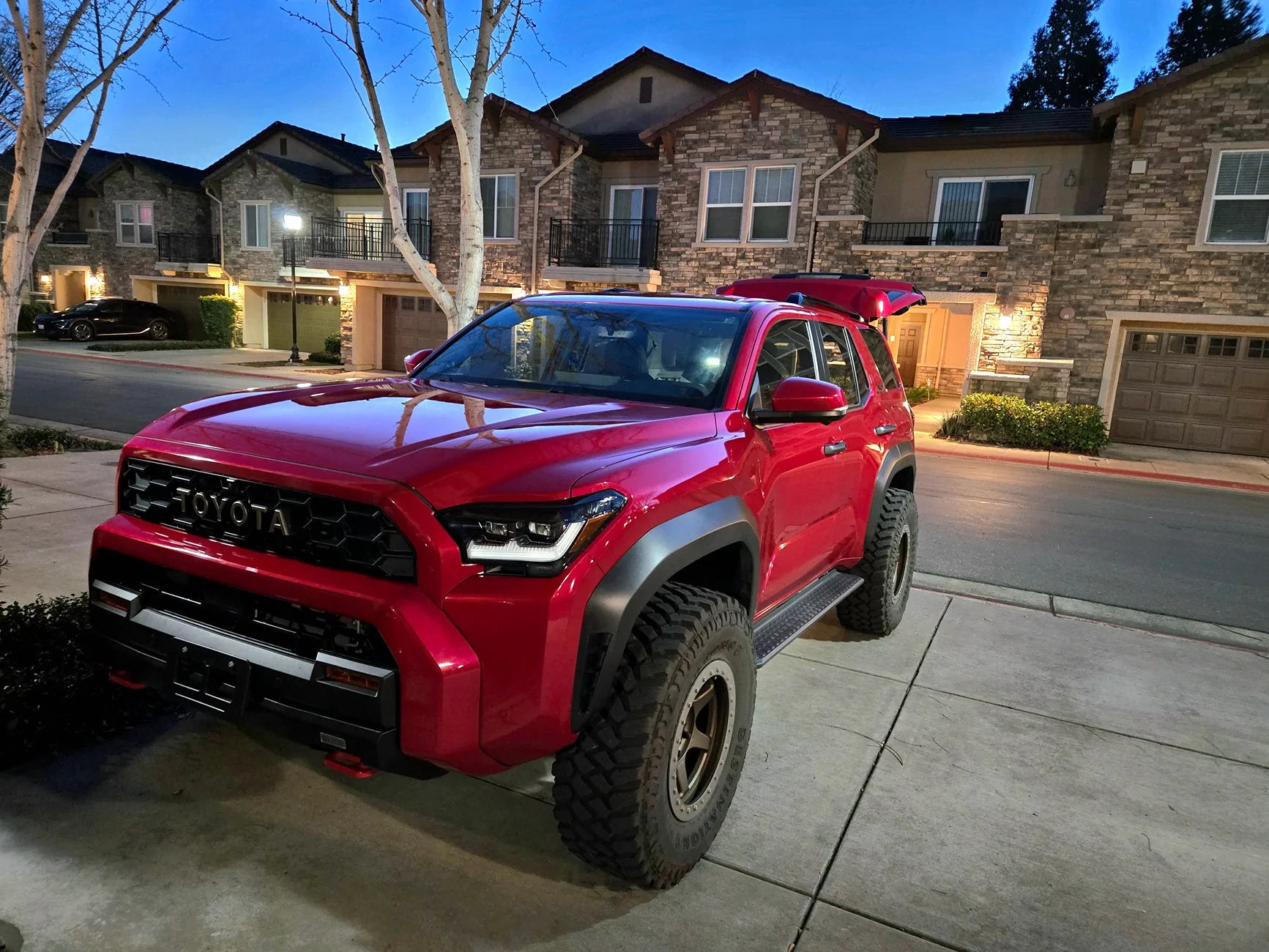

initially I was jonesing for amber drls on my SR5, but now I am getting real used
to the simplified look of the SR5 single projector with drl, low, high in one lens
I think it makes the front of the truck look tight w/o the extra lamp and
surround DRL (underground SR5 and I got black matte cover for the silver
toyota badge in the grille)
but if I had an extra 2 g to blow on lamps my first month, I'd have gotten
the trd pros. still might do it someday though 'cuz I do believe amber drls are superior
to white

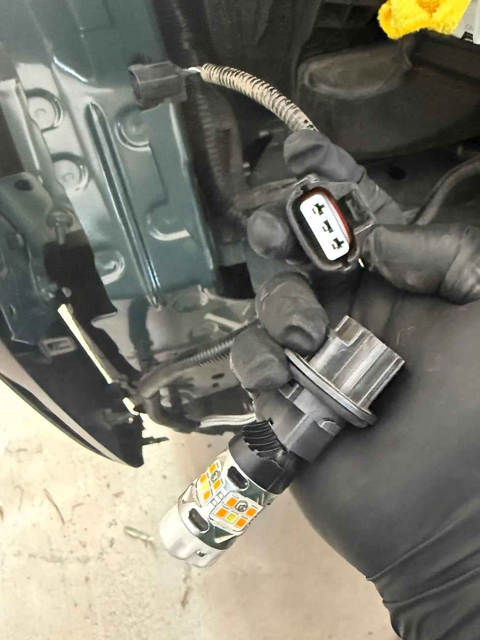

Honestly, replacing the halogen parking light/turn signal bulb with a LED switchback would probably do wonders on its own, without needing to drop almost 2 grand on a whole new headlight assembly.

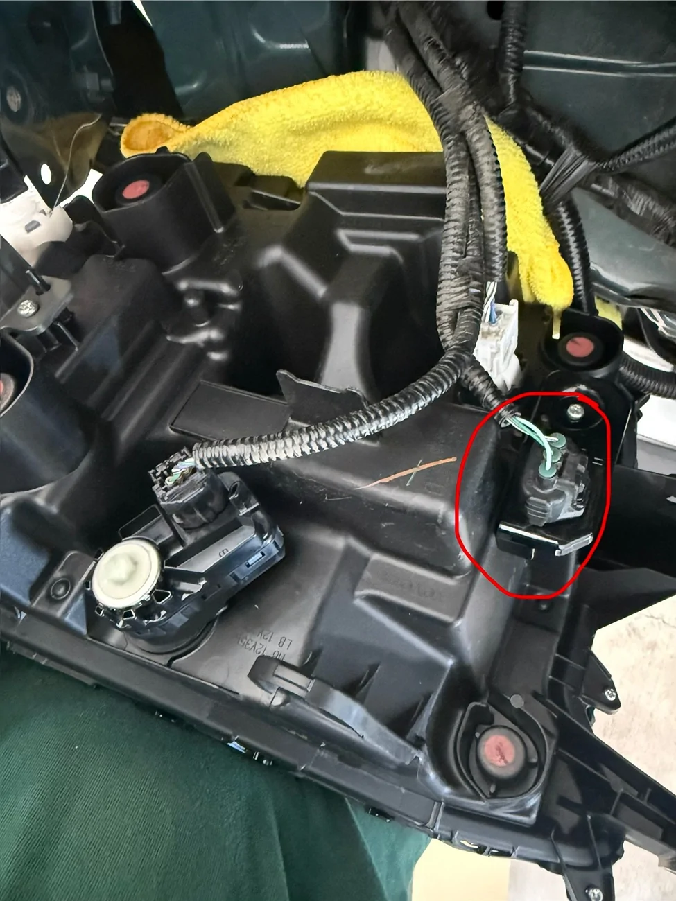

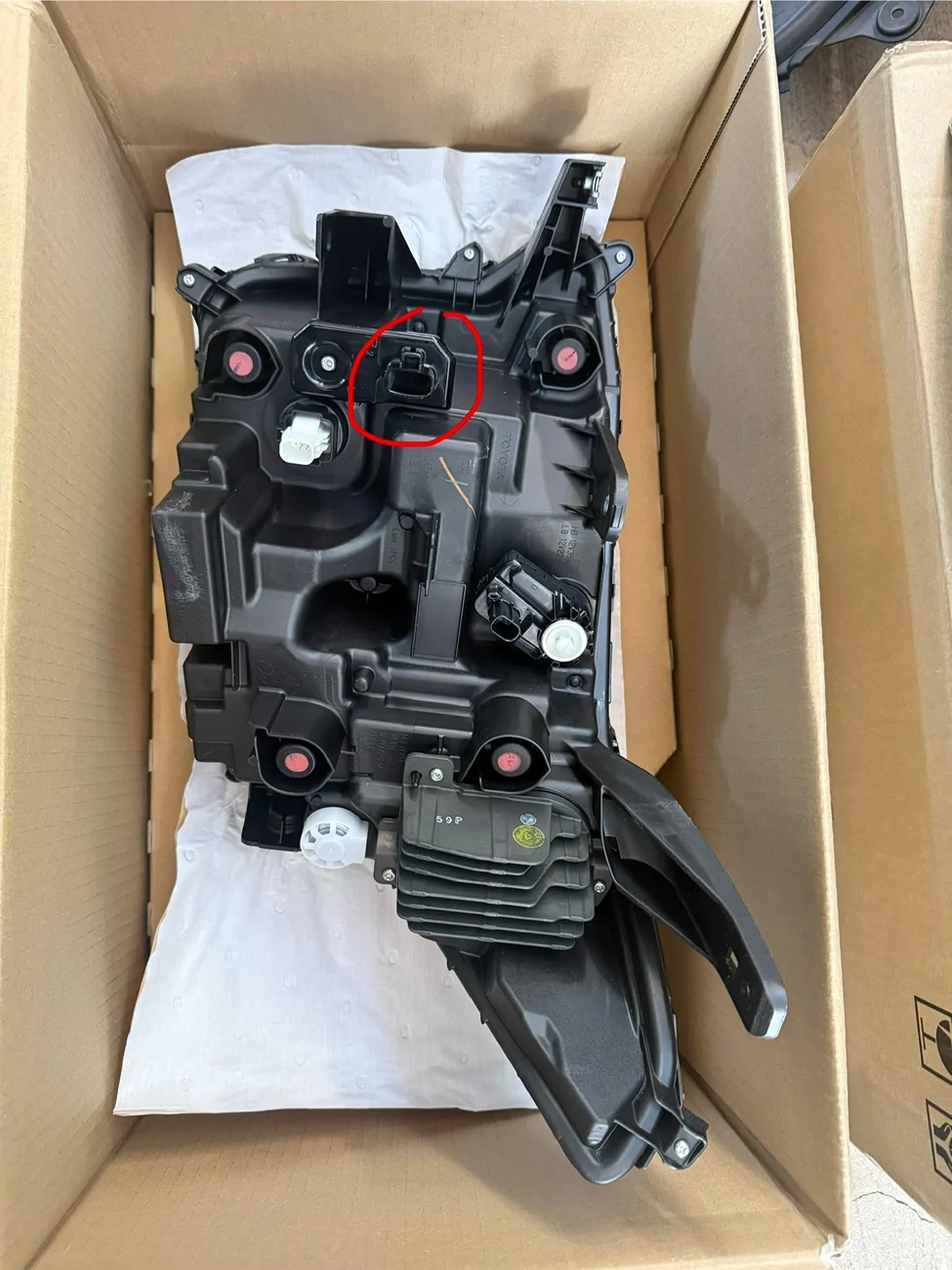

I installed some trailhunter headlights on my ORP this weekend. For anyone wondering about the dummy plug, i snapped some photos. Just have to remove the connector from the halogen bulb and snap it in place.
2025 2026 4runner 6th gen TRD Pro headlights & tail lights installed / swap on TRD Off-Road Premium ORP IMG_9187
2025 2026 4runner 6th gen TRD Pro headlights & tail lights installed / swap on TRD Off-Road Premium ORP IMG_9190
2025 2026 4runner 6th gen TRD Pro headlights & tail lights installed / swap on TRD Off-Road Premium ORP IMG_9189
Can you post some more pics of the trailhunter headlights on everest? I'm debating between the limited and the trailhunter lights
