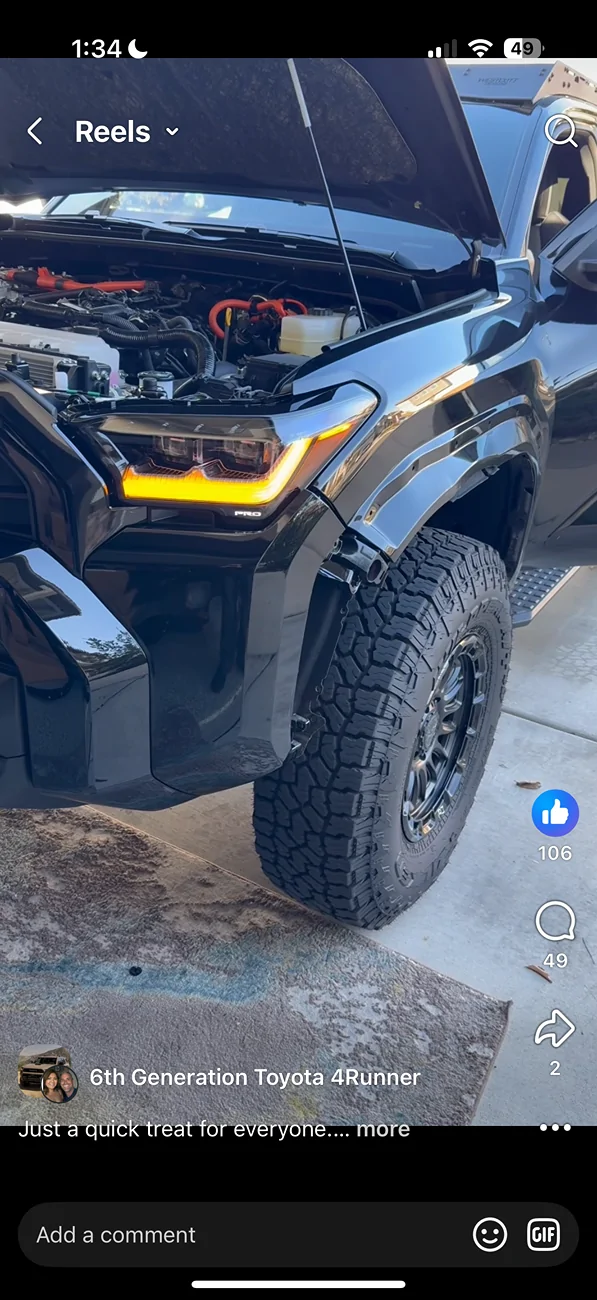

Hi all,
I am happy to report that the user who did the swap was a success. The TRD Pro headlights were a direct fit and everything works as usual including the leveling switch inside on the driver's side dash. He did mention that the premium headlights use one less plug, so one wire harness from the car gets plugged into a dummy socket on the premium headlight. It's like Toyota specifically designed it that way knowing people are going to do this swap.

Do we have a picture? 😬
