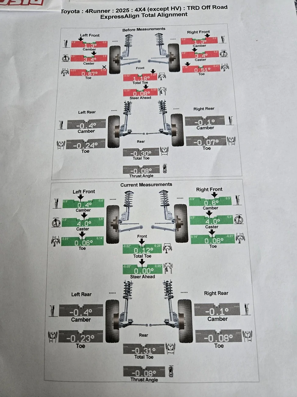

I've been through the manual and asked Gemini to check it too and there are no alignment specs in the manual that I can find. (Gemini Notebook said:
"The provided sources do not contain the specific mechanical wheel alignment measurements (such as camber, caster, or toe angles) for the 2025 Toyota 4Runner.)​
However, the manual does detail how wheel alignment directly affects the vehicle's advanced safety technology, along with the warning signs of misalignment")​
I've had two alignments done by dealer service department and both show before (with red on caster, toe, and total toe) and after (all green). So specs must exist.
When I had leveling kit put on by local tire shop about a year ago their system - just updated the week before - did not have the specs for 2025 4Runner so I told them to use 2024 Tacoma and that seemed to work.
Your dealer's service advisor should be embarrassed by their incompetence/work avoidance.

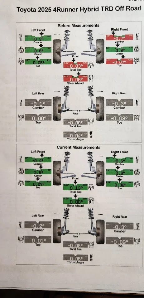

Here's a pic of my alignment at America's tire. I have a 2-in coil lift only to level.. I went the max that I could go with that type of lift. I don't think this pic will help you any because the dealership is struggling, I find that very odd as they deal with these all the time and this Gen6 has been out for 2 years now!

Weird. It makes no sense that Toyota would not have numbers, nor that a repair shop (Toyota or otherwise!) could not easily get them. On my regiular warranty services fro my '25 ORP they gave me a summary exactly like the one @MikeD showed above, so obviously they have the numbers. I cannot imagine the Trailhunter trim would be any different (availability, not necessarily the actual numbers).
