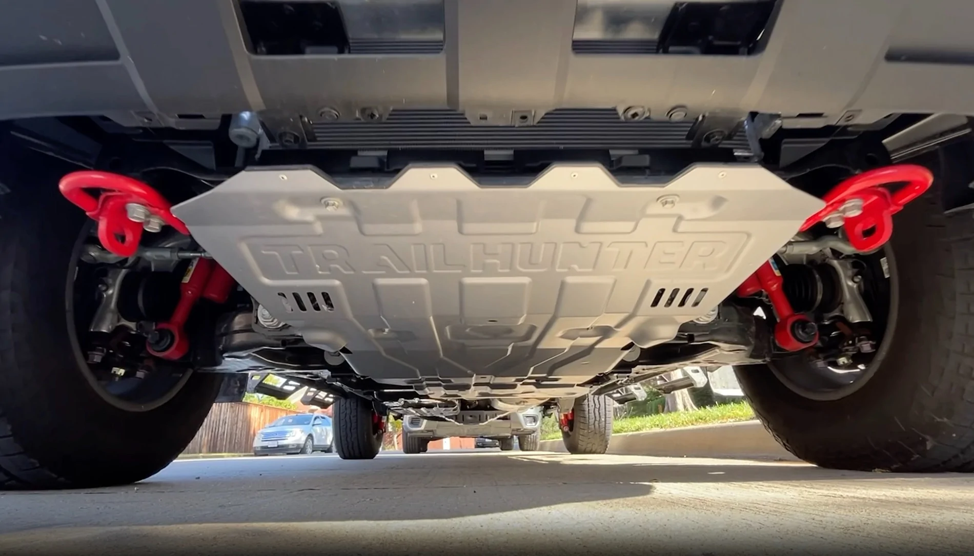

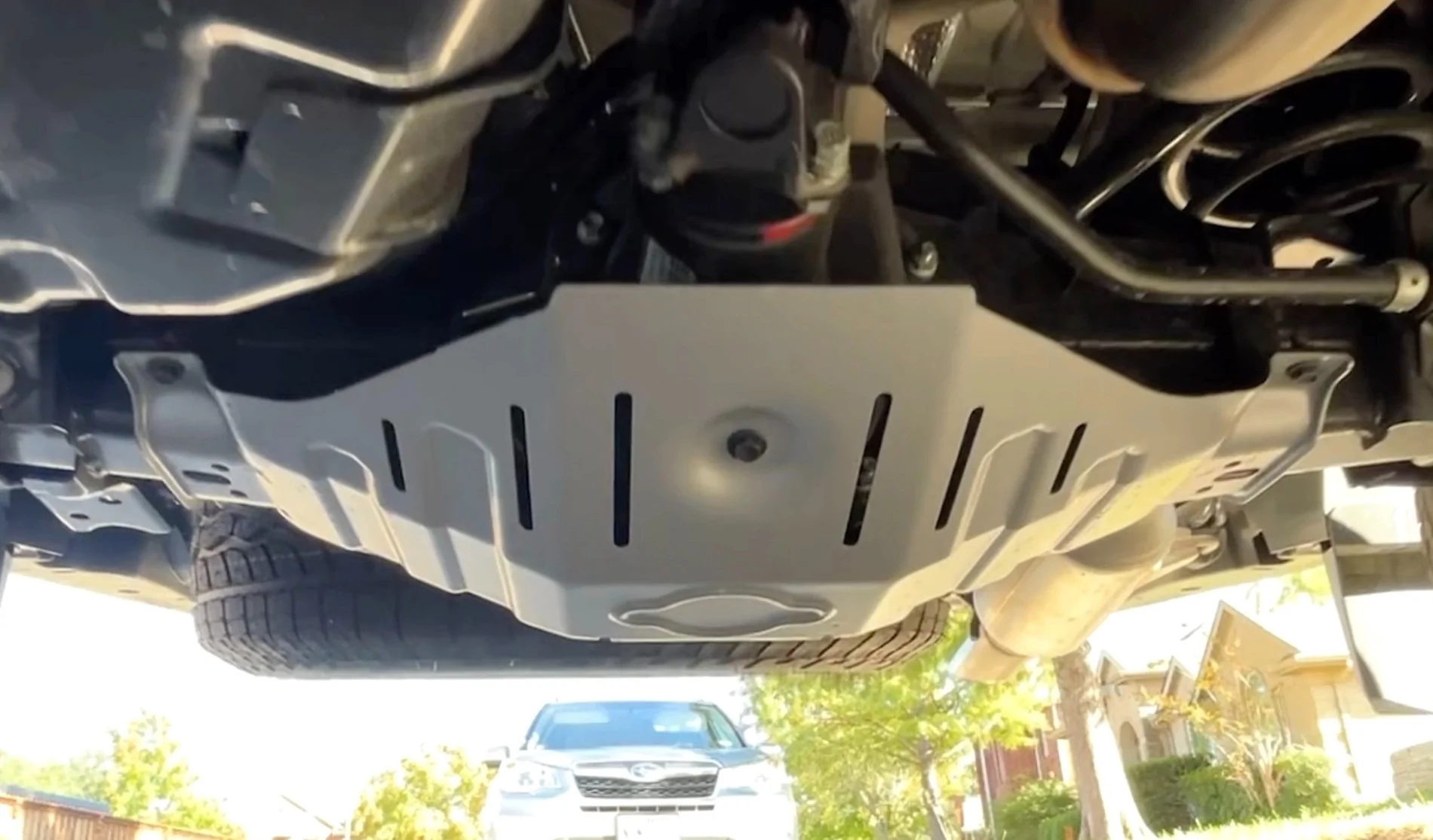

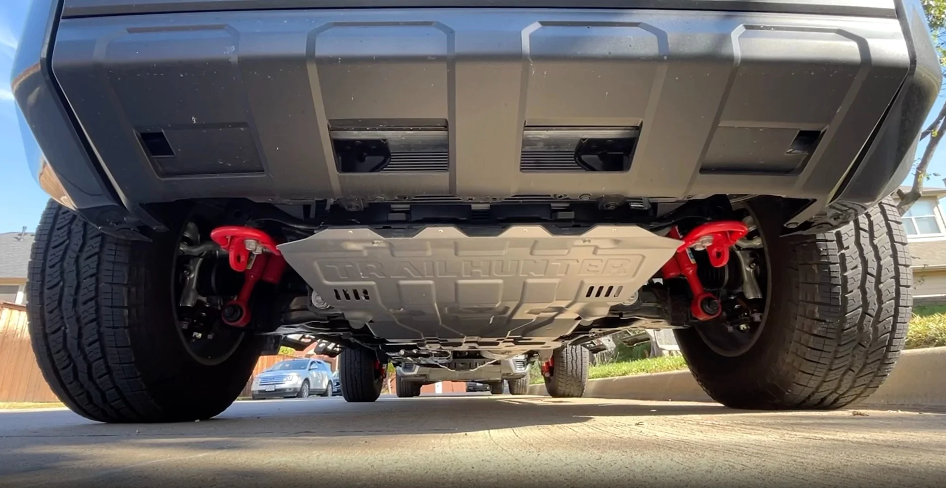

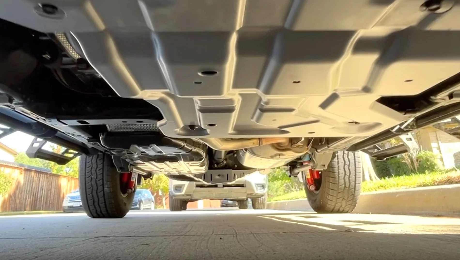

Finally got all 3 pieces OEM skid plates. These are hardened steel, thinner than the 1/4 inch aluminum TRD front plate.
I like the matching design/color scheme.
These part number are for gas model. Hybrid might be different.
Front: PT228-35240
Transfer case: PT228-35248
Rear: PT228-35245
Undercarriage video look:
Photos:

Quick questions:
  1. How does weight of these skid plates compare with aluminum from other vendors?
  2. Not having skid plates on my current 5th-gen, do they interfere at all with access to oil plug & filter?

Quick questions:
I dont exactly know the weight, i think someone on the forums measured it , not that much if a difference. Aluminum is going to be lighter by some pounds
6th gen OEM plates (either aluminum or steel) will need to be removed entirely for oil change (removed 4 bolts completely, loosen other 2 bolts and slide the plate off). Not hard at all, just a big bulky if you dont have lift/jack. I can shimmy my way under the vehicle on the ground to get it done. Other 3rd party plates have cutouts for access.

Those are the factory recovery points...you had them painted/powder-coated red, right? I know Toyota has red aftermarket hooks, but they ain't it, and pix I see have them as black. I got mine powder-coated on my SR5 and love it...was just wondering if Toyota did offer them in red as well.
You’re correct, i cleaned the OEM, sanded them a little, rubbing alcohol cleaned, and can spray red. It worked out well enough, and I dont have to spend much.
Toyota does have their own, as well as many other third parties.
