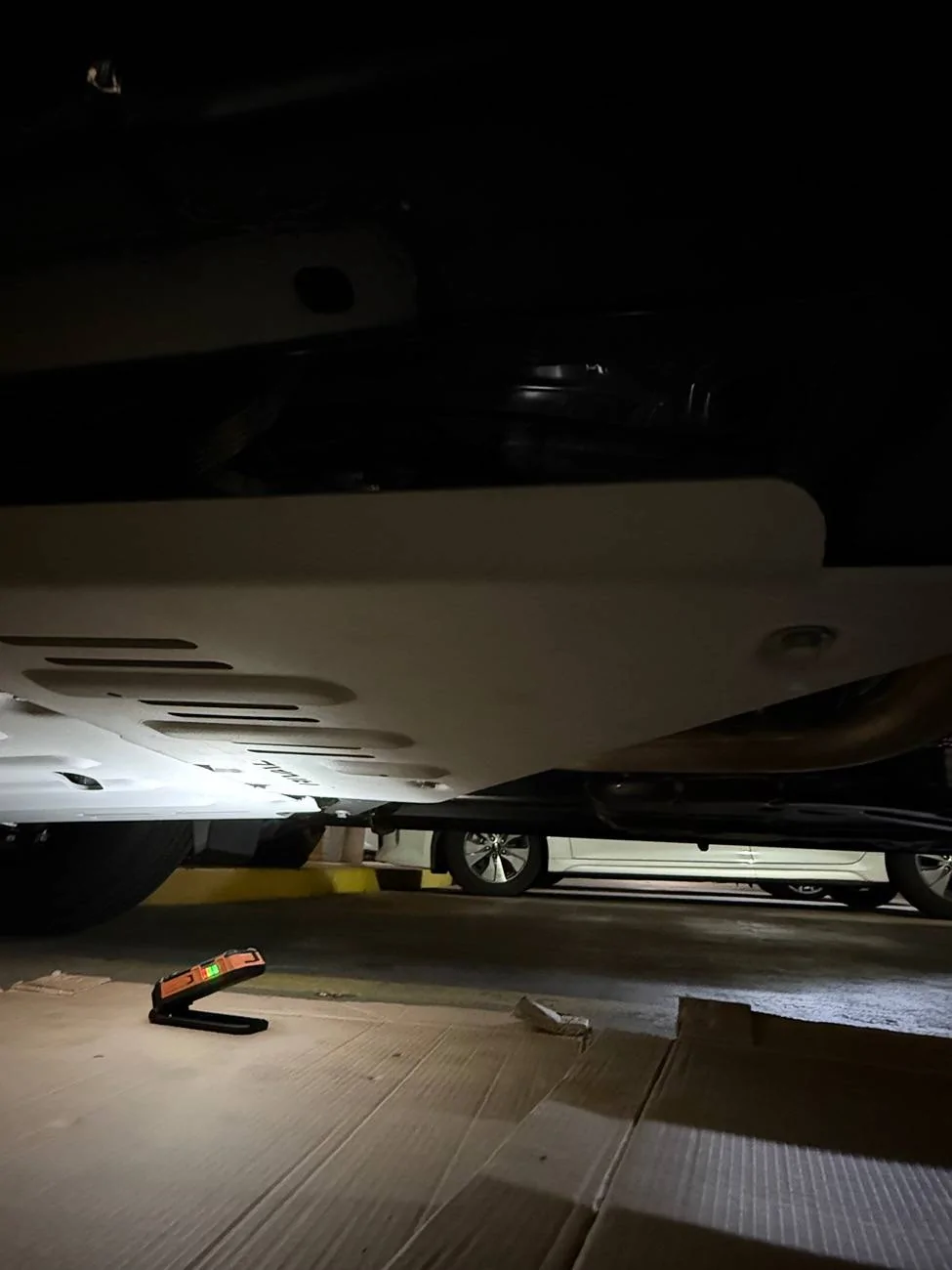

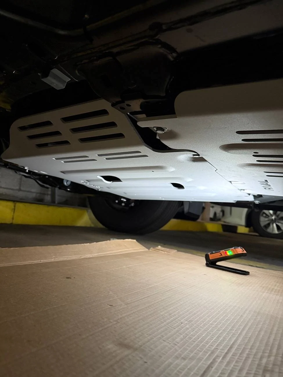

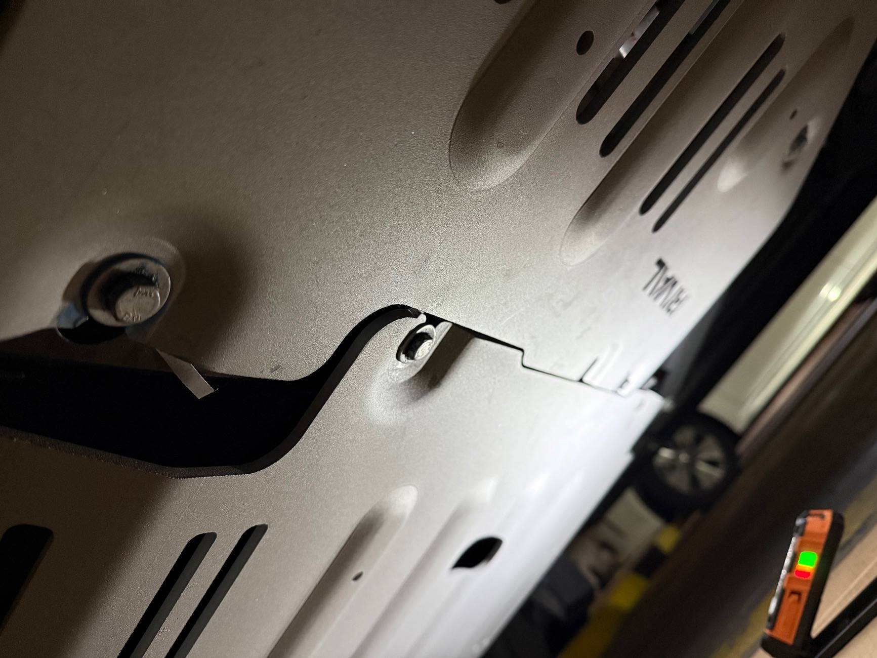

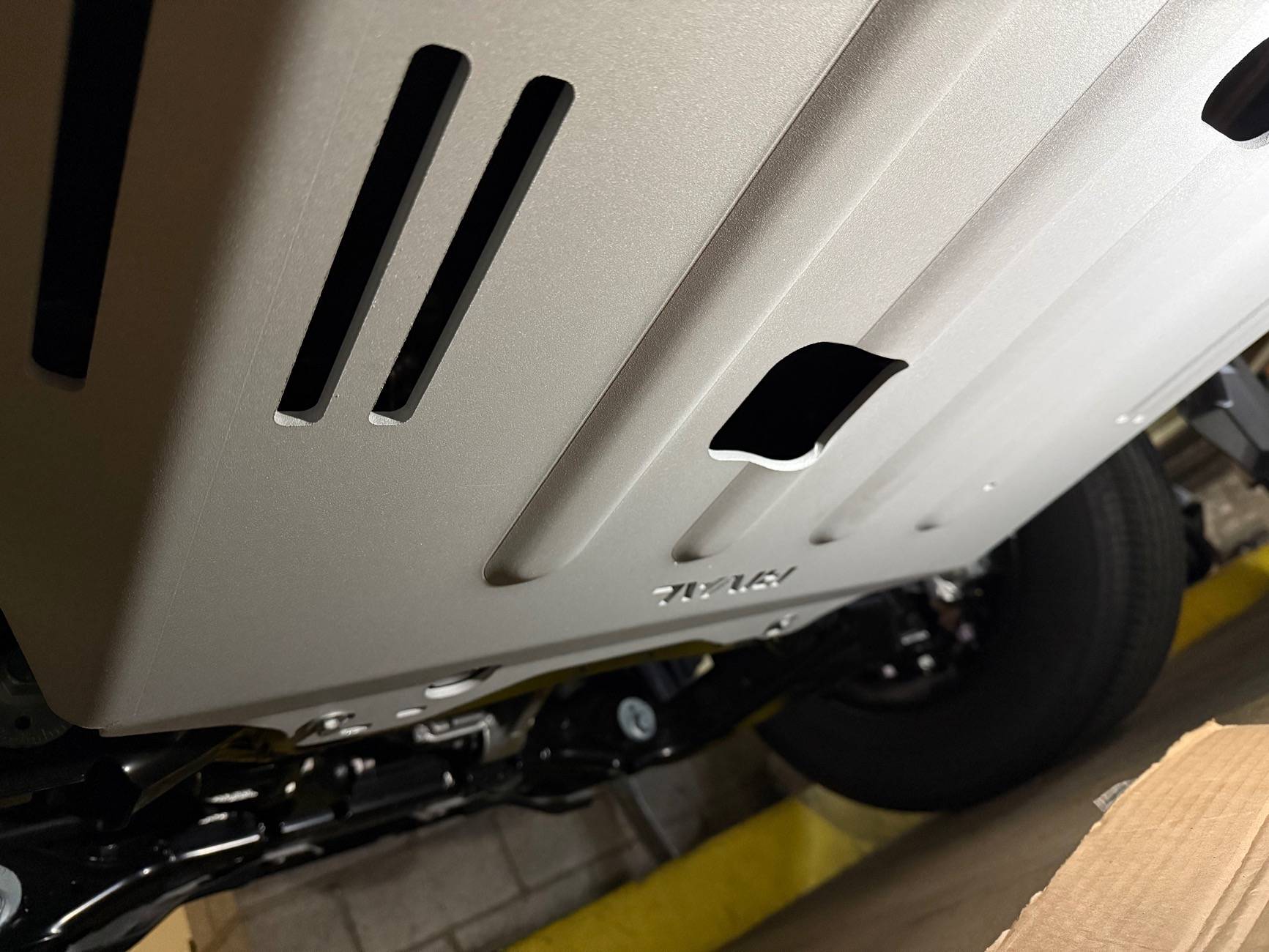

I got the bundle during the Memorial Day sale and received the transmission/catalytic converter and transfer case skid plates in about a week. The engine skid was done as pre-order so I am just waiting for that.
Install took about 1.5hrs because I didn’t have a lift so I was just scooting in and out on the cardboard boxes they came in while the front driver side was elevated on two 4x6s. I would say it shouldn’t take more than 30-45 min if you have a lift. Maybe less. I work pretty slow too. Didn’t help that I had to exchange the torque wrench I bought for the job because it didn’t work right.

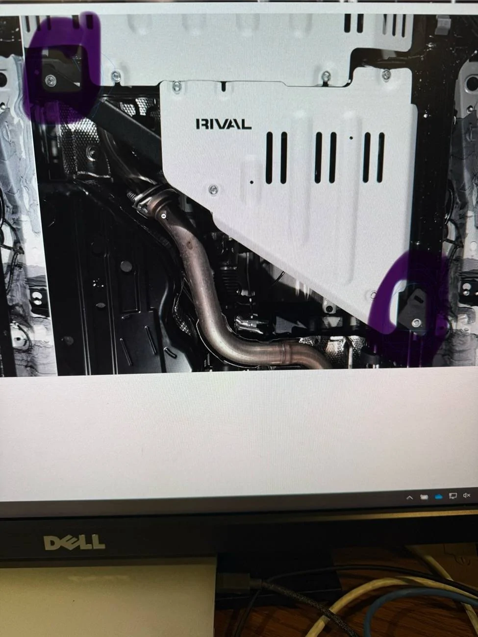

The instructions are easy to follow even if you were just to look at the pictures. I had a tough time installing one of the wired nut things. I got it in right eventually and am not sure if having the truck on a lift would have made a difference. I circled in purple the 2 bolts for the transfer case skid mount that the instructions said to tighten right away. DO NOT do that. It’s a super tight fit with the transmission skid in place and the holes may not line up unless you leave the diagonal mount loose.
Note: I did not find transf case instructions on the website but they were included with the part. I googled today and found on the European site that the instructions are there for tacomas and it does say leave the bolts loose until later

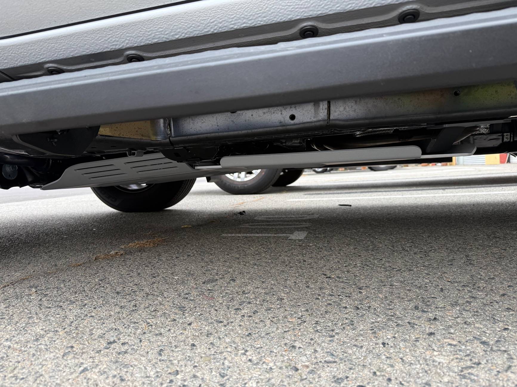

I did end up using loctite(blue) because I would hate for one of these to come loose on the freeway or something and ruin someone’s day. I don’t do any off-roading yet but I really want to. It’s the reason we got the 4Runner. Hopefully these are good. They felt really sturdy. Another thing that you can’t really see on photos from directly underneath is that the plates kind of sit zig zagged like up and down. Imagine a flattened letter W or M. It’s noticeable when looking from eye level under the tube steps. Not having done any of this before I do not know if that’s normal or not. I did wonder why the diagonal mounting bar for the transfer case skid plate angled down towards the ground when it looked like it could have been attached to the truck with the angle going up into the void behind the transfer case. I just figured the manufacturer knows better so I installed it the way it was pictured. This is definitely a job someone can do on their own and it can be done much safer than the way I went about it. The bundle deal for all 3 parts was excellent compared to what I’ve seen from other companies and I like that the transmission skid was one piece that covered the catalytic where others sell the cat cover separate.

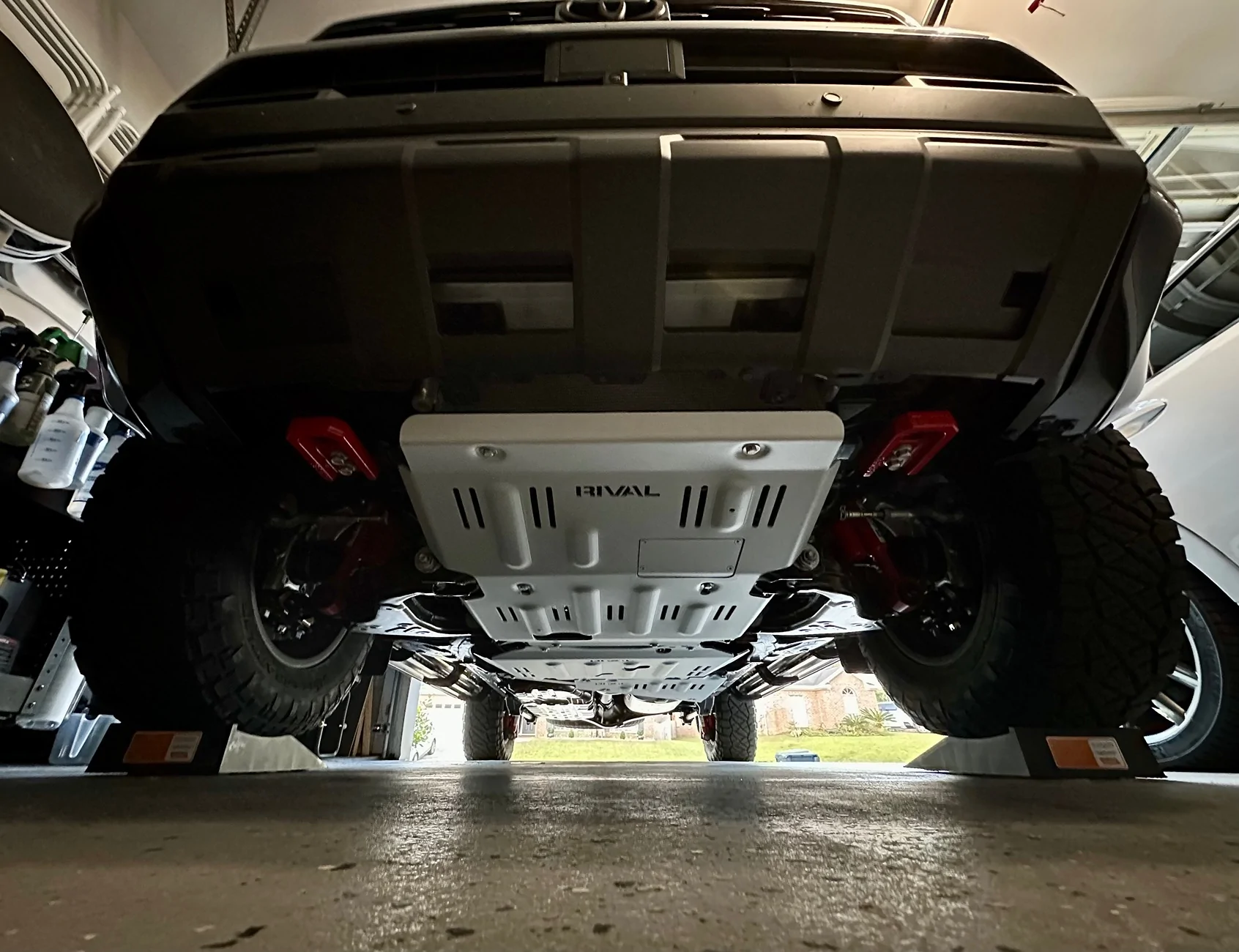

I just installed mine this afternoon. The quality is good but not the fan of the hardware, I think it could be better. It took me roughly an hour and half to do all 3 skids. Overall, I’m pretty happy how they look.

It’s the bolts and washers. Washers started bending after torquing to spec from the directions.

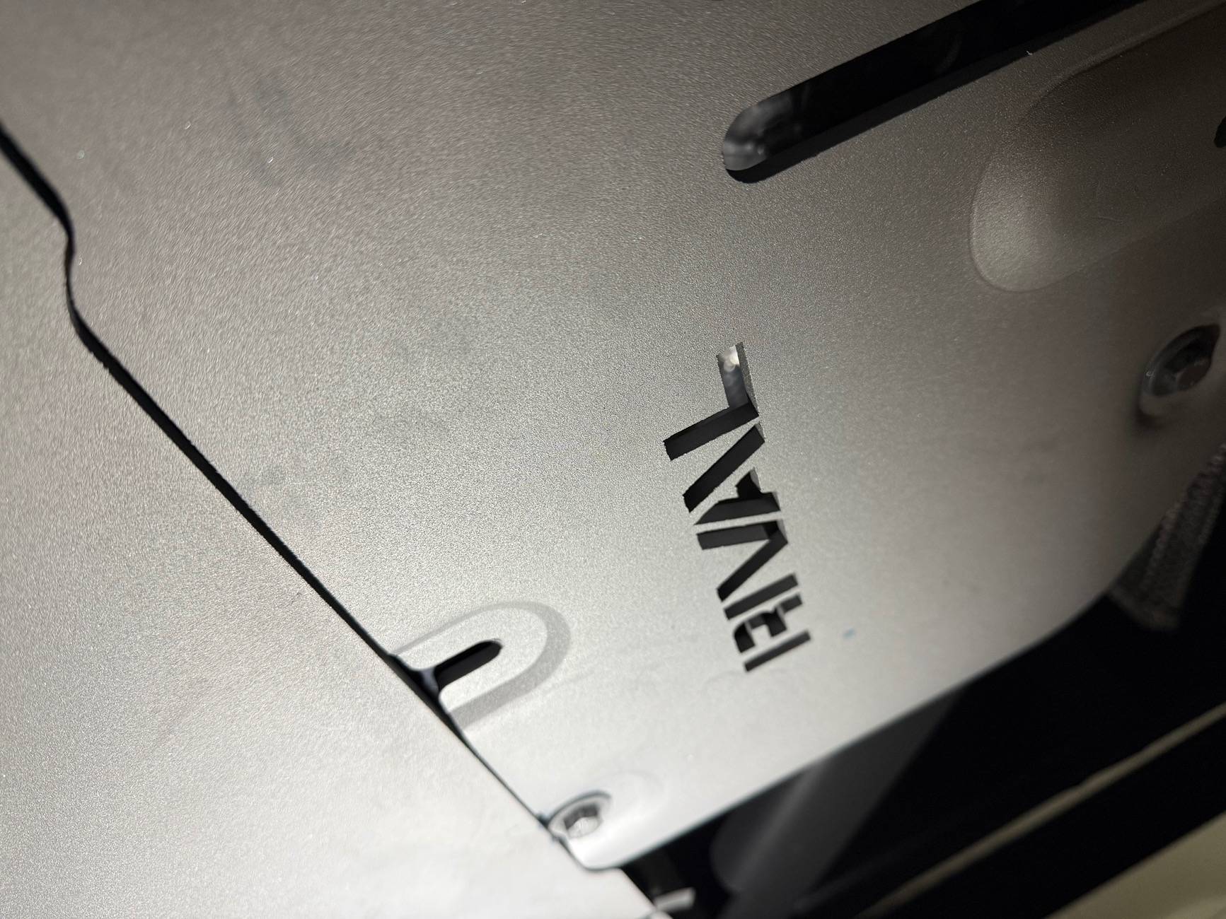

Got the engine skid installed yesterday. I used the bolts I bought, but the washers provided by Rival were much larger OD so I used those instead of the ones I picked up from McMaster. I also experienced some minor bending of the washers at 17.7 ft lbs.
Overall very happy with the skid plate. The powder coat is definitely not the best quality, and there was some damage to the coat where zip ties were attached through some of the bolt holes. Not a big concern since it’s aluminum and lives under the vehicle anyway.
