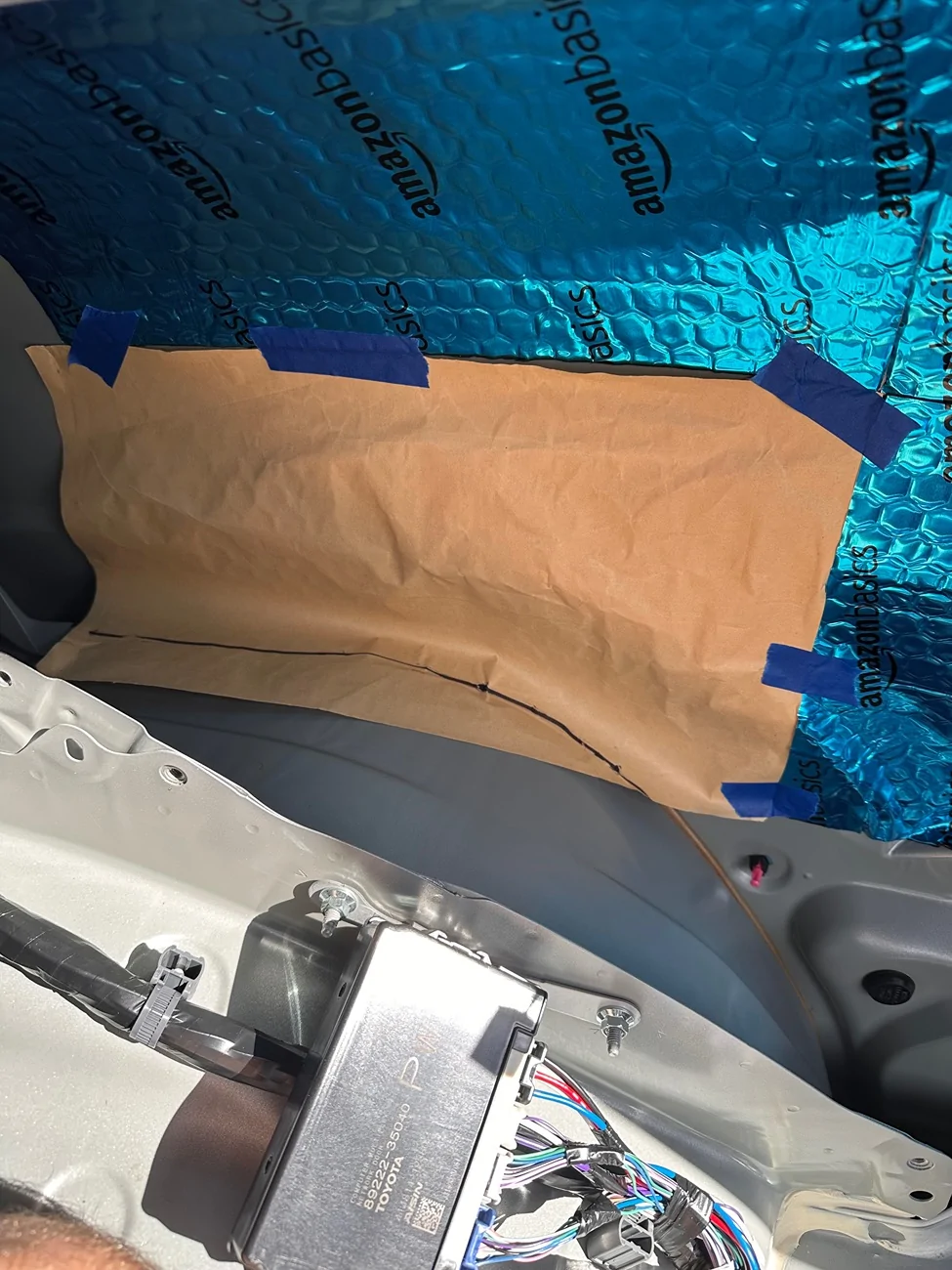

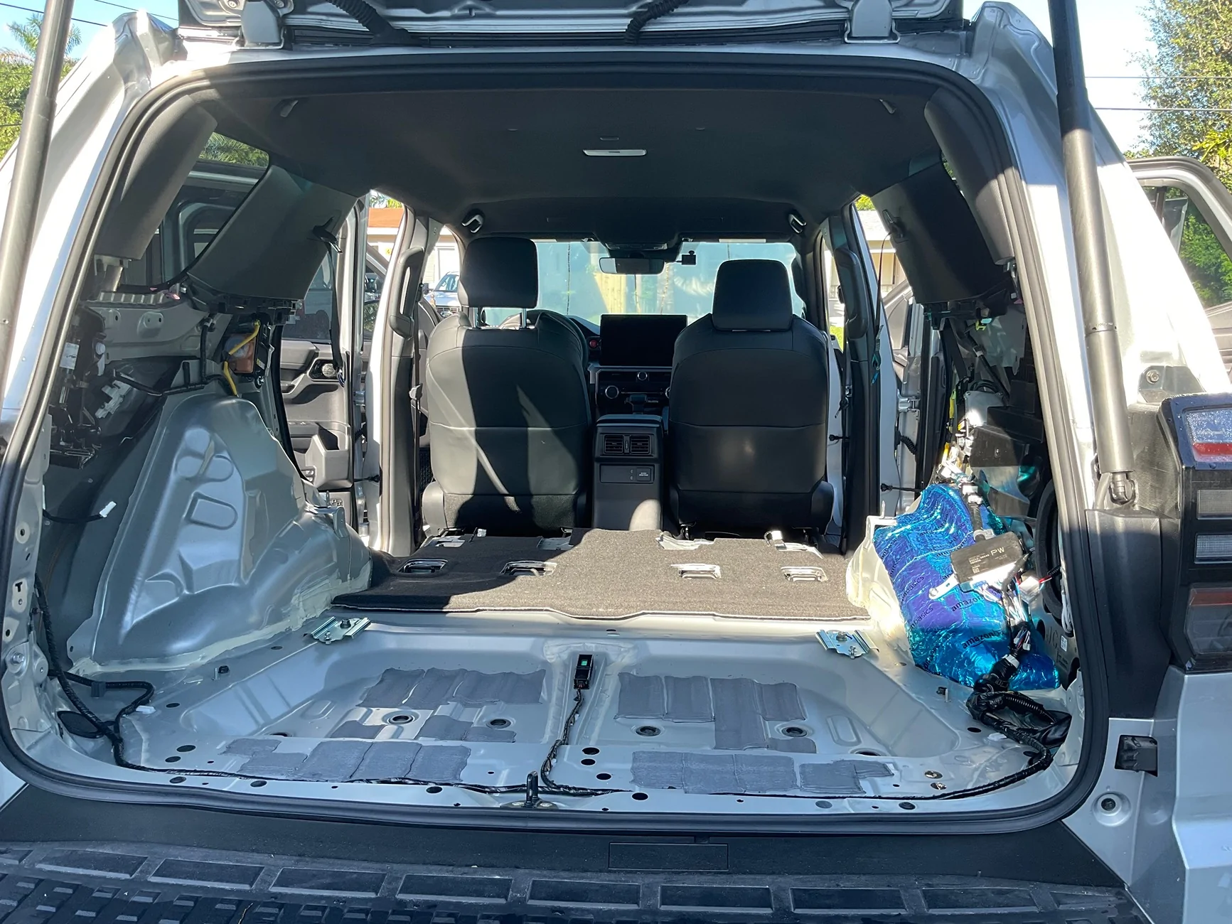

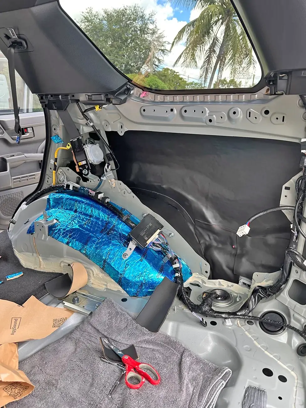

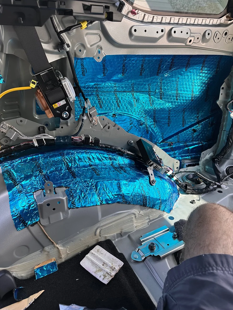

Started sound deadening the interior. Want a quieter ride and hopefully helps on the sound quality of the stereo system. Using the stuff from Amazon. Considerably cheaper than Dynamat and the like . It goes down the same, doesn’t smell. Topping with a foam layer.

I see a huge cavity in the floor of your first photo. Is that "usable space" for storage or not readily accessible? I tried to lift the floor up quickly and it didn't come up - I then assumed it was flat below there since the spare was tucked up pretty high.

I did the same thing to a Tacoma that I had. I had another post addressing the dead space in the floor. Still brainstorming on it. I have seen a factory storage piece that goes there but have not researched it yet. I believe it’s available on SR5s.

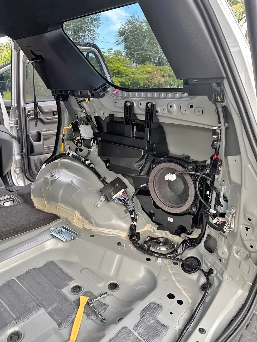

Is that the JBL subwoofer?

I think that cavity is for the hybrid battery and the 3rd row seats

I’d personally aim to delete the JBL sub from the rear and gain more storage space like the SR5. This is the first view I’ve seen that shows the full sub enclosure.
Does it look like something you can simply unplug and remove from the system without issue or did you discover the amp back there as well?

the space is where the 3rd row would mount. I'd someday like to use the space. There is another build a company is doing and I sugguested they make a "door" so that the space can be accessed would love to keep recovery gear etc in that area.
