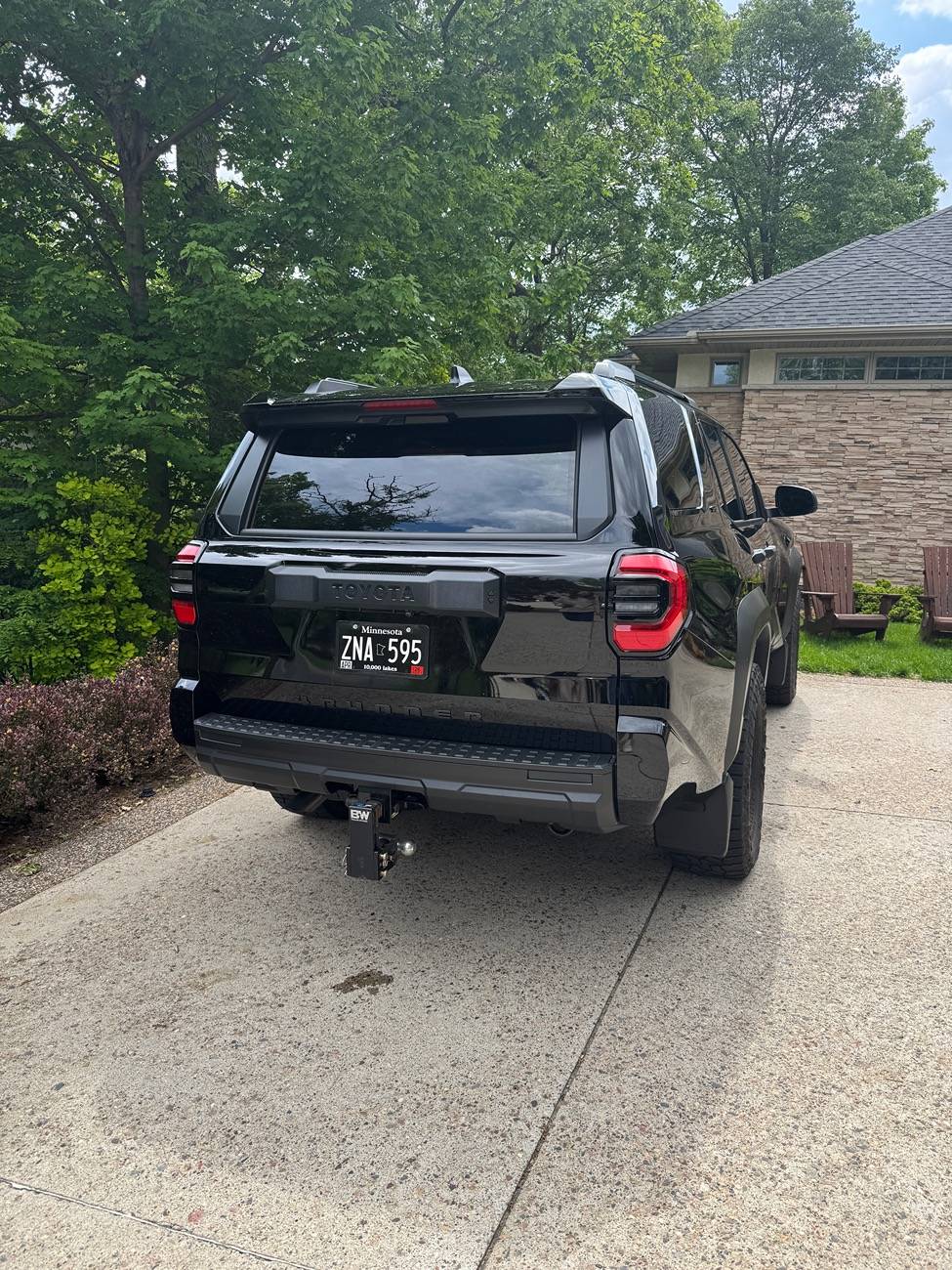

There Falken Wildpeak 285/70/17 load Range E. Got them slightly used on Facebook. Haven’t noticed much in mpg but I also went into it knowing I’m not gonna get great gas mileage so I try not to pay attention to it lol. More about the smiles per gallon for me. I took the air dam off right away but I did a roadtrip to Omaha from Minnesota and think I was getting around 20mpg without the air dam on stock tires. Just checked today after bigger tires for a few days and it’s sitting around 18.5mpg but mostly city driving.
Yep, sometimes you gotta live for the smiles lol. Ok cool, yeah, I’ll be taking off the air dams for sure then. Still looking into the different tire options. Appreciate it!
