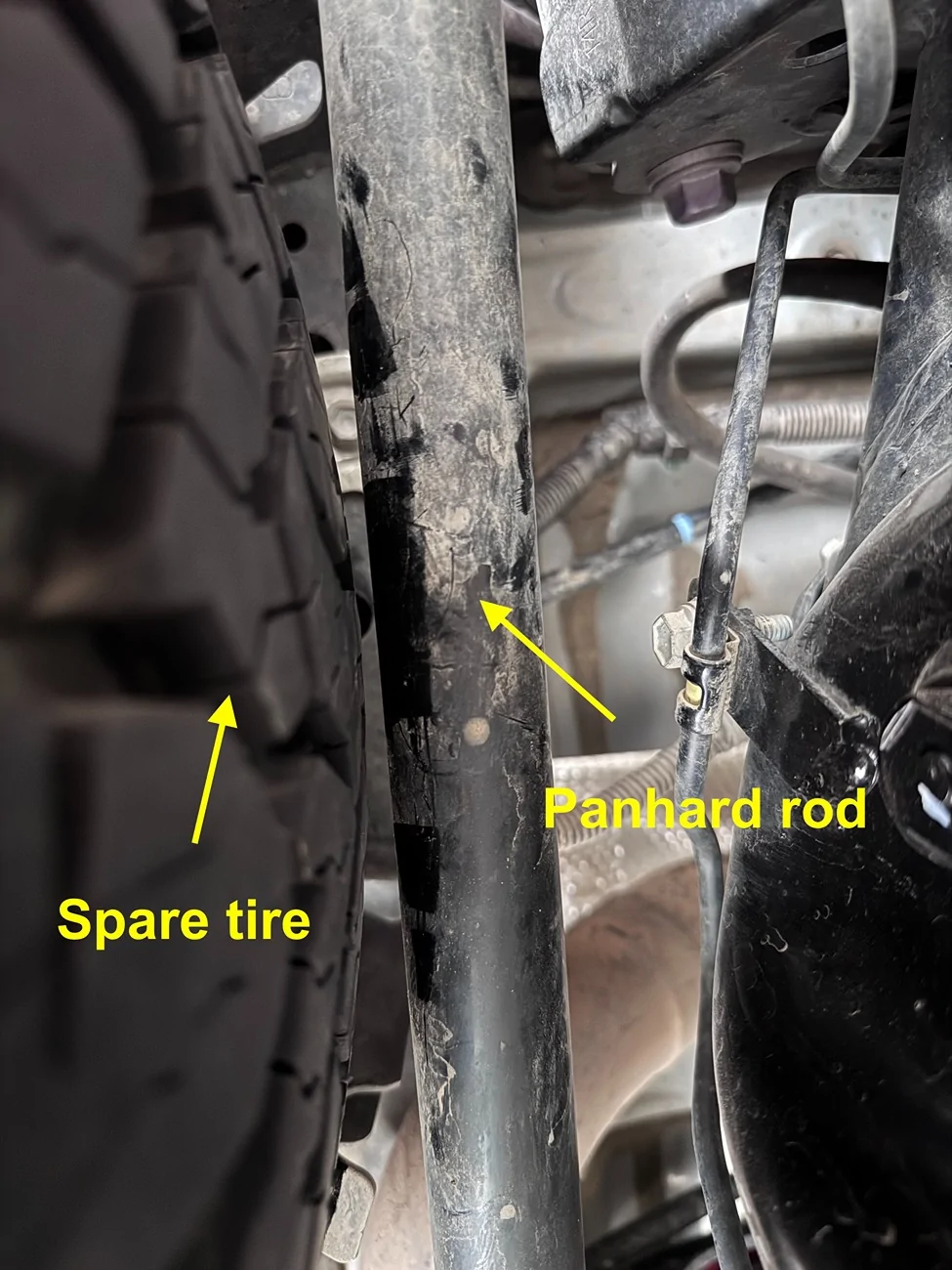

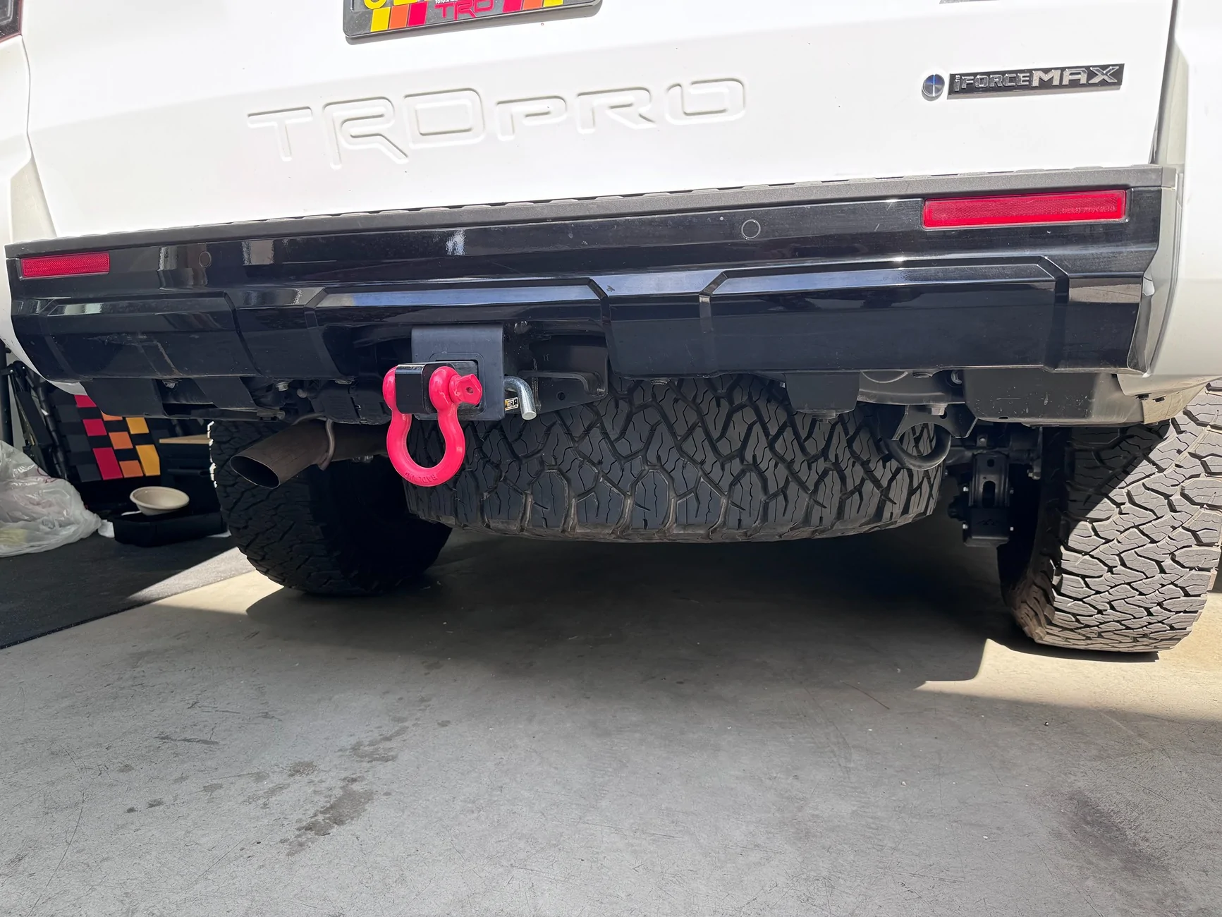

For anyone wondering if a 285/70R18 KO3 (E-Load, ~33.6") fits in the factory under-bed spare location: The good news is: Yes, it fits without modifications, but it is really tight... No need to modify the bracket or anything, but you have to intentionally push the tire back toward the hitch while cranking the chain to leave about 1/5" of distance to the panhard rod.
Concerns: That 1/5" distance is close enough to risk rubbing when the panhard rod moves during off-roading. Also, because the spare tire hangs significantly lower than stock (due to increased width), it will completely ruin your departure angle and will likely strike rocks on technical trails.
I will go with this as a temp solution but eventually I think I will have to install a tire carrier.

Damn... is it the angle in rear is looooow. i know KO3s are heavy but damn

yea, this might be ok for some mild overlanding, but definitely not ok for rock crawling.

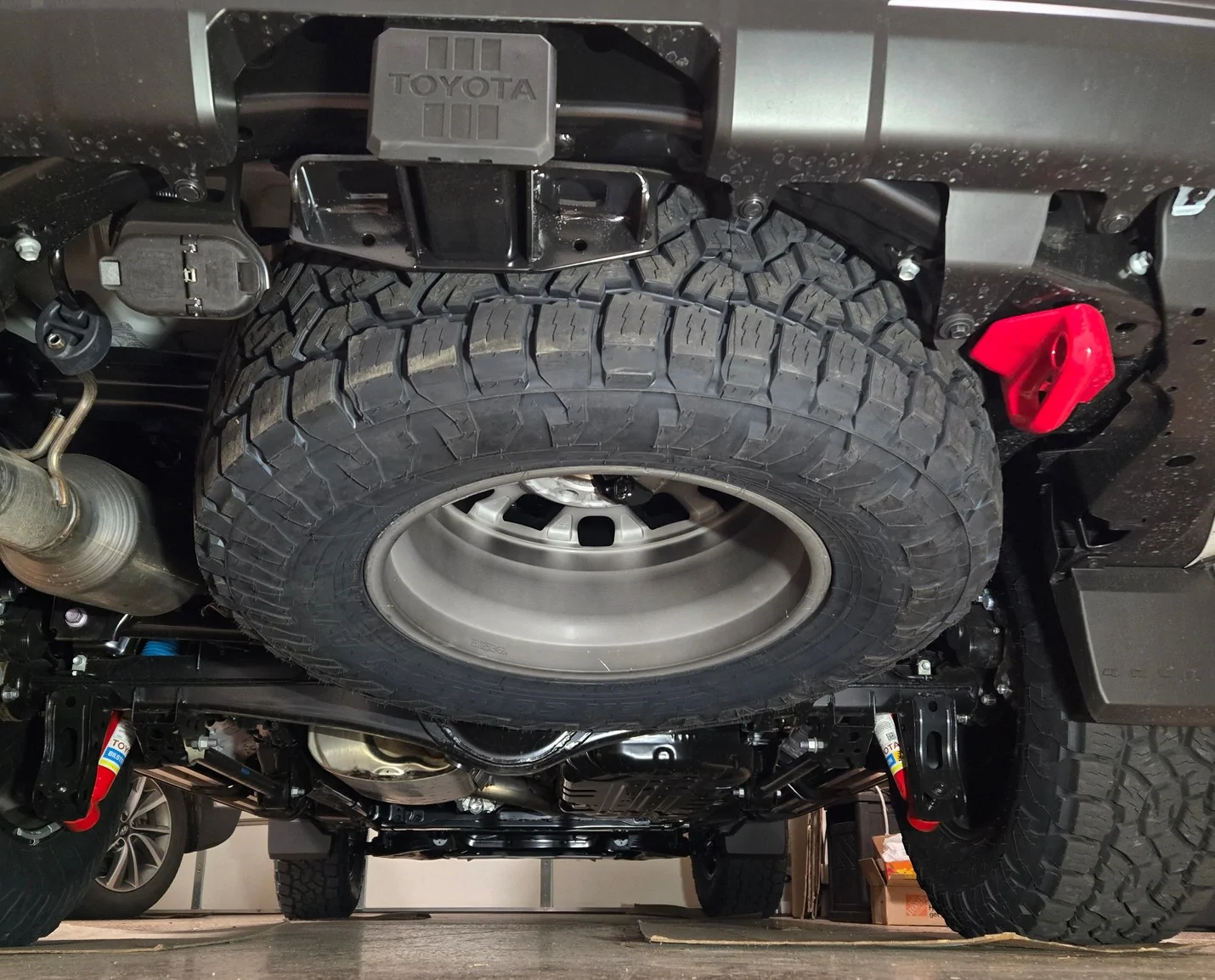

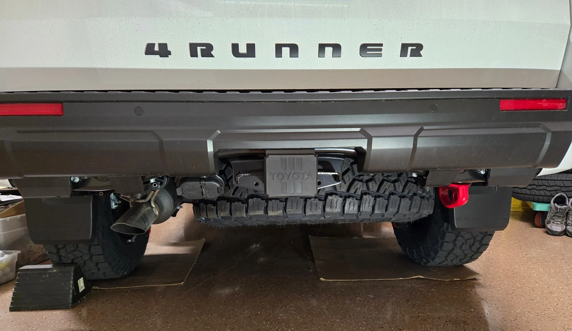

Are you sure that spare is fully seated ?
Here's my Toyo OC AT3 LT275 /70 R18 125S E1 spare.

It was fully seated. I think it's just my tire is slightly bigger.
