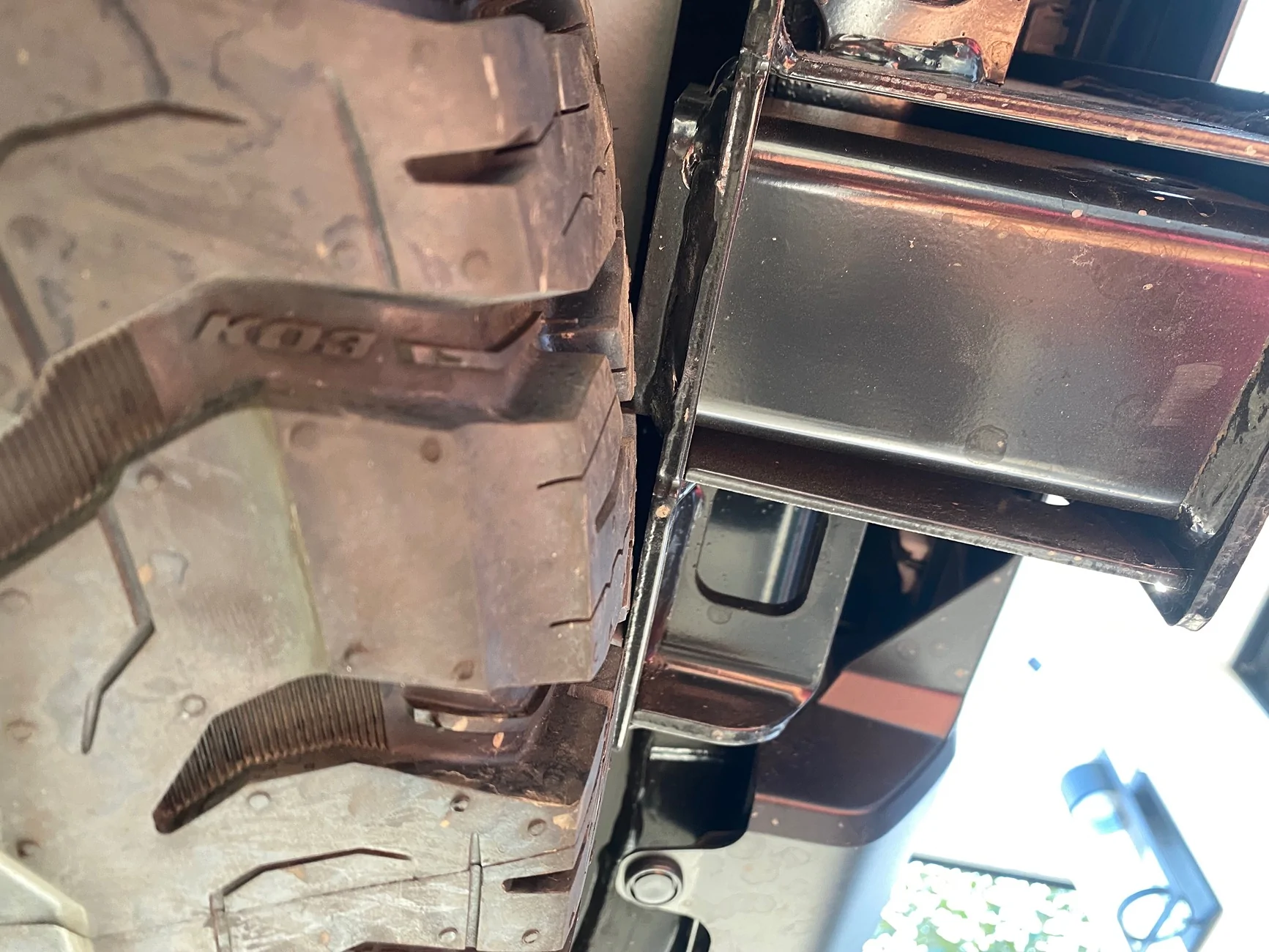

Here's my take from everything posted, including my own experience. I'm thinking the profile of the actual tire you're installing is very relevant.
32.6" stock obviously fits fine. pic at front bracket attached for reference of how stock tire sits.
33.5" Toyo AT3 fits per MPS2026. photos shown in their posts above.
33.7" K03 fits with mod to front bracket - this is my setup with 285/70/18 K03. Pic of modified bracket attached.
33.9" Toyo AT3 285/75/17. Comments above make this an interesting one. A 33.9" would definitely not fit if the tire profile was like my K03. With a more square profile like the K03, the tire would hit low on the radius of the front bracket and not be sitting flush against the horizontal surface meant for the tire to be pulled up against. Maybe it works if the tire is rounder vs more square???
@Van Solo - maybe it's worth a check to see if the AT3 profile would allow it to fit?? Maybe the tire profile is different enough based on 3rdRunner's experience.
@3rdRunner - Would be great if you get a chance to post a pic of the tire at the front bracket (and maybe above) to give anyone else checking this thread as much real-world experience as possible.
I've included a pic to show my tire sitting flush/tight against the horizontal portion of the bracket. I'd want to make sure this was the case on any larger tire as I wouldn't want the tire only held against the radius of the front bracket.

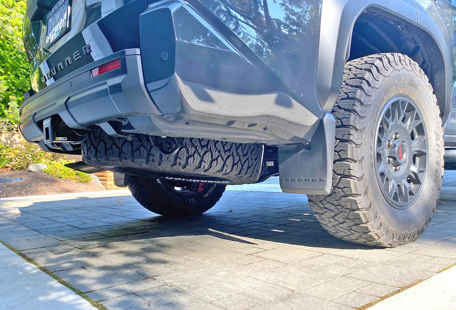

Just put 285/75r17 AT3 on the truck, now trying to decide what to do about a spare... the pics above and some others I've found make it look like a major issue for departure angle. So I am thinking of going with a 34/10.5r17 AT3. Only .4" smaller diameter than my full size tires, and .2" wider than the stock spare... I hate the way they designed this on the 6th gen. My 5th gen has a full sized K03 tucked nicely out of sight.
