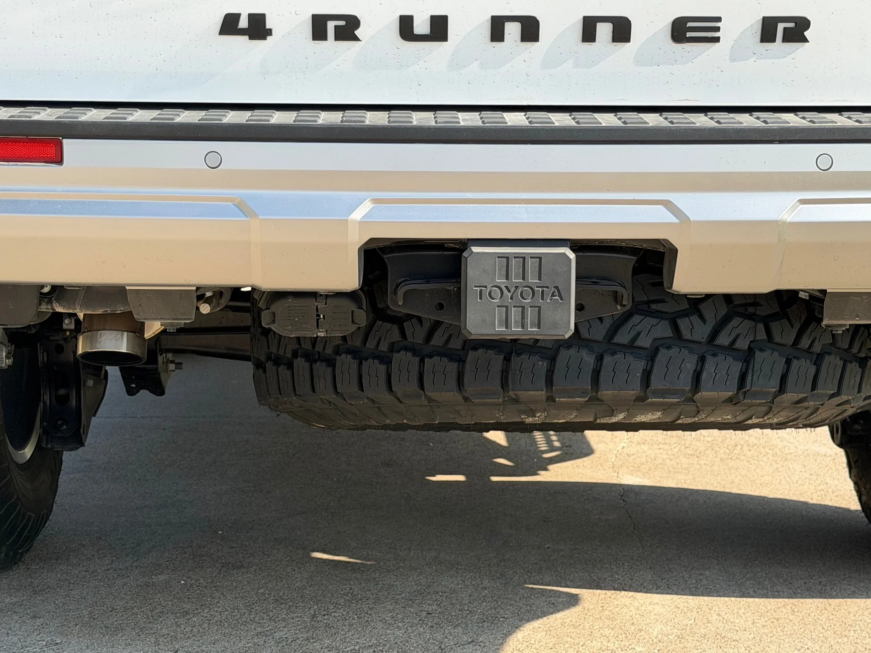

3rdRunner
Bill
Jan 13, 2026
222
161
It’s snug but fits. It hangs pretty low due to the width - someone commented it looks like a full diaper. Don’t know how aggressively you off road but I drug it on departure several times. No punctures though.
