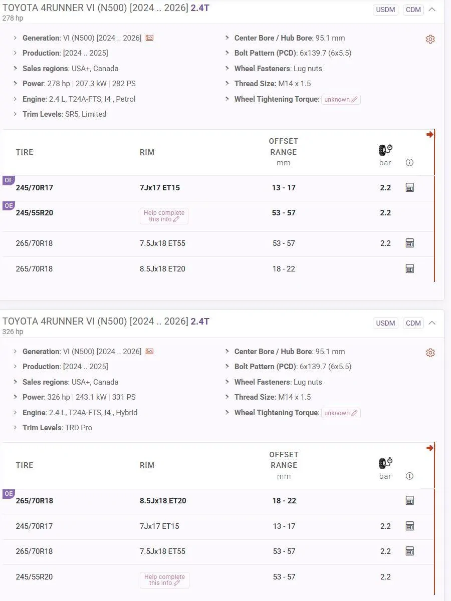

you CANT fit a 5 lug 5th gen wheel to a 6th gen 6 lug wheel hub
i was thinking of my 2018 tundra lug pattern when i wrote that above lol, 2nd gen tundra had a 5 lug vs the 3rd gen tundra having a 6 lug
edit : plus the hub bore is 106 on the 5G vs 6G 95
also forgot lug nuts are 12x1.5 vs 14x1.5 i think?
2,758
1,561
here you go 2024 vs 2025 wheel specs
2025 2026 4runner 6th gen Do the Hybrids need an LT / E load tire? 2024 4runner wheel specs
2025 2026 4runner 6th gen Do the Hybrids need an LT / E load tire? 2025 4runner wheel specs

That's good to know thanks! I didn't realize they changed the hub bore, well that kills that idea.
2,758
1,561
hey at least there is one benefit now. all the BoF vehicles all have the same wheel specs now.
center/hub bore is 95.1
bolt pattern PDC is 6x139.7 (5.5)
thread size M14x1.5
this will apply to
6th gen tacoma
3rd gen tundra
3rd gen sequioa
6th gen 4runner
the only thing you really have to worry about is offset of the wheel.
but if you want details you can goto this website
https://www.wheel-size.com/size/toyota/4runner/
https://www.wheel-size.com/size/toyota/tundra/
https://www.wheel-size.com/size/toyota/tacoma/
https://www.wheel-size.com/size/toyota/sequoia/

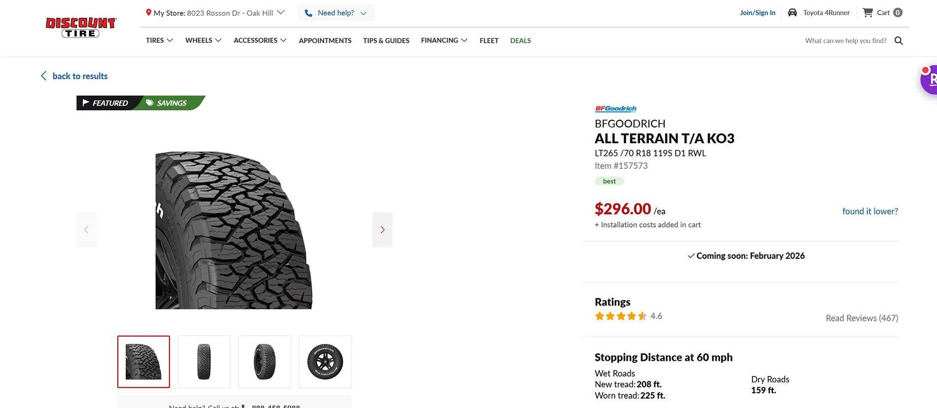

265/70/18 D coming Feb 26. Can find them on the BFG website upcoming sizes list as well.
Thanks! I was looking at BFG site but didn't notice the "coming soon" pdf download. Looks to be a few in D
35x12.50R18/D 118R
LT235/60R18/D 108/104S
LT255/55R18/D 109/105S
LT265/70R18/D 119/116S
