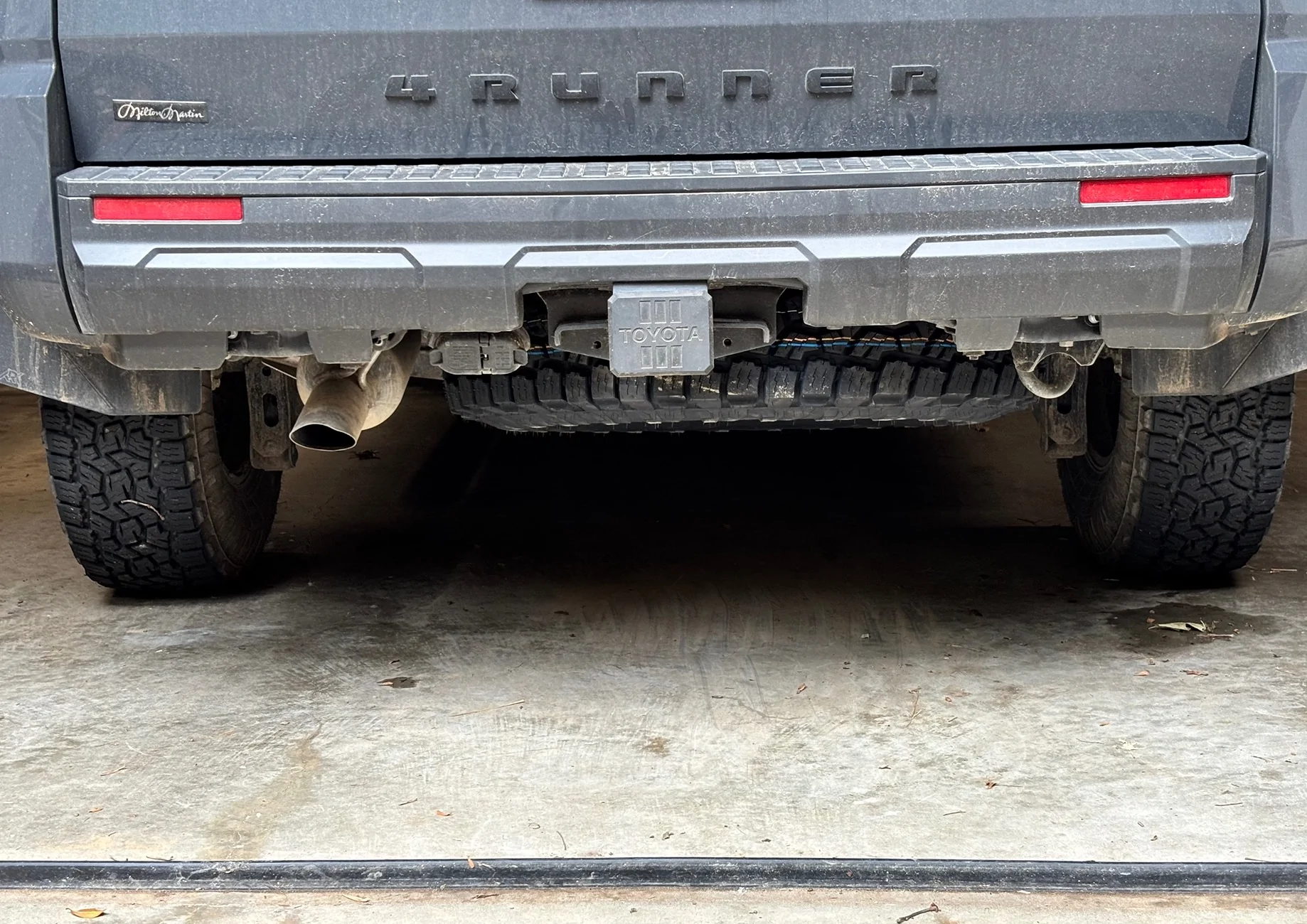

MPS2026
Malcolm
May 27, 2026
Georgia
4runner
I have an AT III 34x10.5 r17 mounted in the spare area of my SR5. Tight fit but no mods required. Actual diameter of this tire is listed as 33.5”.

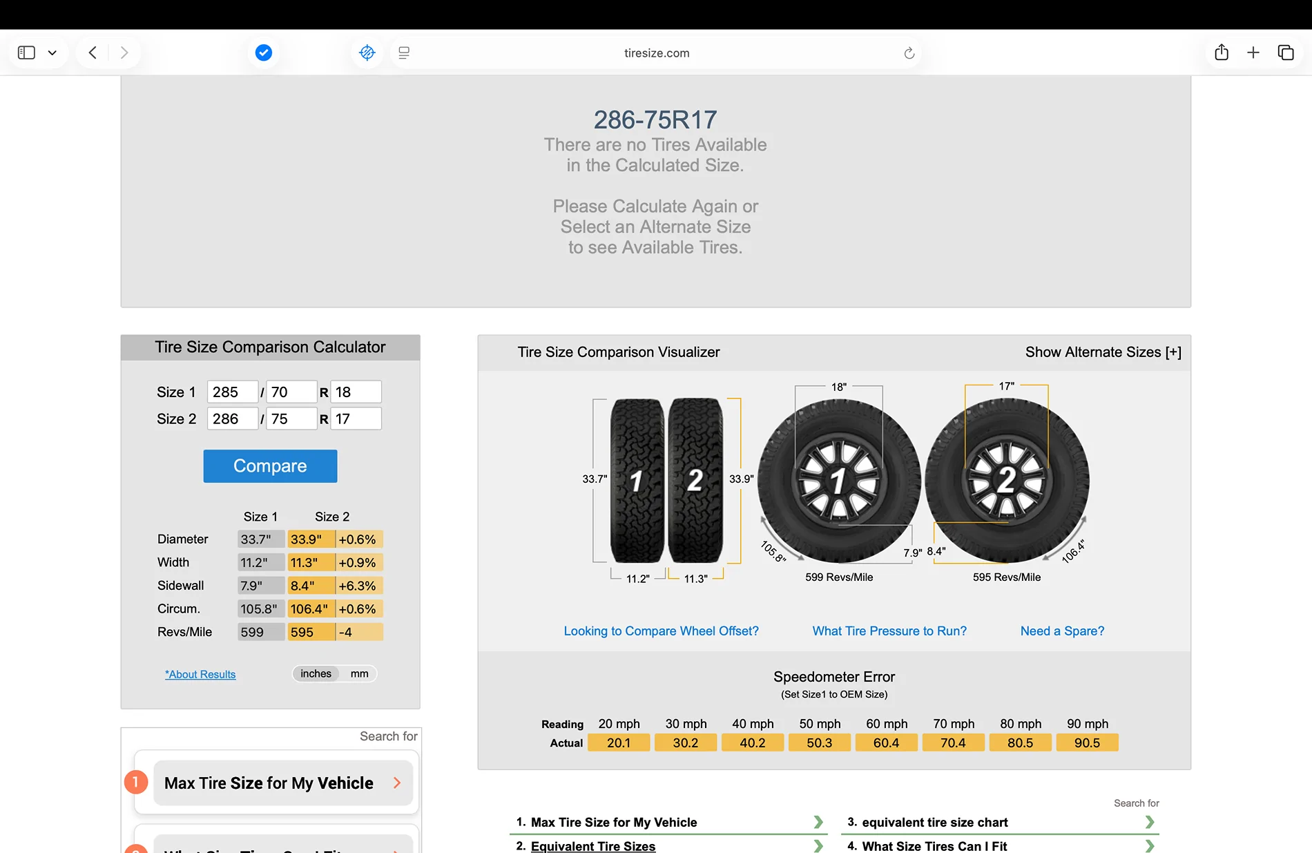

Van Solo
Van
May 20, 2025
599
397
Calgary / Canada
Toyo Open Country AT3 285/75R17 Specs below:
PART #:355700
  • LT285/75R17
  • Overal Actual Diameter: 33.9"
  • Overal Actual Width: 11.3"
  • Approved Rim Width: 7.5" - 9.5"
  • 10-Ply Rating
  • Tread Depth (1/32): 16.5"
  • Load (Lbs): 3195 @ 80 PSI
  • Sidewall: Blackoff
Wheel Specs:
Blackhorn NS5
17x8.5 ET25
We will be fitting this tire underneath the TRD Off Road Hybrid in the next week (hope)
@rutsnext said The actual outside diameter of a BFGoodrich All-Terrain T/A KO3 in size LT285/70R18 is 33.7 inches when measured at its true inflated dimensions.
with 1/4" remaining i think we can make the 33.9" fit !?
wit calculations below 286/75r17 (To get the 33.9") acutal 285/75R17
0.5" estra sidewall let's do this!?
2025 2026 4runner 6th gen Largest size spare tire fit in undermount carrier? Screenshot 2026-06-27 at 22.14.56

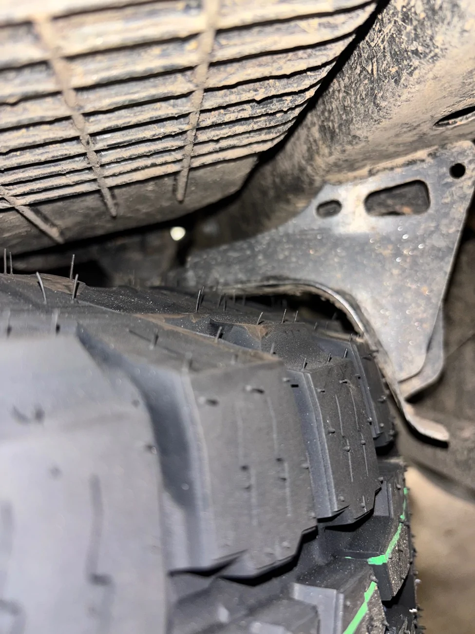

MPS2026
Malcolm
May 27, 2026
Georgia
4runner
Oh nice this is exactly what I am looking for, is it fully inflated? How do the D load tires compare to the stock tires?
It’s fully inflated. D load is fine. Stock tires were a softer ride but less capable off road. Trade off is worth it for my use. I attached a picture of the bracket that limits putting larger spare in.
2025 2026 4runner 6th gen Largest size spare tire fit in undermount carrier? IMG_2189

Nice, thank you for sharing that. Definitely going to go with that setup. Did you really have to wedge it up there or did it fit without much force? Just curious what it would it would be like to take on and off if I needed.
MPS2026
Malcolm
May 27, 2026
Georgia
4runner

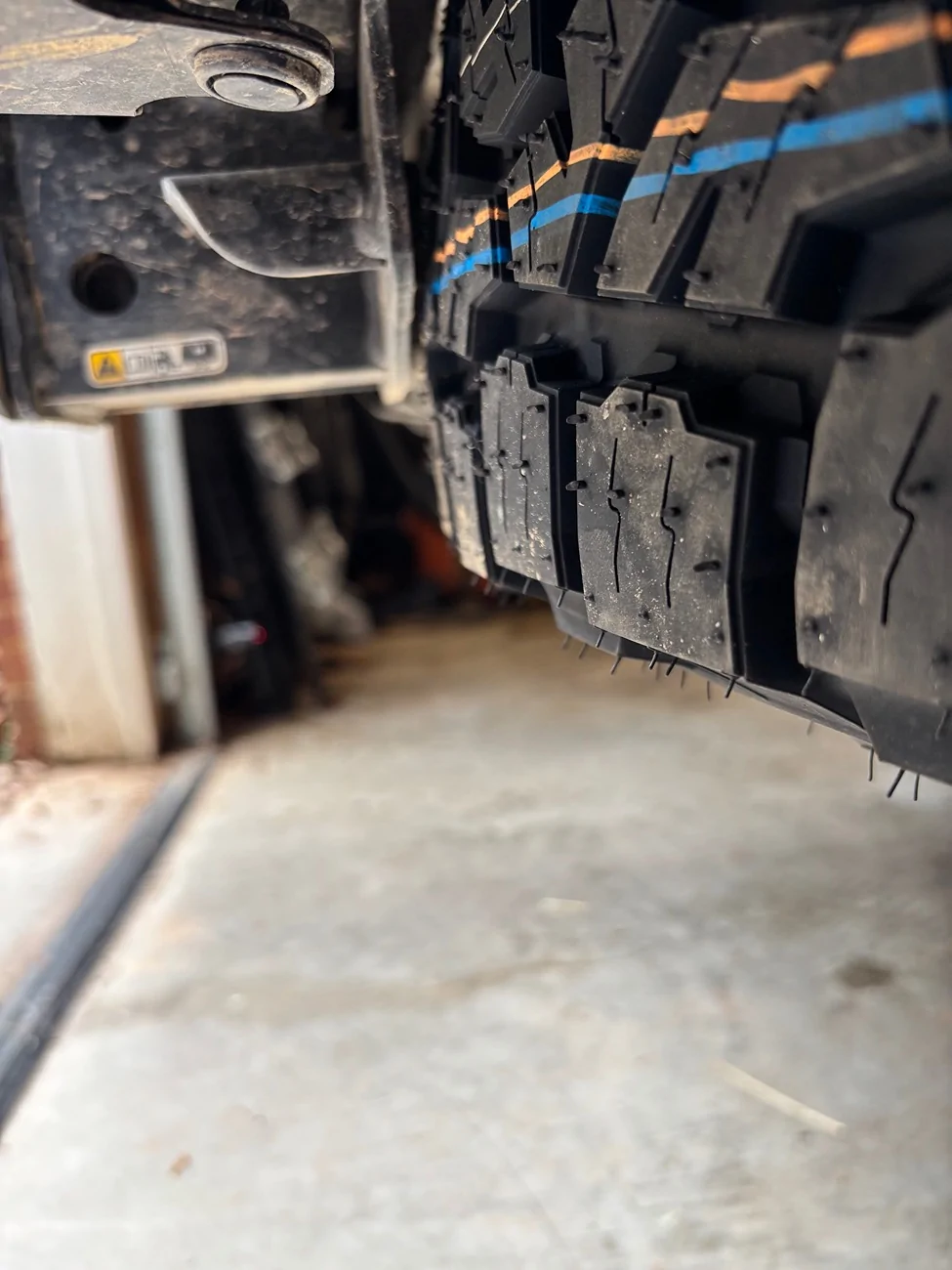

No problem getting it under. Have to move it around some as you lift it up but should be easy. Attached is pic of spare against the hitch to give an idea of how much room you have.

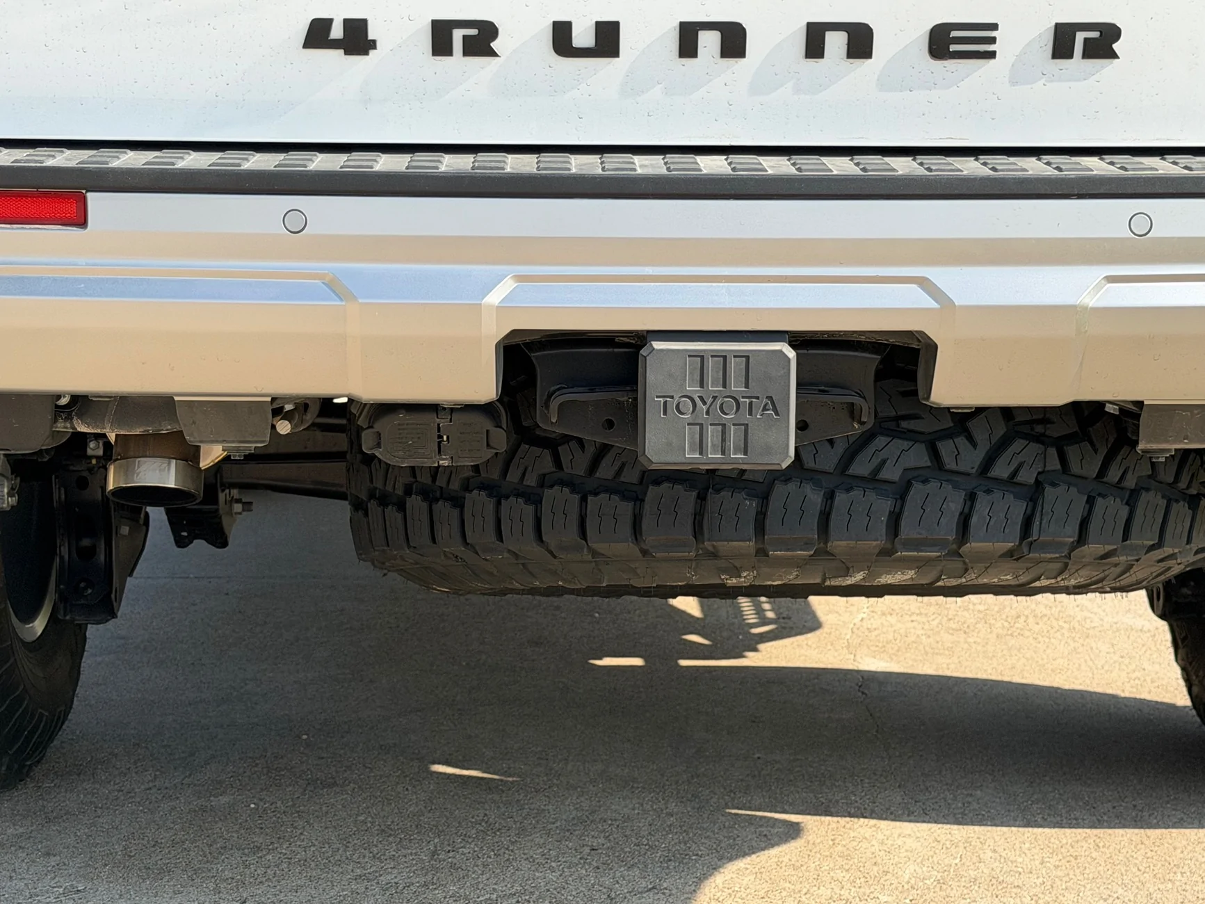

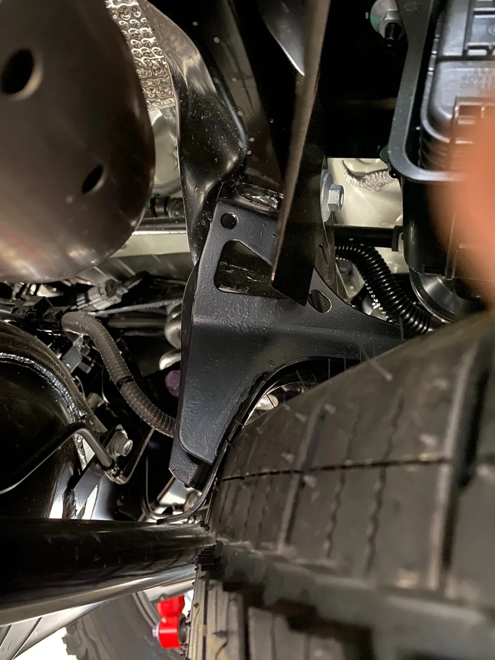

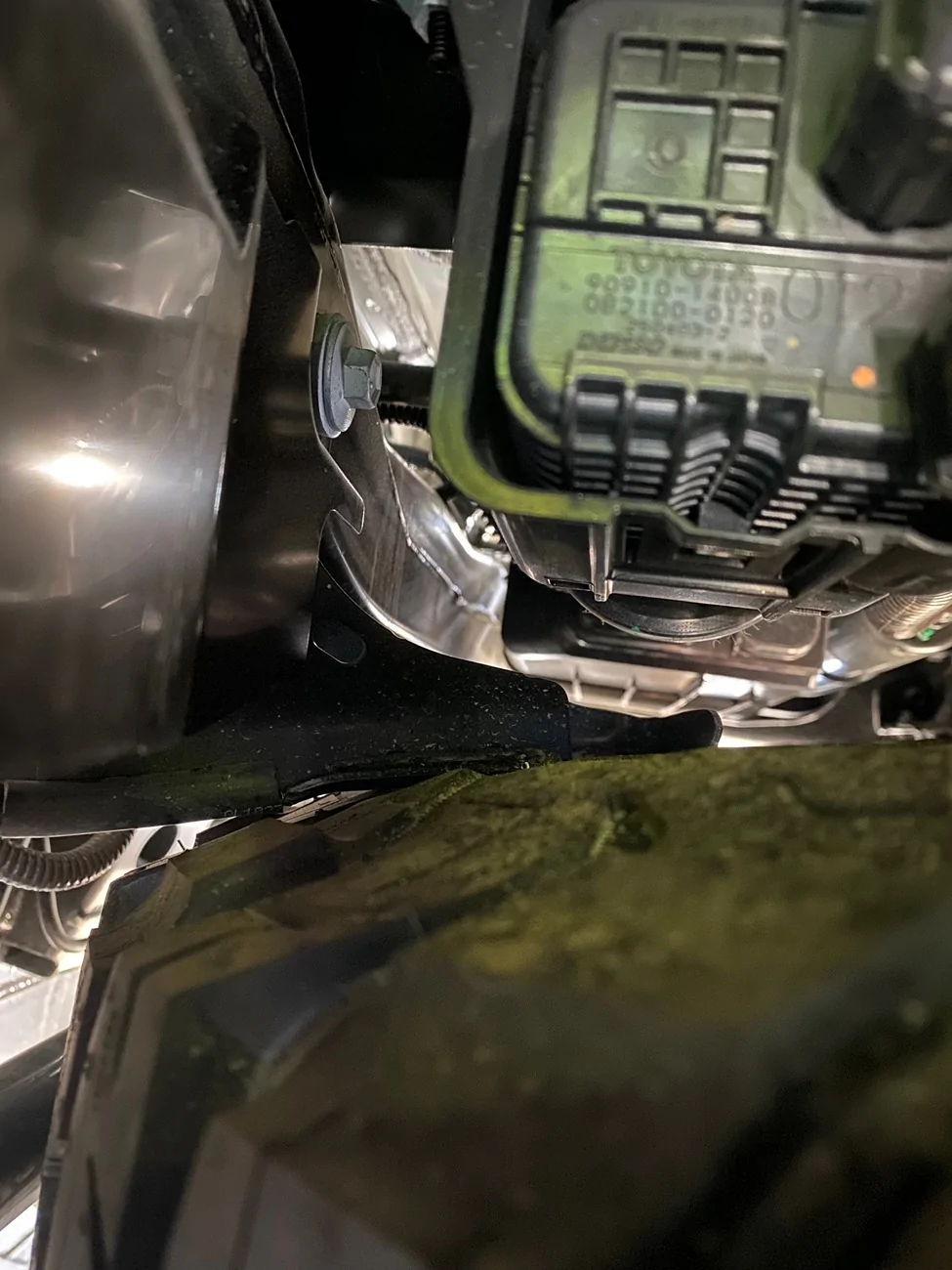

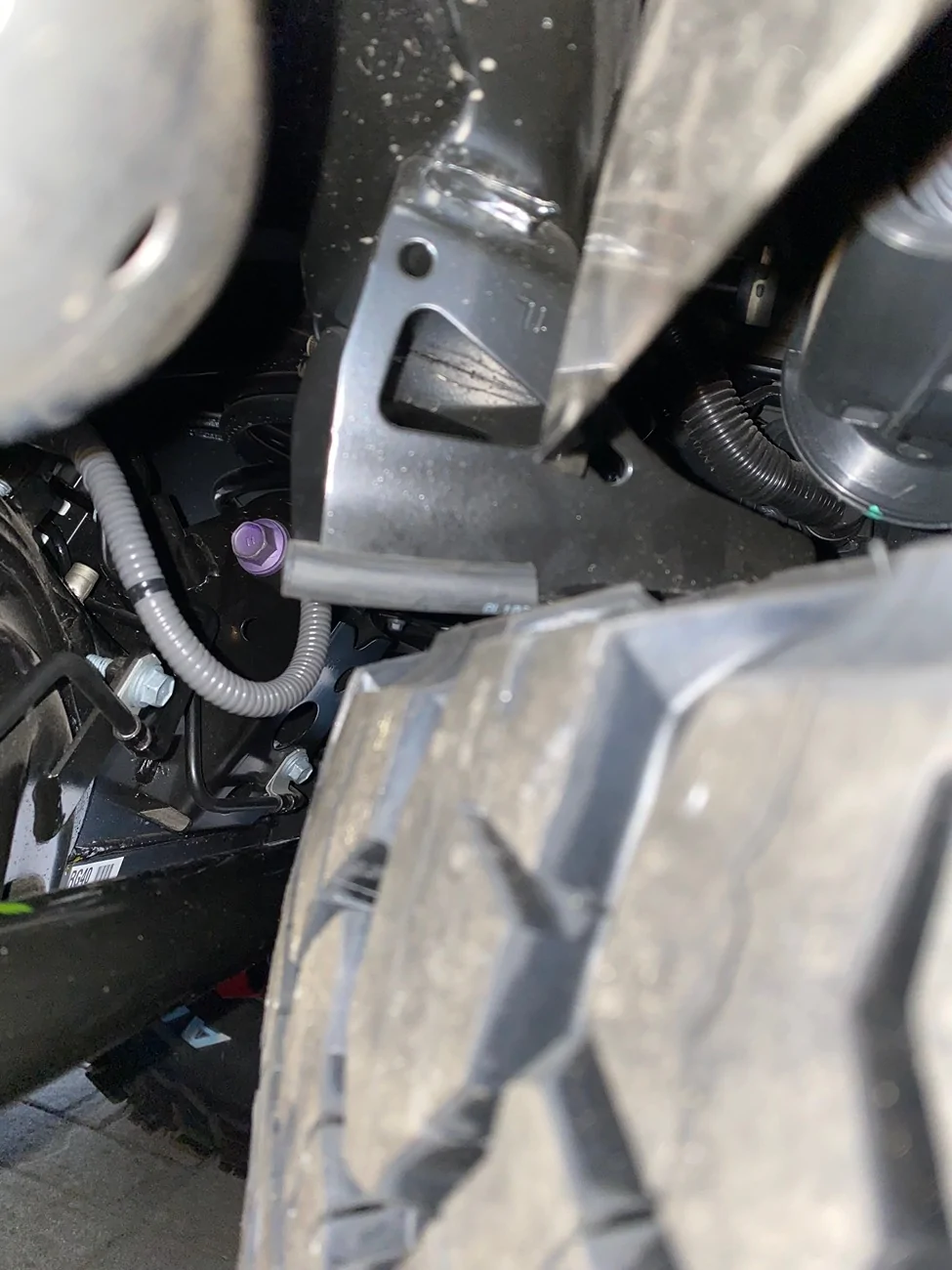

Here's my take from everything posted, including my own experience. I'm thinking the profile of the actual tire you're installing is very relevant.
32.6" stock obviously fits fine. pic at front bracket attached for reference of how stock tire sits.
33.5" Toyo AT3 fits per MPS2026. photos shown in their posts above.
33.7" K03 fits with mod to front bracket - this is my setup with 285/70/18 K03. Pic of modified bracket attached.
33.9" Toyo AT3 285/75/17. Comments above make this an interesting one. A 33.9" would definitely not fit if the tire profile was like my K03. With a more square profile like the K03, the tire would hit low on the radius of the front bracket and not be sitting flush against the horizontal surface meant for the tire to be pulled up against. Maybe it works if the tire is rounder vs more square???
@Van Solo - maybe it's worth a check to see if the AT3 profile would allow it to fit?? Maybe the tire profile is different enough based on 3rdRunner's experience.
@3rdRunner - Would be great if you get a chance to post a pic of the tire at the front bracket (and maybe above) to give anyone else checking this thread as much real-world experience as possible.
I've included a pic to show my tire sitting flush/tight against the horizontal portion of the bracket. I'd want to make sure this was the case on any larger tire as I wouldn't want the tire only held against the radius of the front bracket.
