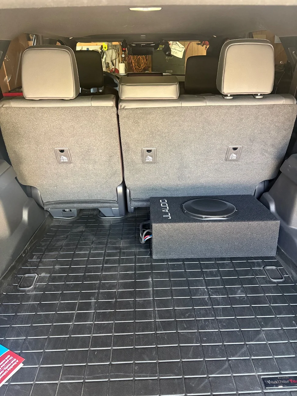

When I initially got my 4Runner TRD Sport premium I expected a lot better sound quality from the JBL sound system. However I was disappointed with the amount of rattles coming from the doors and an overall lack of bass.
I decided to just take it into Independence Audio and Video to have sound dampening done to all four doors and have a sub installed. They did a great job - not only is there more bass now, but the sound deadening fixed the rattles and made the road noise so much quieter. I highly recommend getting sound treatment done!

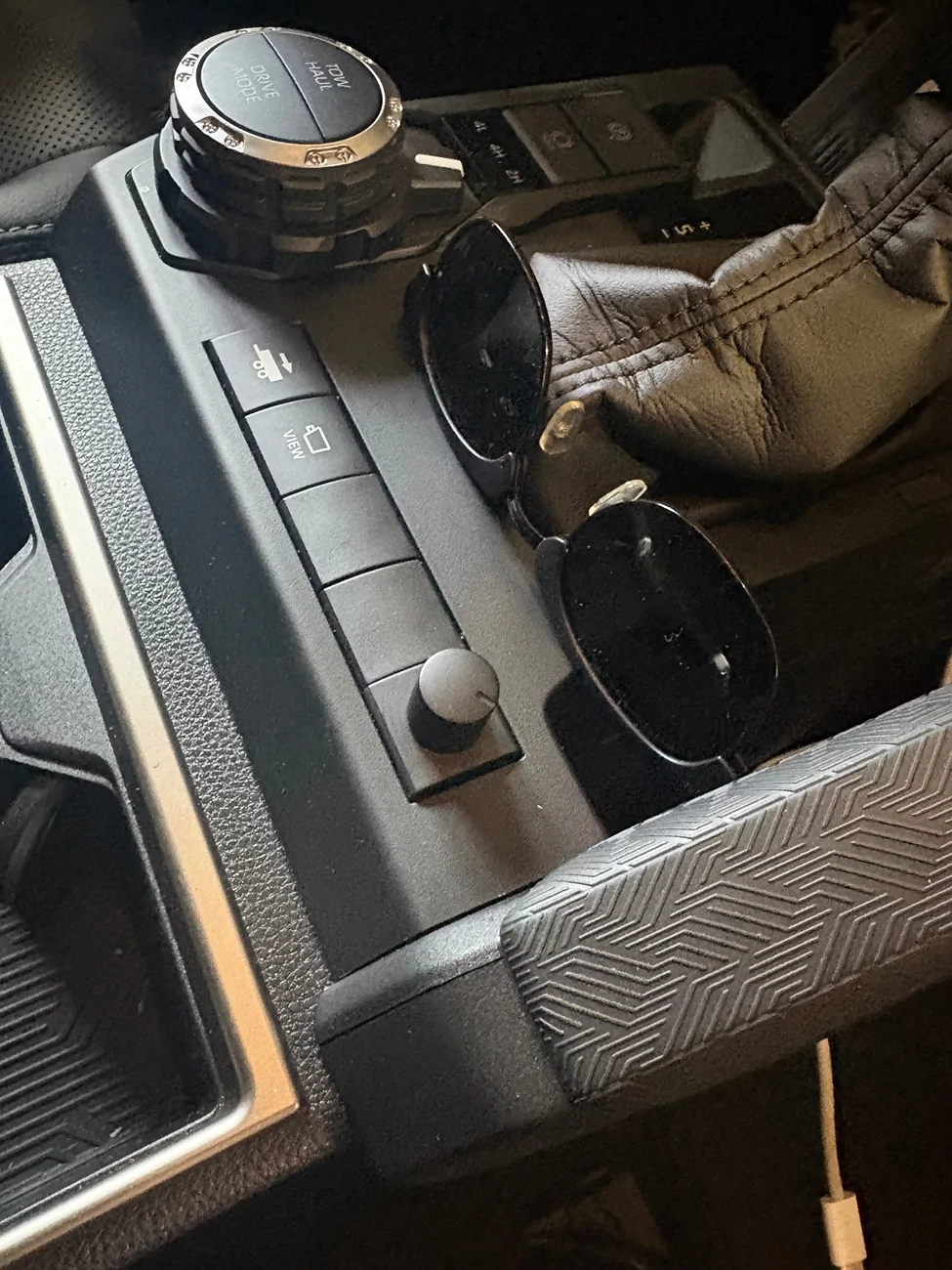

I also had a sub knob installed into one of the blank switches. Overall super happy with the install and recommend using Independence Audio and Video if you are somewhat nearby.

The sound deaending was around $100 per door including labor. The install for the sub was $350. The most expensive part was the sub itself.

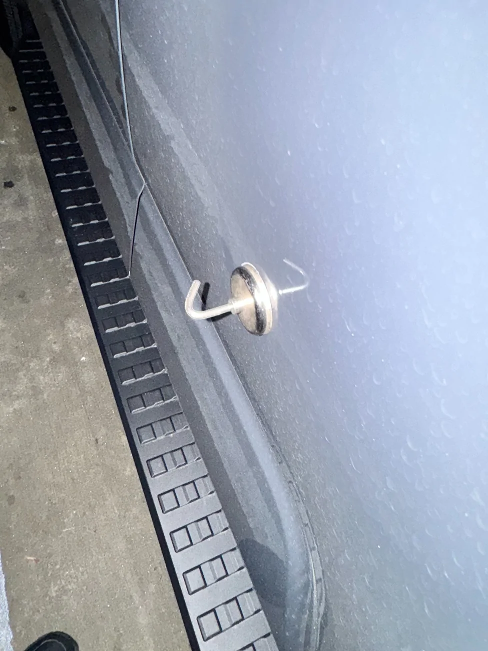

My mistake. Just for my correction and for you: I took a magnet and tested the 4Runner, and I found that only the hood is aluminum. The roof, trunk, doors, and side panels are not.
But I’m still curious whether the metal sheet all around is thinner and not as strong as the 5th Gen.
Oh, I'm sure it's thinner. Gotta meet those efficiency goals, get weight down any way they can.

I like the bass knob, I would have put mine on the left of the wheel however. Sound deadening makes a huge difference! And now you have a solid foundation to build on in the future.

Nice setup!
Hopefully Skar Audio makes a stealth box like they did for the 5th gen. Great box, just a trash sub. When I had mine, I threw in a DDSL712 with a sub spacer (was close enough in Ari space) and it got fairly loud.

What sound deadening did you use? I was looking at getting the sound skins kit since it comes pre cut already. Also is that the Powered JL 8in?
