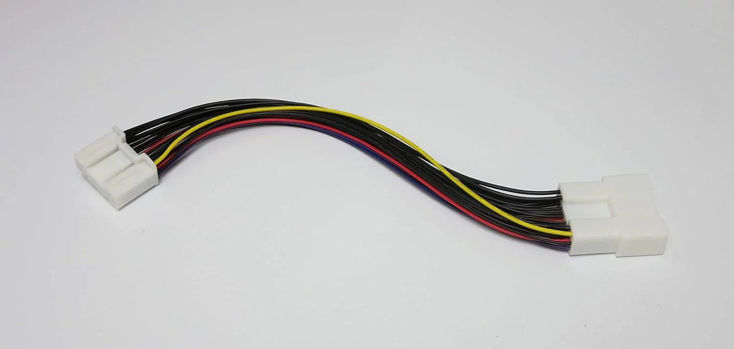

Dash Tweeter - 2.75 - 3.5 (I installed a 2.75 but gutting the original tweeter) / Harness - 72-8109
Front Door - 6x9 - Harness - 72-8109 / Bracket - Metra 82-8146 w/ some minor modifications using a drill. 3 out of 4 holes lined up, had to use drill to line up last hole.
Rear Door - 6.5 - Harness - 72-8109 / Bracket - Metra 82-8148 perfect fit.

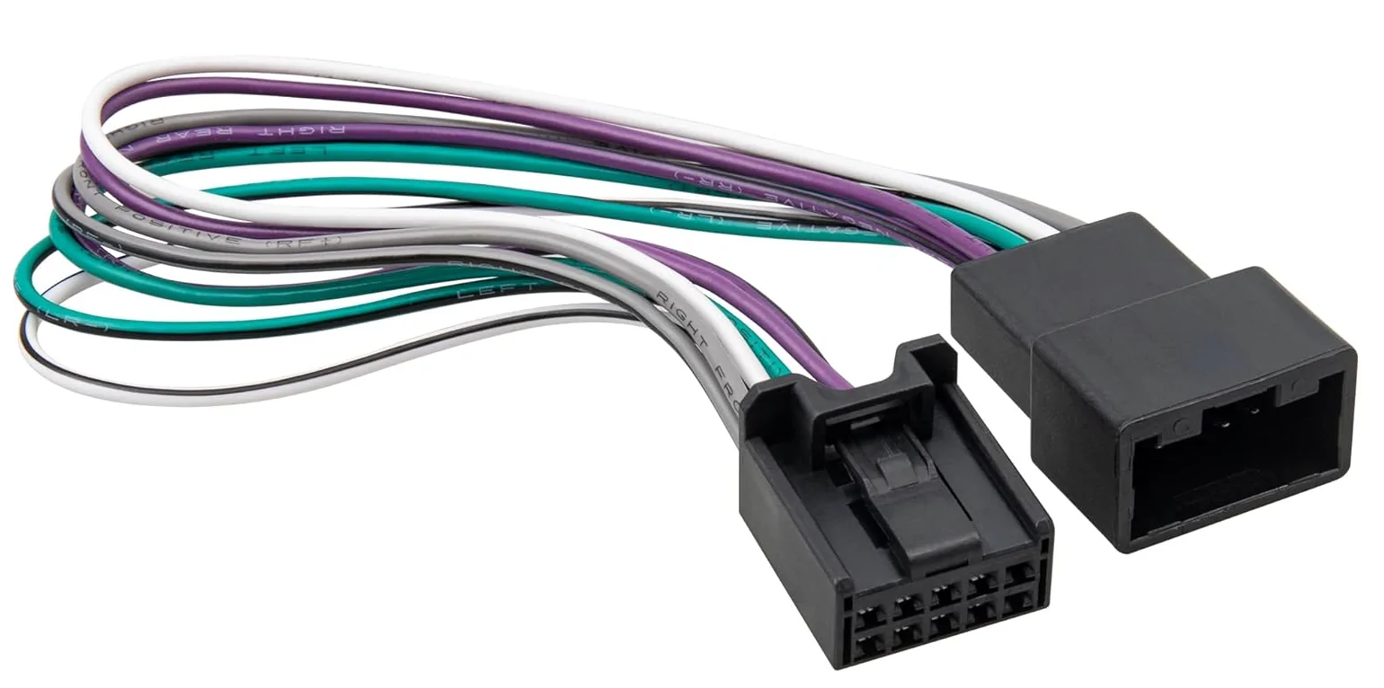

Radio speaker output harness (to aftermarket amp or loc) - You can find these at several sites but I bought the Amazon Red Wolf 10 pin one for $14 then used some speed wire to run to amp.

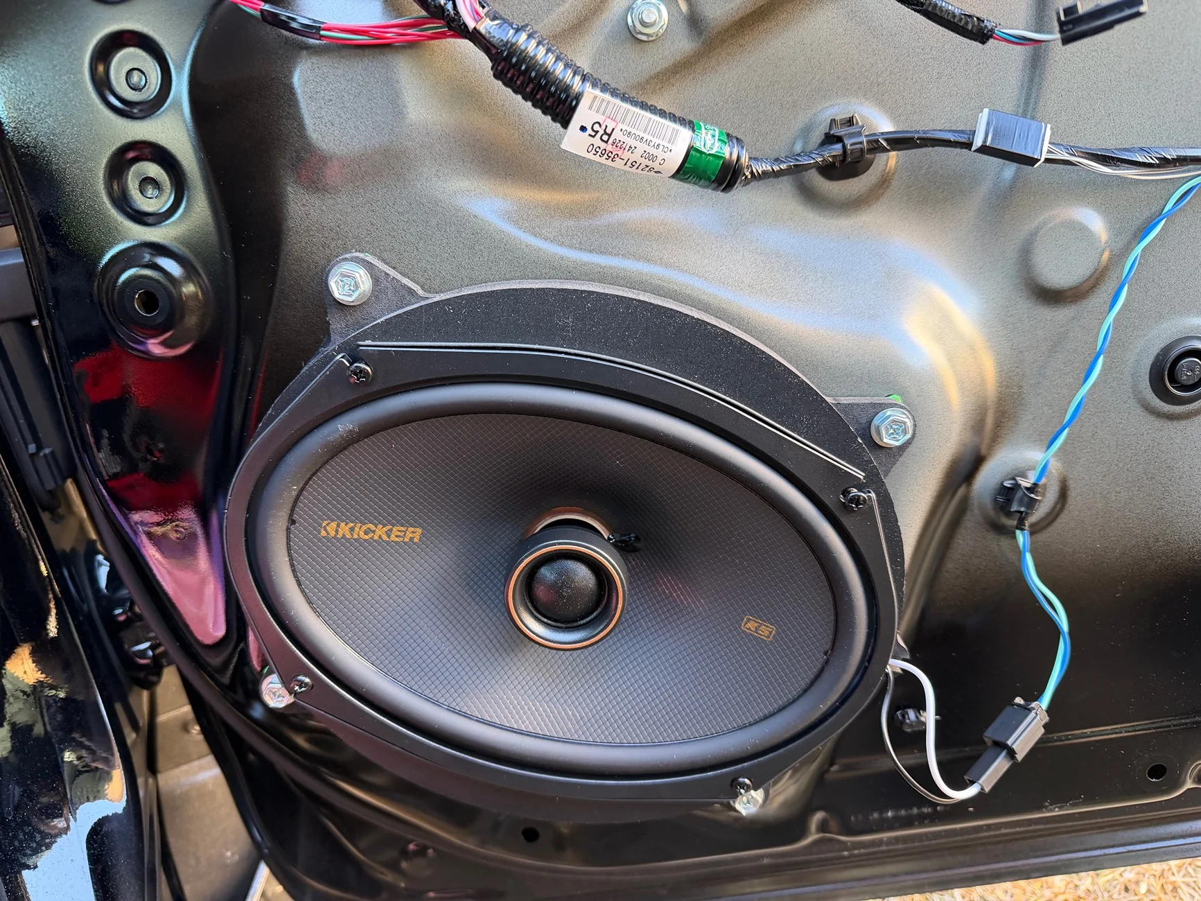

Just replaced the front(51KSC6904) and rear(51KSC6504) speakers. I used the harnesses OP mentioned. But I used the brackets from trail grid pro. I also used their video to figure out the disassembly of the front and rear doors.
The OEM head unit is not powerful enough to run aftermarket speakers. They’re clearer but that’s about it. An amplifier seems to be necessary. I’m not sure if I’m going to run a 6 channel to run all 6 or a 4 channel to run the dash (will replace at that time) and front door speakers. Probably the 4channel amp. I will also likely use a mono amp to run a sub separately.

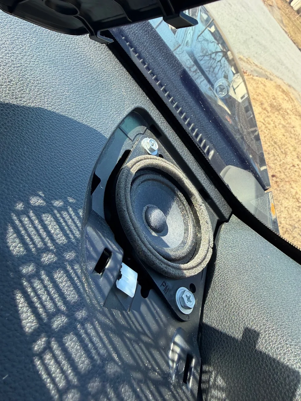

Here are some pictures of the dash speaker (I pulled it up just to see if the SR5 Even came with dash speakers) and an installed 6x9 in the front. I forgot to take more pictures.
