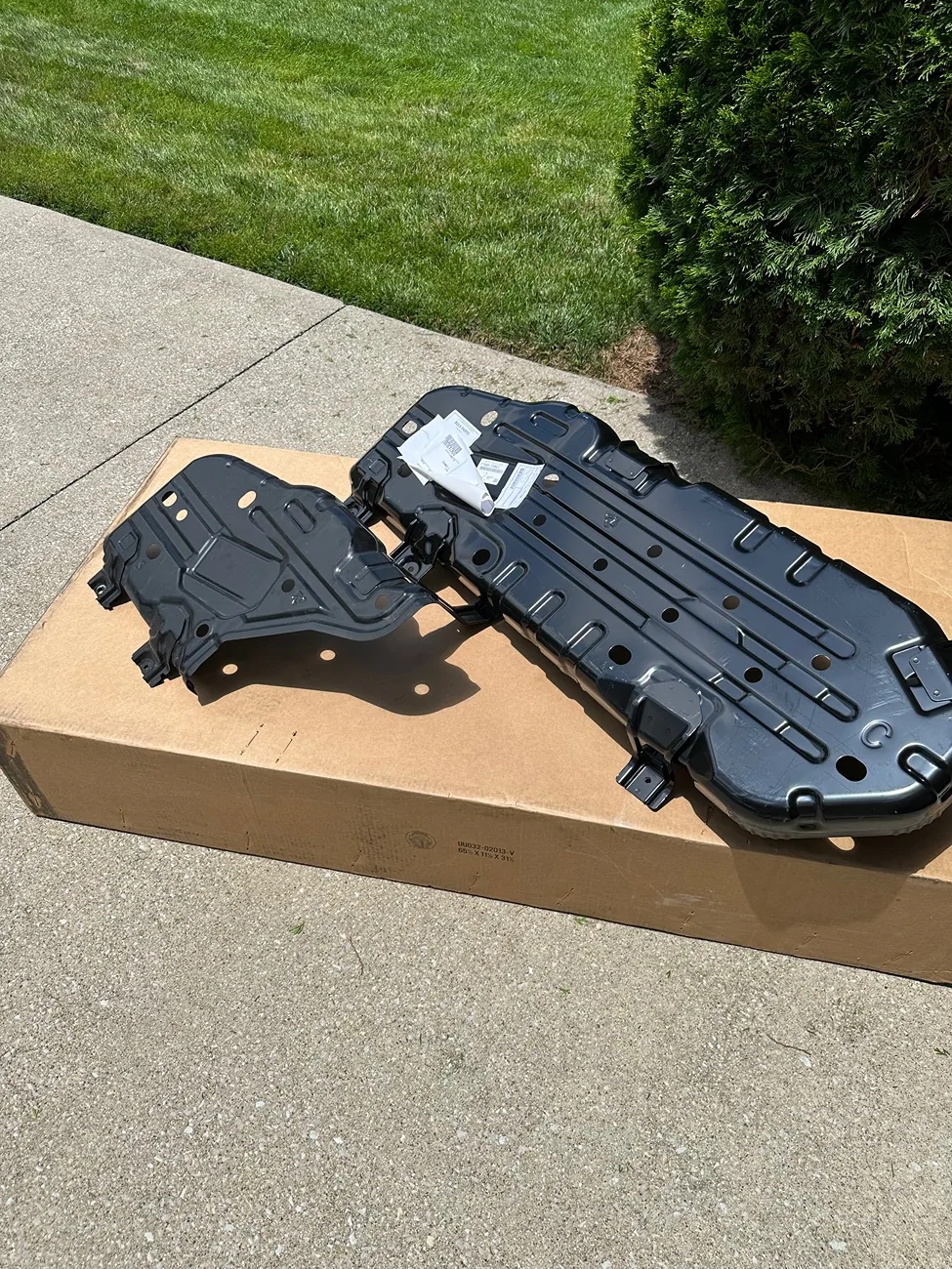

I checked around to see if anyone had already posted this but I couldn’t find anything.
For those who’s trims (Limited/Platinum and maybe SR5/Sport I’m not sure) have the OEM half gas tank skid plate and want to upgrade to the full-coverage ones found on the off-road models here is the part number:
Fuel Tank Protector Sub-Assembly
Part Number: 77606-35091
You’ll also need 2 more of these bolts to complete the process as you can reuse the 3 currently on the half-skid plate. This is the part number.
Bolt With Washer
Part Number: 90119-08D63
I’ve installed the skid plate with no issues. It was about as annoying as installing any of the other skid plates but not too difficult.
Also the half-plate’s part number is #77606-35100 in case anyone was curious. Attached is a picture of both plates side by side. There’s a huge difference.
2025 2026 4runner 6th gen OEM Half-Gas Tank Skid Plate to Full Skid Plate Upgrade Install - Limited/Platinum/SR5(?)/Sport(?) IMG_8671
Bolt With Washer
Thanks for the comparison. It's definitely an upgrade.
Is this part number for the non-hybrid or hybrid version?
Will this upgrade work if you already have the oem skid plates installed , including the oem TRD front and oem transmission skid plates?
Bolt With Washer
Thank you for posting this!
(Edit) Just installed the full shield. The two extra mounting locations were present on my 2025 SR5. Toyota, as of this post, has a backorder on the bolts necessary for installation of the shield. I got a refund for these, removed the half shield, and proceeded to Lowes with an original bolt to locate its alternative in their bolts bin located in their hardware isle. I was able to locate an M8x1.25 bolt comparable to the original. Installation was quick and easy!
