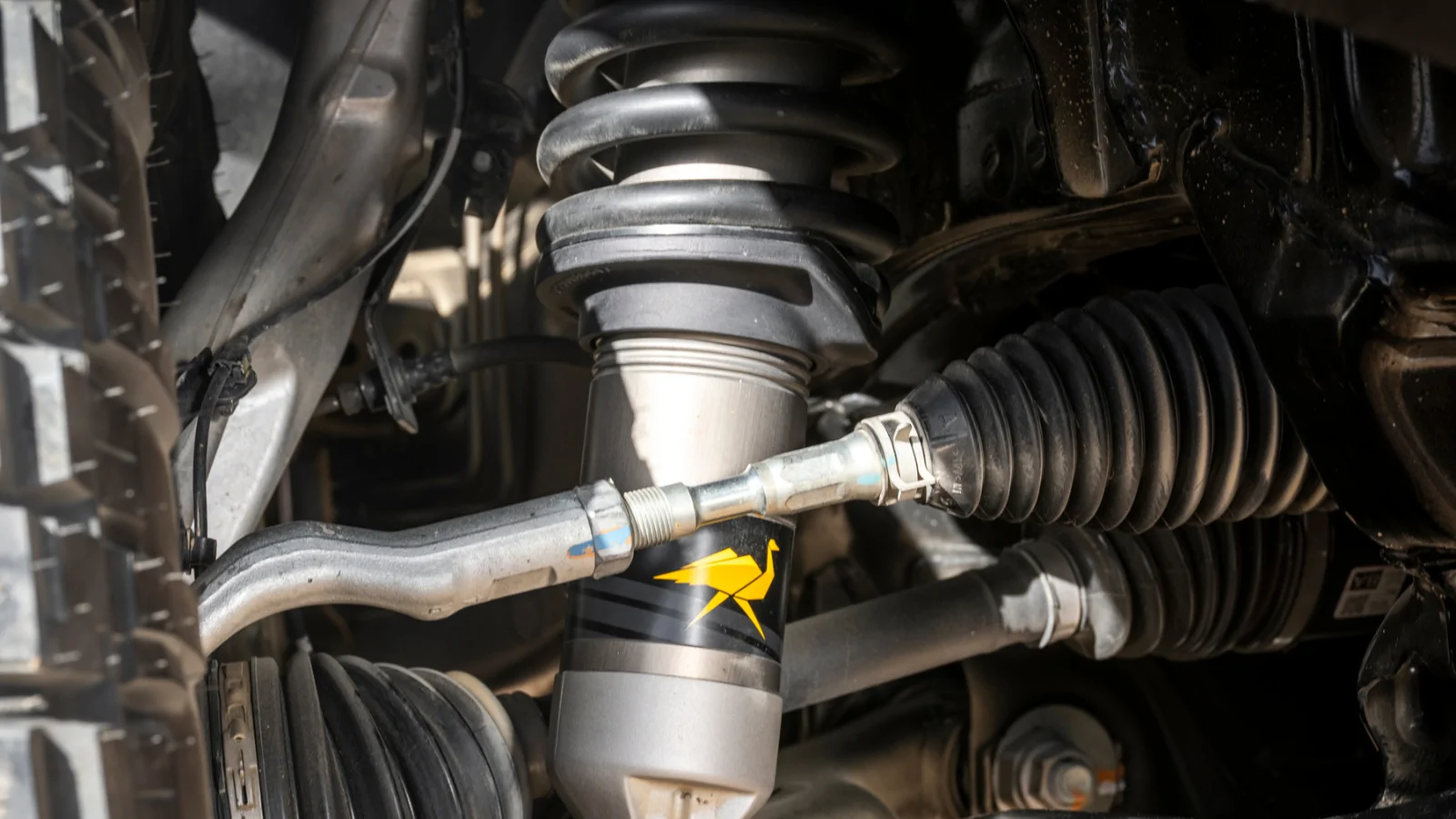

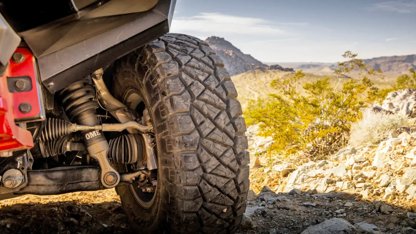

That's exactly what the MT64 is built to solve. Old Man Emu tunes and matches the springs, shocks, and arms (if you choose to upgrade) in each kit around how your 4Runner is actually going to be outfitted, so instead of adding weight and hoping for the best, you're running a suspension that's already accounted for it.
About the MT64 Shocks
The MT64 shocks sit right in the middle of the OME lineup, between the iconic Nitrocharger and the ultra-high-performance, adjustable BP-51. They're built with a huge 2.8in aluminum body, giving them the oil capacity and heat dissipation to handle everything from daily driving to demanding overland trips. The name comes from the internal monotube design, which uses a 64mm (2.5in) inner bore diameter, big even by MT64 standards, and it's specifically engineered for vehicles carrying campers, toppers, tents, and rack systems.
Features & Benefits
  • Tuned and matched suspension kit for increased comfort and control
  • Complete coilover assembly for direct bolt-in fitment
  • Adjustable 6-position snap ring, giving a range of front lift from 1.75–3in depending on how you set it
  • Monotube design with a massive 2.8in body for more oil and more accurate tuning
  • Aerospace-grade aluminum body dissipates heat roughly fifteen times faster than steel and adds protection against stone damage
  • Forged body cap and rod ends reduce weight while keeping strength up
  • Digressive valving reacts instantly to changing surface conditions
  • Direct replacement for stock and most aftermarket lift kits
  • Hydraulic end-zone top-out adds cushioning at full extension to help soak up unexpected hits
  • 7/8in piston rod shaft for exceptional stability under load
In short: a bigger body means more oil, better heat management, and a more refined ride, whether you're driving to work Monday or out on the trail Saturday.

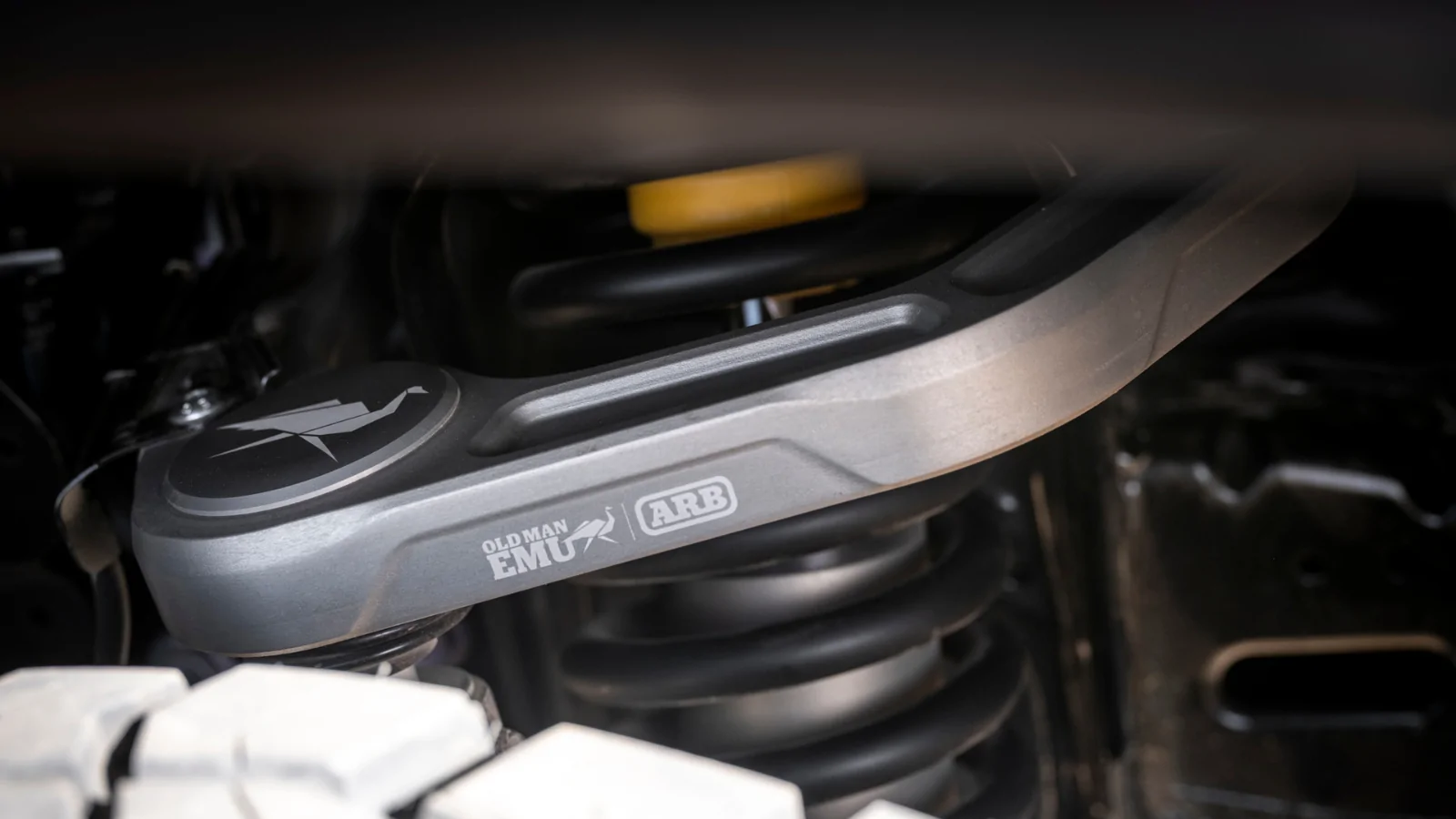

About the Upper Control Arms
Your 6th gen 4Runner runs an IFS (independent front suspension) setup, meaning each front wheel moves independently instead of both sides being connected by a solid axle. The upper control arm is a key part of that system; it connects your frame to the front wheel hub, and it's a big part of what keeps your front end aligned and handling right, on- and off-road.
The problem is, when you lift the front of your 4Runner, it changes that geometry enough that a shop can't always get you back into proper alignment spec with the stock arms. This can cause other issues down the line. But, OME's Upper Control Arms fix that by giving you the adjustment range you need at your new ride height, so your alignment can actually be corrected instead of running out of range.
Want more information on whether you should upgrade your UCAs? Let us know!

are those new silver control arms for this platform? every other version i've seen shows tubular UCAs, as do the links above.
ARB likes to show a lot of products you can't buy lol. I think ARB has been posting pictures of this built 4runner for over a year at this point but still hasnt released a skid plate, bumper, or roof rack shown. Also it doesn't look like they sell an aluminum UCA for any vehicle.

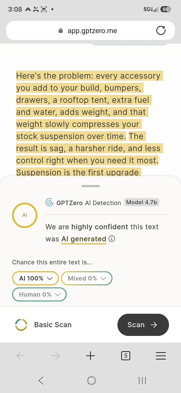

I guess their AI advertising makes some mistakes. I put their post into the AI detector, here is the result lol.
I talked to ARB at Overland Expo West a few months ago. They said those new UCA's will be out likely toward the end of the year. They are still testing them out and making final tweaks before releasing them.
