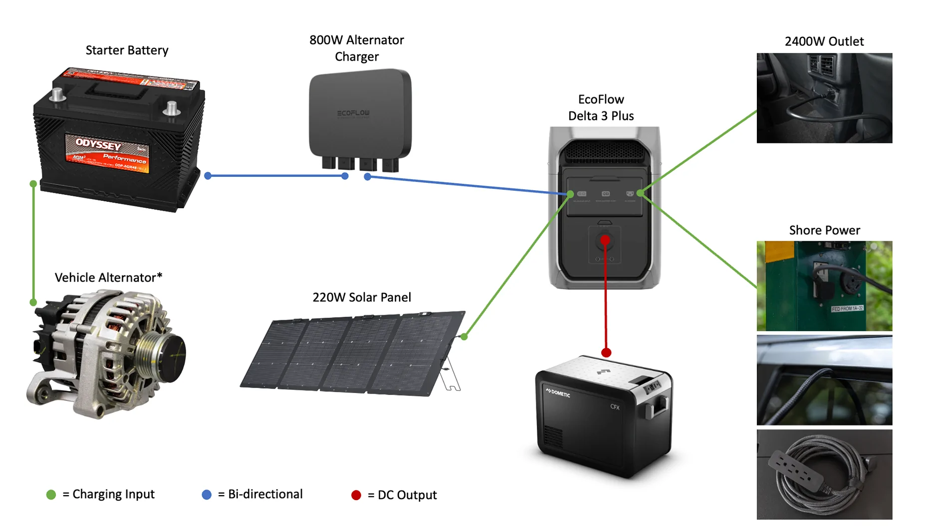

Here’s an overview of how the entire system is wired:
2025 2026 4runner 6th gen Dual-battery setup for the Hybrid 4Runner Ecoflow System Diagram
* Yes, I know most hybrids don't have an alternator. It represents the vehicle charging system (DC-DC converter).

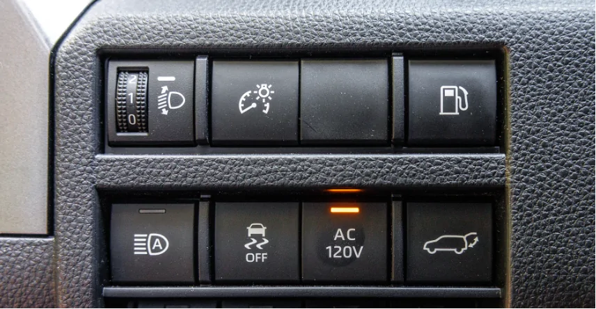

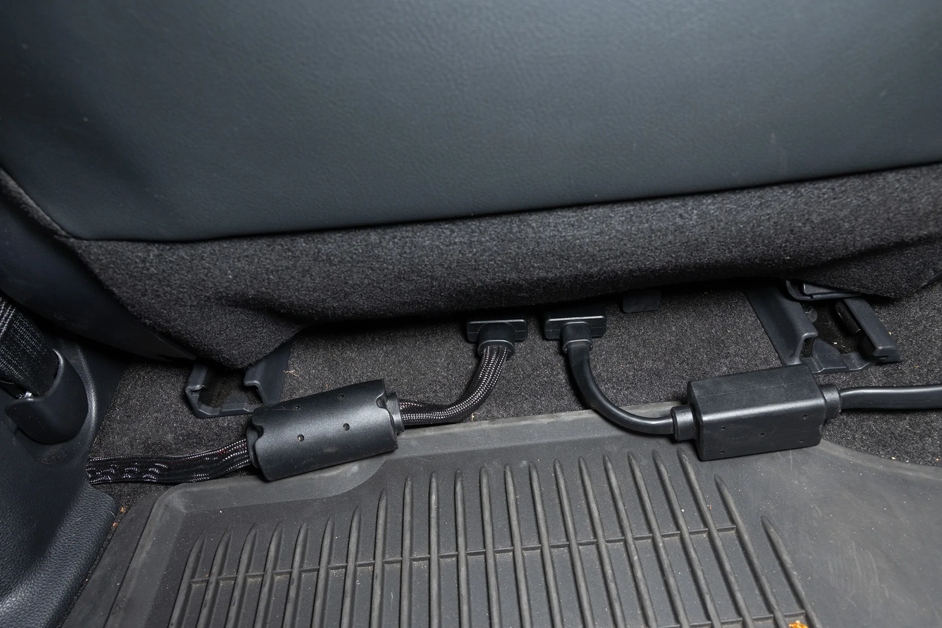

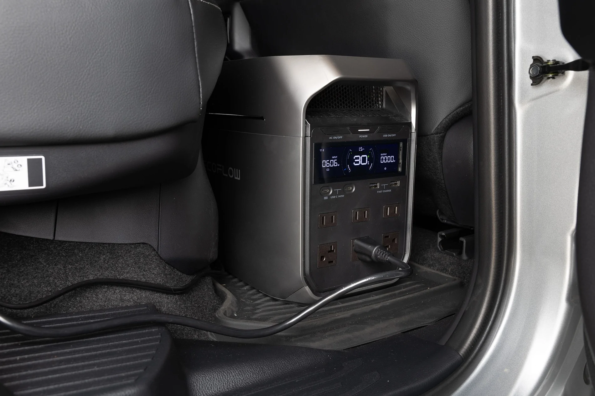

The Delta 3 Plus fits nicely behind the passenger seat in the rear footwell. Whenever it’s installed in the vehicle, I run a short, 2-foot TrippLite Series 15 Amp power cord from the EcoFlow into the 2,400W AC outlet in the center console for charging. This allows me to turn on the AC 120V switch and charge the Delta 3 Plus using the Toyota hybrid charging system whenever the engine is running.

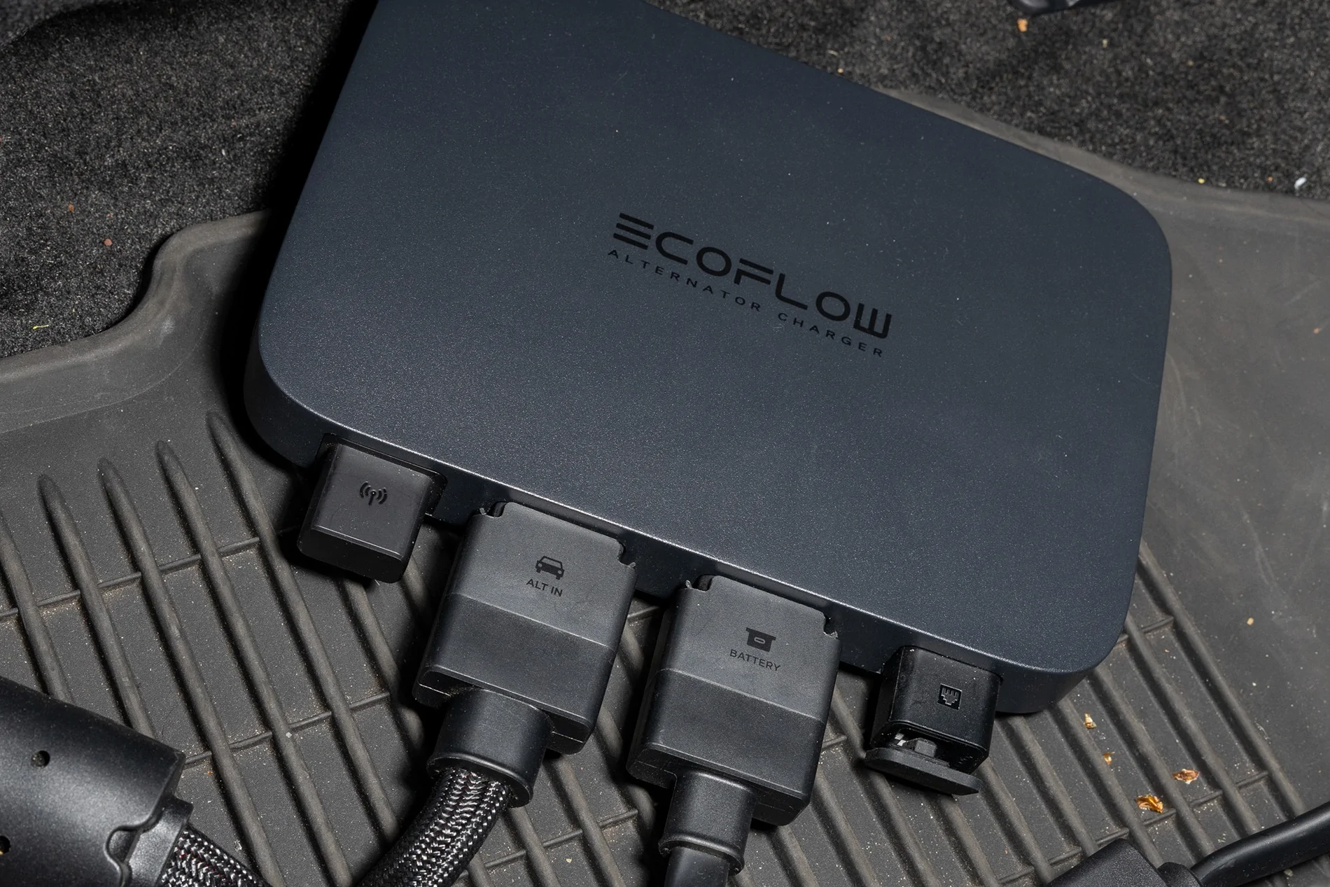

Next, I installed the 800W Alternator Charger under the driver seat. I connect the charging input labeled “Battery” to the Delta 3 Plus using the provided cable, and I ran the other cable labeled “Alt In” to the Odyssey AGM48 starter battery in the rear cargo area by routing it under the door sill covers and behind the plastic side panels.

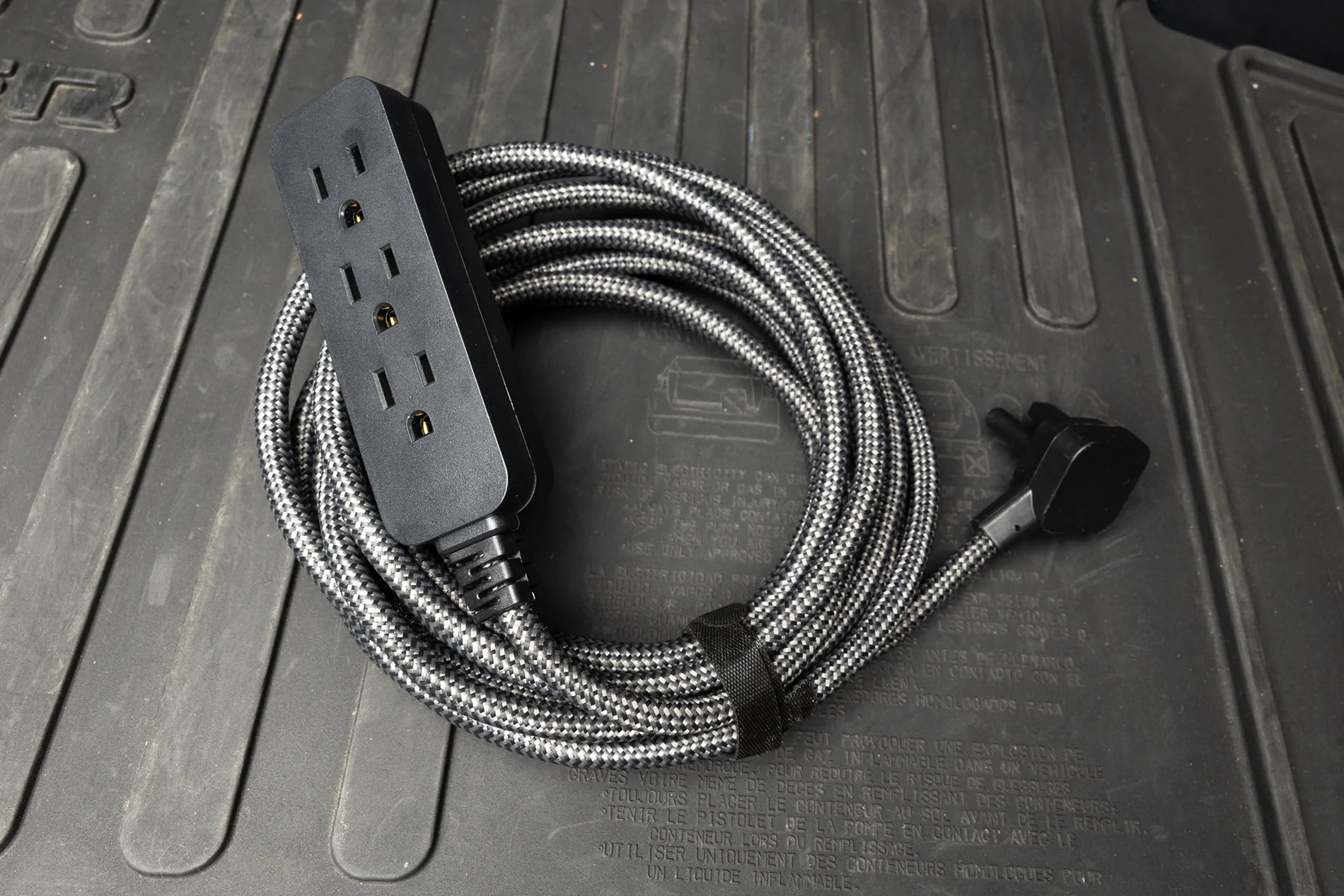

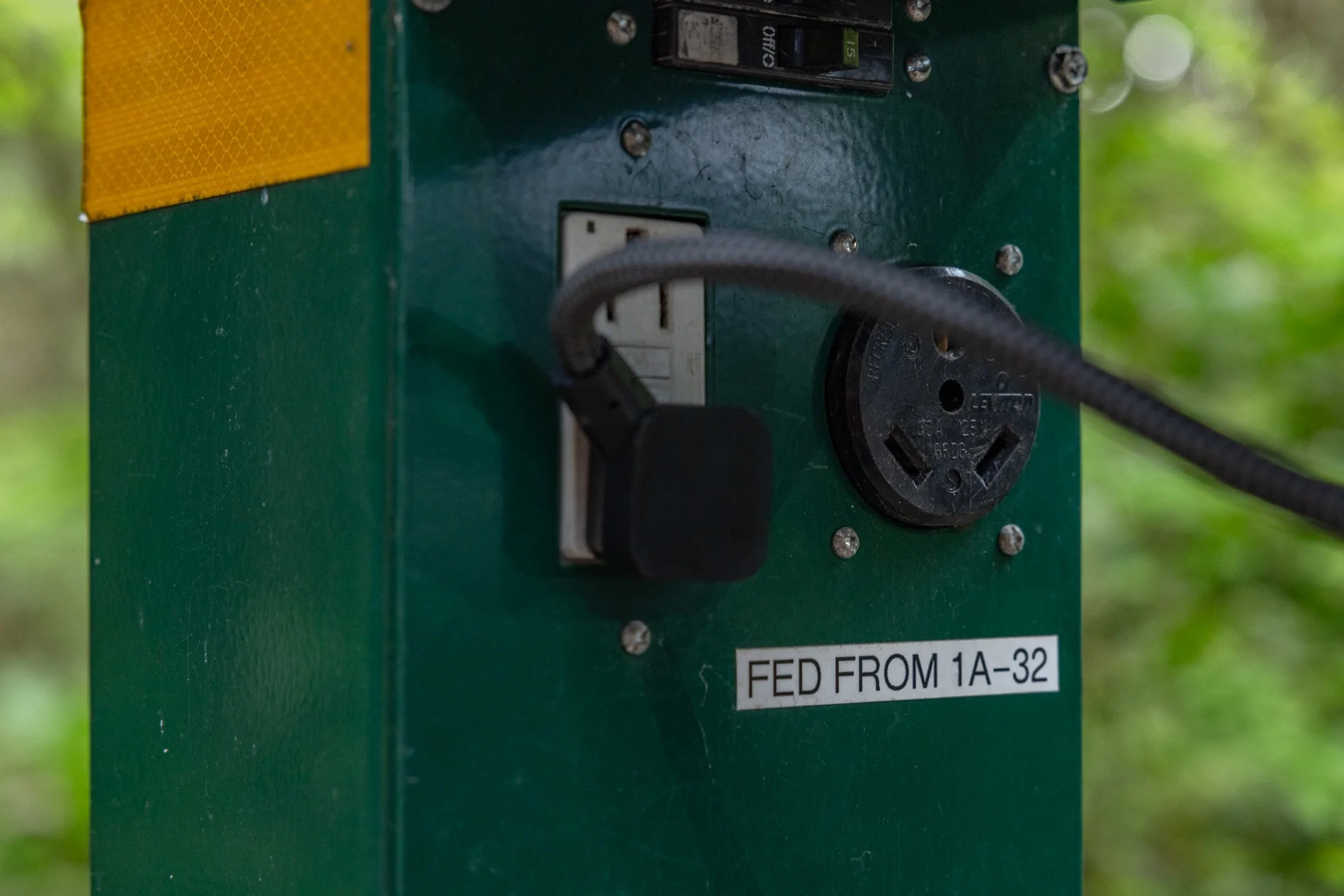

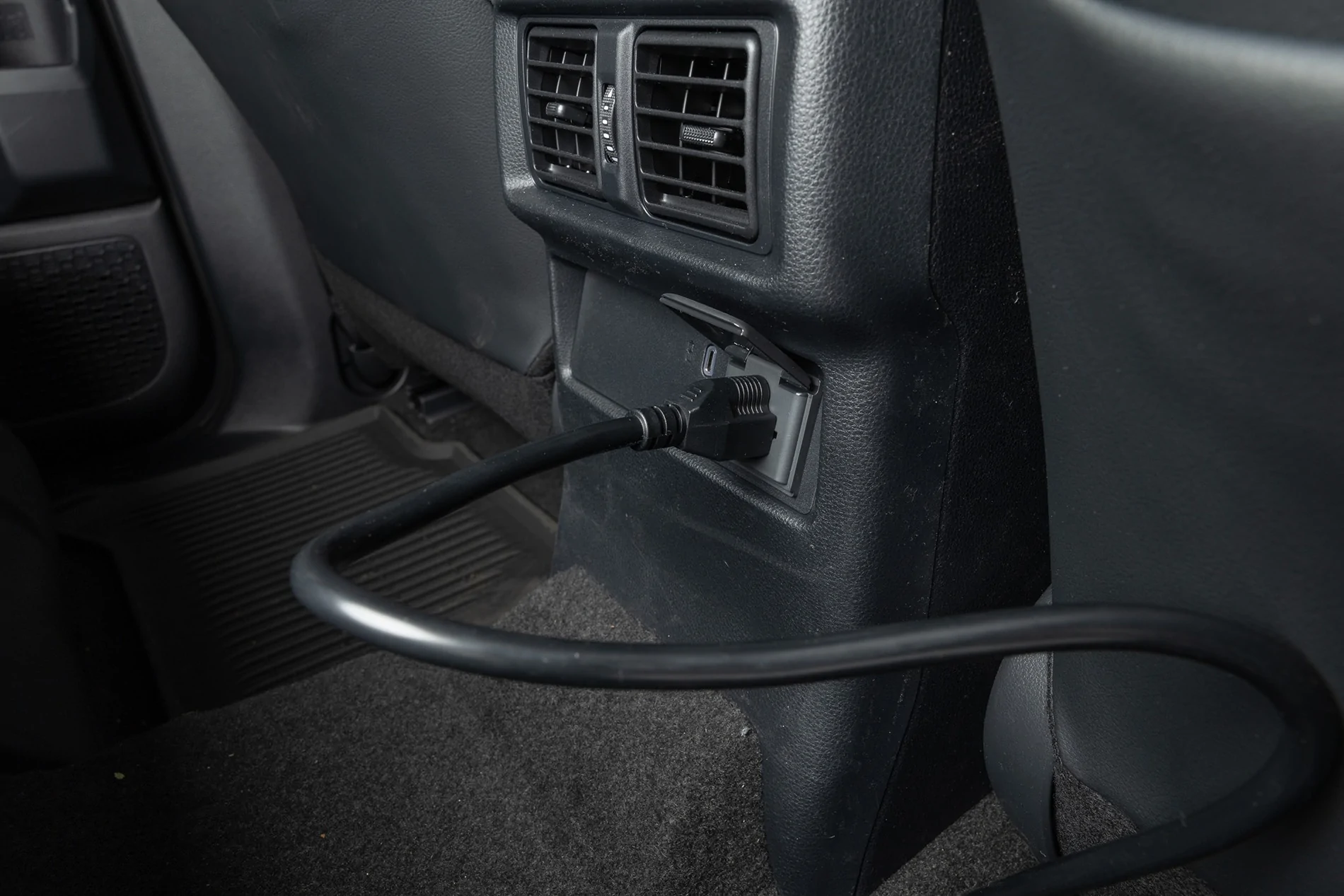

When I’m in a developed campsite with electrical hookups, I use this GE 3-outlet Power Strip Surge Protector 15ft Extension cable, which is rated for 13Amps / 1625 watts, to connect the EcoFlow to shore power. I simply unplug the AC cord from the Toyota 2400W outlet, and plug it into the extension cable.

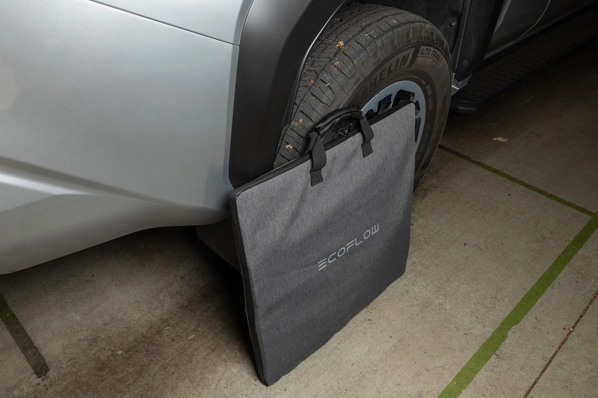

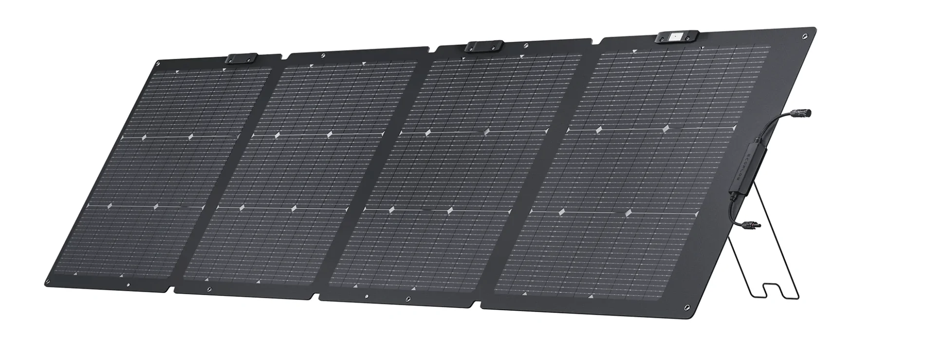

I don’t use the solar panel very often (because I’m usual driving from place-to-place enough that I can just charge off the alternator), but when I need it, the 220W Bifacial Solar Panel plugs right into the Delta 3 Plus and is very compact and easy to stow. Since I have a Free Spirit Recreation FSR Aspen V2 Rooftop Tent with a clamshell closure, I can just stow the solar panels inside the RTT when I’m not using them.

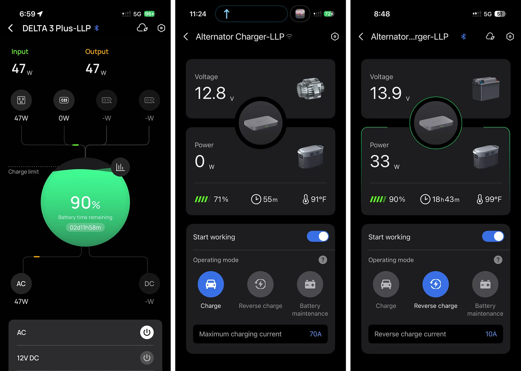

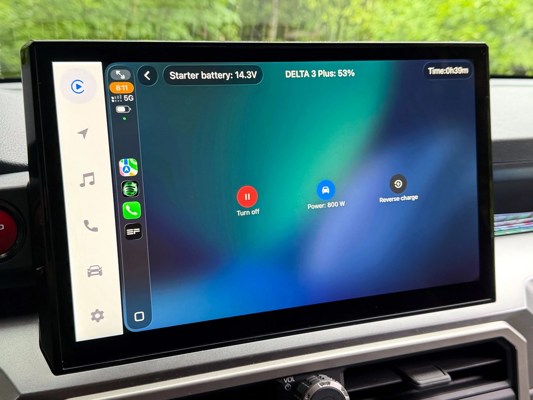

Here’s a look at the EcoFlow iPhone app and Apple CarPlay widgets:
2025 2026 4runner 6th gen Dual-battery setup for the Hybrid 4Runner EcoFlow A
The app for the Delta 3 Plus shows the input and output draws, the current battery charge level, and the expected run-time based on recent usage patterns. You can also selectively turn off AC, DC and USB ports, as needed.
The Alternator Charger has three modes:​
Charge: charges the EcoFlow using the vehicle’s charging system at up to 800W​
Reverse Charge: Allows you to recharge or jump the starter battery using 800W​
Battery Maintenance: Used for off-grid basecamps to prevent the starter battery from dying while running 12V accessories.​
The EcoFlow Carplay app allows you to control and monitor the Alternator Charger right from your dashboard. You can turn it on/off and toggle between charging and reverse charge modes.

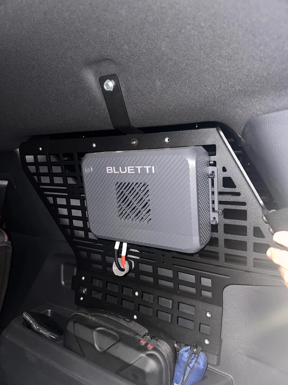

Similar setup but using Bluetti Charger 2 and DC hub. Mine is installed in the back.

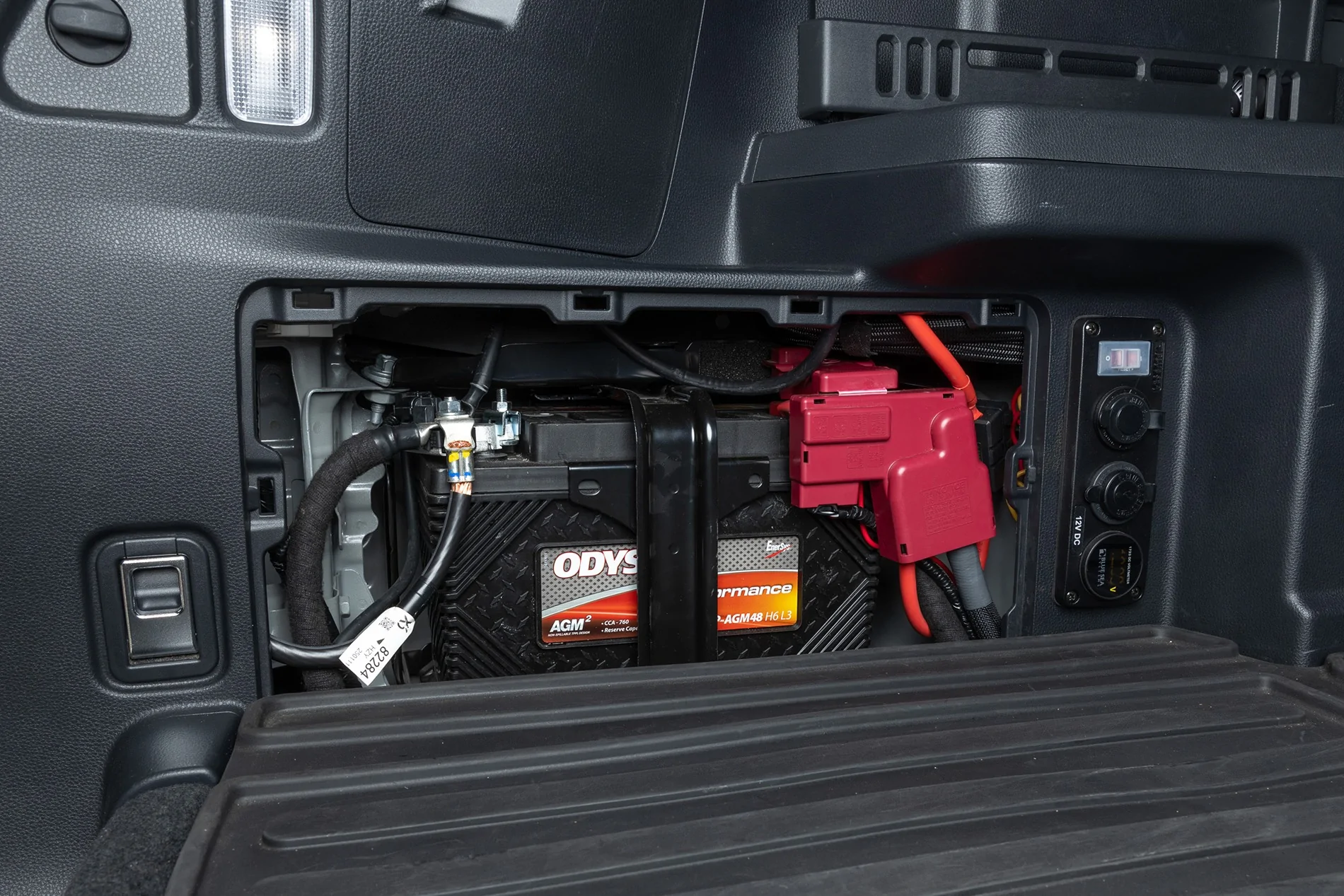

love the write-up, I will be pursuing a very similar system.
one question, this power panel you have installed near the battery:
2025 2026 4runner 6th gen Dual-battery setup for the Hybrid 4Runner 1782149705173-xr
what is it, how did you set it up, what else can you say about it?
also, I see you upgraded your vehicle battery as well. any particular reason?

one question, this power panel you have installed near the battery.
It's the Blue Sea Systems 12v power panel. I use it to monitor starter battery voltage on its OLED display, and to add some additional 12V/USB charging ports in the rear cargo area. You can read more about it here:
https://www.4runner6g.com/forum/threads/blue-sea-systems-12v-power-panel-install-in-orp-hybrid.4046/
Yeah, I run quite a few accessories off the 12v starter battery around camp (scene lights, phone charging, power to the rooftop tent for light and charging) so I upgraded to the Odyssey AGM48 battery. It takes more charge and lasts considerably longer than the OEM flooded battery. Also better-suited to running the WARN winch.
