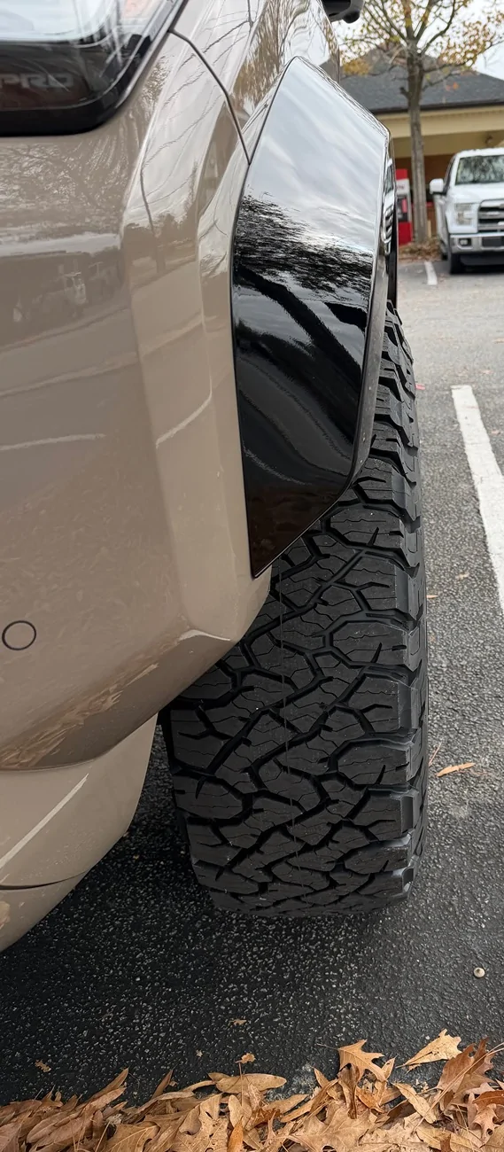

2025 TRD Pro
285/70/R18 with a +18 offset
Wheels are KMC
Tires are BFG Ko3 E Rated.
This is what a +18 offset looks like on a Pro

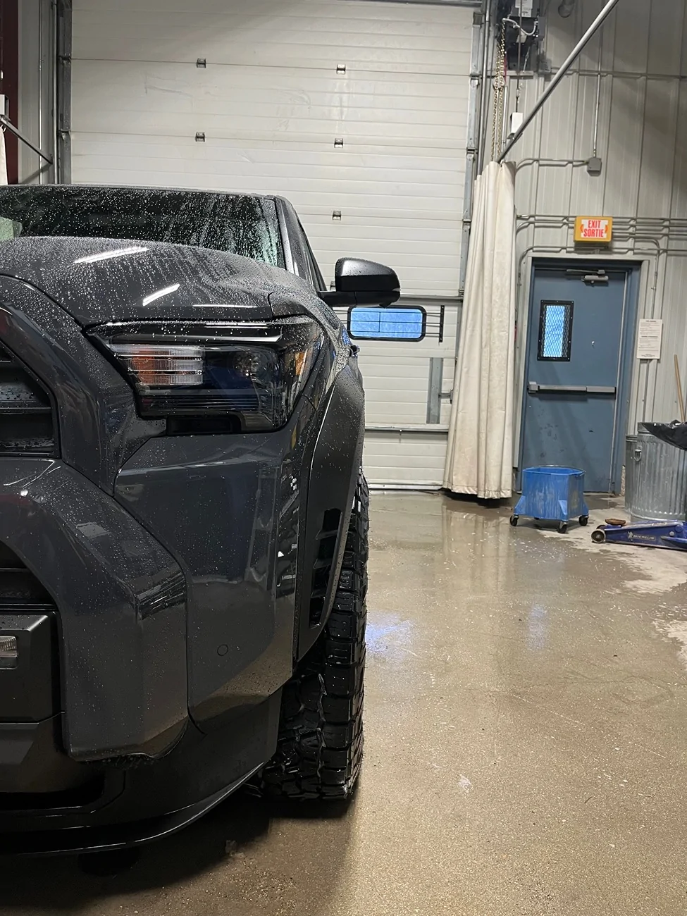

What I’m looking at are 18” rims, 8” width with +45 offset. I’ll be putting 265 tires on, just wondering if they’ll be flush or stick poke out a little past fenders.
This is an 8” wheel at +35 and a 285 tire, you’d have less poke than this.

Need to add wheel width. +18 offset from a 7.5 inch wheel is very different than +18 on a 9 inch wheel.
