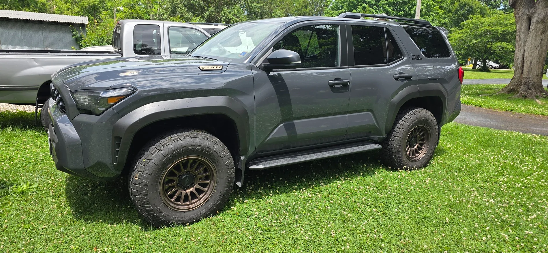

2025 2026 4runner 6th gen What do you guys think of these wheels? 20260527_132939

Remember offset is not static it’s based around the width. So if decrease the offset and increase the width you are getting even more poke.
Those wheels first posted would be 62mm or close 2.5” more poke than stock.
