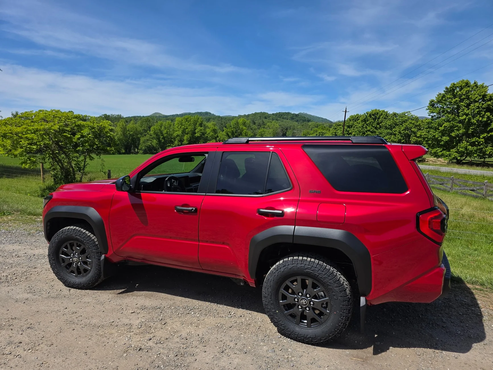

I just upgraded my tires and noticed the shop inflated them to 40 psi. Or at least that is what they were reading after driving home. The new size is 265 70 17. Should I stick with the manufacturers 33 psi or change it based on the new tire size and type?

I usually run ~35 ish with the AT4s. Kind of preference though.
Whatever you go with though, take your measurements when the tires are cold.

so many variables...so it is best if you do some initial investigation
for your tires and your loads
start with chalk test pressures front and rear
then adjust for mpg, handling, suspension as you like
but chalk test pressure is a good starting point to know
also compare door sticker pressure to chalk test pressure

Typically you increase tire pressure when swapping from OEM to LT tires for load rating. My Mickey Thompsons are currently at 38 psi cold.

For those who don't know:
The chalk test is a simple way to see whether your tire pressure is giving you even contact across the tread. The basic idea is: mark the tread with chalk, drive a short straight line, and inspect how the chalk wore off.
How to do it
1. Start with a cold tire pressure setting close to your door sticker or a sensible starting point.
2. Find a flat, smooth area like an empty parking lot or quiet straight street.
3. Draw a thick chalk line across the full width of each tire tread, including the outer edges and center ribs.
4. Drive straight for about 50 to 200 feet, without hard braking or turning.
5. Stop and look at where the chalk rubbed off.
How to read it
• If chalk is rubbed off mostly in the center, pressure is too high.
• If chalk is rubbed off mostly on the edges, pressure is too low.
• If it wears off evenly across the tread, you are close to the right pressure for that tire and load.
