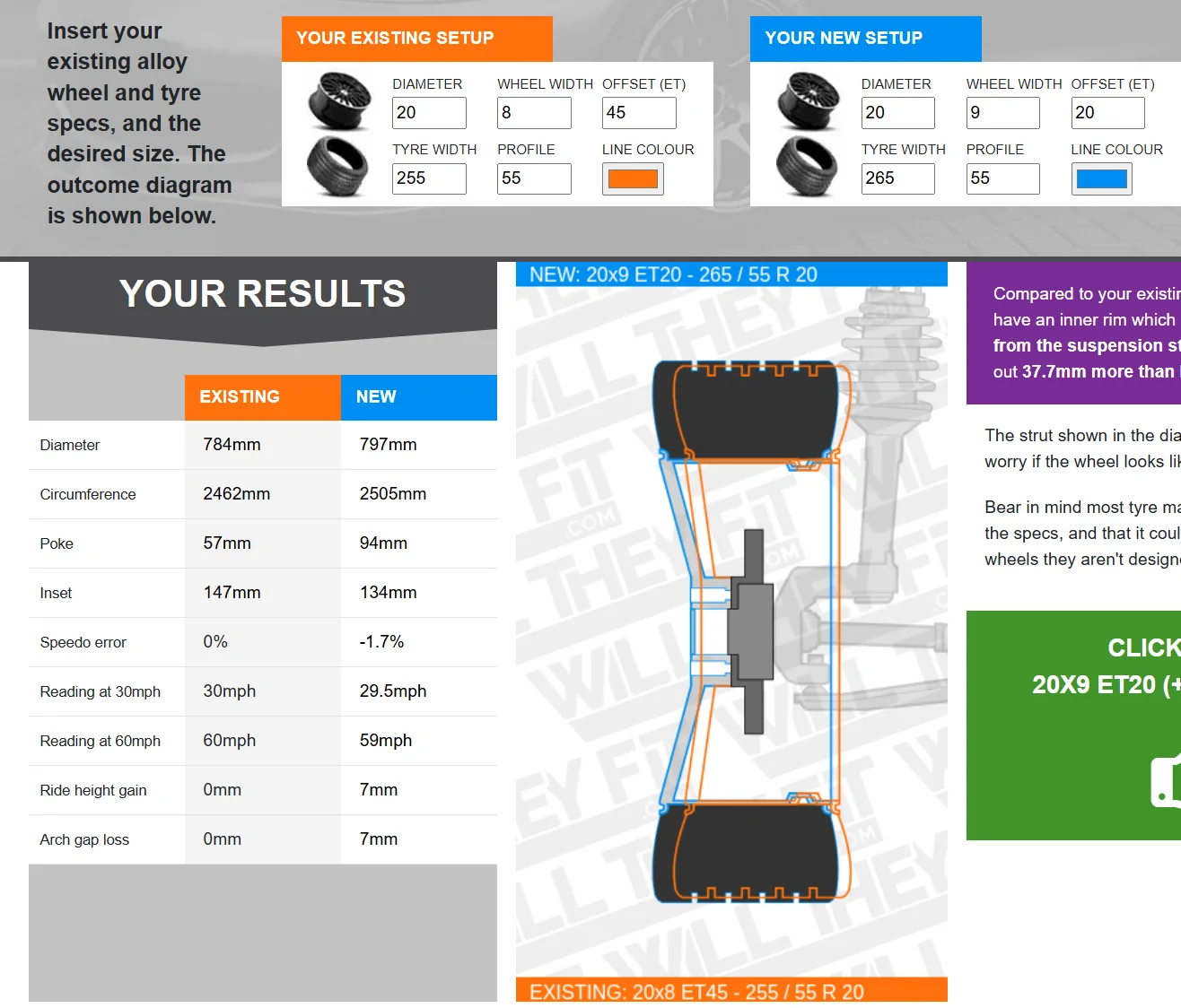

the biggest problem will be wheel offset if you dont use oem wheels.
most aftermarket wheels dont usually get above 25-30 offset but most i see are 20 offset. its a big difference when you visualize it with tires and wheels vs the oem tires and wheels
using my platinum oem wheel and tire specs and wanting to put aftermarket wheels and tires
1. first did a lookup of oem specs
https://www.wheel-size.com/size/toyota/4runner/2025/
2. then used the visualizer website to see how the poke changed with aftermarket wheels based on the specs
https://www.willtheyfit.com/
here is a different reference site to use besides the ones above
https://tiresize.com/

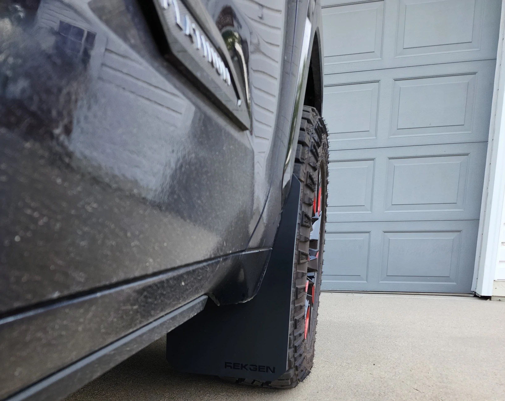

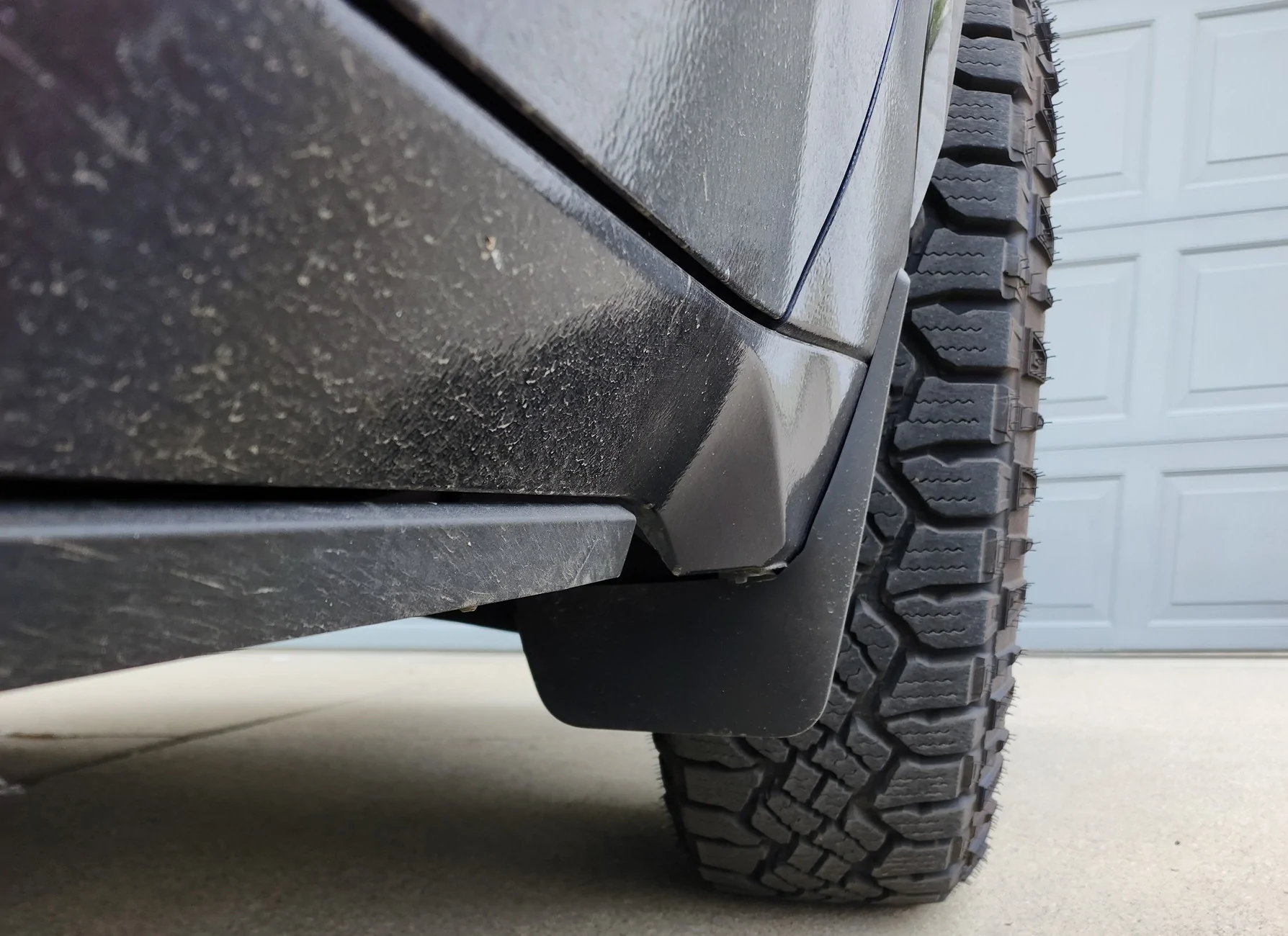

not any with the oem mud flaps (on our 23 tundra). but i kept the same tire specs just different aftermarket wheels.
i havent purchased the wheels yet for the wife's 4R, waiting until we get the vehicle in the driveway before i order the wheels. not going to replace the oem tires just yet since toyota changed from the grandtrek pt5a to a different tire now on the platinums

here is the 23 tundra after we put fuel flame wheels with duratrac's on them
oem mud flaps vs some rekgen mudflaps
you can see the added poke of a smaller offset than the oem wheels had. the oem wheels sat within the wheel well vs these flames at 20 off set, they poked about 1 inch past the fender flares.

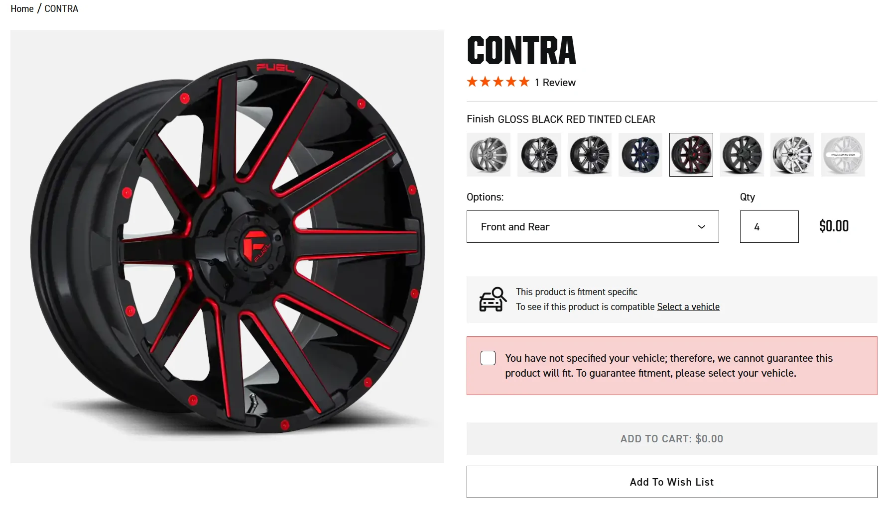

we will be getting some fuel wheels after winter.
this is the spec i will be getting, directly from the fuel website specs pages
just a note, will need a hub centric ring to get these to fit correctly on the hub of 95.1 (5th gen was 106.1)
you can take a larger bore (hub) and fit it to a smaller hub but you cant do the opposite
Part#ModelFinishSizeBolt PatternBackspaceOffsetBoreWeightLoadLip Size
D64320909857D643 CONTRAGLOSS BLACK RED TINTED CLEAR20X96X135/6X139.75.7920mm106.1038.00 lbs25000.00
