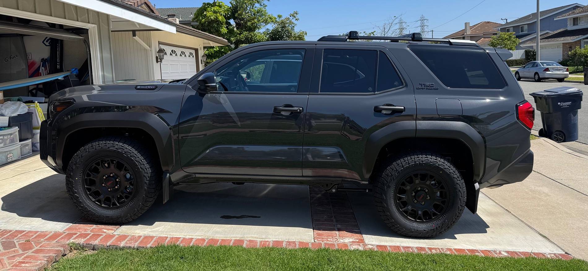

I am more than content with the size and look of the 265/70R18 Falken Wildpeak A/T4W that I just put on (but I do have the black TRD wheels). Sure, bigger would look even more aggressive, but I just need functionality primarily in the snow and minor off road while also being quiet on the road. Also do some infrequent towing (3800 lb trailer).
That looks great. Unfortunately, I do really like the black wheels like you have lol. Just means I might have to spend more money.
This looks like the perfect combo! Any chance you have more pics, maybe straight on from the front and/or back and something a little diagonal?
